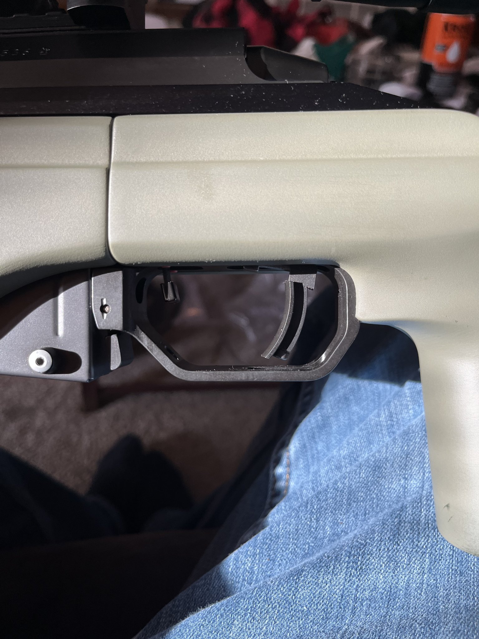

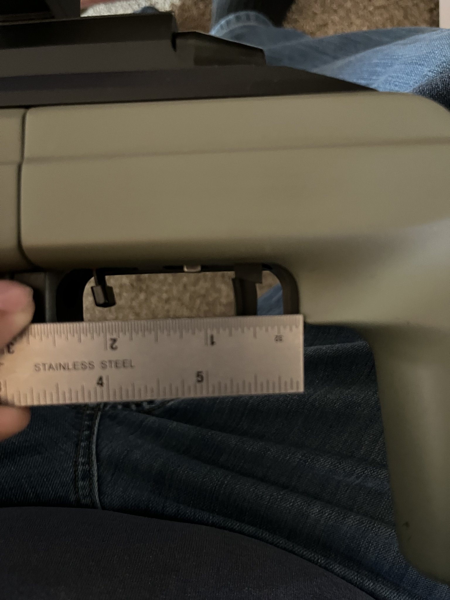

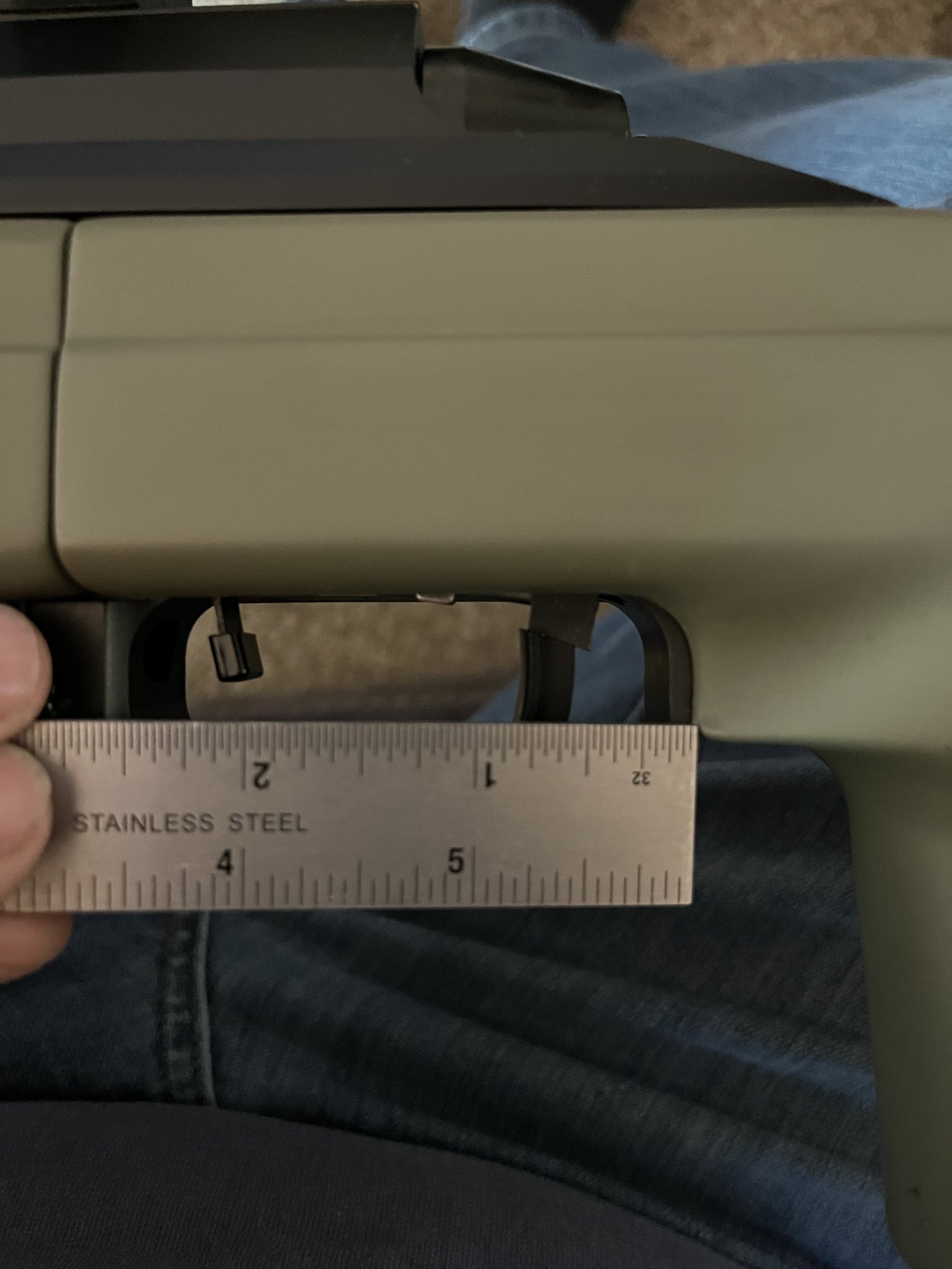

Hi everyone, sorry if I re-open this old post. I read the instructions, they were very helpful, thank you. I have a new version TRG 22 (post 2013 trigger), and I purchased an old version trigger (pre 2013), to be able to adjust the first and second stages. I brought the first to half of the total weight, it works fine. I only have one doubt: does the trigger, in this older model, after unloading the hammer, not move? In the new trigger it also moves when unloaded or after a shoot, practically like the first stage. Here, however, with the rifle unloaded, the trigger remains stationary. Is this normal or is there some incorrect adjustment?
When you say unloading do you mean "reset"? I'll pull my TRG's out and look tonight if I don't get skull drug into my normal craziness.
Just grabbed mine. The pic without the ruler is in the cocked position one pic is with the ruler in the cocked position and one is in the fired position. There is some movement in the post fired state, maybe .125 inches but nothing near like the first stage in the cocked position. Hope this helps.
Reactions: Fenix and stefan73
Just grabbed mine. The pic without the ruler is in the cocked position one pic is with the ruler in the cocked position and one is in the fired position. There is some movement in the post fired state, maybe .125 inches but nothing near like the first stage in the cocked position. Hope this helps.View attachment 8232633View attachment 8232634View attachment 8232635
I should have worded that differently. The first stage is nonexistent in the fired state. There is about .125 inches of rearward travel in the uncocked state.
Reactions: stefan73
Yes, you're right, I'll explain better too. If I remove the bolt, both triggers have a long, smooth movement comparable to the first stage. In the old version, when the hammer is down, the trigger practically does not move; while with the new version after you shoot it has practically the same movement as when there is no bolt. Maybe at evening I'll recover the triggers and try to measure, if it can be more clear.
It could also be all ok, I just have no experience with the old trigger and I don't have a comparison with another "born old" Sako.
Reactions: .505gibbs
