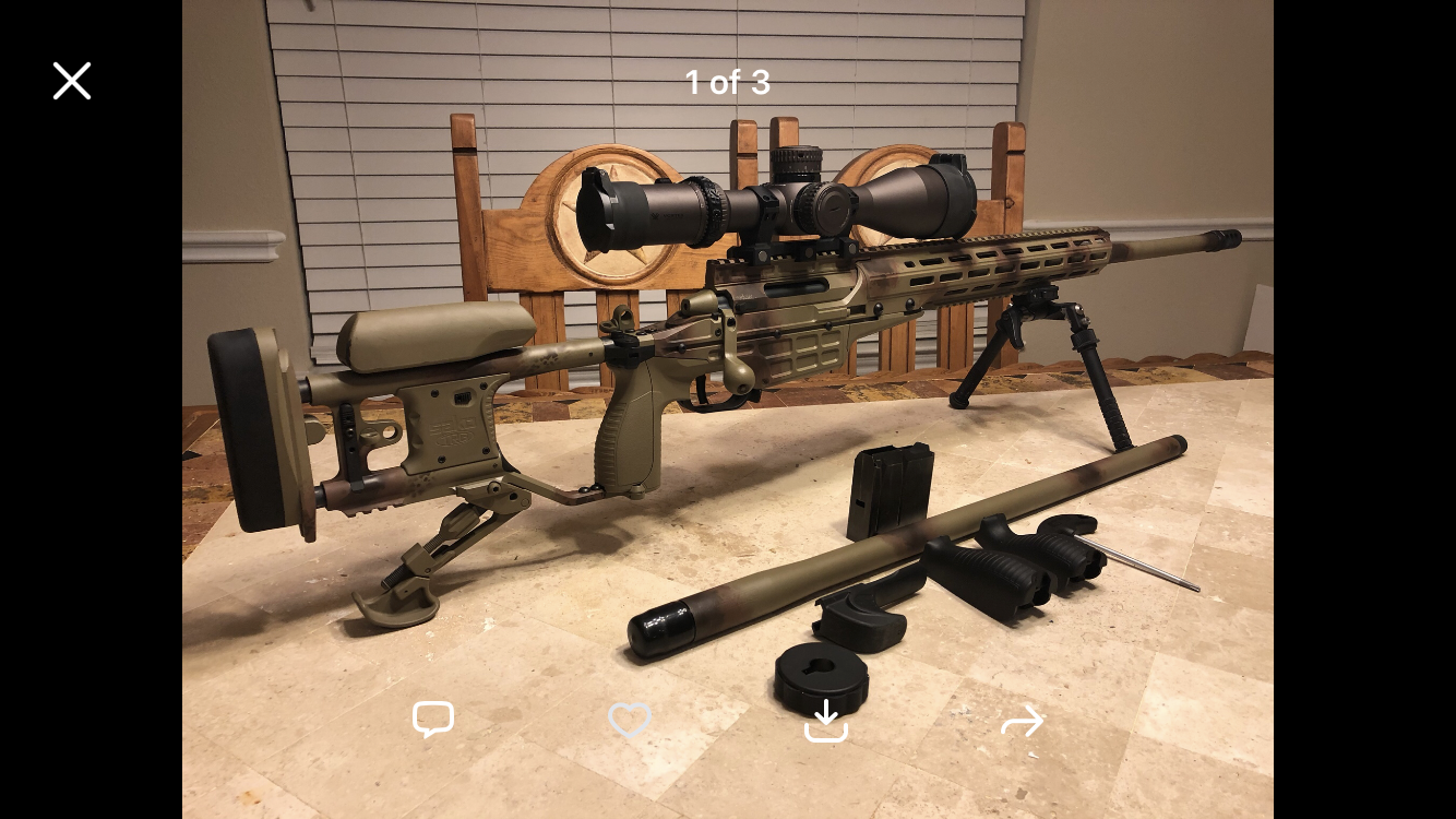

Here was mine. I sold it a while back.
That's one awesome setup! I'm after the A1 version of the TRG over any other rifle. Looked at AI, Barrett and so on. Something about the TRG A1 that has me. Just wanted to hear from others who had experience with both and wasn't sure if going the with the A1 upgrade would be worth the couple grand over the fixed stock. Money isn't the issue. But it will be an issue if I find out after the fact that I should've stuck with the fixed stock.

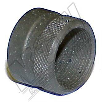

Does anyone have a thread protector for a TRG-42 338 LM? I can't seem to find mine, nor have I seen any instock anywhere lately, I want to sell the rifle complete so if anyone can point me in the right direction I'd really appreciate it. Sorry if I have posted this in the wrong area.
Many Thanks,

Is that an M18x1? Not sure about the 338….
Yes M18x1.
I see you had an extra barrel for the A1. How difficult are they to change and where did you buy the extra barrel? There doesn't seem to be a ton of factory or aftermarket support for these rifles in the US. A client just picked up a TRG42A1 and I am curious myself. Thanks!
If you need a barrel, I have a spare Brux BBL with a KRG barrel nut.
The answer is it's really eazy to change the barrel, the hard part is getting the old bbl off. It's typical to either make a relief cut or use alot of heat on the action. The former is a better want to do it.
Short Action Customs are pros are this, and I used to the later method to save the OEM BBL off my TRG-42A1... but they had to cerekote the action due to the heat.
