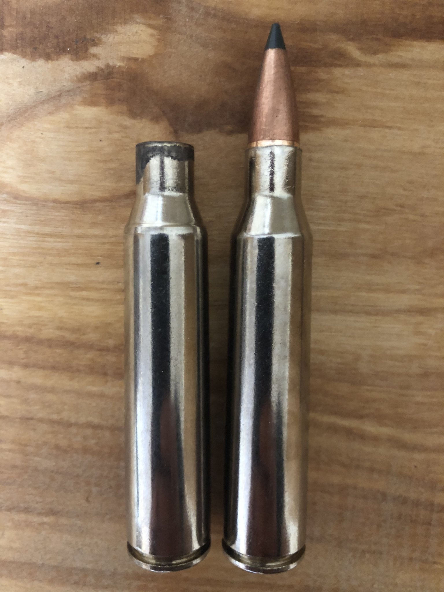

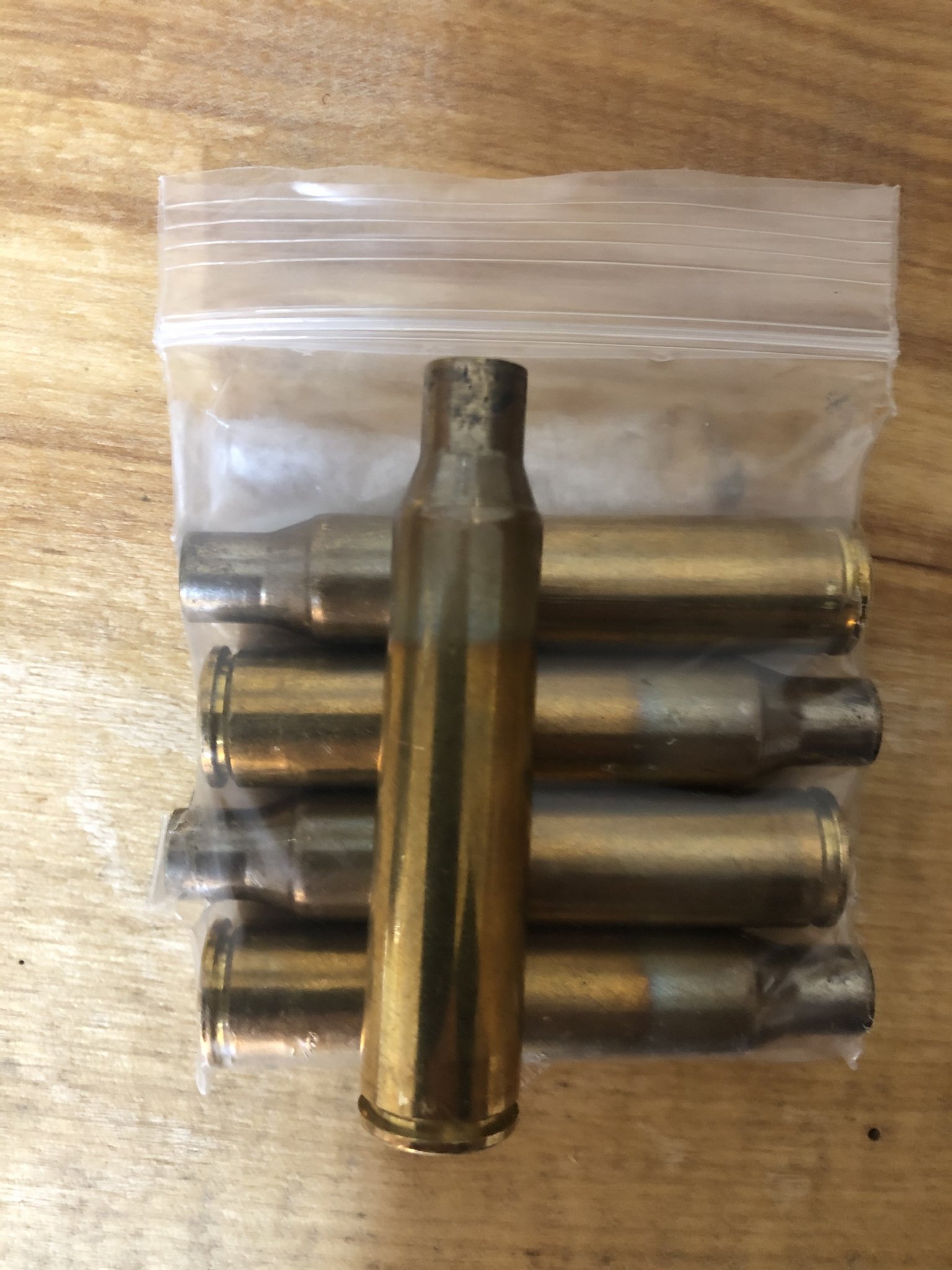

Hello this is my first post on this site and I’m hoping someone can lend me their expertise. I recently purchased a Sako TRG 42 in 338 Lapua as a step up over my .308 and have fired 30-40 rounds through it. A mix of Sellier & Bellot and Federal. The rifle itself functions flawlessly and I’m very happy with it. However after looking at my spent brass, I’m noticing a slight bulge in the neck on all the casings. I’ve been searching online for similar problems but can’t find anything helpful. The accuracy is good and everything else appears normal. This is my first 338 Lapua but I haven’t observed this happening on any other caliber I shoot, so it has me a little concerned. Anyone know what’s causing this and if I need to send the rifle in for warranty or is it nothing to worry about?
Eww, damn. Bolt lift feels good? What does the case head look like?
Definitely not right. It’s almost like it got chambered with one seriously messed up reamer (hard to believe from Sako), or the headspace is so off that it’s dangerous.

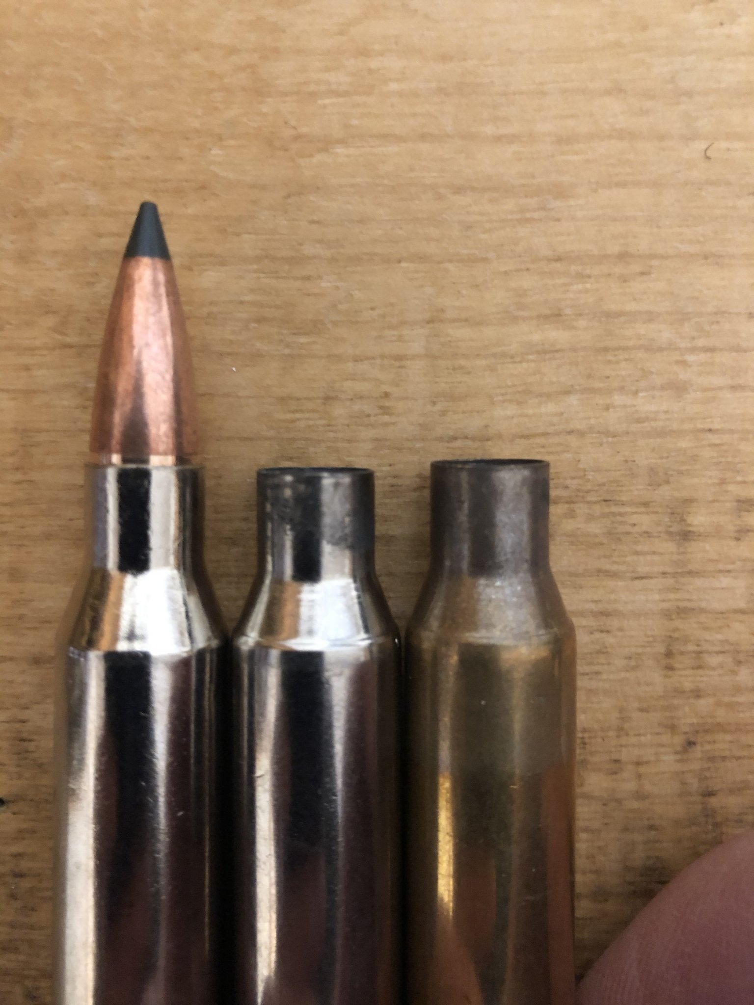

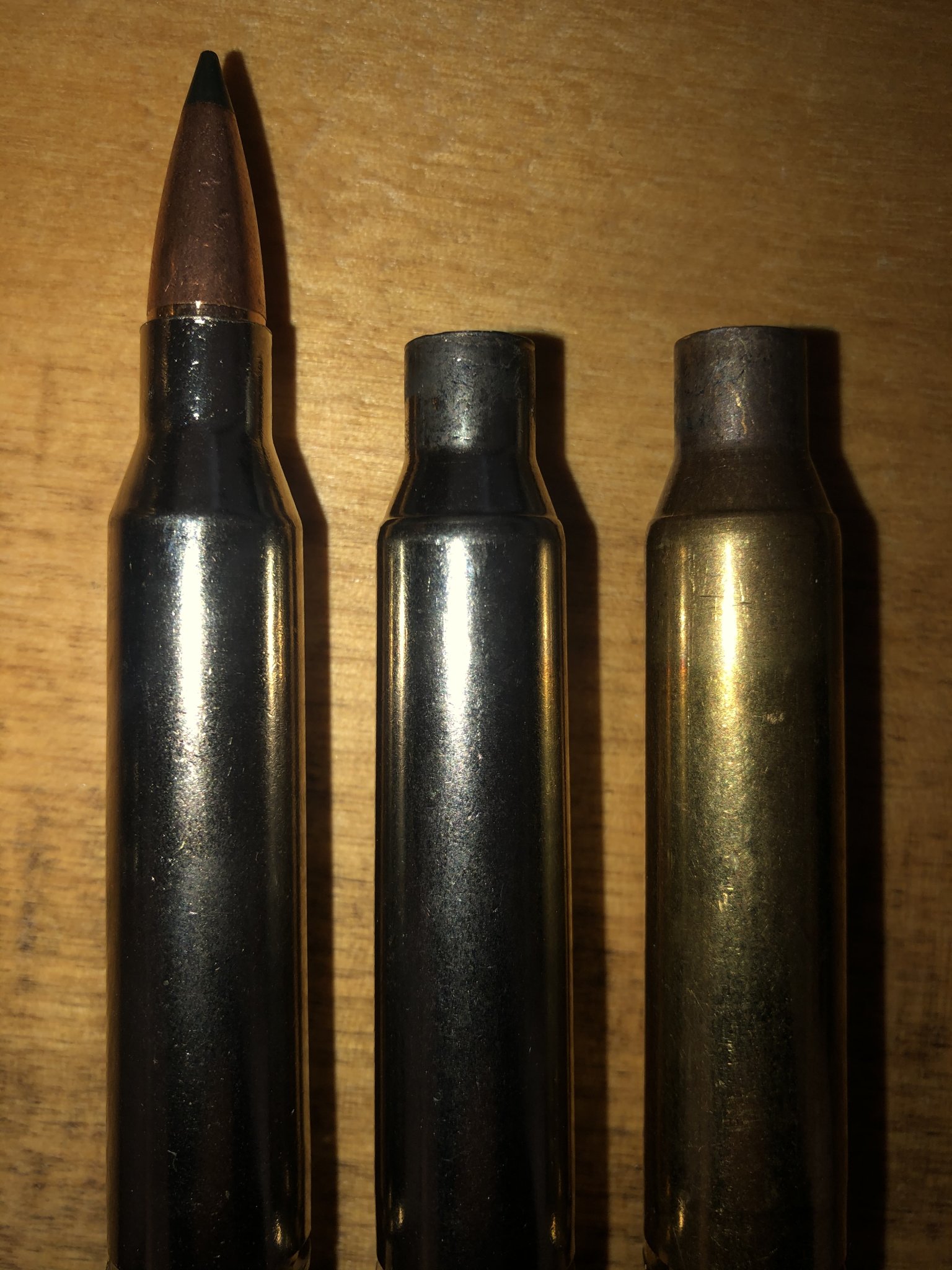

Yeah, the bolt lift feels fine. I haven’t noticed any stickiness. I didn’t notice anything out of the ordinary until I collected the brass.
Personally I'd have it checked out before firing it again. Either by a local trusted gunsmith or by Sako (via Beretta USA). You either have a poorly cut chamber or headspace is drastically off (my take on it with as much data as a picture can provide). I can already see a clearly developed line above the case web.
You are shooting factory loads which makes it sort of a pain to do with a bullet seated in it, but if you could measure the difference between an unfired piece of brass and a fired piece that would sort of answer one variable. Hopefully you have a pair of calipers around to do this with some accuracy.

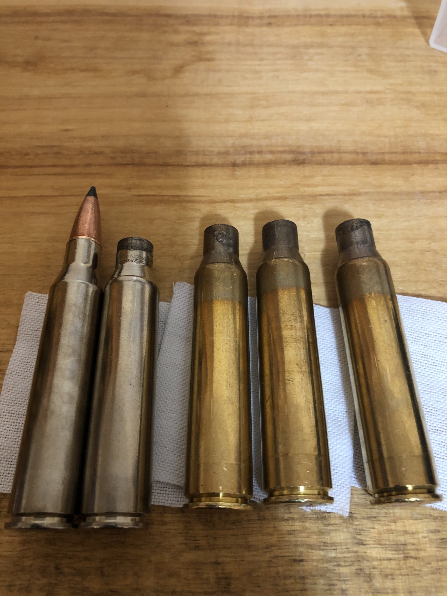

I just received the rifle back from Beretta today. There was no documentation in the box with it, just five new fired casing all showing the same issue I was originally worried about. I then called Beretta customer support and was told the rifle was test fired, the headspace was checked and everything was correct and within factory parameters. I’m still concerned by the brass deformation. I think I should probably find a gunsmith and get a second opinion. Any thoughts on this?
I defer to the last sentence in post #4...
Two options: Just keep on them, focus comments on the photos and see what they come back with. Either that or just outright buy a new barrel.
That's just how they are to deal with, unfortunately.
