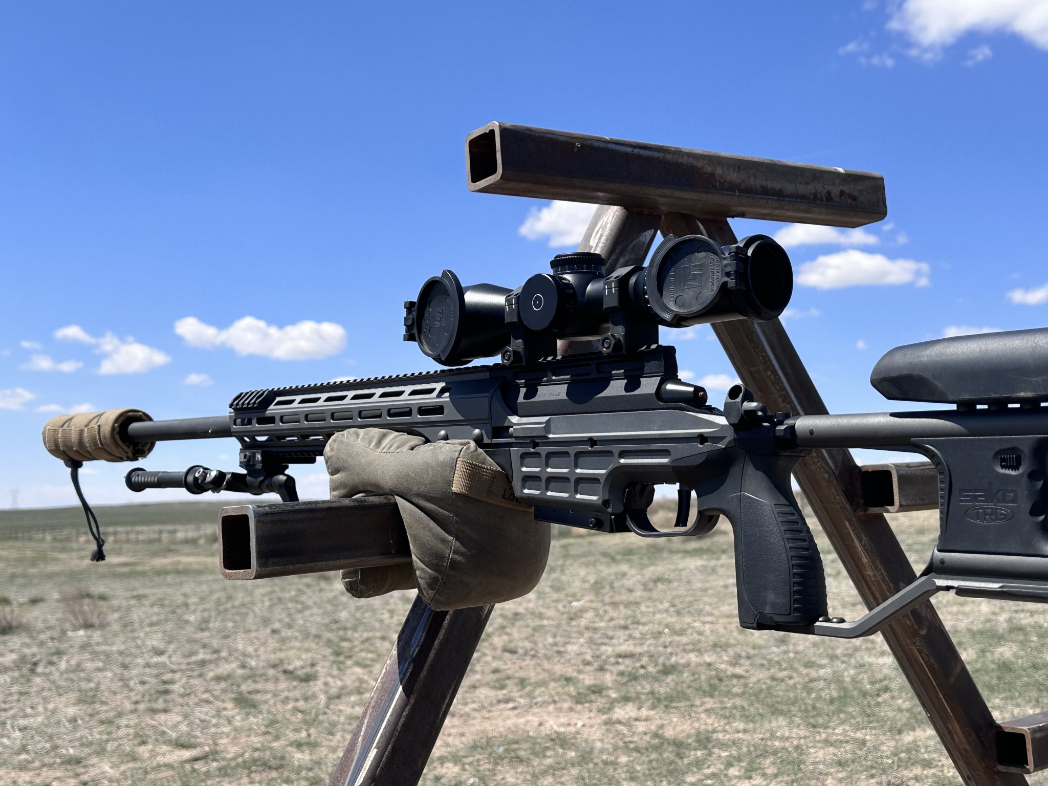

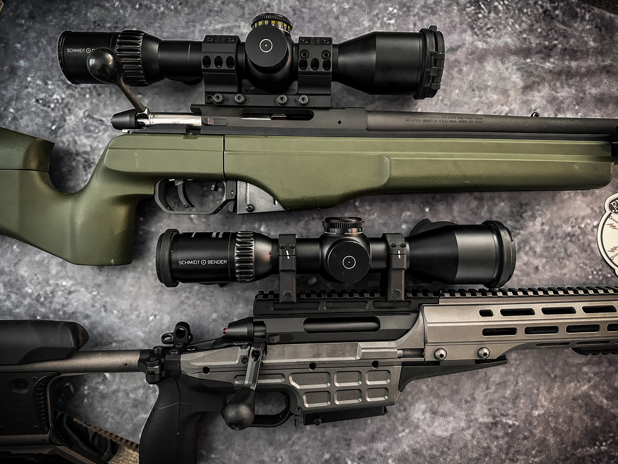

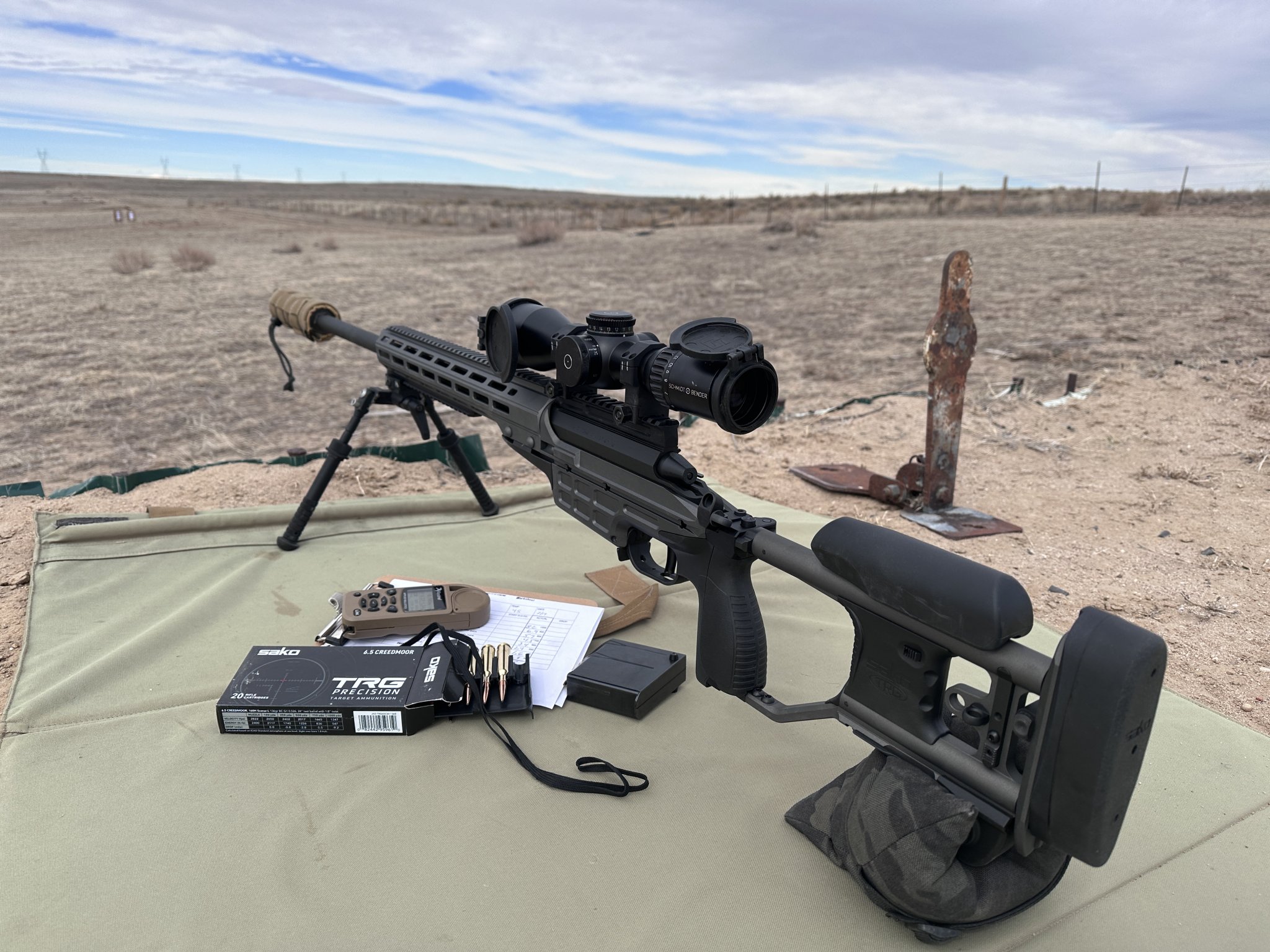

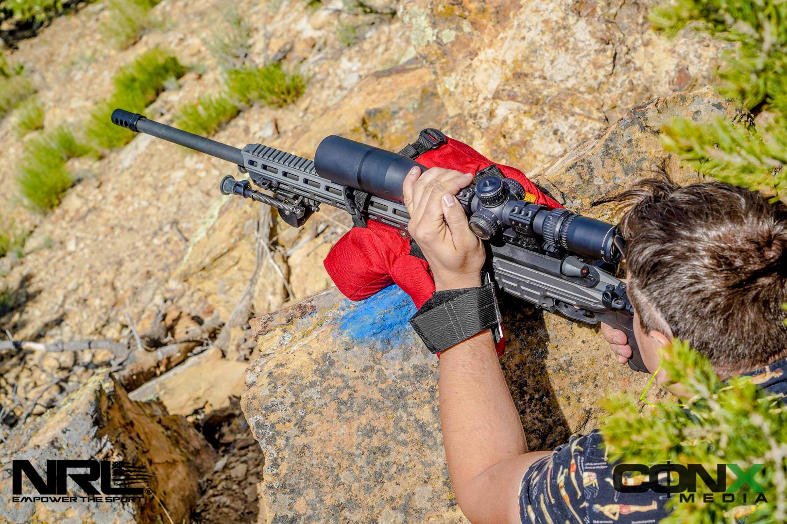

    We are currently working with the SAKO TRG22A1 in 65CM

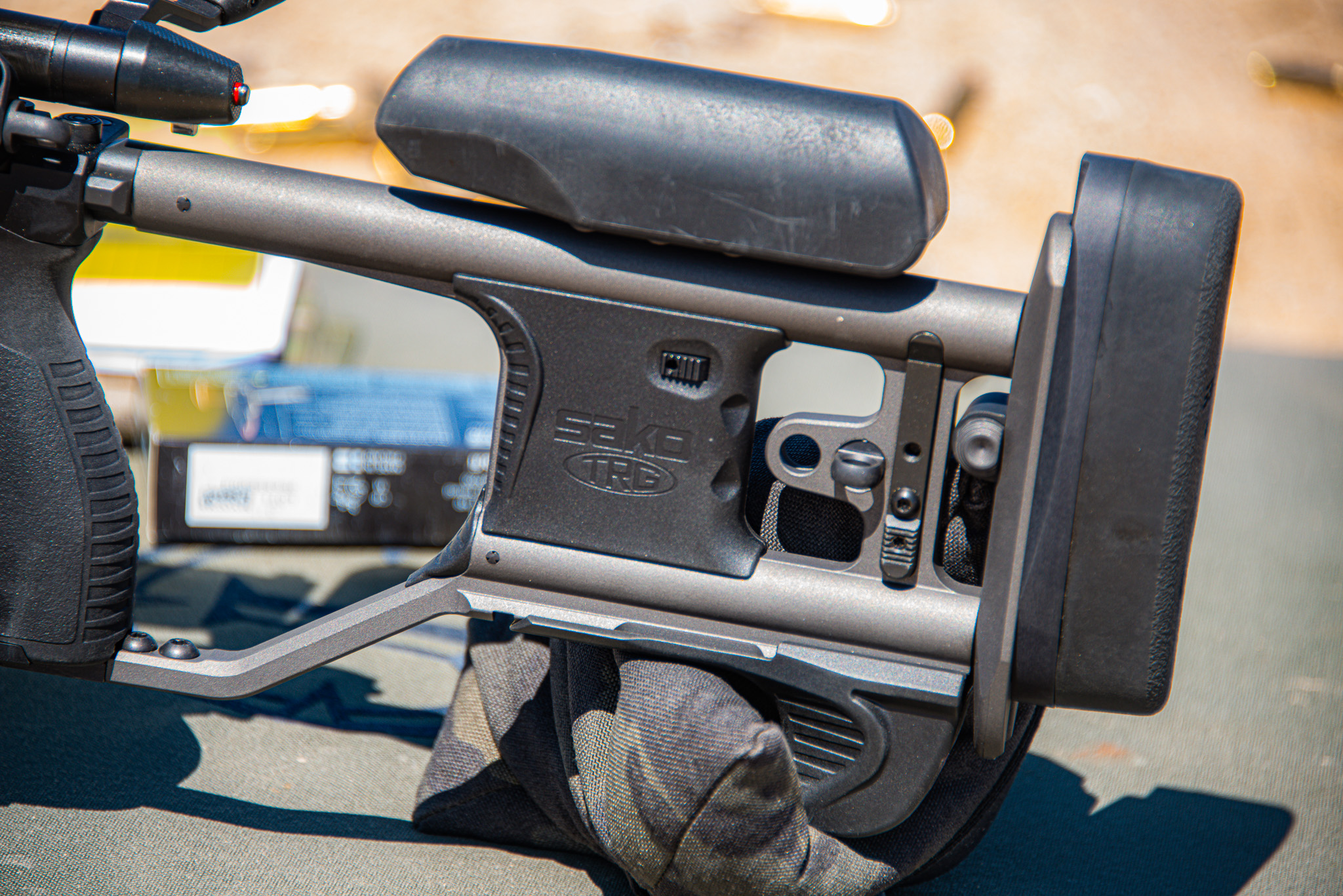

    I will note, I have an original TRG22 in 308, and the changes are well received as believe they did a great job changing the rifle to fit modern times. Mainly the adjustability in the stock. The TRG22A1 has a folding quick adjust stock. One note, be sure to tighten everything up as you can induce movement in the parts without securing. The bolt is one of the smoothest in the industry and when you run the bolt on a TRG you instantly fall in love. I am big fan of their triggers also.
    This rifle is different from the M10 TRG by the fact it is not switch barrel capable. The barrels on the TRG are fixed in place.

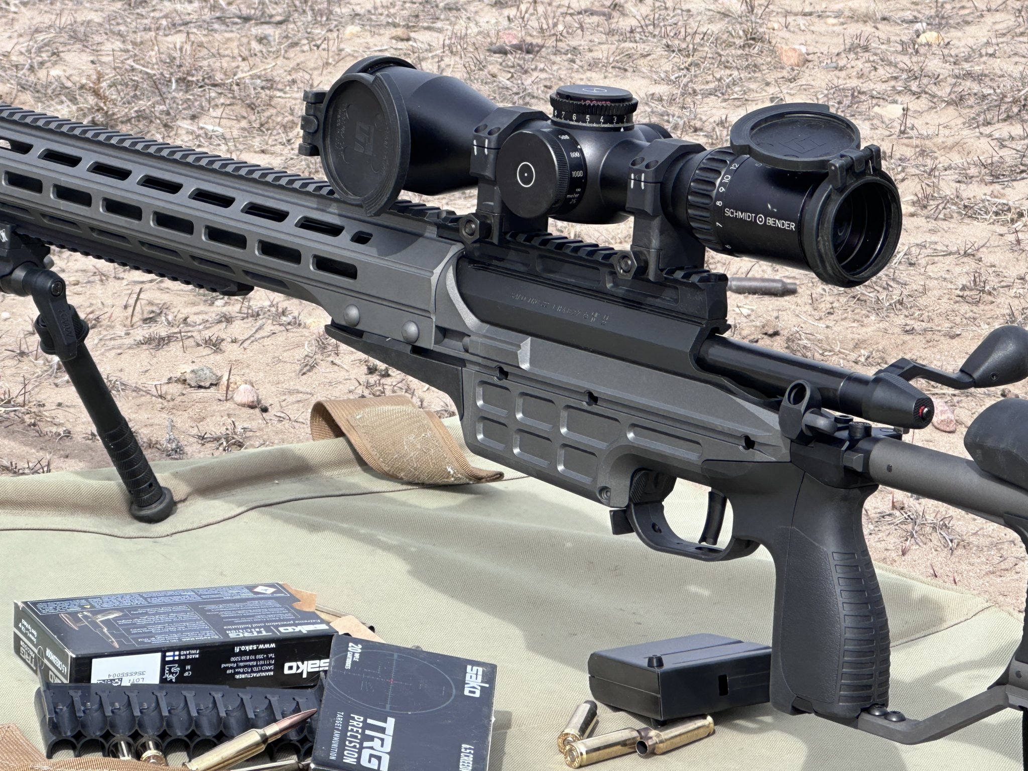

    TRG Ammo
    One highlight for me is the TRG Ammo from Beretta.

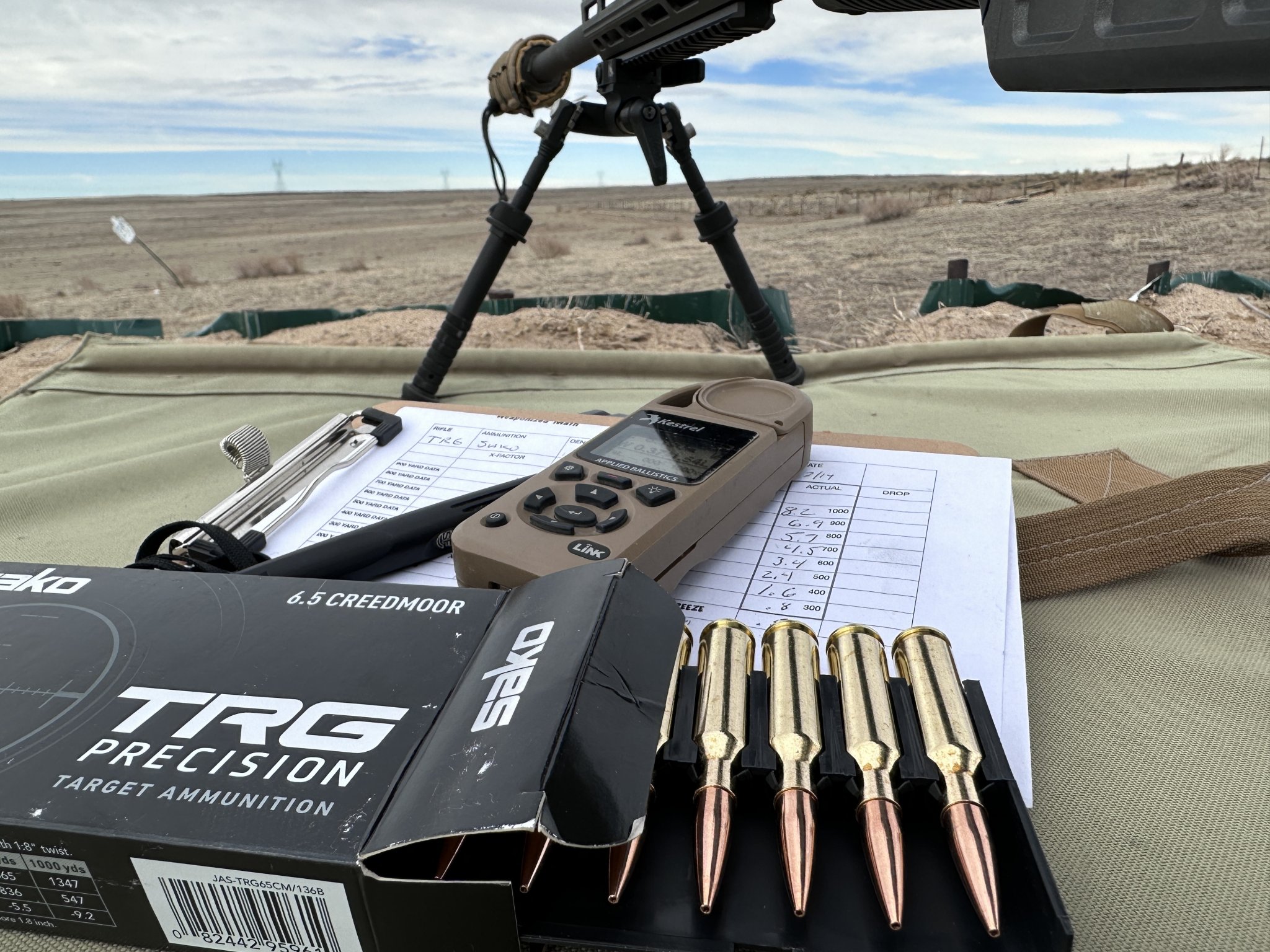

    The TRG Precision ammunition features a 136gr Scenar L bullet which in my opinion is the perfect round for the 6.5CM. Many people chase bullet weight but the 136gr Lapua has the same BC as many of the heavier 140gr class bullets have. The benefit of the 136gr bullet is being slightly lighter you bring back speed. I feel the 6.5CM class of bullets work best around 2800fps or higher.

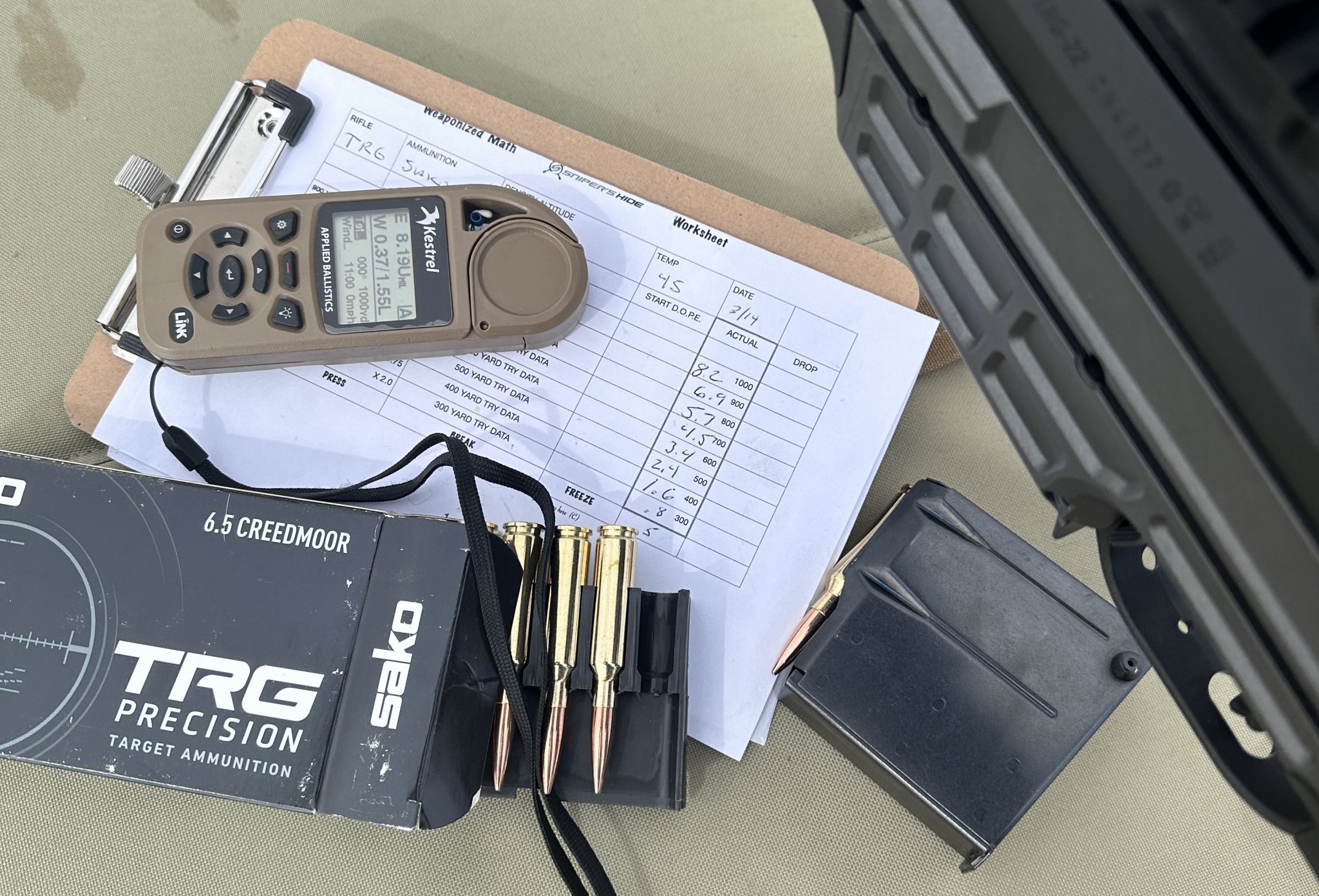

    Running the Numbers
    Running the bulletseeker on the TRG we had excellent numbers.
    136gr Scenar L
    AVG Velocity : 2780fps
    SD: 14fps
    With the Hammer forged barrel we have a bit slower velocity, but I have documented that many times. However even with them being in the slower node of velocity, accuracy is first class. When zeroing the rifle my initial accuracy first look was very, very good.
    Bottom group was my initial shots on paper after the bore sight. The 3 shot group at the the target was my zero group so very accuracy ammo.
    I then went out, dope the rifle to distance, getting my weaponized math details.
    I then adding .2 mils over the 1000 yard dope and decided to whack a prairie dog on the range. I estimate it was around 1010 - 1015 yards, this was a second round impact on the animal. I quick ranged him, saw the splash in my reticle, adjusted and took him out with the next shot.
    I will have more to report, our weather is just being racket since our Cameo Class. Once the weather breaks I will be back out putting the TRG22A1 through its paces.

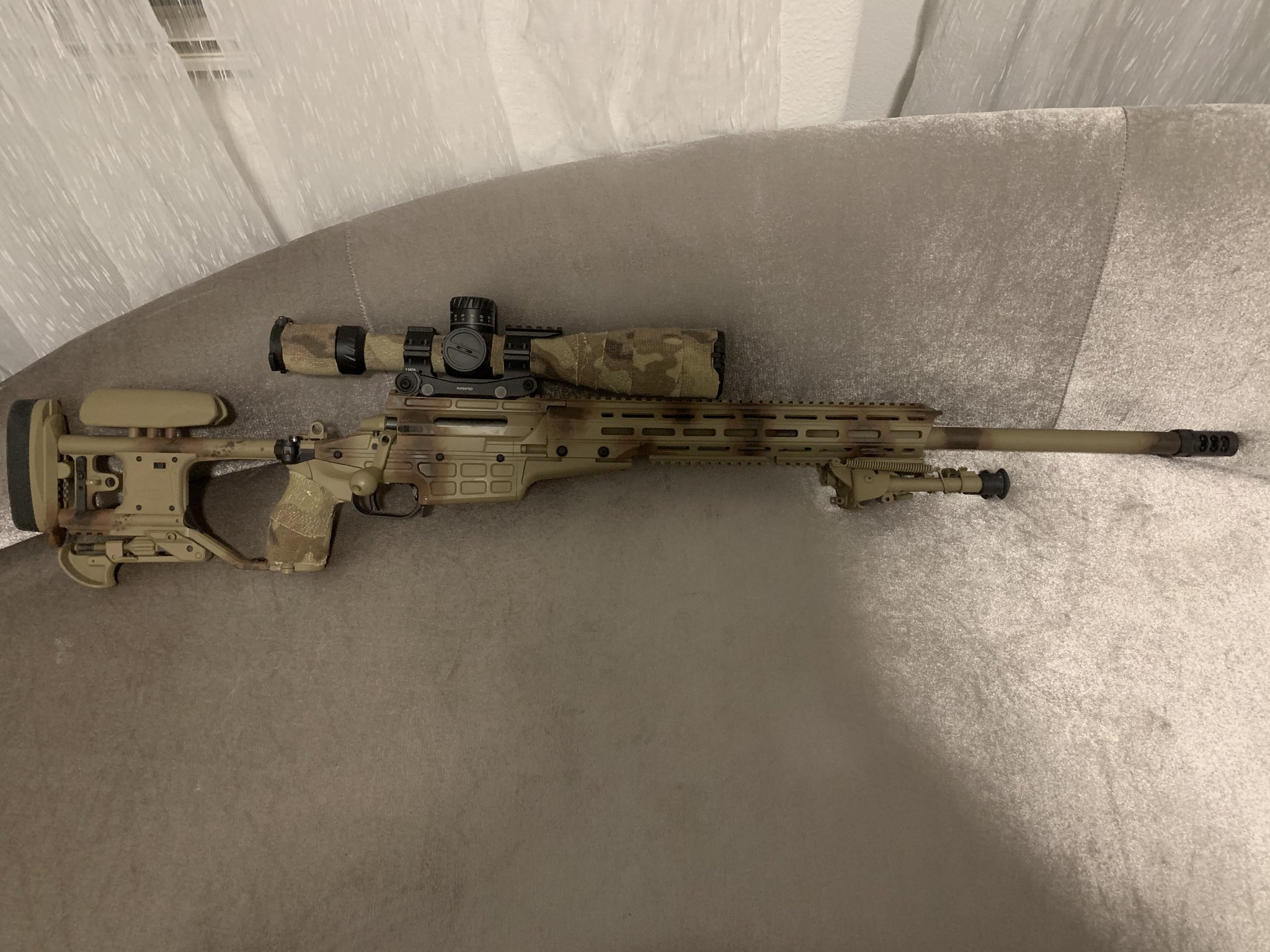

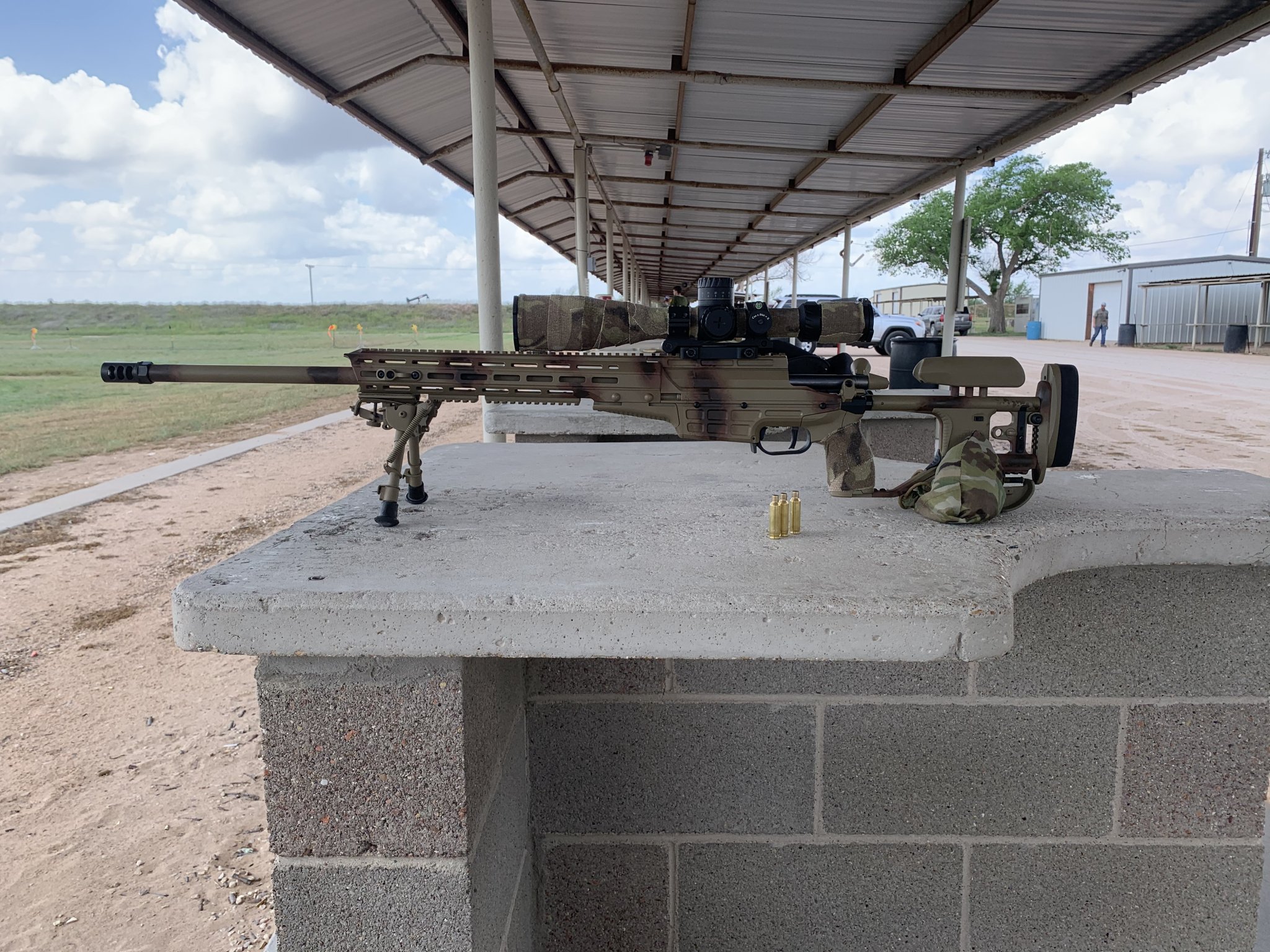

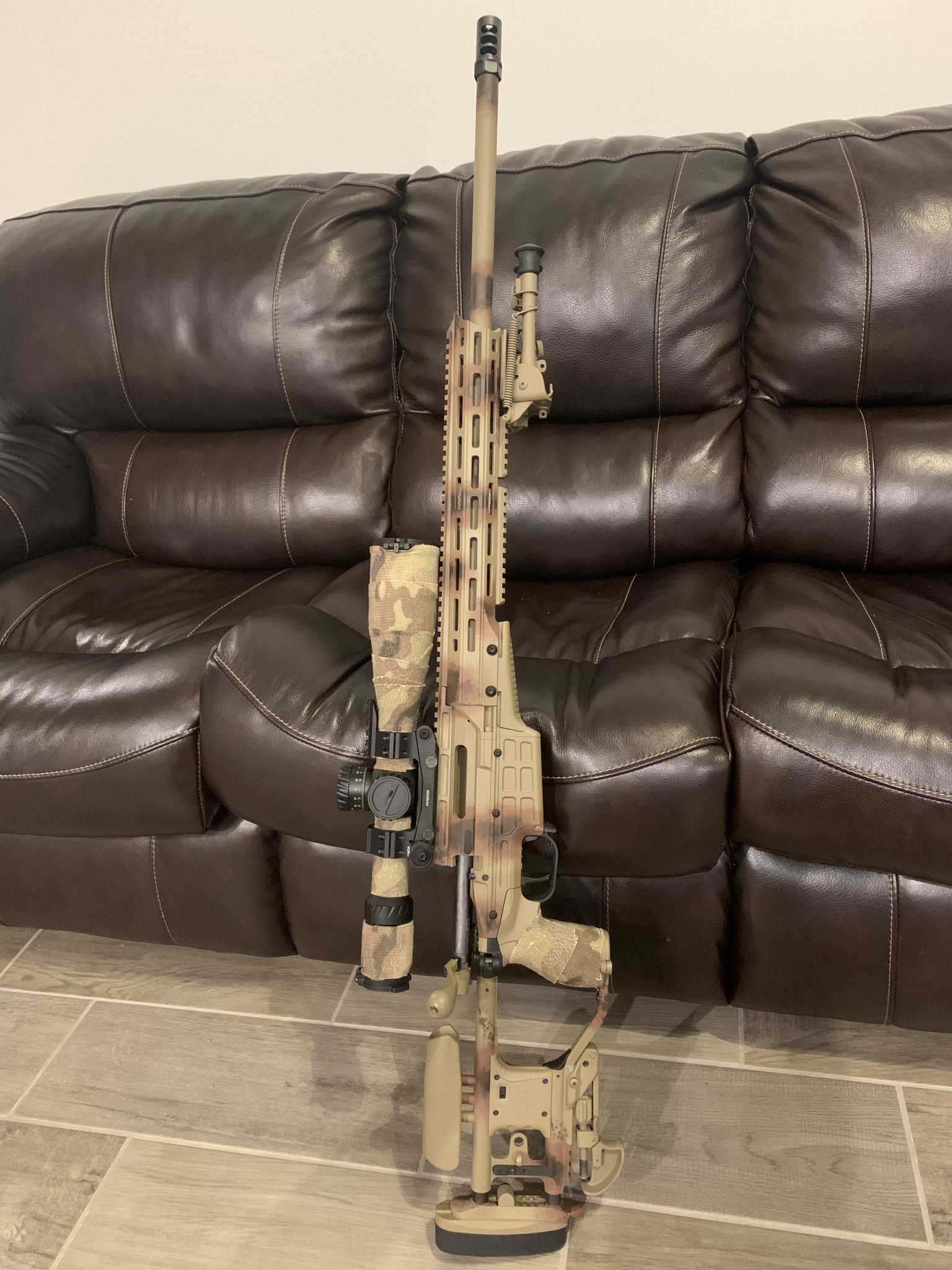

    I had one in 6.5CM, too.
    The trigger is good as expected, the bolt is smooth (it’s coated), the M10 monopod works fine.
    Bolts/screws need to be loctited, always keep loosening.
    Magazines do not work with 6.5x47 and similar cartridges.

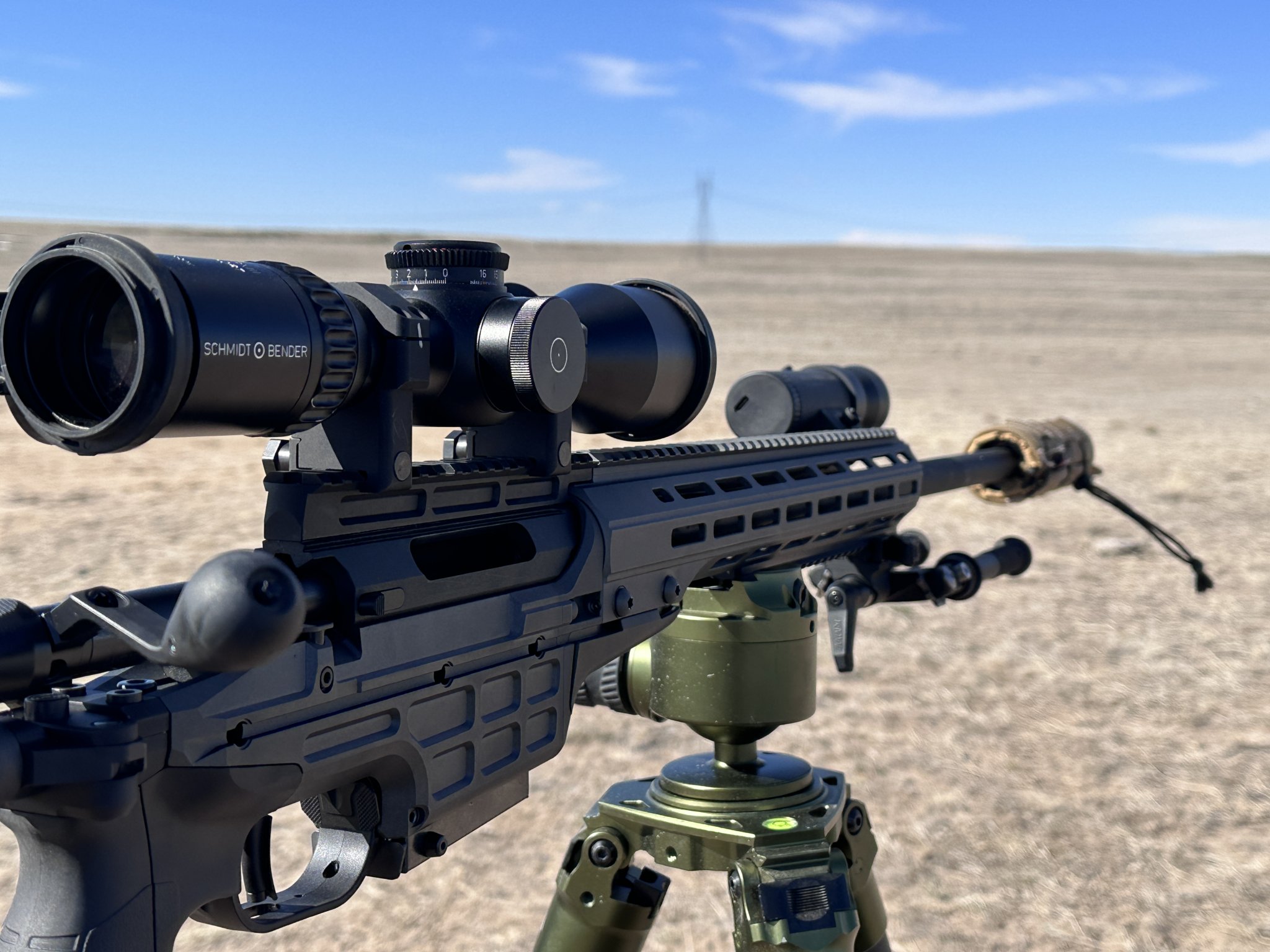

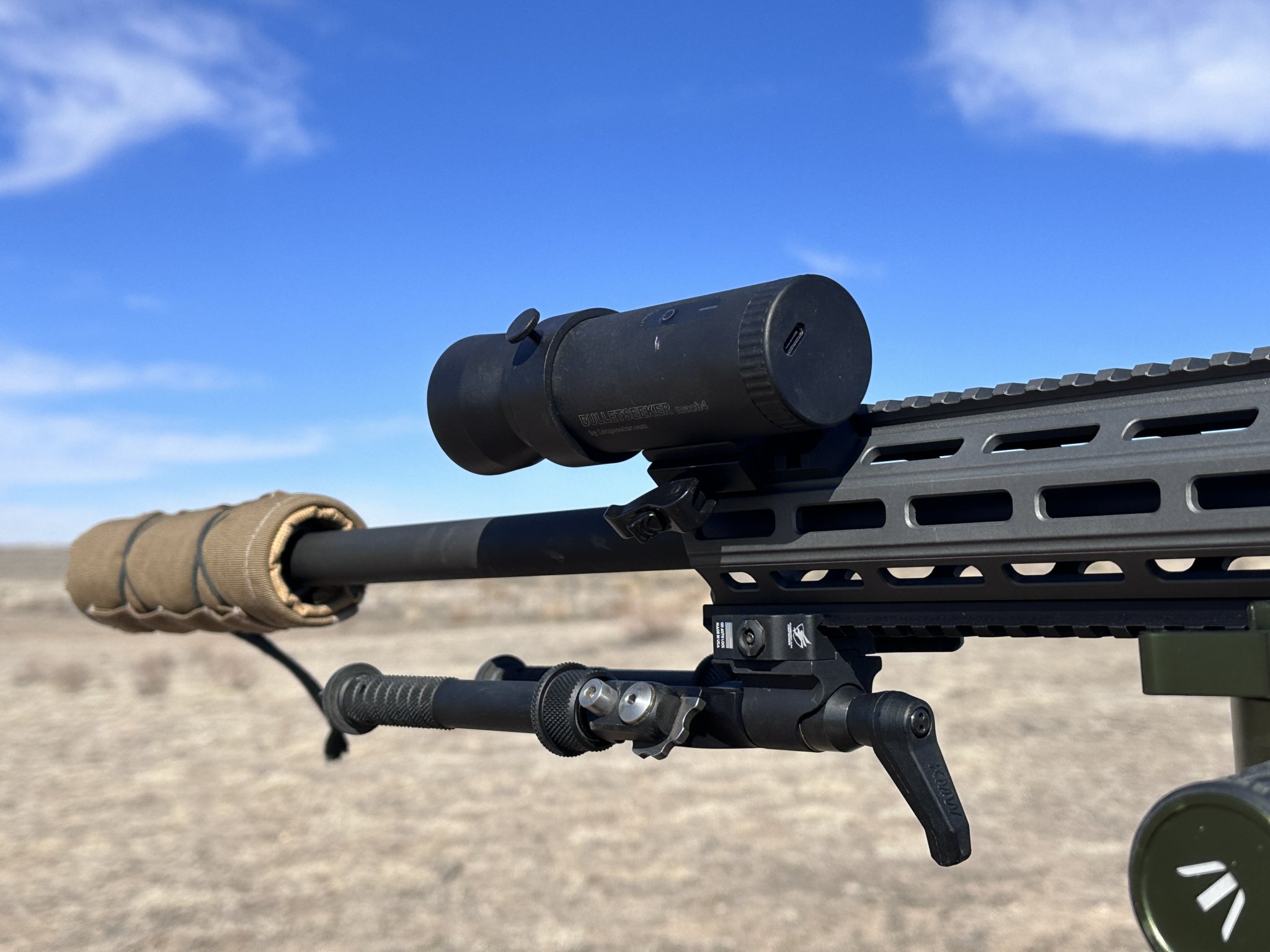

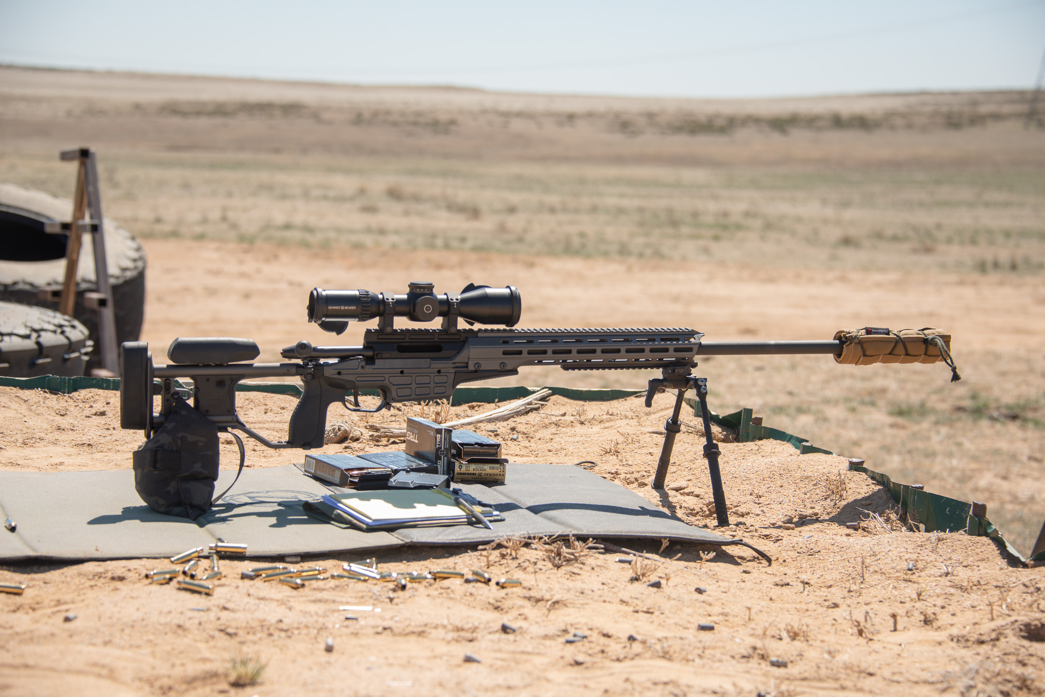

    Went out again with the TRG22A1 (in-between our psychotic weather)
    Accuracy is effortless with the TRG ammo, I love the 136gr Scenar L
    I was able to compare the ammo in my AI AT LE With custom Straight Jacket Barrel and even in that rifle, it's tops, well under 1/2 MOA.
    Super comfortable to shoot, and will make you look like a rockstar at the range
    Do they use Lapua brass in that Sako ammo?
    Reactions: jLorenzo
    The original GRN / BLK / TAN Stocks have a thick feel to them, they were not comfortable for me either. The palm swell was too thick for my hands.
    They are accurate, they are very good, and super smooth, but the TRG stock was thicker than the AI stock for me hence the move to AI personally even though I had the TRGs first
    Reactions: matt33 and brianf
    it is not Lapua brass, it looks like Norma brass, but it is marked SAKO

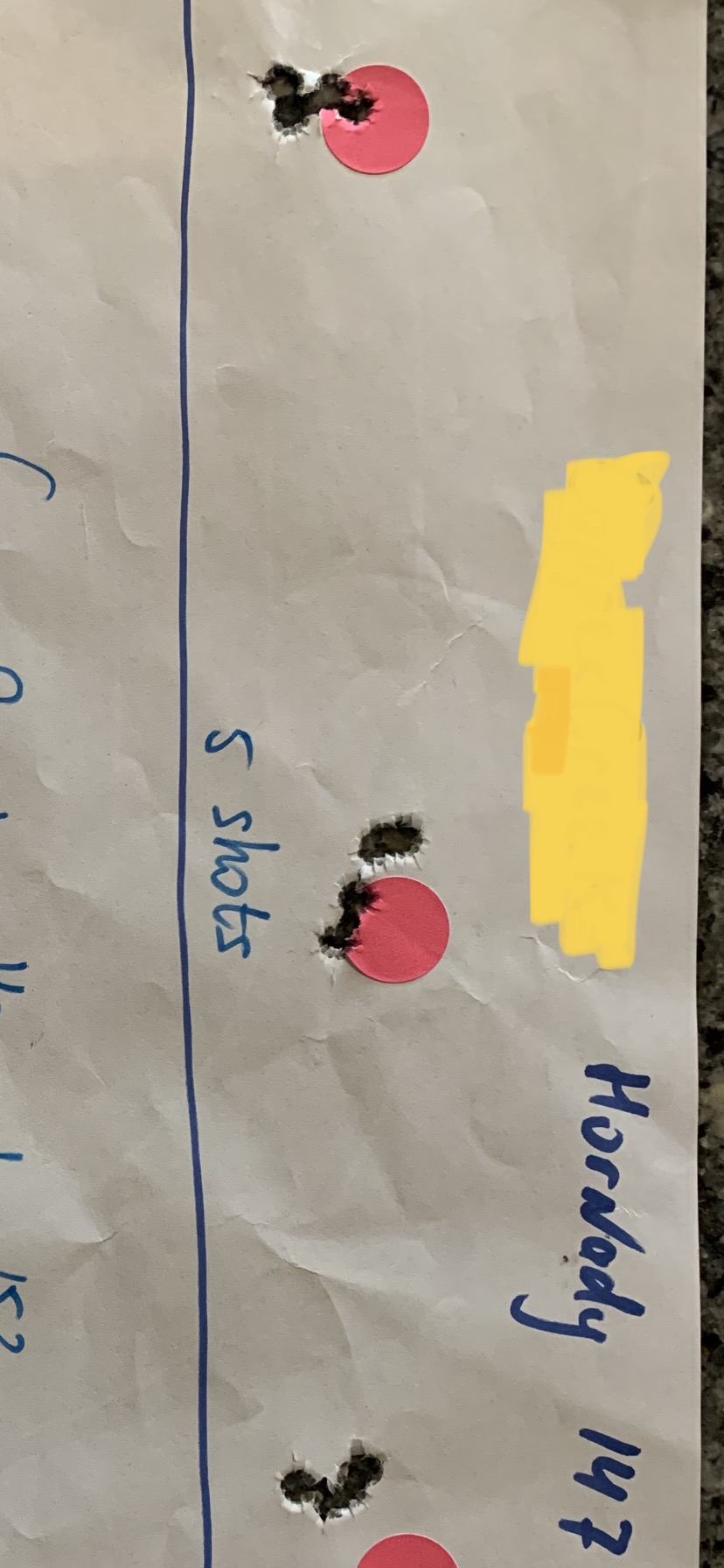

    As far as factory ammo, I remember that the original Sako barrel didn’t like the Hornady 140 ELD-M and Berger 140 hybrid. The best, consistent groups were with the Hornady 147 ELD-M.
