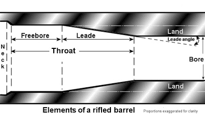

There are several different freebore specs for the 6.5CM other than SAAMI .199".

If I read the SAAMI 6.5 Creedmoor chamber drawing correctly, a factory chamber should have 0.1992" freebore (0.2645" dia.) and 0.162" leade. The two combined create the throat. These dimensions should be the minimum dimensions and maximum would be +0.015". Anything shorter would not meet SAAMI spec and would be considered a custom chamber. Unless the barrel maker specifies this fact it would open them to a liability as factory ammo either would not chamber or cause unsafe pressures.
If a reamer is worn then the leade taper could be larger and possibly explain the 0.050" difference in the two barrels.
Thats correct there are several shorter freebore specs optomized for specific factory ammo and a worn reamer could aslo cause issue or someone inadvertently using a different reamer.
In this case it is most likely poor QC or lack of it.
