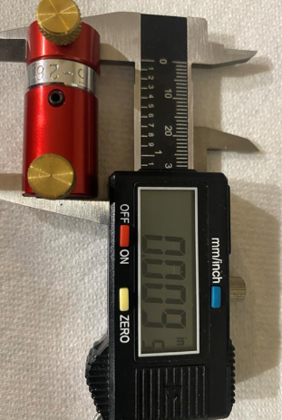

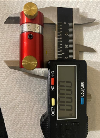

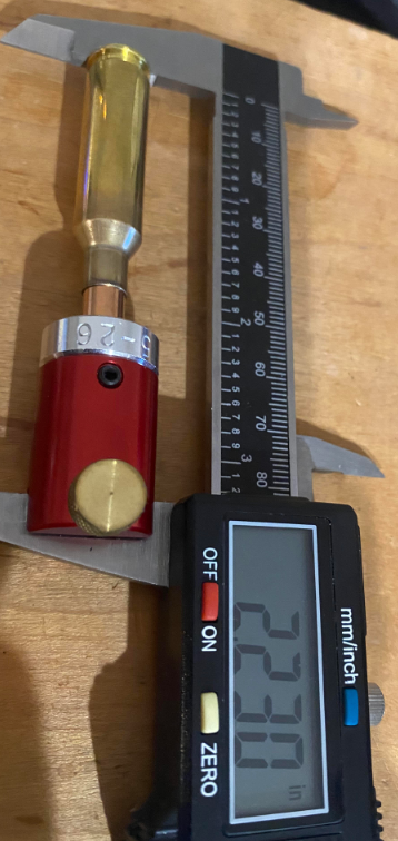

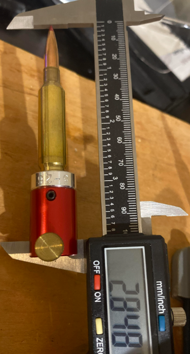

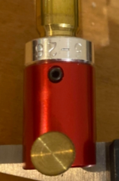

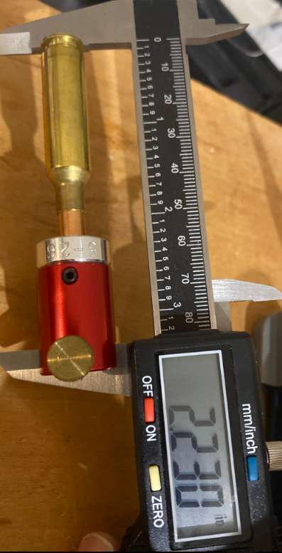

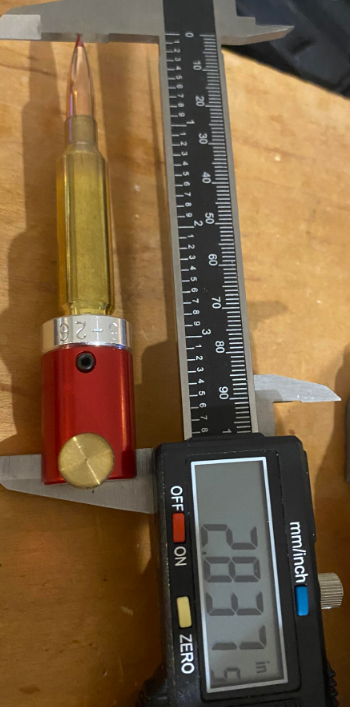

It was not the primers. They were all seated below flush. I have a feeling It is a measurement issue with the calipers and "base" that was being used. Just checked what I think may be the problem. Its the smaller anvil base.
Here it is installed
Here it is if I snug down on the thumb screw just a little more. It puts a slight cant on the anvil even with ample pressure trying to keep the pieces together.
  • Wow
Reactions: TheOfficeT-Rex
Has to be a measurement issue then.
If the bullets are consistent, then you should have an OAL similar when the BTO is similar.
So, has to be an issue with the measurement tools or the technique.
Reactions: CheapBasterd

I prefer to use only the piece that holds the comparator and use the caliper jaw at the base of the cartridge. I usually spin the cartridge some to be sure it is real flat on the caliper jaw. Then use consistent tension, as in very little, to measure where the bullet ogive is. My mentor when I started all of this many decades ago had me using sooted bullets to see that I was using consistent tension. If I pressed a little, there would be a little ring. If I pressed harder, I would leave a wider ring. The goal was to leave a very very small ring of disturbed soot.
By not using the other end of the comparator set, I am eliminating a piece that is held in place with a set screw and one source of induced error.
While it was entirely my carelessness not checking the caliper zero as I should have been. This small anvil is going to stay in the toolbox...I just messed with it a little, it has the thumb screw and bottom set screw. Too much room to change the zero on the calipers using either one. Thank you.
I get more consistent measurements without the anvil on the caliper. Just the comparator and the face of the caliper jaw. The anvil can get out of alignment or loosen and get moved around. I found it was more consistent without it.
Measure the oal without any attachment just using the calipers. Now that I see how your doing it, I believe this is a thing. I don’t even understand the purpose of the piece your using on the base.
The piece on the base is a Hornady comparator tool with a bullet insert. He's using it to measure both the BTO and the OAL. He just has the calipers zero'd on that base/comparator.
I agree though, I'd remove it and see how the OAL compares.

What are you trying to point out?
If the calipers are zero'd when closed onto that insert, it will measure the same.
Yes, I edited my post...I didn't read it the whole thread. That's on me.
If he's using them correctly, appears to be a caliper issue. As posted above, when measuring cbto no need to use any attachments.

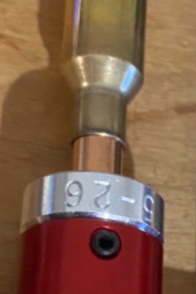

Personally, I'd also invest in a better set of calipers such as Mitutoyo.
Yeah I guess i misspoke. I don’t understand using it in that capacity. I use the exact one to measure the ogive.
I prefer to use the comparator to only measure to the ogive. I also use it so that the bullet is skyward. This prevents the bullet from being pulled into the comparator by gravity as I spin the cartridge base on the caliper jaw to be sure it is not cocked to one side as I gently press the cartridge up with the thumbwheel.
Except for the issue involving a cartridge being too long to feed from the magazine, the COAL doesn't even matter. That being said, again, I prefer to eliminate as many sources of induced error as possible. If I were to care about COAL, I would remove all attachments prior to measuring just to prevent any sort of induced error.
Calipers are not real expensive. I have several sets. Calipers are dedicated to the various comparator sets, a set for 6mm, a set for 7mm, a set for 30 cal, a set for 223 and a set for 338. Another for general measuring of stuff without any attachments. Same reason for having more than one set of micrometers.
I'd just be looking to see what the error in measurement is. As if it's happening here, it's happening somewhere else.
That's where my OCD would kick in. Because I'd want to make sure I'm getting the important measurements correct.

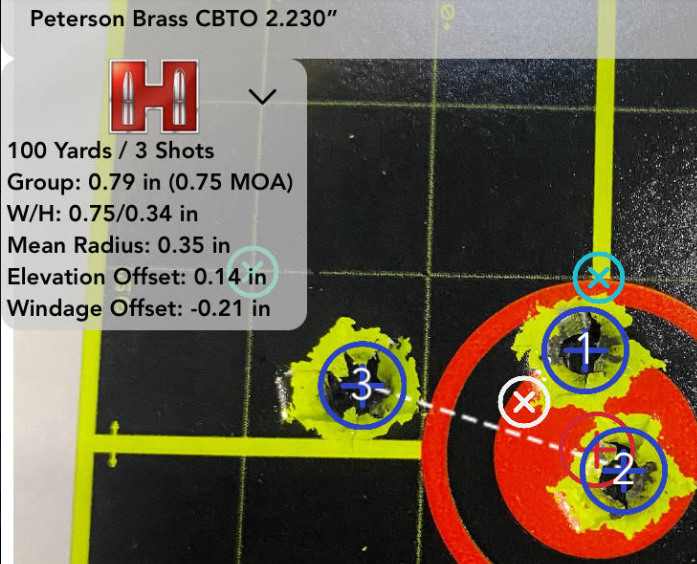

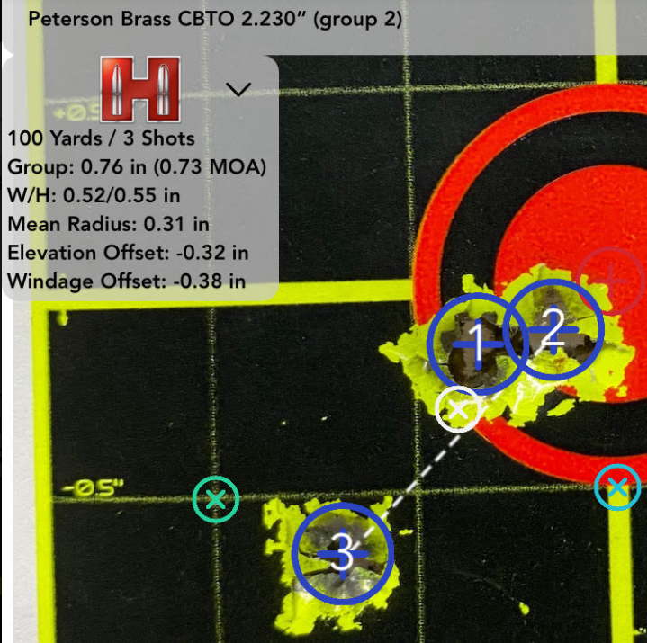

Well, I ended up putting that COL measurement tucked away in the back of my mind and focused on the consistent 2.230" CBTO. Maybe I'll pony up for some better calipers.

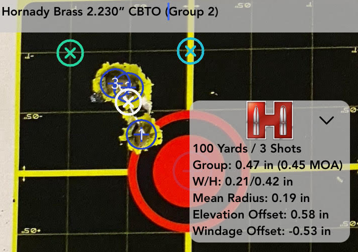

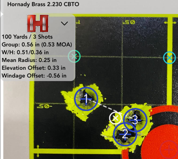

Hornady case with tighter groups.
