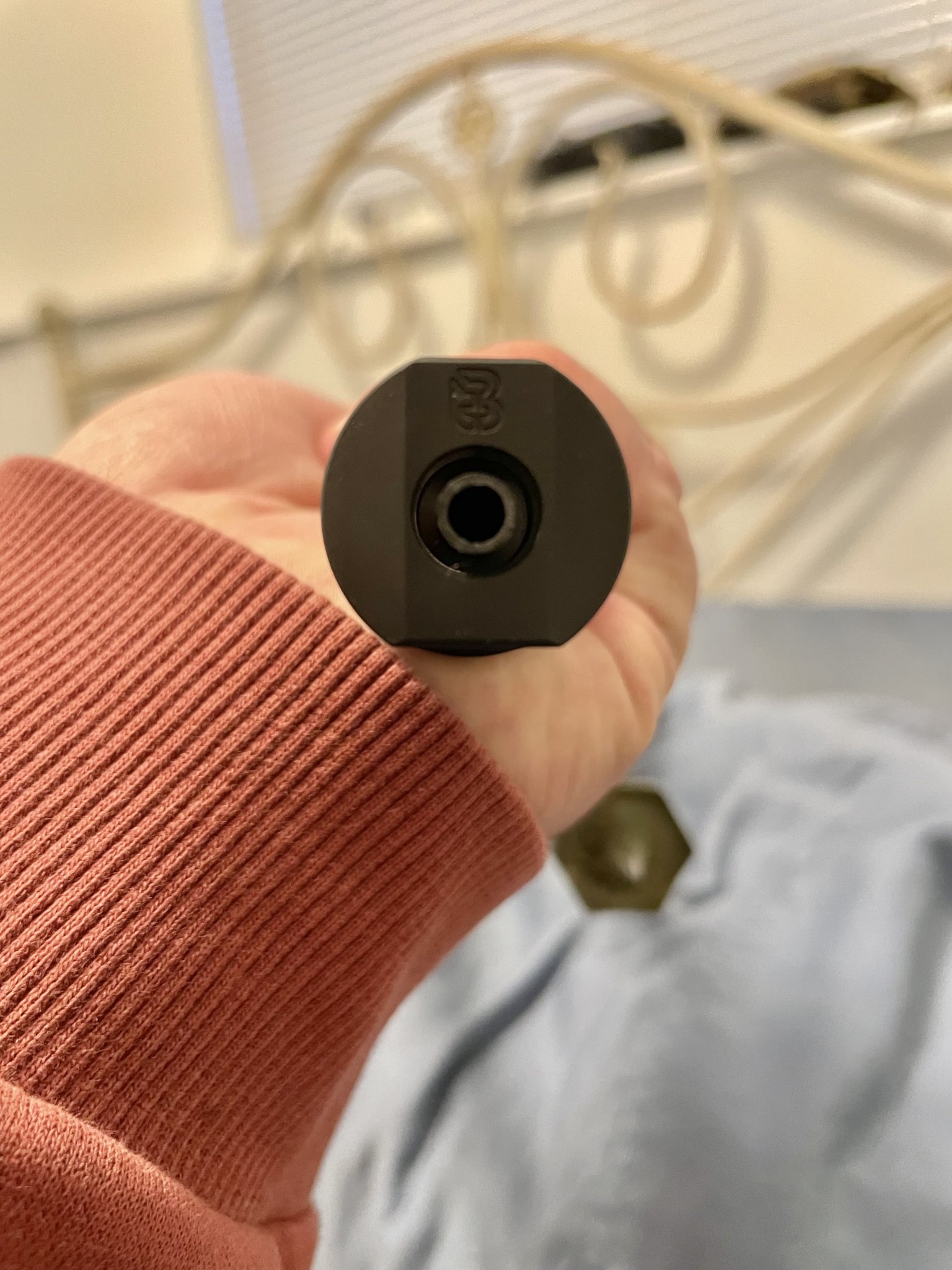

I just got a new Thunder Beast muzzle brake and it was so close to being perfect without shims that I decided to sand fit the back. I got it perfect. Now my question is in the future when I get a thunder beast suppressor should I replace this break with a new one? I barley sanded the back down. I only needed a couple of degrees to get it where I needed. I don’t know if this is the right way but off of a level surface the brake stayed perfect level (not leaning)
The thunder beast suppressors come with a free muzzle brake so maybe it’s worth having the new brake machined on a lathe to fit the barrel?
This is doable as long as you dont dont introduce misalignment by unevenly removing material off the back. The recommended method is to use peel washers or have the barrel machined. Your brake should have come with peel washers.

It came with peel washers but the brake was so close without is was hard to get a perfect torque alignment. I think when I get the actual suppressor I’ll just put on the new one that comes with it and use actual shims versus the peel washer
if he did some small finish sanding where the brake face was placed on a flat surface like a trued flat marble slab or something similar, i wouldnt see any issues with that. would be easy to be uniform. he will need to visually check alignment down the bore when the suppressor is screwed on.
Reactions: diderr
I’ll just either get a suppressor alignment rod or use a new MB with the suppressor. I won’t risk blowing up a $1400 suppressor
You do what you want but I don't think thats necessary. Visually check alignment down the bore. If you see something other than a circle of light then you can be concerned
Reactions: diderr
