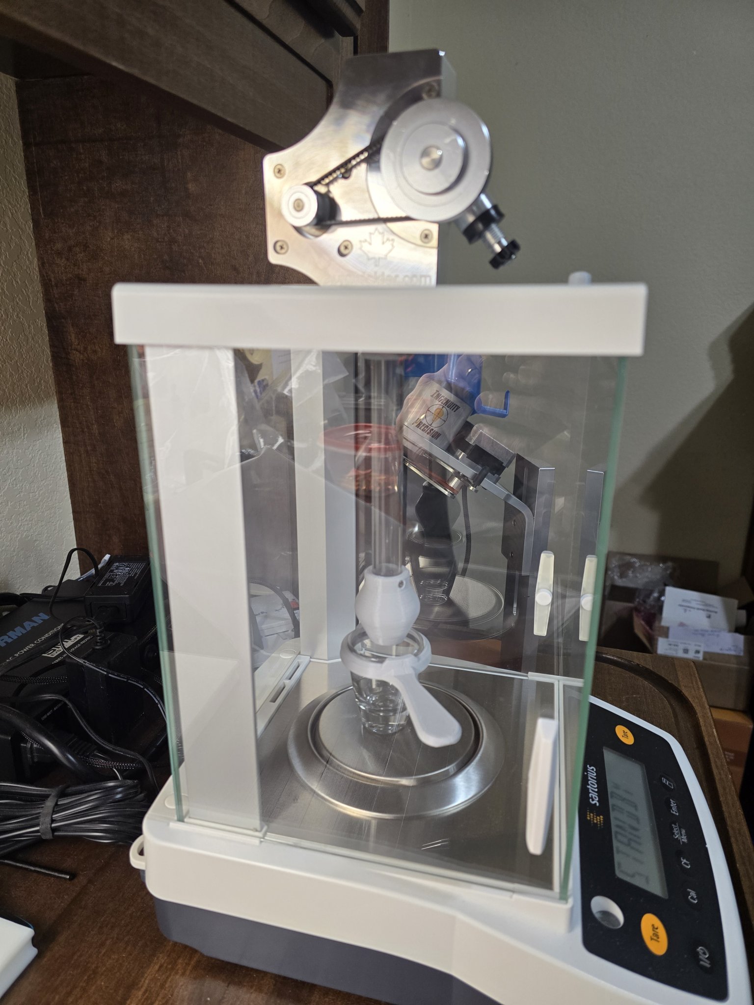

I have the Sartorius Entris 64-1S scale with The Ingenuity Trickler system. It works great. However, recently I started noticing my scale takes several minutes to stabilize once I turn it on. And then after using it and verifying after have loaded some cases it has changed again. Small amounts of drift such as 0.026 to 0.050 or so. About a kernel or so of weight drift. It's not much but up to now it has taken very little time to stabilize and then rarely moved after was tared. I don't have anything like a line conditioner or antistatic mat etc. Just plug in and go.
Any ideas what is happening? Do I need to change my setup such as line conditioner, surge protector etc? It is always been in a separate room in my house with climate control. I have changed nothing. Never did anything to scale either. Thanks for the help!

I actually reached out to Sartorius North America service. This was their reply....Try cleaning beneath the pan/pan support with a handheld vacuum to remove any dirt/debris that may have slipped into this area. If grains somehow slipped into the load cell, then this can cause drift.
Guess what....this fixed it! They had other suggestions but there must have been a kernel stuck under the platon. It has been flawless since.
When grains are dropped from the autotrickler it will get a kernel that bounces out of the pan once in a while and apparently one goes under the platon too

When grains are dropped from the autotrickler it will get a kernel that bounces out of the pan once in a while and apparently one goes under the platon tooView attachment 8586407
I don’t have an AT, but I thought I had read that their platen insert thing helps align the cup to the optimal position so the kernels don’t bounce out as easy. I think it’s not suppose to center on the nozzle?
