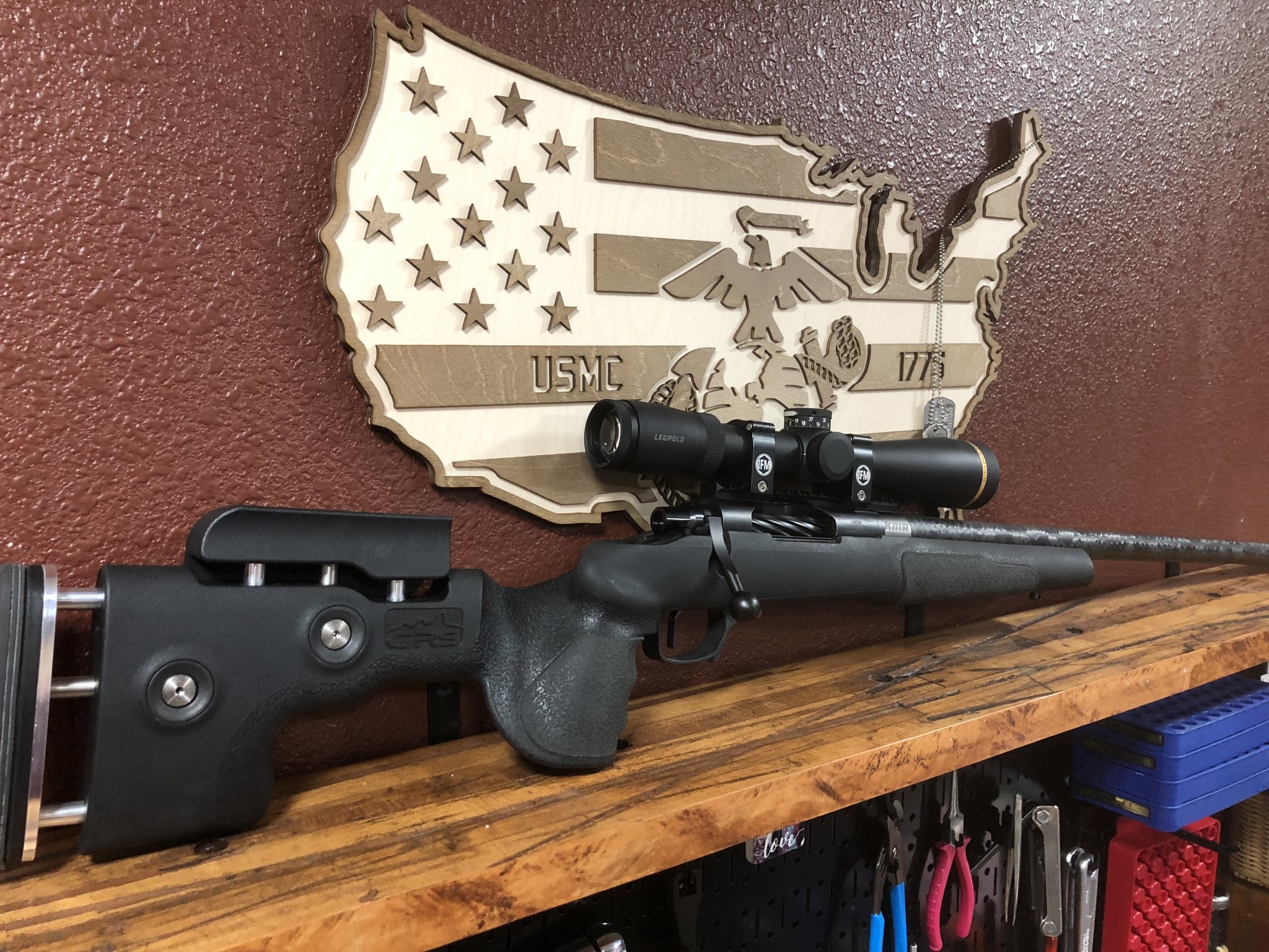

    I've got a 300 SAUM and my brother rocks the 7 SAUM. Both are excellent guns but the 300 bucks a bit more.
    Mine is in a model 7 and factory stock (I can't find a chassis) but it just got back from the gunsmith on getting threaded to run a brake - hoping it's a more enjoyable gun to shoot. It weights in at 7lbs13oz so it's light.
    Both our SAUMs have dropped plenty of deer in their tracks and my 300 is also my elk rifle.
