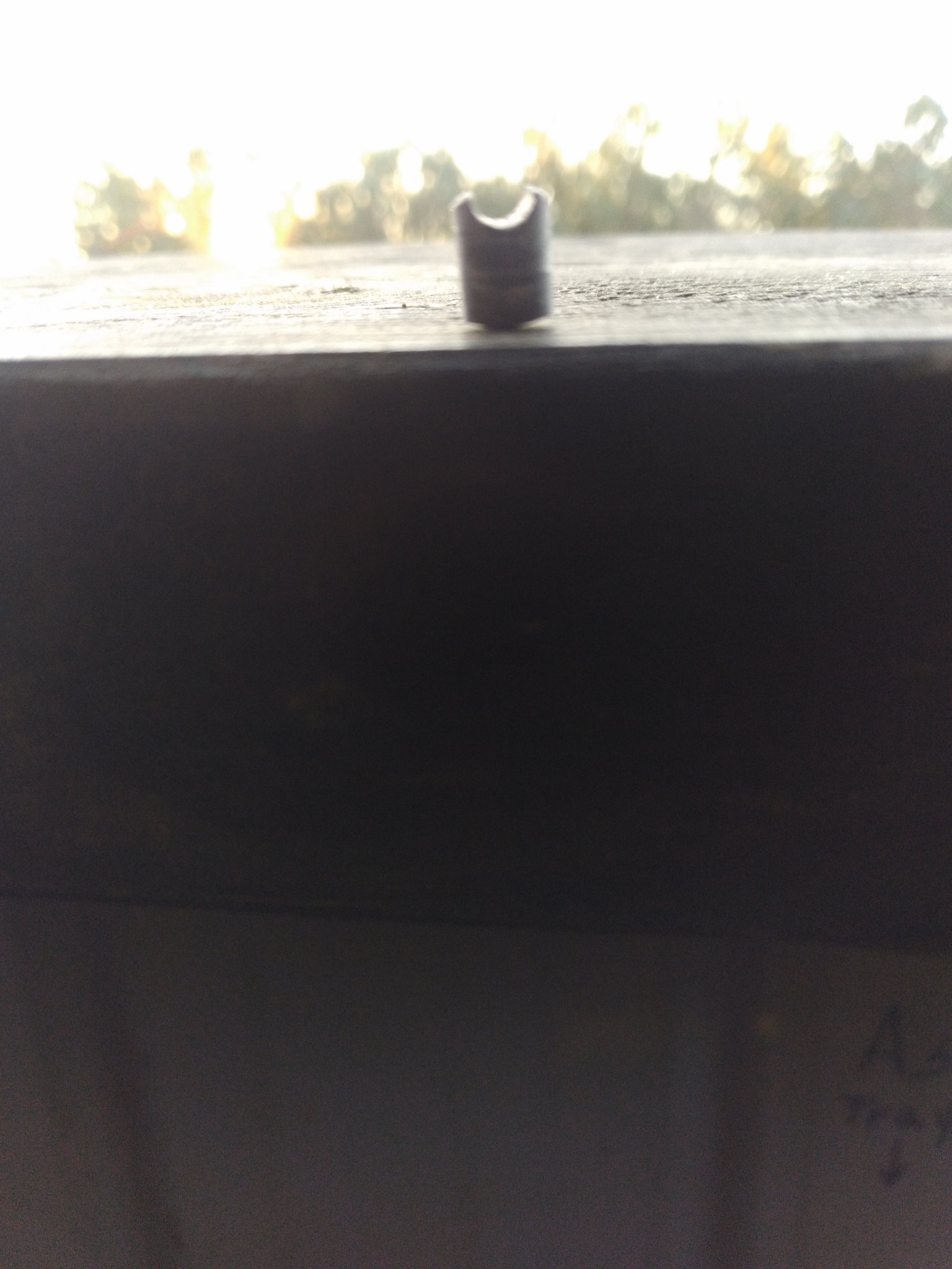

My buddy just sent me a picture of a broken bolt from his 270. Is that a common or rare occurrence? I told him to check with Savage 1st. I know he's had that rifle 25 years, it has notches cut all down it, for all the deer harvested with it.

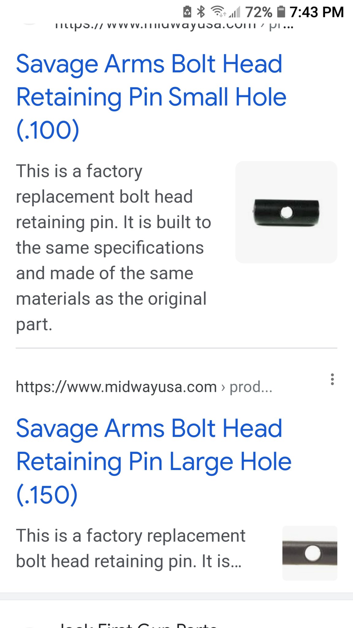

Google shows two savage style retaining pins, a .150 and a newer .100
I do t know but it seems like the new small hole may not fit an older larger lin u less they just designed a whole lot of extra space around it that they later deemed unnecessary. I’d measure my pin first to make sure it fits the hole.
He said 1999, so right on the cusp, he did also say pre-accutrigger. He's measuring right now.Man, that's pretty skinny.
The firing pin looks to be over .100 where it passes through the retaining pin.
I wonder what they changed to make them that small?
(Diameter, don't say it)
I'm gonna have to look at a newer Salvage.
For the OP, if his rifle is 20-ish + years old, it's probably the .243 diameter.
Have your buddy give it a quick measurement to be sure.
