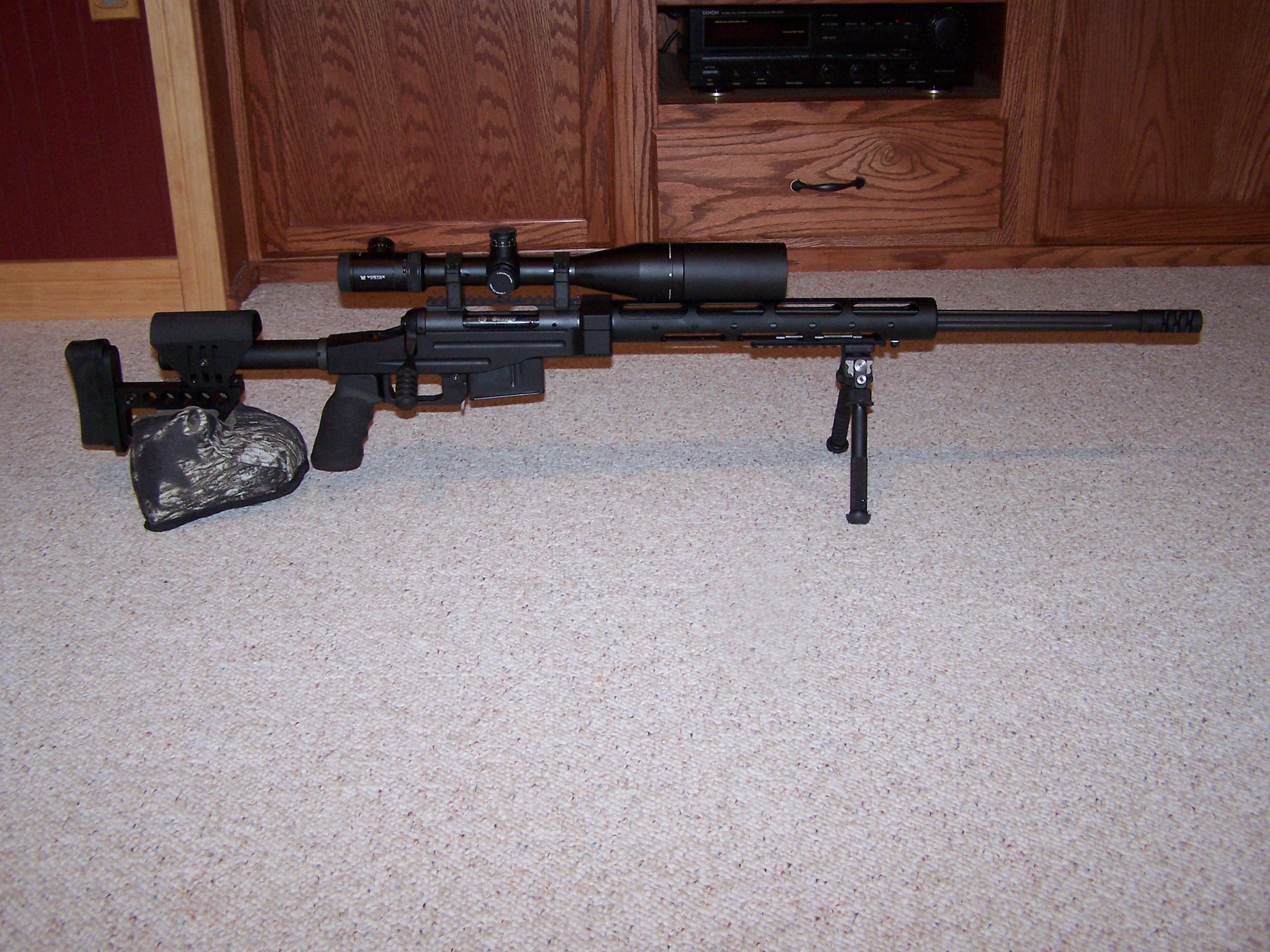

I will try and post a picture tonight. It is the evolution chassis w tactical buttstock. Abput$800 if I remember correctly. Don't worry about redneck he hates everything savage. By the way I have several of both and the fcpk is my favorite. They have been discontinued so there may not be a lot left out there. Sorry if I missed the 11 being a side release. I thought just a few of the 10's were bottom release.

Here is a pic of the FCP-K in the XLR chassis. Yes it is a 4.4 spacing as are all the modern 10's 11's etc. I have really enjoyed this rifle and it has been a hammer since I bought it. Mostly factory loads of 168 SMK's and 175's.

Does the XLR chassis make a difference. I've been looking at it too for my 11VT.
I only shot mine briefly with the accustock and the groups did tighten up afterwords but I think it was primarily that I felt way more comfortable behind the rifle. The XLR fits me perfectly. I would suggest getting behind some different chassis' and high end stocks to find what feels best to you. Kyle was really great to deal with as well.
Very nice looking rifle. Are there any other stocks you know would fit without any alterations? Also are you familiar with the RemAge barrel? I am looking at that option as well
Most any chassis will make a difference. The stiffness of the platform is hard to beat, but the looks might not be for everyone. Weight can also be a consideration.
I believe KRG and McCree along with the new AICS will work with the bottom release, you would need to check. Manners and McMillan will also fit you may need bottom metal as well, not sure if the manners mini chassis will work with the bottom release. As far as RemAge you would be better off to get a Shillen DGR reciever that will accept the savage prefits. It has a savage bolt (PTG) remington footprint and will work with standard savage small shank prefit barrels and nuts. That reciever will cost you as much as the whole FCP-k

Cool..... Weight is not an issue but how it performs is what matters. Plus I dig the look of the xlr too.
