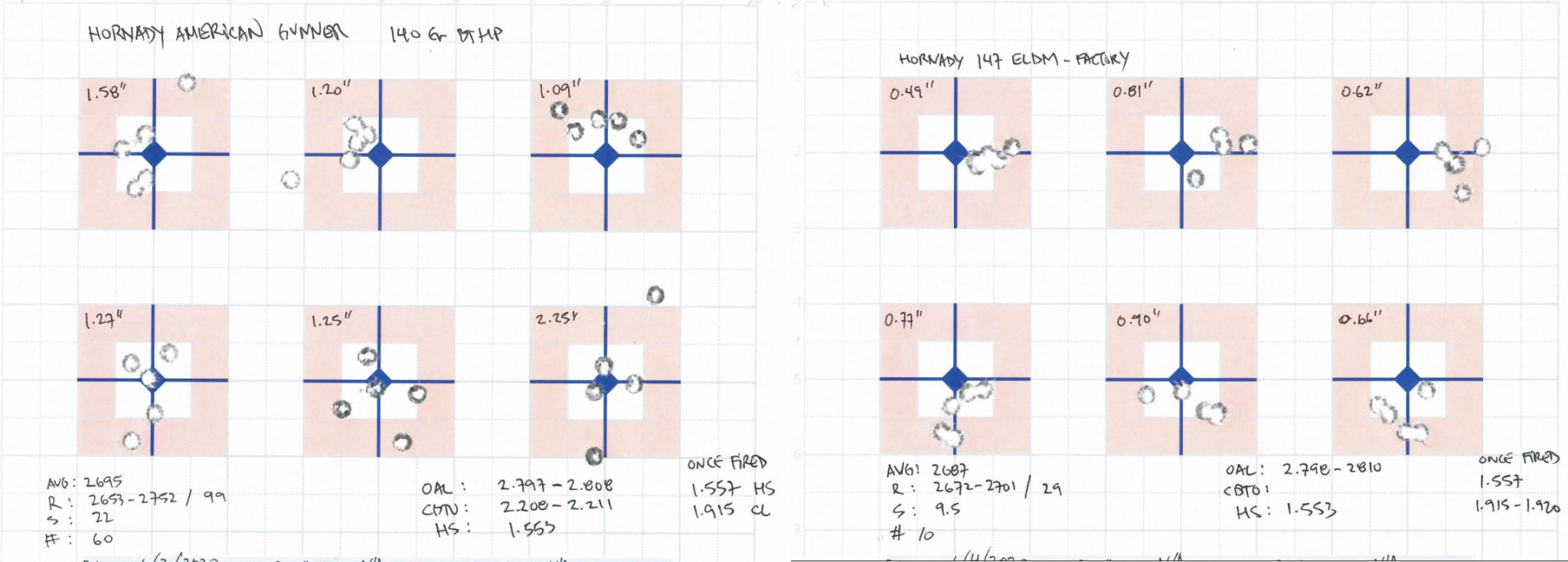

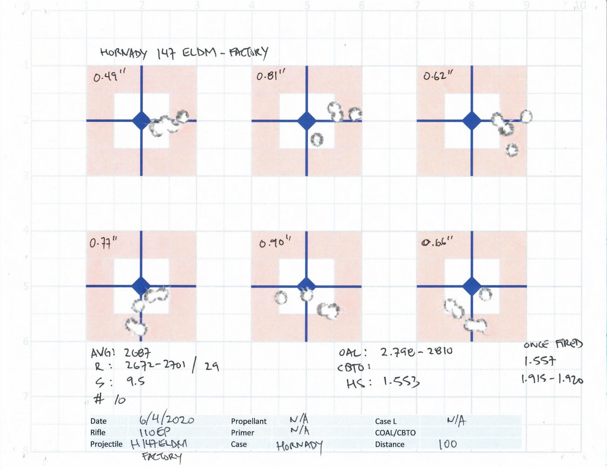

Results at 100 yards using factory and hand loaded ammunition.

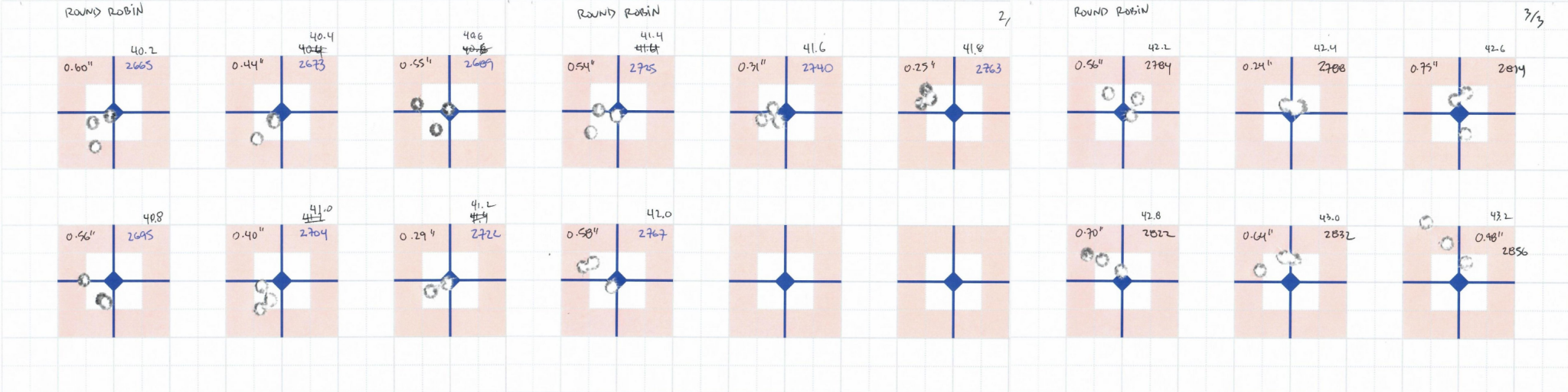

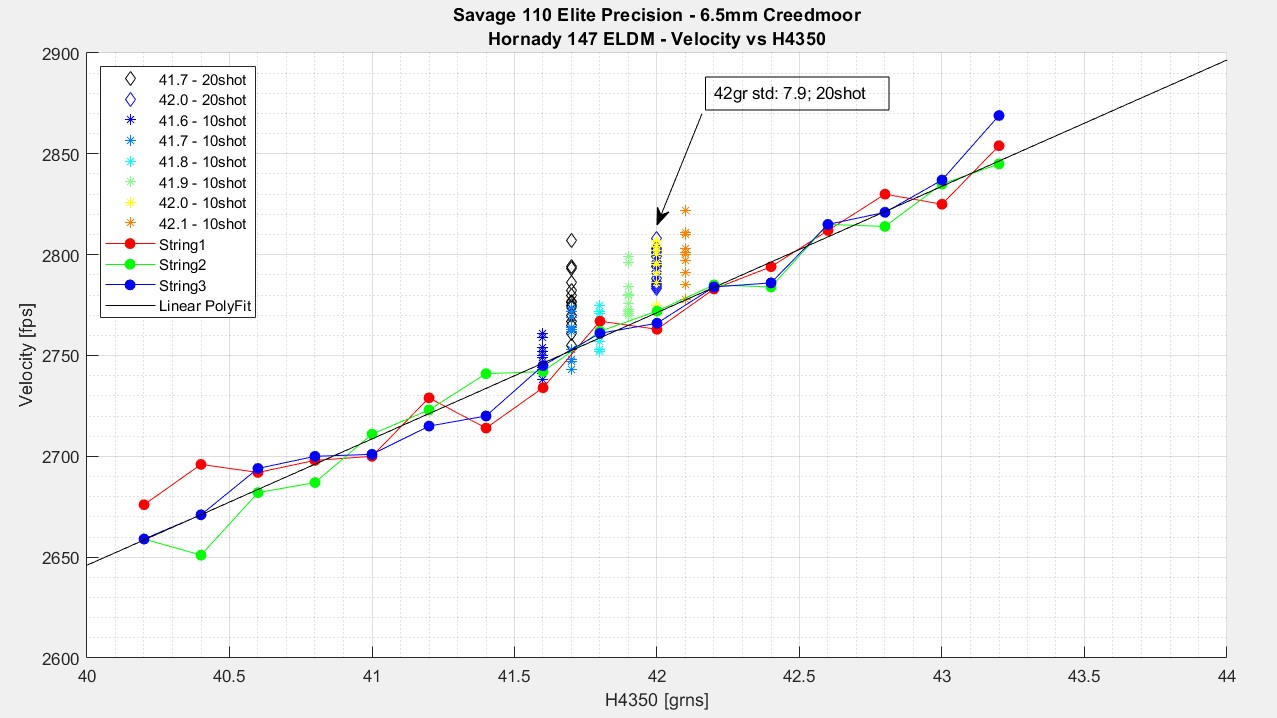

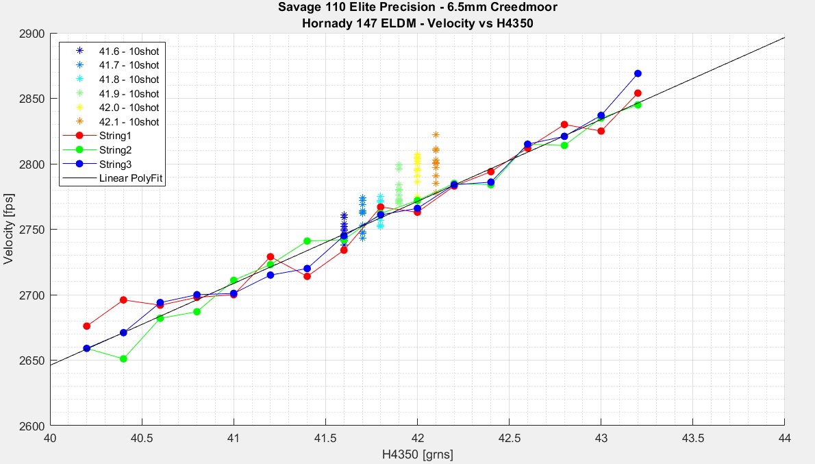

3 string round robin (16 shots), 40.2 through 43.2 grains H4350 and H 147 ELDM, ~0.020 off the lands

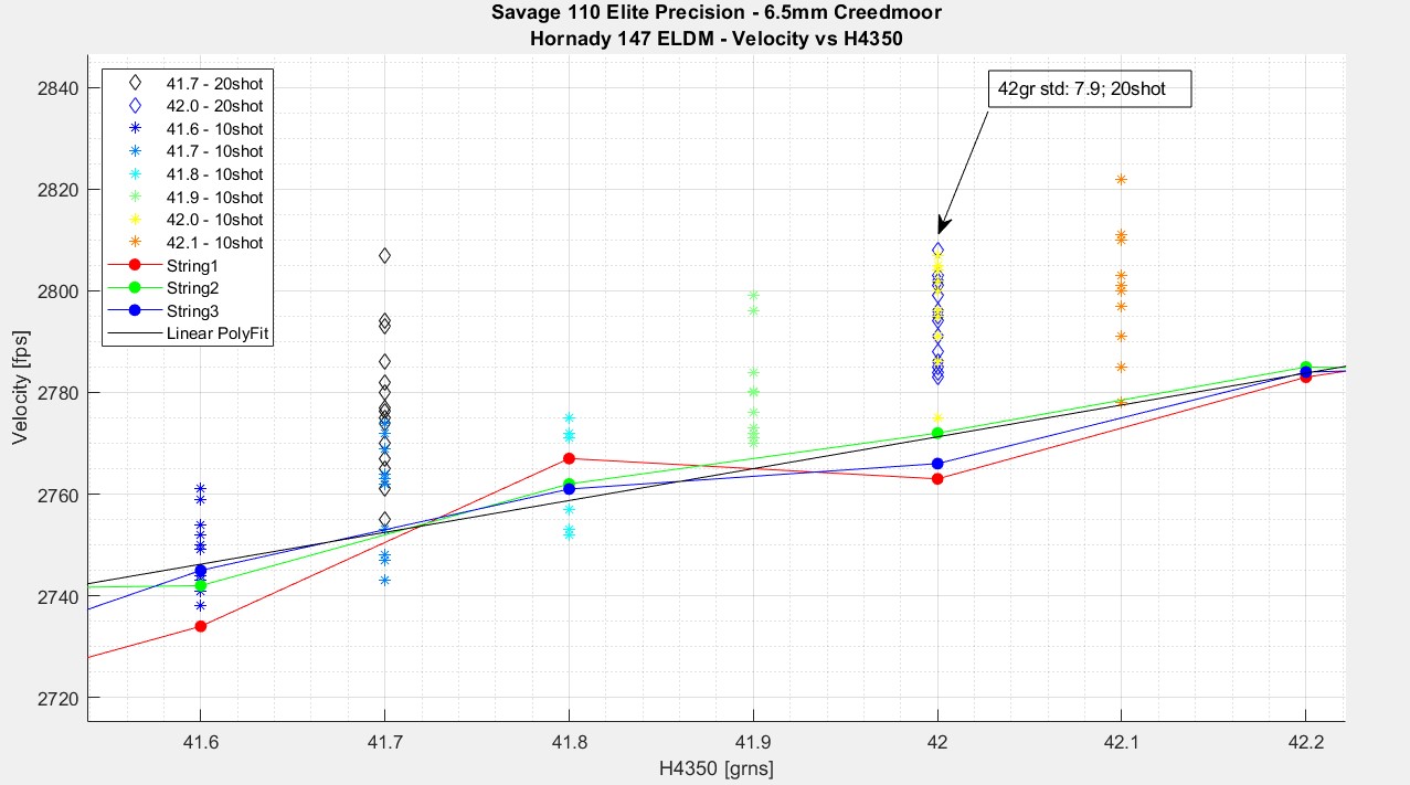

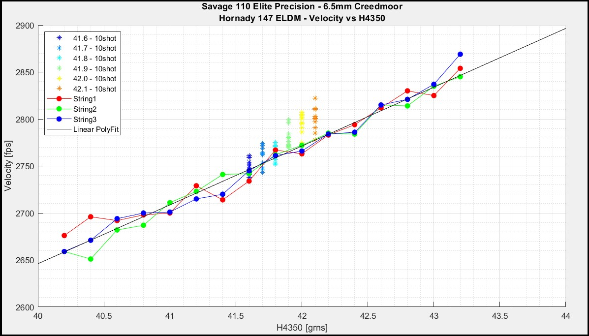

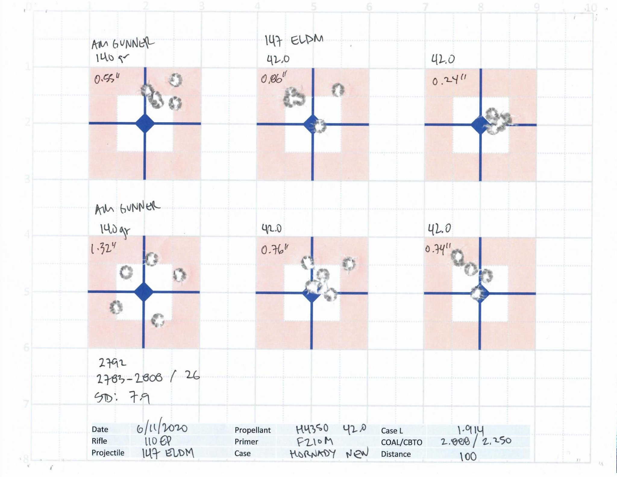

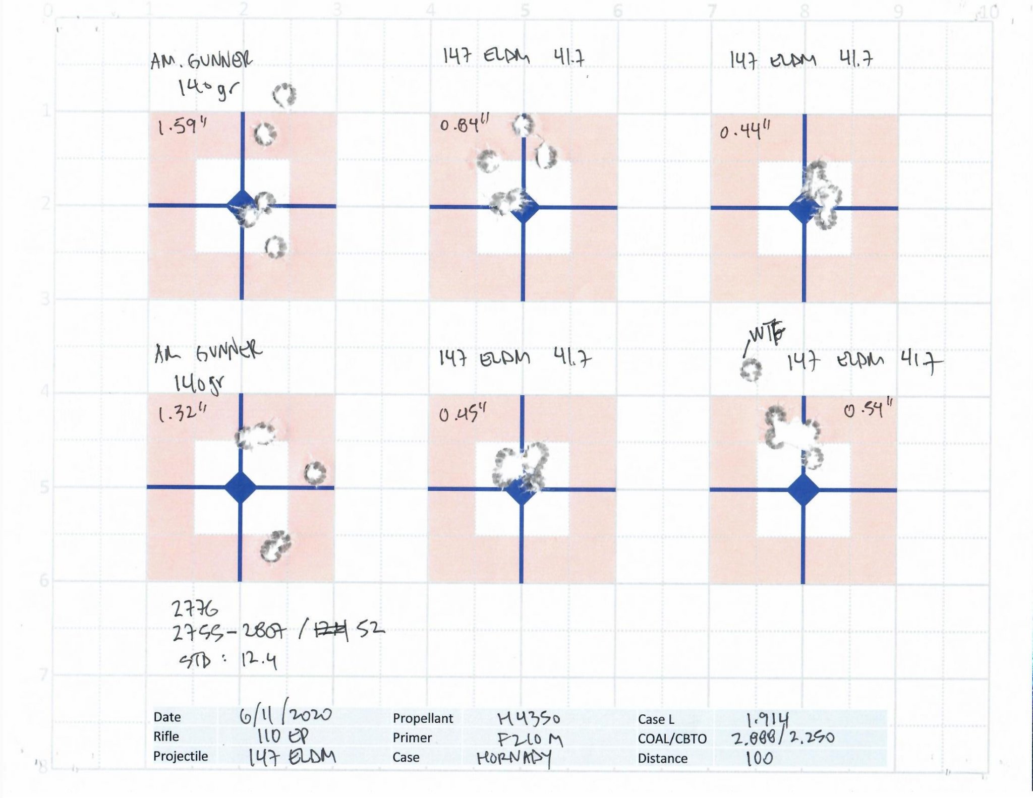

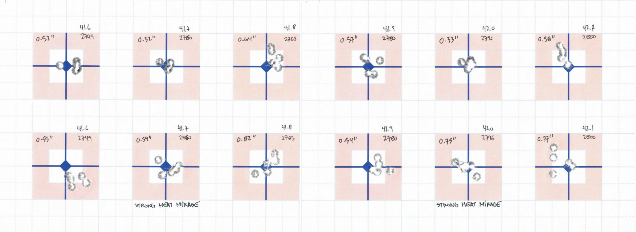

Tried a few more 5-shot groups with 41.7 and 42.0 grains of H4350.
With 42.0 grains, velocity appears to have increased ~25fps from the original 3 strings.
Using new brass with 42.0 grains, had difficulty seating bullets (although I did chamfer the ID on the cases). Many bullets had bad galling and the force required to seat the bullets was noticeable higher than using once fired brass. I didn't expect good results because of that so planning to try 42 again. I did manage 1 group at ~0.25". Also 42 grains has the lowest STD of all the charges tried at 7.9 fps with 20 shots.

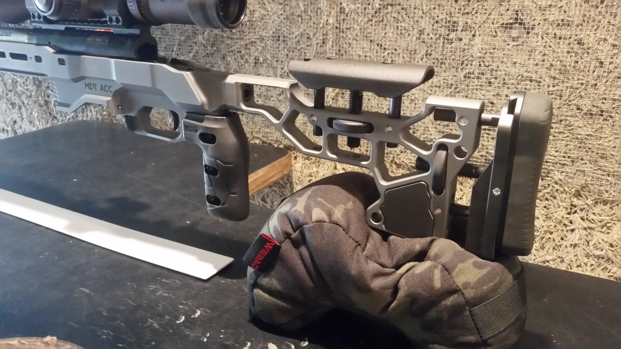

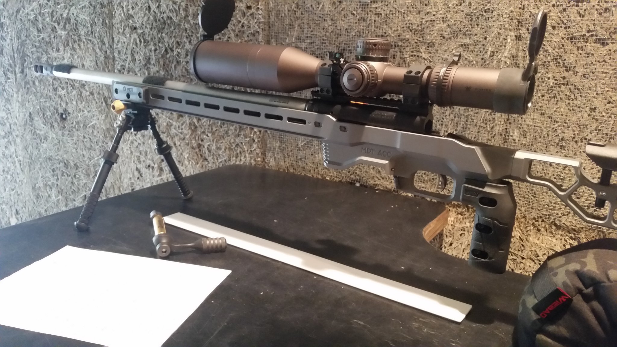

All the groups were shot with a front bipod and a Wiebad mini fortune cookie back rest. I blame a lot of the shot variation to my inability to stabilize the back rest. Not sure how people shoot so well with bags. For me, this doesn't work well compared to a traditional bottom sloped stock which makes it easier to slide forth and back and lock in the elevation.
Please see the other thread regarding the feeding problem:
I really like the MDT ACC chassis and having the ability to add/remove weights. My rifle is currently ~21 lbs and can lower back down to ~14-15 lbs in a few minutes. The stock adjustments starting shifting around so I added set screws and removed the thumb knobs; I set it and forget it. The chassis feels very good to me. I wish the bottom of the buttstock was slanted like a traditional stock for easier elevation adjustment on a rear sandbag/support.
Had extractor problems and added the tactical works extractor kit.
That worked for a while but I still have issues with extracting once in a while. I also shoot a savge12FTR that has never had any feeding or extracting issues; so this is incredibly disappointing. I guess savage is notorious for bad extractor design.
Other than that, it's a good (not great) rifle for the price point it's at.

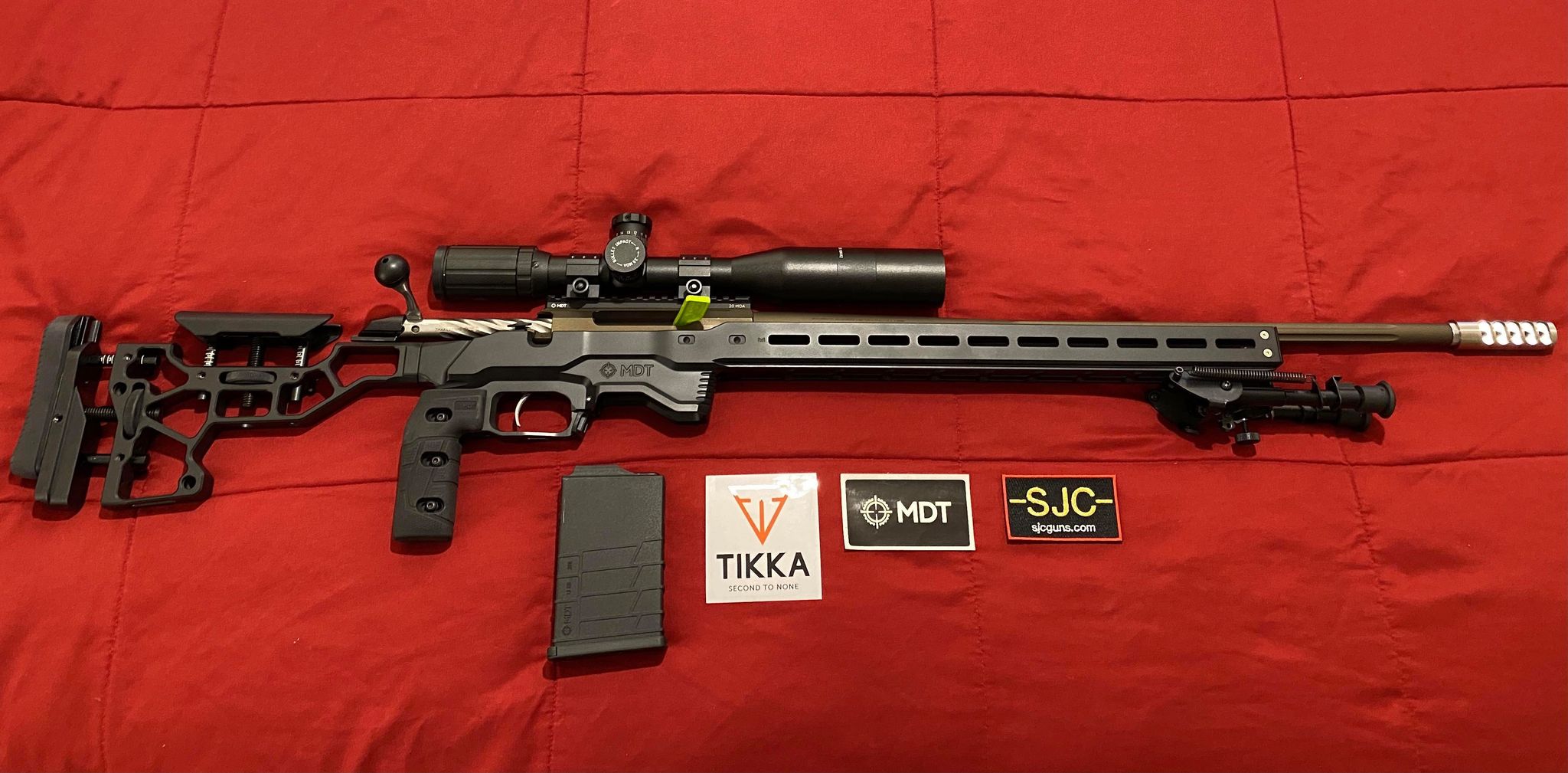

I bought one, and then found out that the options are really send it back to them and they will rebarrel it for are around $500 I believe there were no real pre-fit options out there I could find, (Why I returned it) so you are down to buy the barrel that you want, and then send it to a gunsmith with the action for them to turn a blank and install/true/headspace it for you.
I ended up going with a Tikka T3x lite, pulled the action and dropped it in a MDT ACC Chassis as I really wanted that all along, I just received a Proof 29" .264 Heavy Palma blank I am having installed on the Tikka action.
