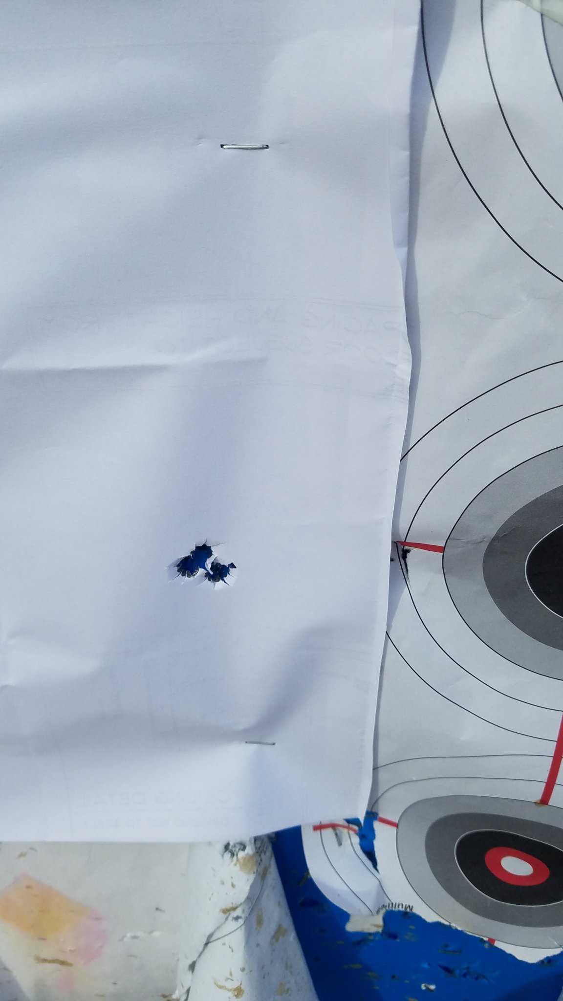

Start your rifle off with Remington primers they are smaller diameter and will show primer pocket expansion quicker I would load all virgin brass with H4831 9 1/2 primers and test for seating depth while breaking in the barrel and fireforming the brass to your gun. On the second firing 210m or BR2 do a ladder test for ocw and you will have already tested seating so your good. I'm just touching the 195tmk's in the 308 and they shoot bugholes. This is 300 yds 3 shots just after Christmas. This shoots 1 mil left of my 168/175 handloads and FGGM. Once I shot the first one I just held the same poa for the group. Our range went cold for about 20 minutes by then I had about an hour to get 2 rifles through some load testing and didn't finish the 5. I most likely would have dropped one out but the gun really likes this bullet and it was an easy tune to get to shoot.
