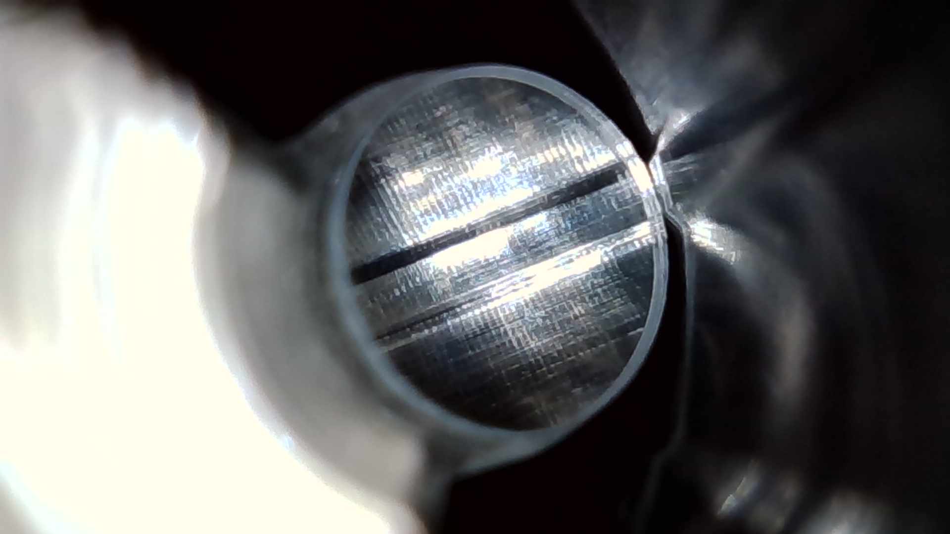

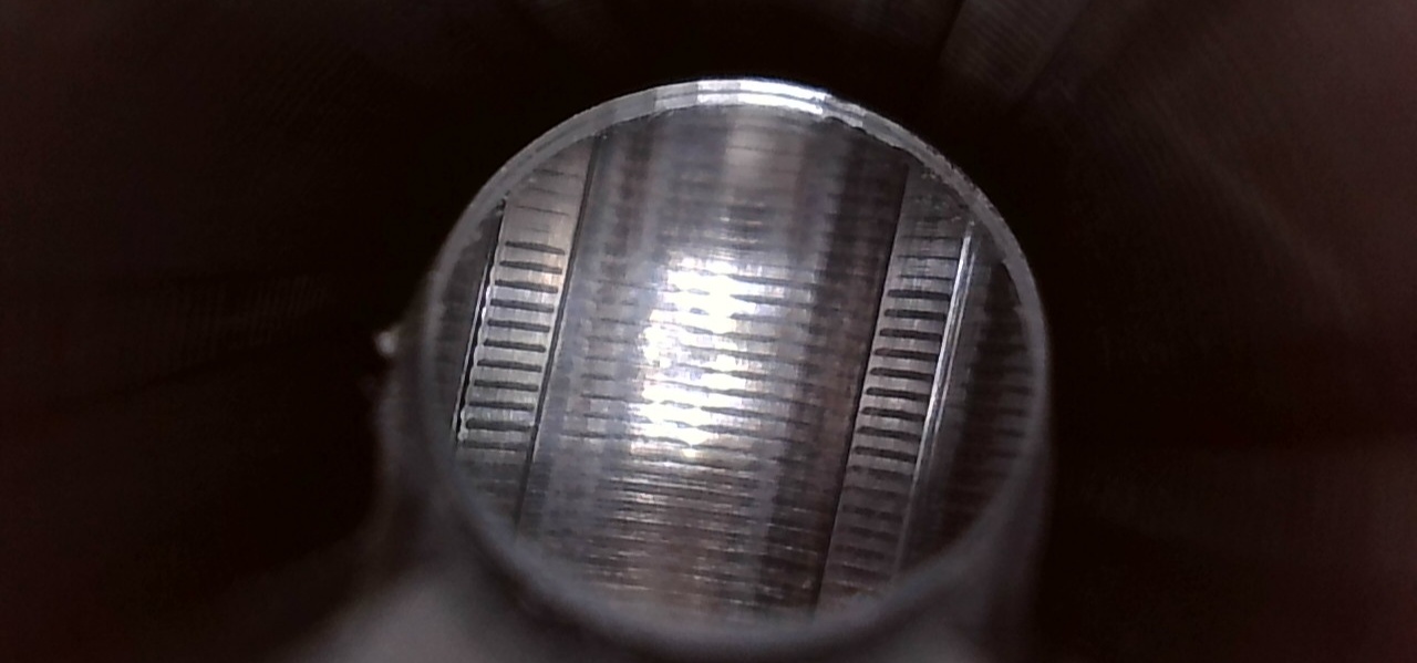

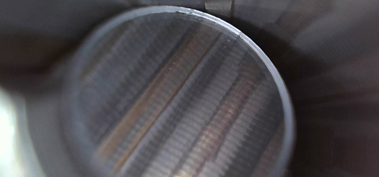

I purchased a Savage 110 Tactical chambered in 308 little over a year and a half ago and I have never seen a worse Barrel in my life.
Looks like train tracks running through the bore. deep and consistent pretty much from chamber to muzzle.
I don't know what kind of voodoo Savage does with these barrels because even though it looks horrible I'm pretty consistently shooting one Moa.

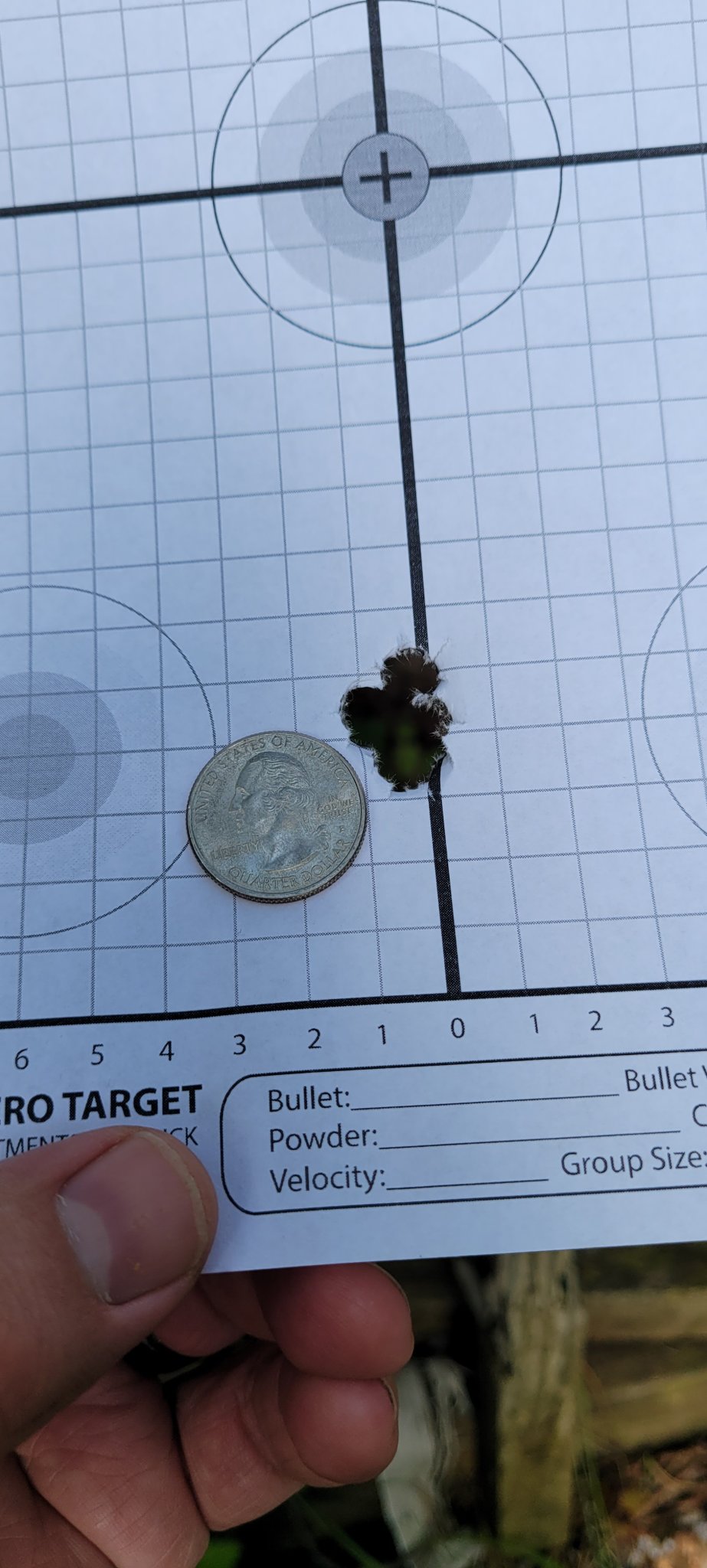

As you can see it grabs a hold of the copper pretty good lol but somehow manages to shoot great has anyone else had this kind of experience with Savage I actually had my first Barrel replaced from them on this gun because I thought it looked so bad but whenever they sent me the new one back it looked even worse but somehow shot even better.
Five shot groups like this aren't all that uncommon.

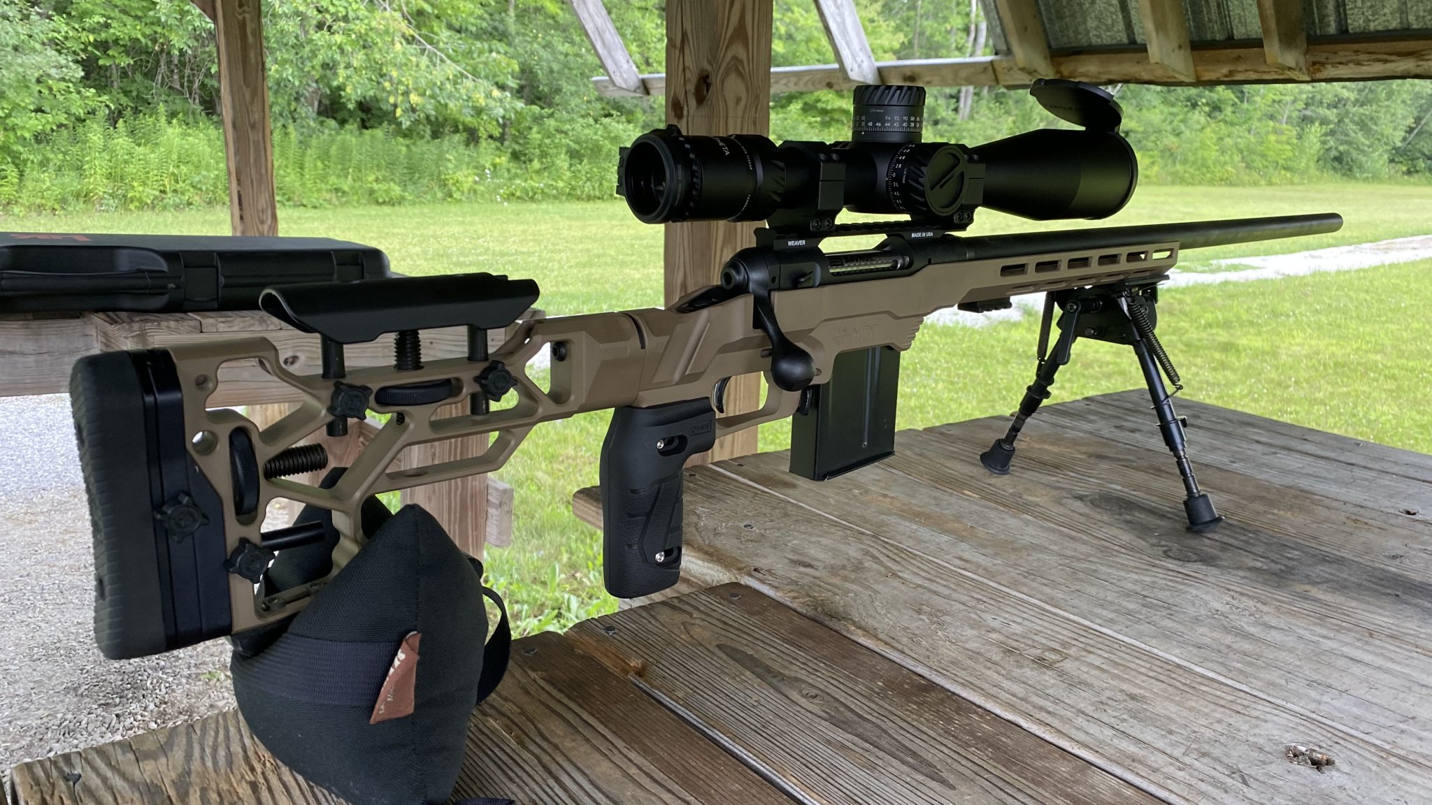

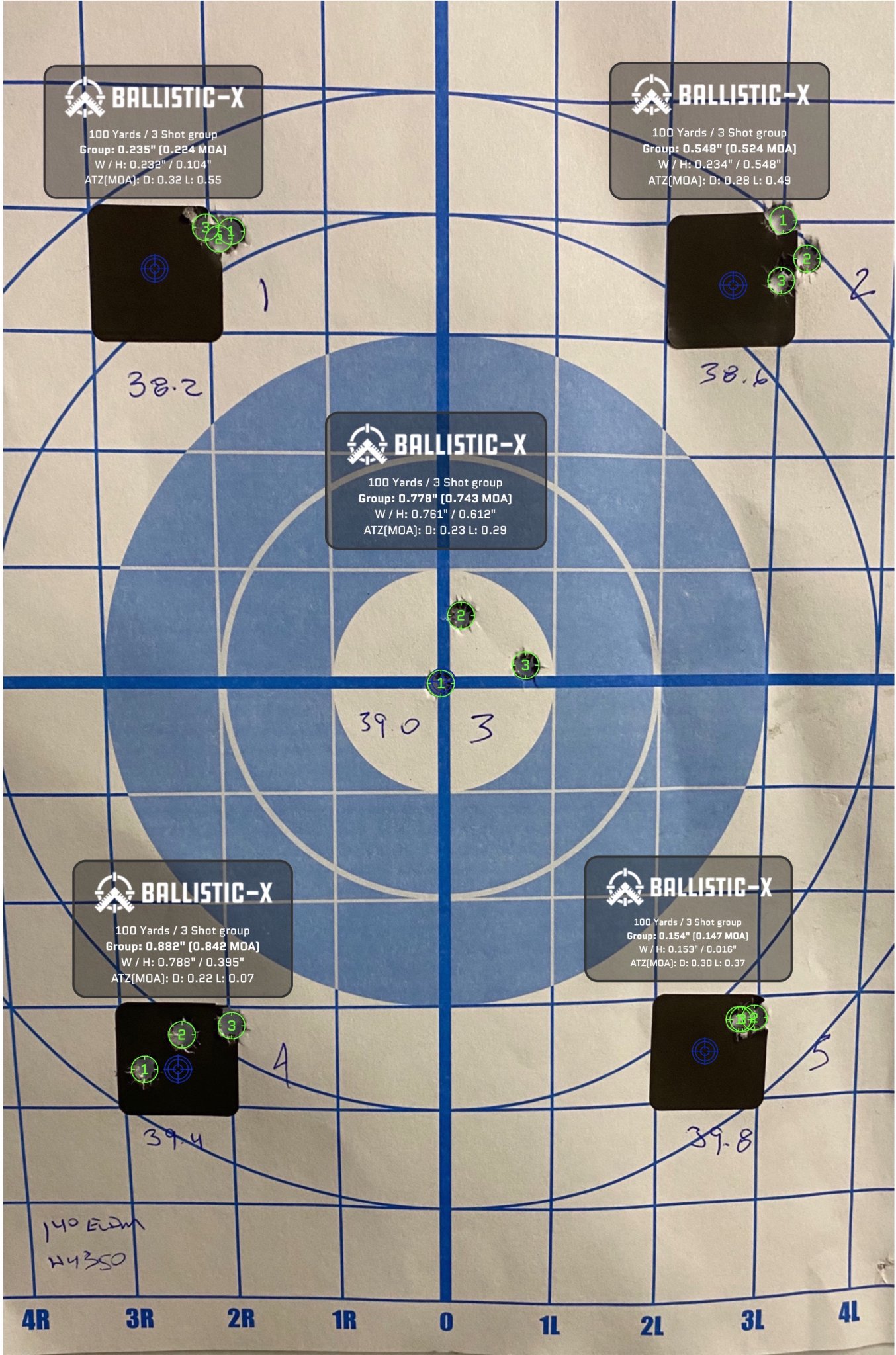

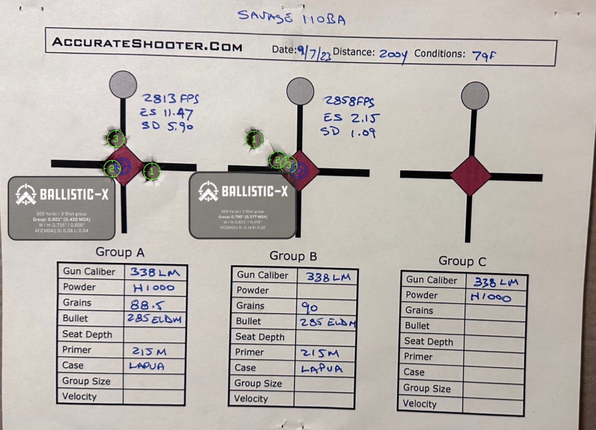

I have 7 savage rifles including a 110BA in 338 LM and 2 10BA’s

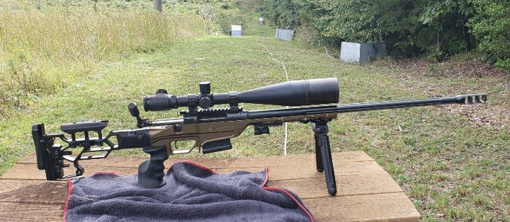

This is a 12FV 6.5 Creedmoor in an MDT LSS-XL Gen 2 chassis.
I shot this target 2 weekends ago.
102y from a bench with a bipod and rear bag.
All 5 shot groups.
This is my low node 2668 fps.
39.8gr H4350 under a 140gr ELD-M in Lapua brass and a BR-4.
This was the load development target for this rifle it was shot in 0°F weather on New Years Eve 2021.
Ballistic-X-Export-2022-08-04 11:31:40.479494.jpg

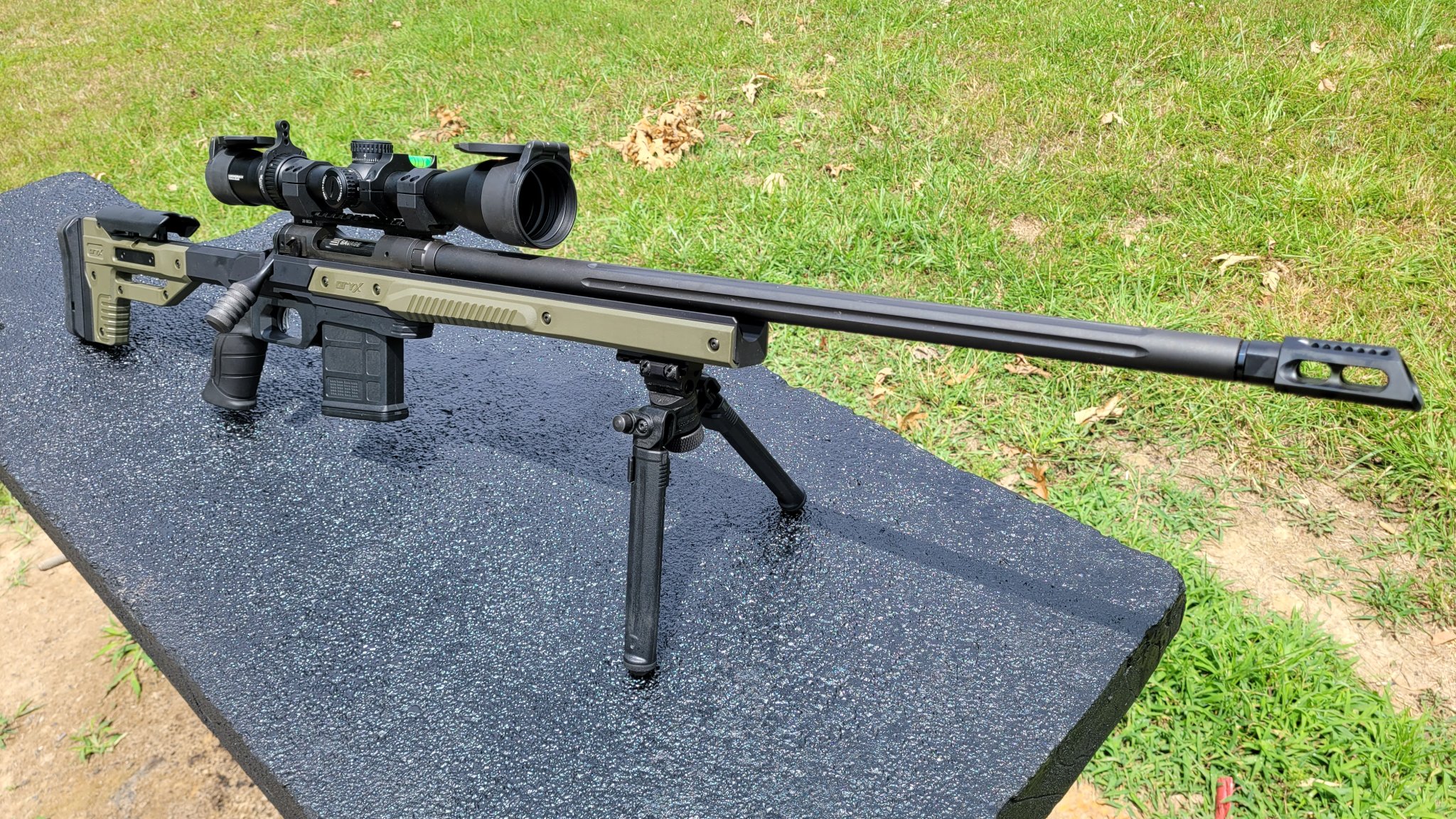

The 110BA in .338LM isn’t too shabby either.
Ballistic-X-Export-2023-09-15 20:28:51.840767.jpg
All 5 shot groups.
View attachment 8522486View attachment 8522487

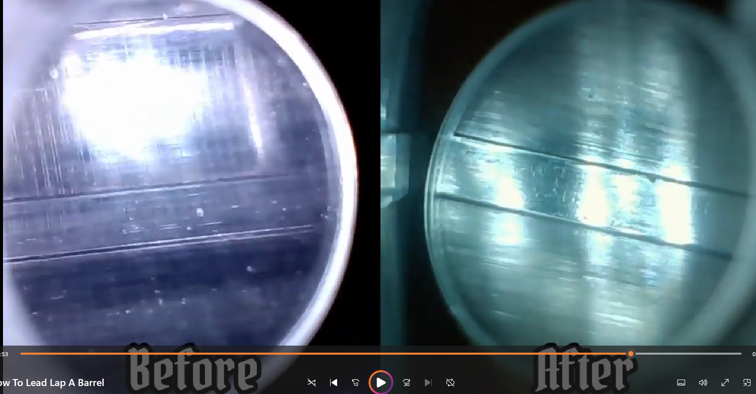

That is from the rifling process and shows up more than likely when the stock is on the gun drill, one person in here mentioned button rifling, however, I have button rifled more barrels than I can count. I have never seen a rifling button create such an artifact, but not to say that cant happen. The scope you have can take a small scratch and make it look like a crushed 18-wheeler. They magnify a lot and make it look alarming.
Based on the groups you are getting I would not fool with it, keep it properly fowled with copper and when it gets excessive, remove it, rinse and repeat. Years ago I had a customer bring me a REM 770 barrel that looked the exact same way. However, it was about a 6-8 MOA rifle from previous damage done from another owner and the fact it was a 770. I lead lapped the bore by hand, going from 120gr up to 1200gr and then polished it with flits for several hours. Here is a grainy image, I had to screen shot it from a vidoe. Brought the rifle to 1 MOA after the fact, however, in my opinion, your rifle is doing fine.
That caterpillar track pattern is from button rifling over the reamer marks, no lapping done after the reaming. You could try fire lapping using Tubbs Final Finish bullets (embedded with lapping compound) or a similar system to iron those marks down, may or may not help, results can vary.
By the way, those marks are directional, that is they should be ironed from the chamber to muzzle end. Get it turned around and the bore turns into a file. Happened occasionally many years ago with some replacement barrels where someone didn't fully understand when spinning up a barrel. It would about peel the jacket off. Not an issue with better aftermarket barrels which are lapped after reaming, cut or button rifled.
