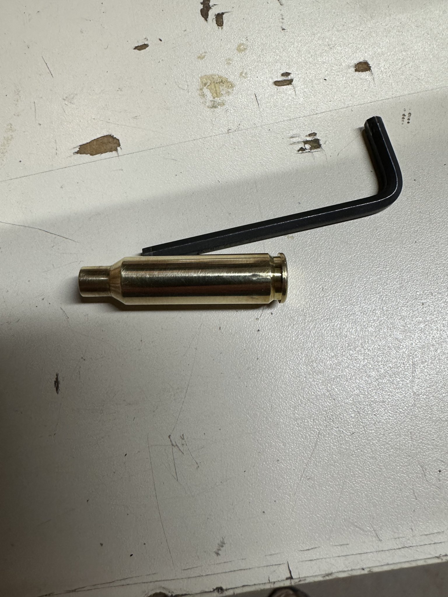

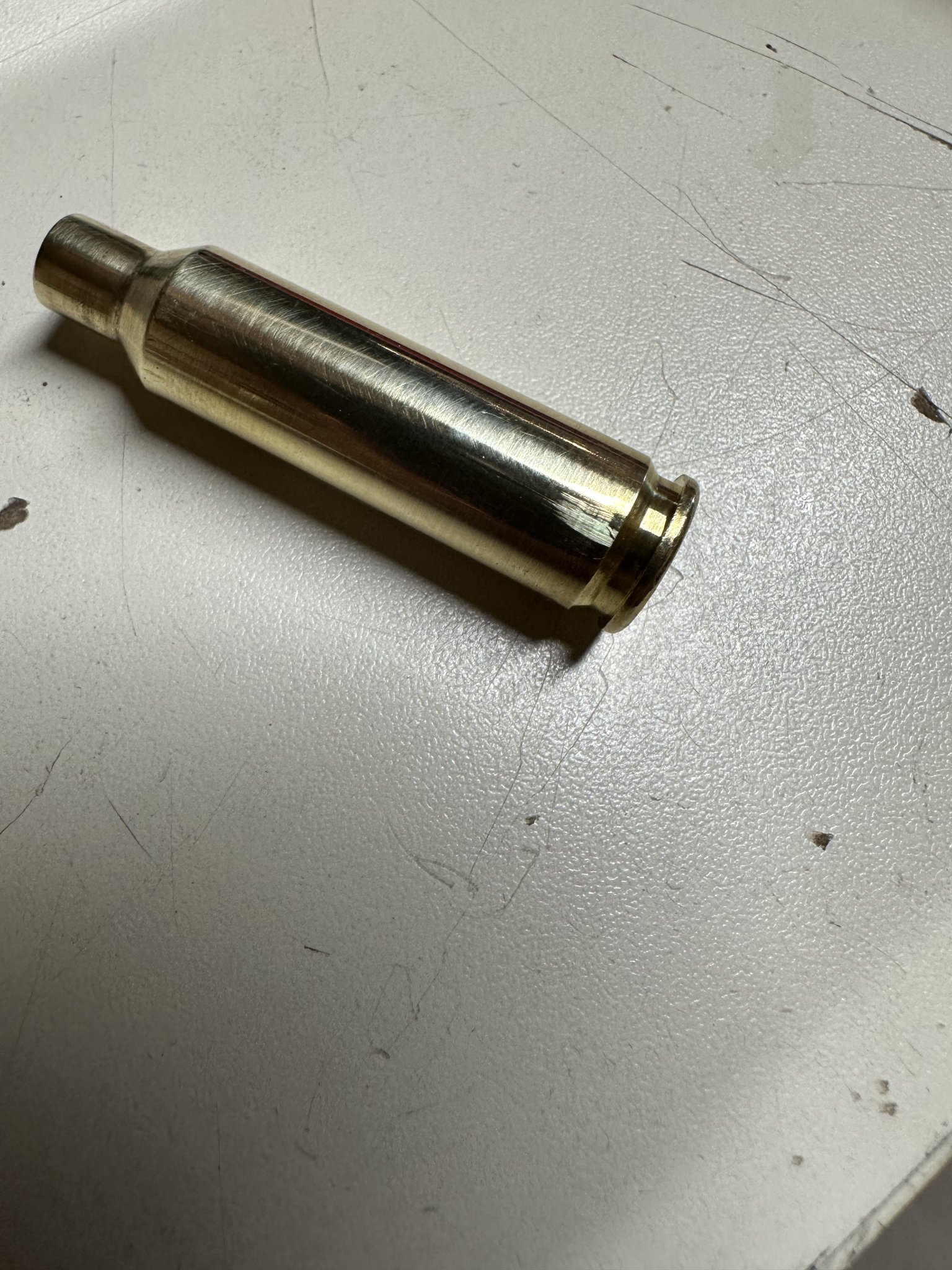

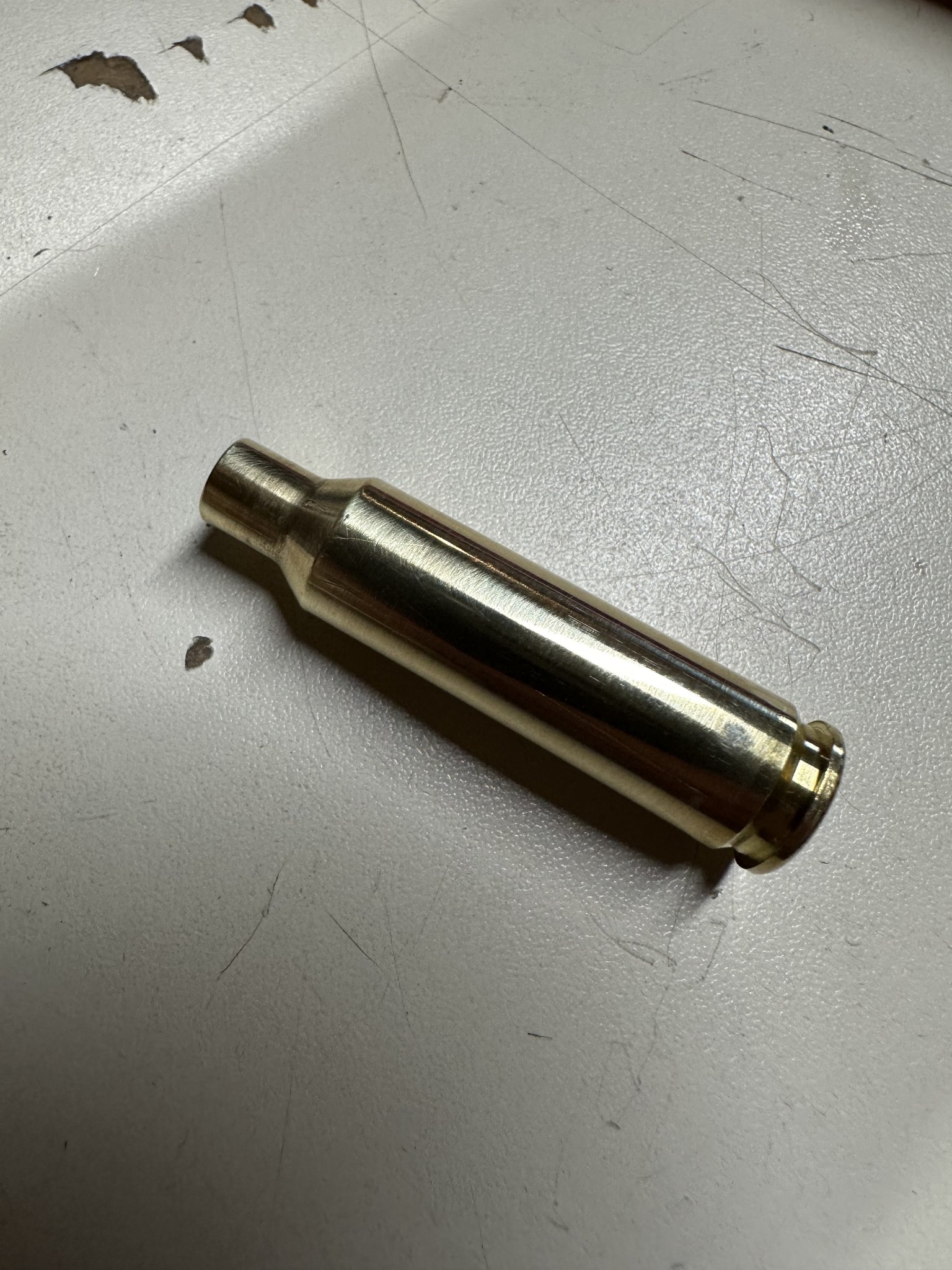

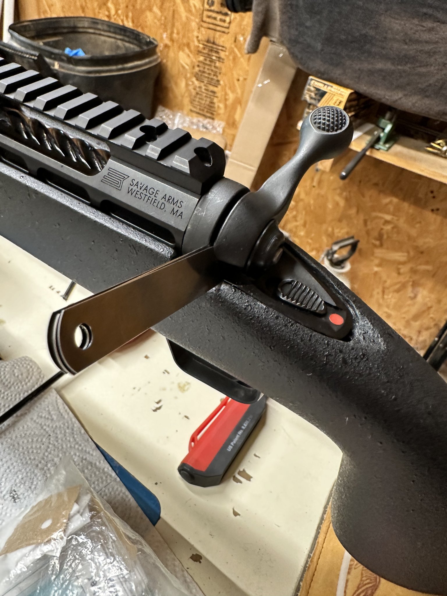

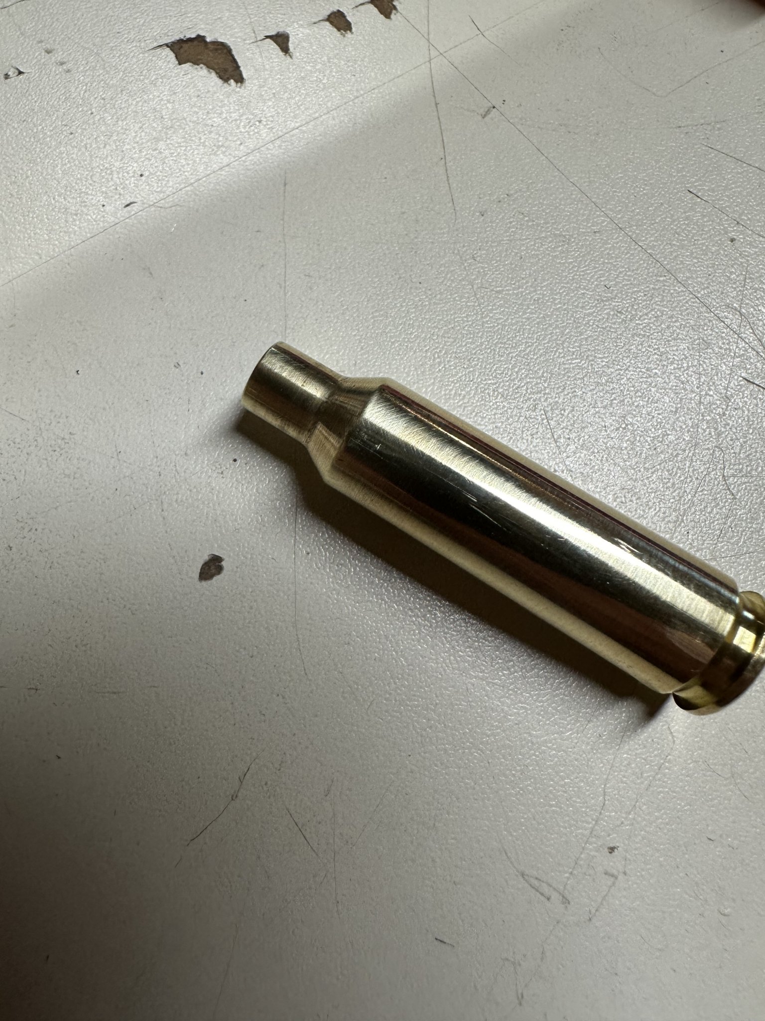

I have a Douglas small shank barrel I had on a savage 10 action,that shot really well,no problems at all,then I put it on the Savage ultralite 110 action,still shoots good,bolt lift is good,but very hard to pull bolt back to extract brass,brass has some marks close to base.
I head spaced the barrel just like any other barrel,took barrel back off,redone the headspace,still the same??
i dont understand why its doing this,I looked in the chamber,looks clean,no burrs

Indeed, and to the OP, have you installed the commonly used extractor/ejector kit with the larger ball bearing in the extractor? I`ve personally not had the need for one but I got a spare anyway. That`s the best way to ensure that an original part will never go bad!
If you put the feeler gauges in front of that baffle, PE is really good.
I've often thought about adding a couple of set screws to the baffle that touch against the rear of the receiver. It would make for adjustable PE.
Some have been known to take a little off the back of the bolt body to fix PE.
Changing bolt handles will sometimes fix it, same as changing the baffle.
Lots of ways to skin that cat.

The lack of a lift kit is not causing the marks on your brass. Pull the barrel off, check carefully inside the chamber for a burr, or even a piece of grit.
I once had a bullet pull out as I was extracting an unfired round. A few granules of powder adhered to the chamber walls, nearest the bolt face. It caused heavy bolt lift and scratches on the brass.
