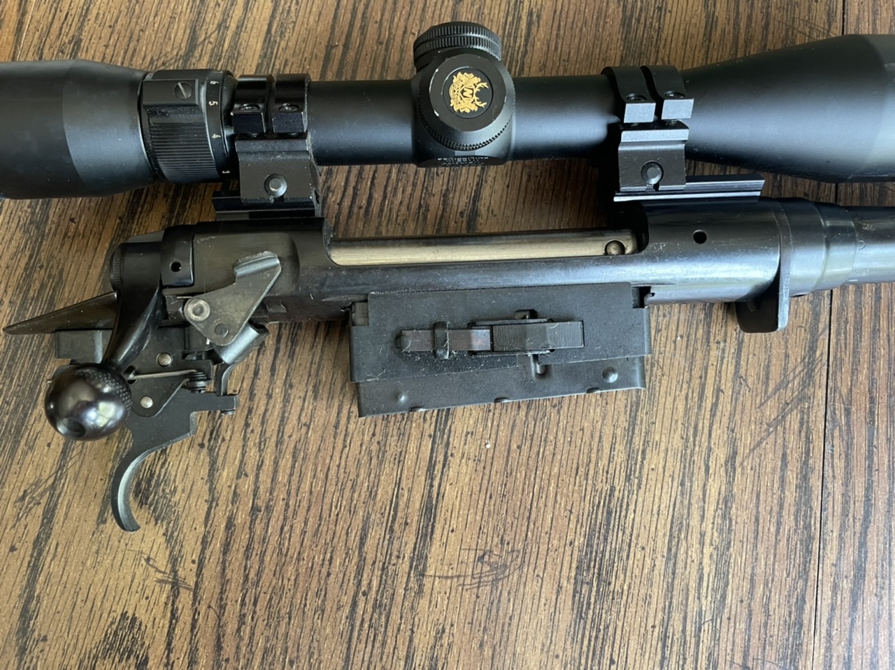

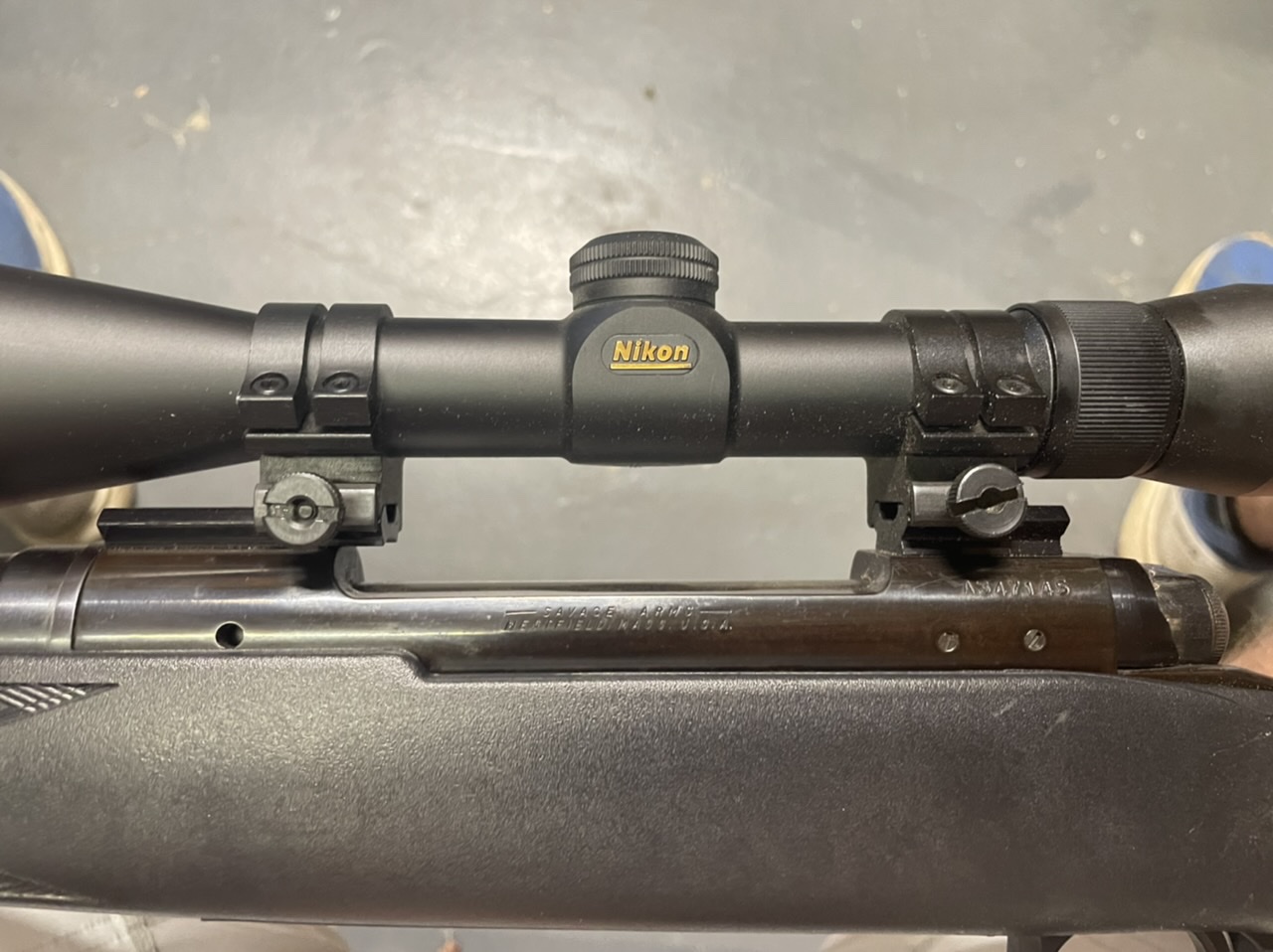

I forgot I had this in the safe. It was my first rifle and hasn’t seen the sun in a lot of years. Is this an action I could rebarrel into something different or am I better off selling it and buying something new? What caliber would be an easy swap if I were to do this?
You could honestly build anything.
The Savage has a replaceable bolt head and different length bolt stop shrouds.
That action has been used to build everything from 223 up to 338 Win Mag and everything in-between.
If you want to stick with your current bolt head:
Anything that uses a .473 case.
BRs, Dasher, GTs, x47s, 22-250, Creedmores, 243, 260, 7-08, 308, 270 Win, 280, 280 AI, 30-06, 35 Whelan.
The list is damn near endless.
Here's my recommendation.
If you reload, buy some 210-215 projectiles like the Berger or even ELDM.
Load them up and try them at distance. You'll be shocked at how well that old assed cartridge does at long distance.
Yeah, it'll kick the snot out of you in that light weight setup, but you'll have a big smile on your face.
Last thing.
If you decide on a total rebuild, it'll cost more than it would if you just spent the money on a completeTikka or Bergara or something like that.
You'll still have a Savage in the end

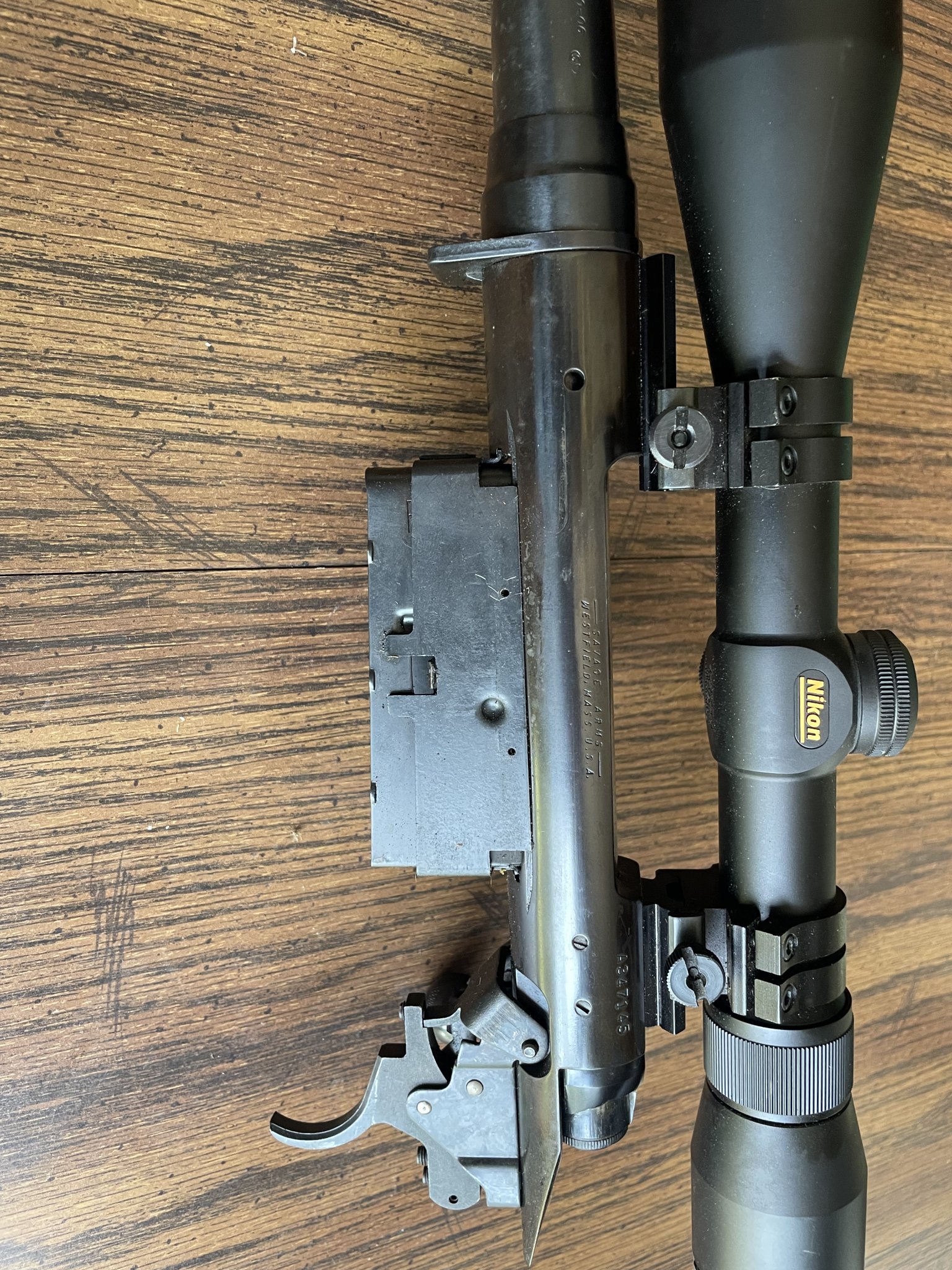

I pulled the action from the stock. Any guidance from these pictures? I’m just going to rebarrel in 30-06 to keep things simple. Suggestions for barrel, possibly a budget trigger, and stock.
Reactions: The D
Stock - What do you want to do with it (hunt/target/both)?
- If weight isn't a concern, the Oryx chassis's are affordable.
- If budget is a concern and hunting is the main use, Boyd's and Stocky's might have something.
- I have one of Savage's Accustocks (built in mini chassis) I like, but it is not a really lightweight stock. They are often available as pull offs on eBay and other places from people who move their rifles to full chassis's and use their Savages for precision shooting.
Barrel:
- you could buy a take off barrel if budget is a major concern. There are usually lots of '06 and 270's on Ebay.
- https://www.eabco.com/ will probably have the least expensive new barrels. But, they don't really customize.
- There are a lot companies that offer Savage prefit barrels with prices to match your imagination.
