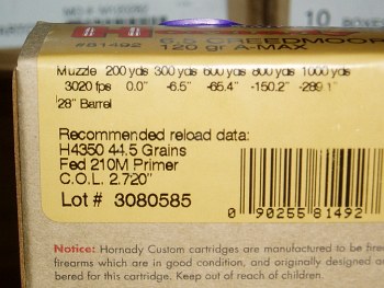

My suggestion is to try the Hornady 140 factory rounds. If it shoots well out of YOUR rifle, reload it to the specs on the box! (Yes their recipe is on the box).
140-gr Factory Load: 140gr A-Max @ 2770 fps, 41.7gr H4350, 210M, Hornady Brass.
120-gr Factory Load: 120gr A-Max @ 2980 fps, 43.5gr H4350, 210M, Hornady Brass.
Here this is off a Nosler forum.
