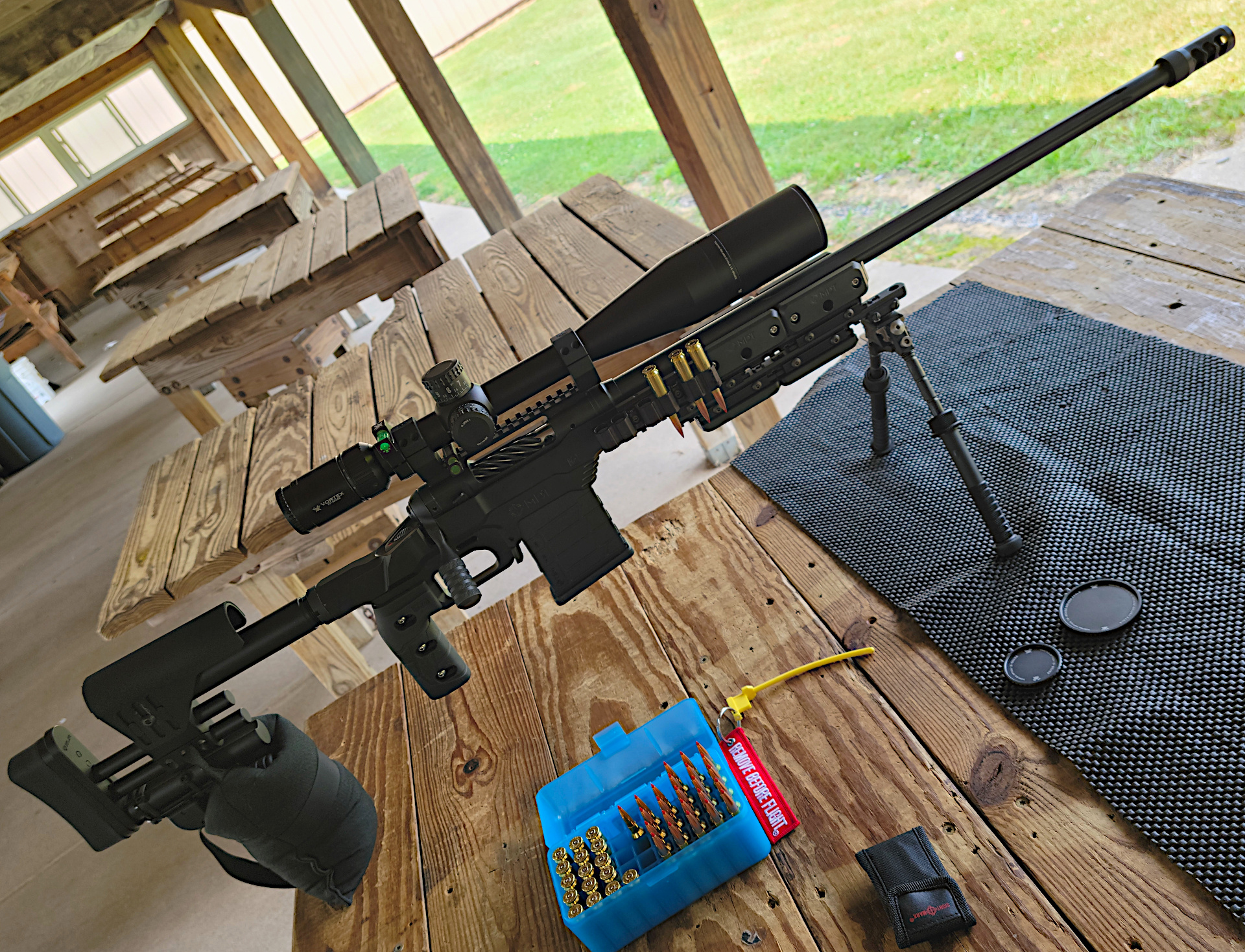

I put one in a MDT XRS and had great results. Shot around a half inch with all the ammo I put through it. Had slight issues with ejection every once and a while

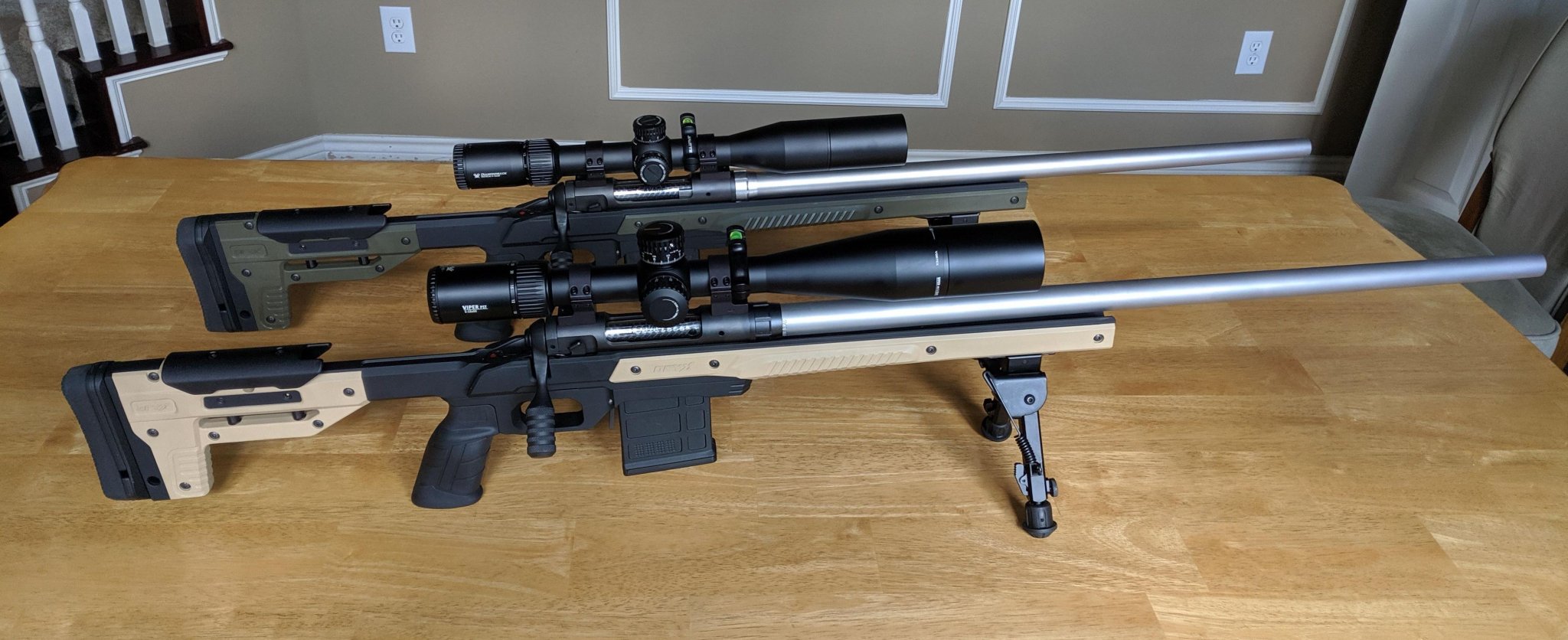

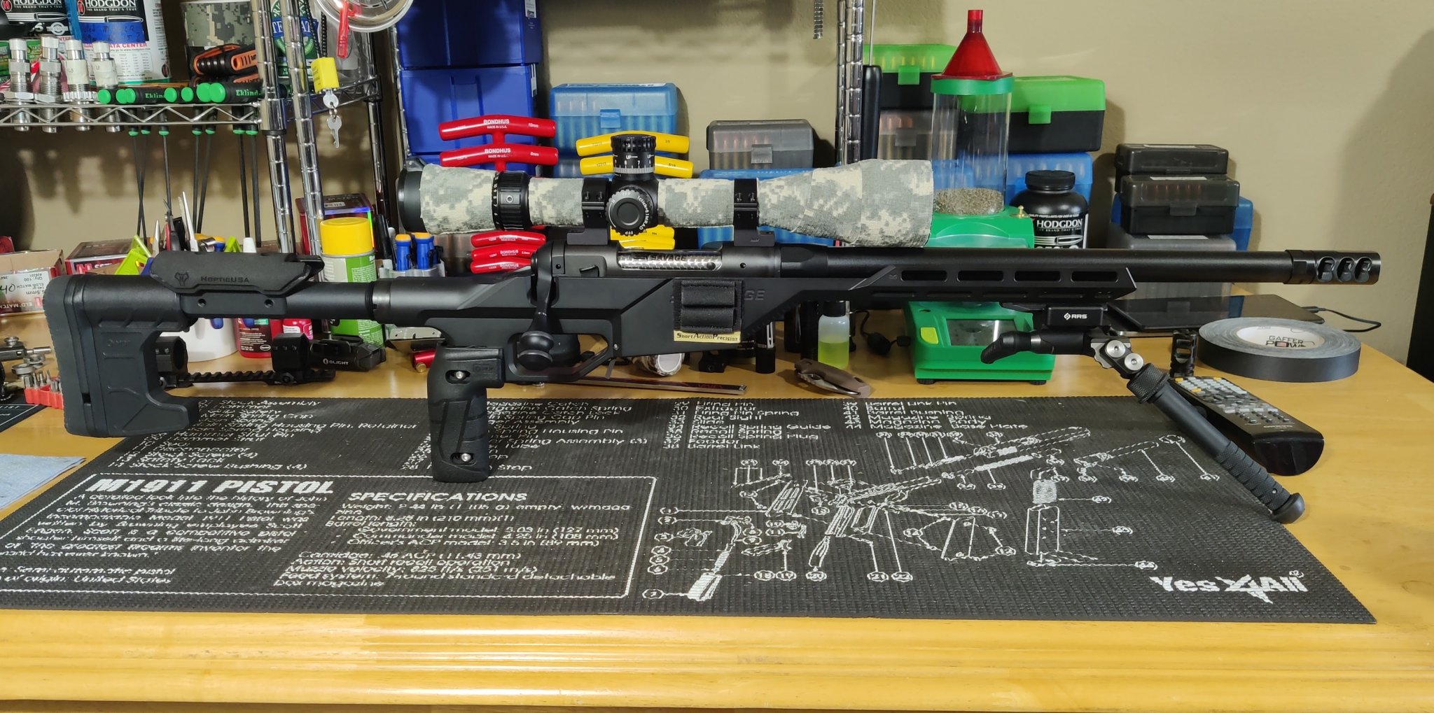

Back in the day, before I knew any better, I picked up 5 of them for $225 each after the rebates. I would then sell off the barrel for $100. Stupid cheap way to get a receiver to play with. They have all been re-barreled with X-Cal sticks, put into a cheap chassis, and shoot better than me.

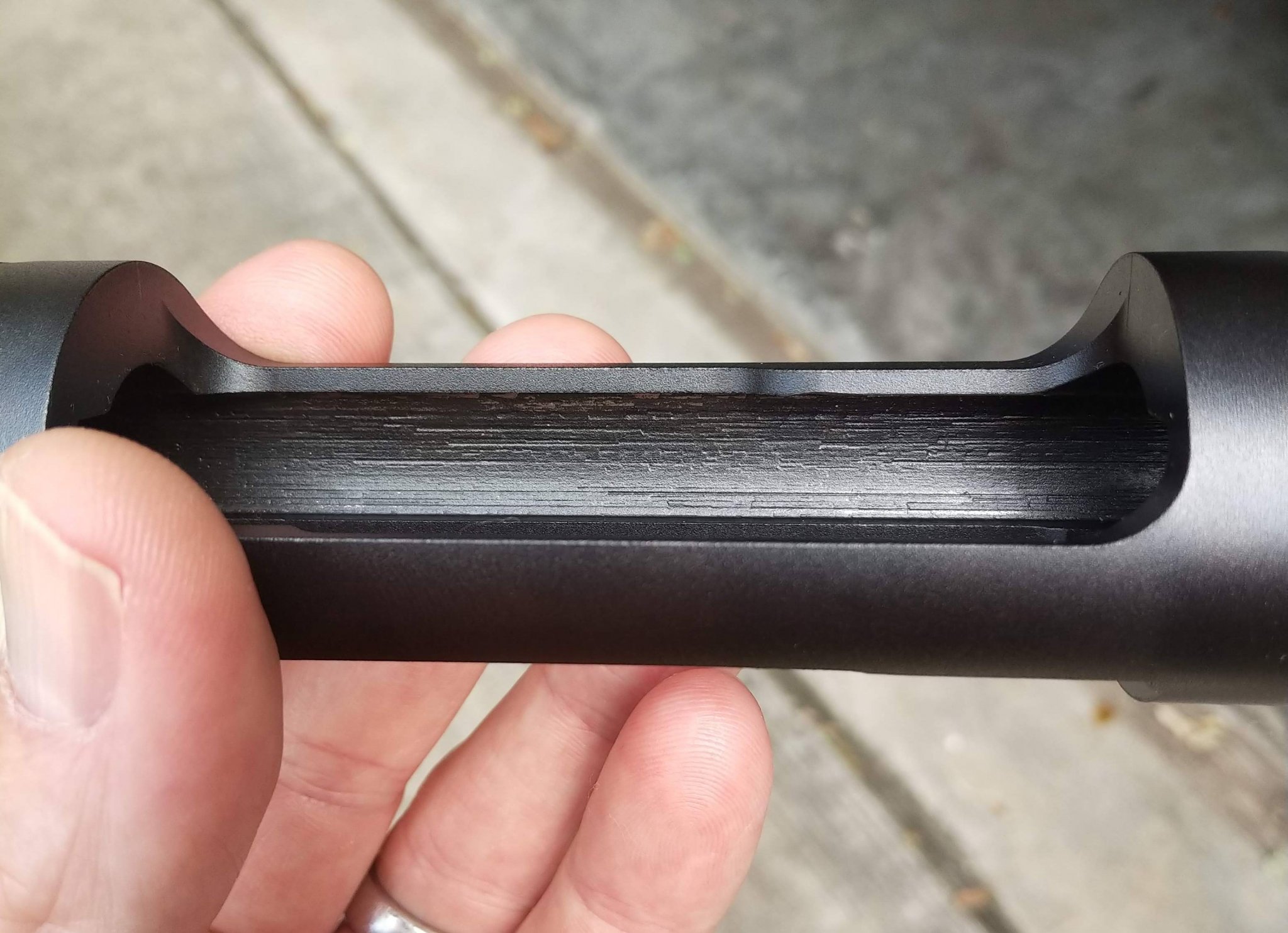

Flash forward and now I have some much better actions, but none really shoot any better than what the 12FVs can do. Quality control across the 12FVs did vary. Some of the machining in the actions is obviously worse than others, but all of them slickened up over time. They can be fussy with loading/ejecting but I don't rush them and they get the job done.
I learned a lot from stripping them down and playing with them over the years. Even though I have way more rifles than I possibly need I can't bring myself to get rid of them. They will be handed down to my future generations as their first "real" rifle.
