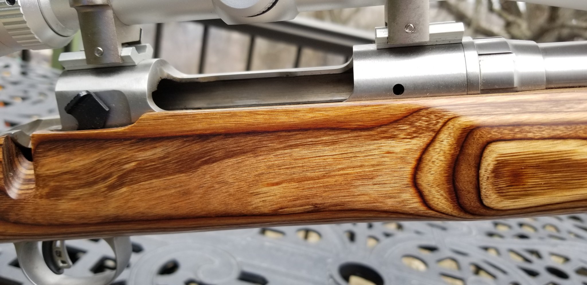

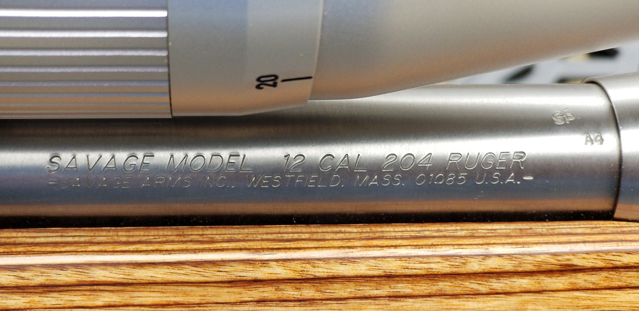

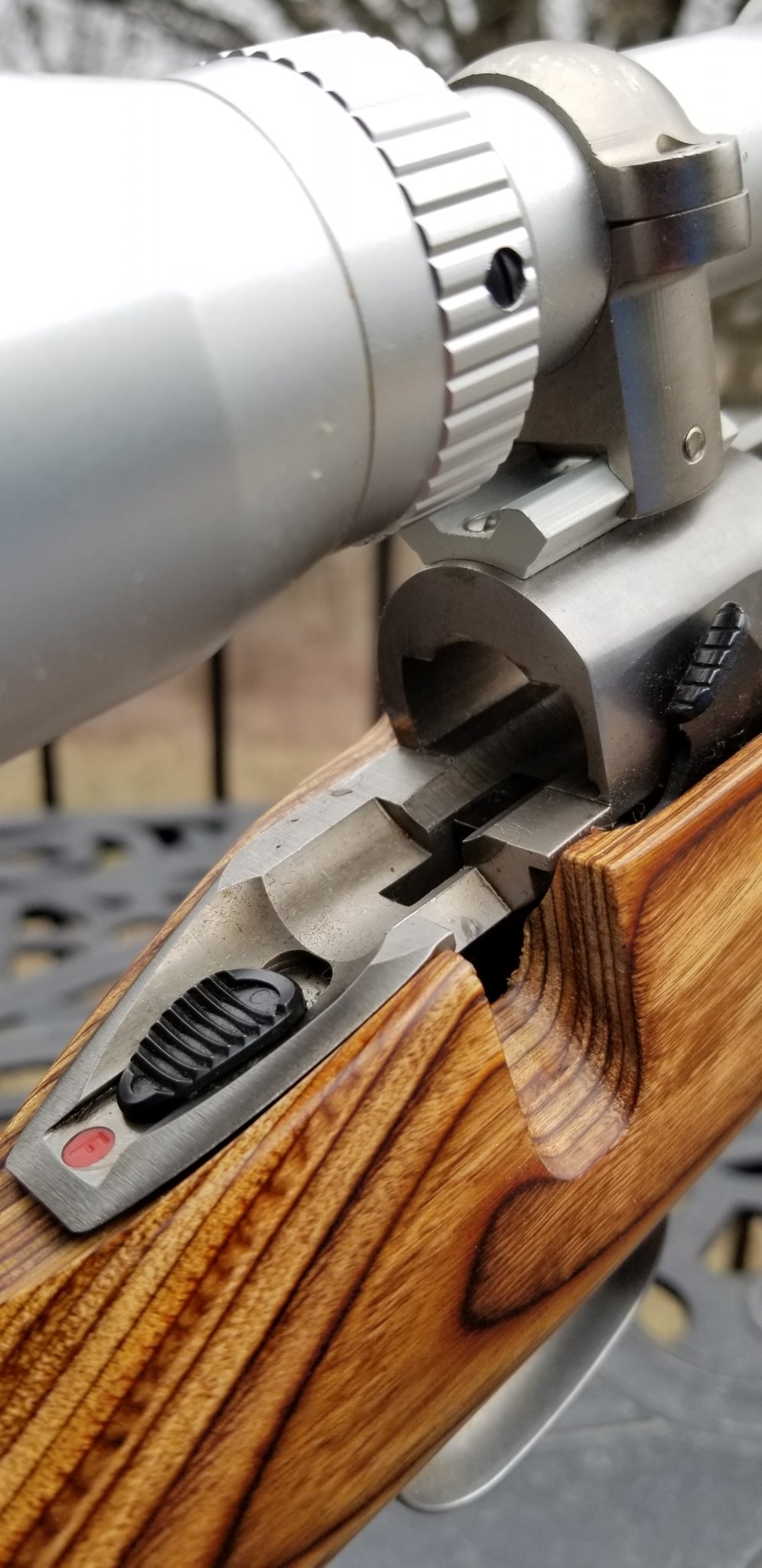

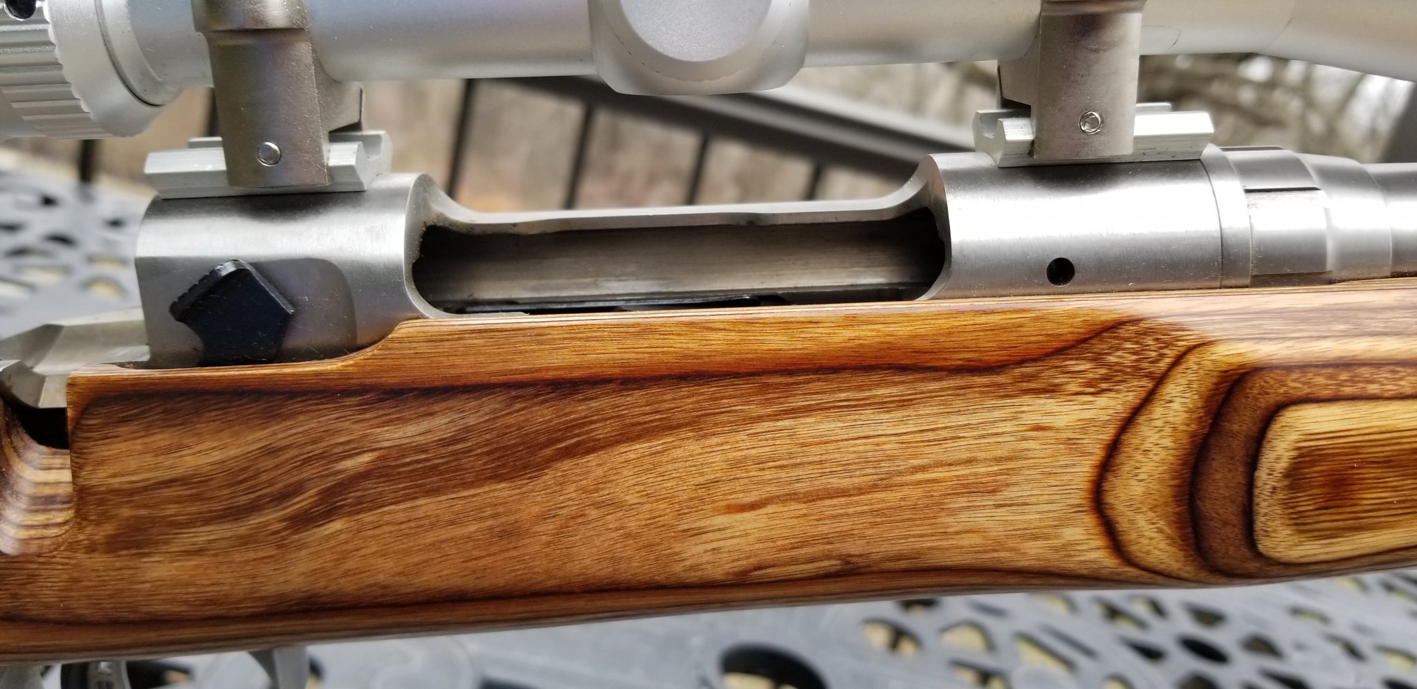

Hello Gents, I have a Savage model 12 .204 that gets no love. As I'm spending more time with the 6.5CM , I'm looking to add another to the mix. So here is my question. Can I rebarrel this to a 6.5? I found a barrel (small shank) in the PX. Just need to replace the bolt,face? I'm not doing the work. Just seeing if this is possible and acquiring all my parts. Thanks

Post pics of the action and mags, and I can tell you for sure and draw lines on the pics even.

Yep, need a new bolt head, baffle and magazine. The wing extending back off the baffle limits bolt throw.
The magazine will also need replacing, cause it has a little block pinned in the back to keep the rounds facing forward.
When you take the action out of the stock, does the magazine stay in the stock or it is attached to the action.
Unlikely, but it it stays attached to the action, conversion may be harder.
