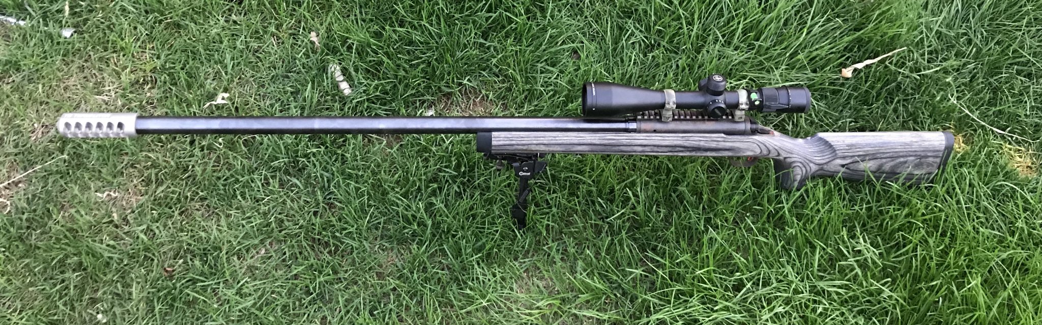

Is this possible? There's not much information on the net about this. I believe the Savage action is 1.350 in diameter? I'd like to buy a cheaper 110 series and convert it to 37XC with a custom barrel. I did read a story on longrangehunters.com but it was so long it was hard to keep up with the author of it. The endd result looked liked a Savage action with a 37XC barrel but it was shouldered. I'd like to barrel nut it? Is this possible? Appreciate the info.
Savage is not the best action too weak , and tennon is to small but will work. Using the nut is the worst thing you could do. The xc is just over 3" long so 1" of the 3 inches is in the tennon and you want to compound the problem by installing 2 of those 3" in a 1.120 diamiter shank? If you are so poor that you cant afford a better action at least spend the money on a shouldered barrel shank that is at least 1.300 in diamiter... be wise save your money take you time purchase a good action.

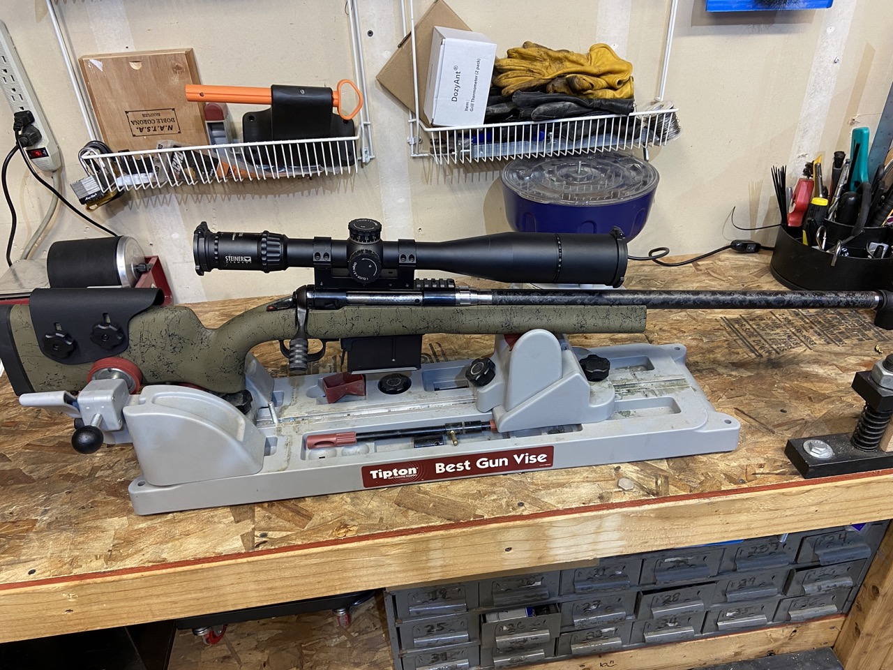

I built one on a 112 w barrel nut. If I did it again I’d go shoulder

I’ve ran a few 7 Saum barrels with a barrel nut.
Big difference from a .540 boltface cartridge and a .580 in standard tenons and actions, that extra 20 thou per side doesn’t sound like much but it does make a difference.
Steel on a custom action is probably considerably better than savage action as well.

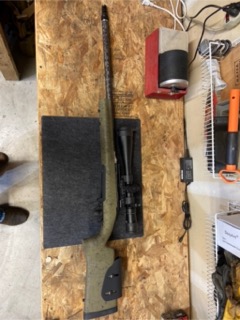

A load that ran flawlessly in my Nuke showed pressure when I put that barrel in my savage.
Fwiw I did burn up that barrel on that action. Just after 1100 rounds it took a dump and es went sky high no matter what I did the vertical was huge. I couldn’t shoot monos it that barrel as I found out bore was too tight and had major pressure issues. Settled on the 350gr smk’s as I got a smoking deal on 1000ct batch. 3k was the farthest I took those as I ran out of elevation in my setup at the time.
That's still pretty bad ass for a Savage set up. I would call that a success; albeit not as good as a custom action but still better ballistics than a factory 338LM.

I just came across this thread and I am looking for a bit of clarification.
I built what I call a poor man's Cheytac a year back or so. I got an excellent price on a Savage 110 .338 LM and had it re-barreled in to a .338-378 and shoulder the barrel (no nut). When building it, my primary concern was lug failure. I was concerned that the bolt and action could not withstand the pressure of the larger cartridge. After some phone calls to smarter people, it was evident that the pressures were only about 4k PSI more than the Lapua.
So my question is, could I have built this rifle into a 37XC? And when does lug failure become a concern?
CM
CM
Lug failure is the least of your concerns since less than 20% of the overall chamber pressures even go into the Lugs. Primary consern is tennon and shank o.d. The 37xc would have been a better option. Better quality brass as the 378 brass quality is very poor . And cant handle the higher pressures. Please note that pressure is what you make it o r should i say what you load it to be. Never the less a savage action is not really you best option for eather cartridge as its a poor quality weak designed action
