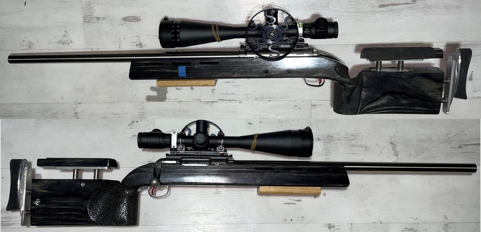

Figure 1 shows profiles of the rifle. It’s a Savage 12 Target Action with a Criterion 26” barrel in 6BR Norma with a 1 in 8” twist. The stock is homemade from a Richards Microfit laminated blank. The scope is a Sightron SIII 10-50x60 Field Target on Warne QD mounts. I use this scope on two centerfire rifles, a spring piston air rifle and a Kimber 82G rimfire rifle, so I get a lot of bang for the buck from this scope. I think it's a lot better to have one really good scope that is swapped onto four rifles than four mediocre scopes that are dedicated to these rifles. POI changes less than 0.5 MOA when switched from one rifle to the next.

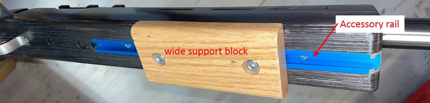

Figure 2 shows the accessory rail (Rockler Universal T-Track) that I inletted into the bottom of the forend. The 3” wide wooden support block was made to better fit the wide owl ear sandbag on the front rest.

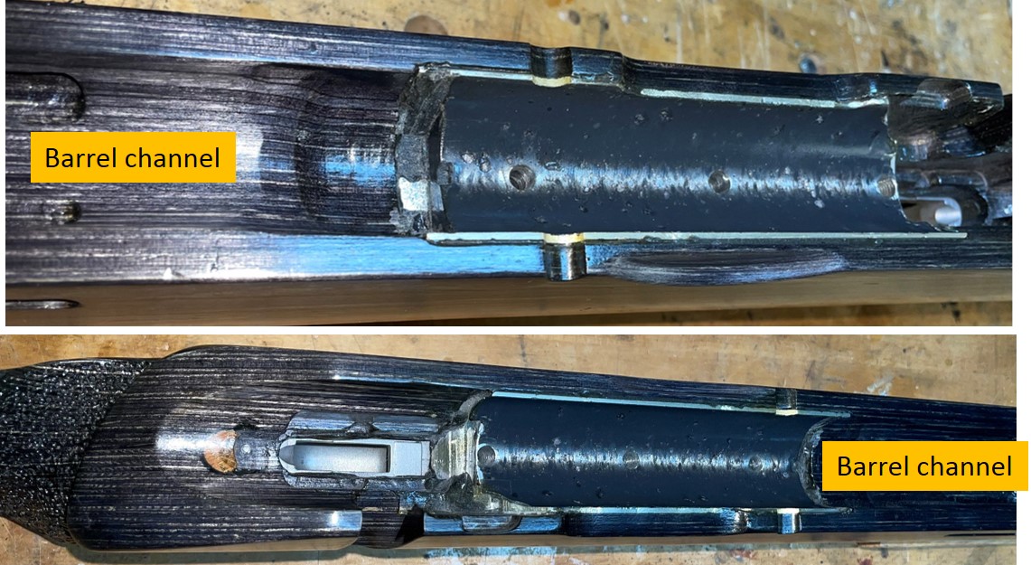

Figure 3 shows the DIY aluminum bedding block that was glued into the stock. The receiver was then skim-coat bedded into the aluminum block with Acraglas Gel and the barrel and receiver tang were free-floated. I like the fact that three screws (all in front of the trigger) hold the receiver into the bedding block.

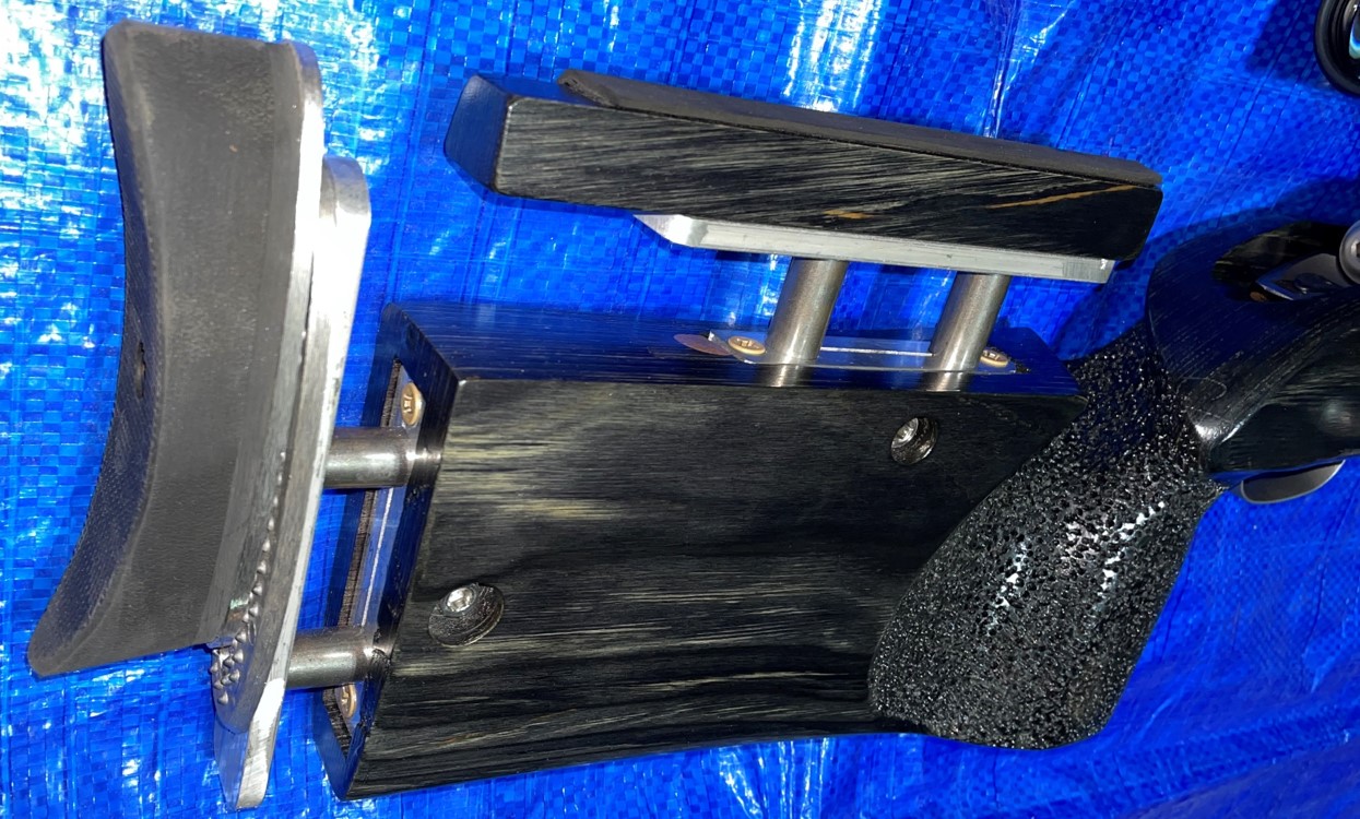

Figure 4 shows the stock adjustment hardware that I made to allow the cheekpiece and buttpad to be moved.

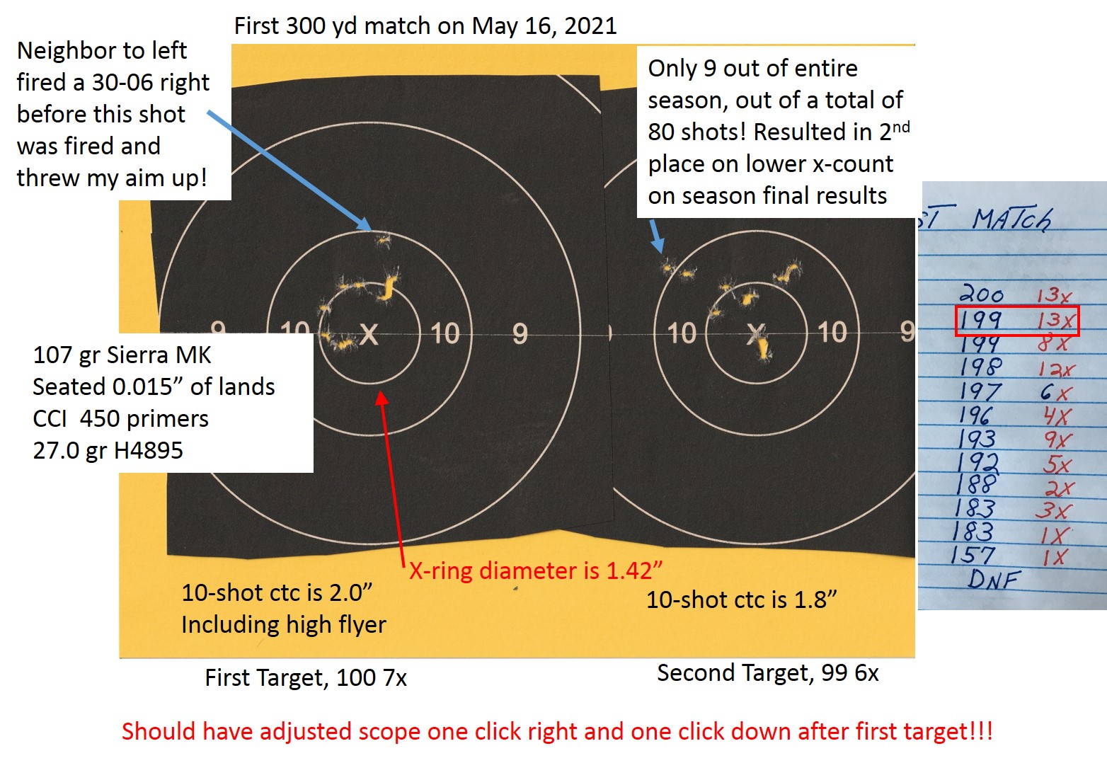

Figure 5 shows the two bulls from my first match. The 10 ring has a diameter is 2.85” and all but one shot were 10s. The 9 was on the second (right) bull at around 11 o’clock. It didn’t miss by much and I probably would have gotten a 10 if I were shooting a 6.5mm instead of 6mm bullet! I should have adjusted my scope down and right after the first bull, but was worried about the scope not settling in for the second bull. After this I always made adjustments after the first bull. I was lucky to keep a shot inside the 10 ring at 12 o’clock on the first bull, when my neighbor fired his 30-06 just a moment before I pulled the trigger and my POA jumped up. Still, I was happy with my 199-13x score, which was a personal best.

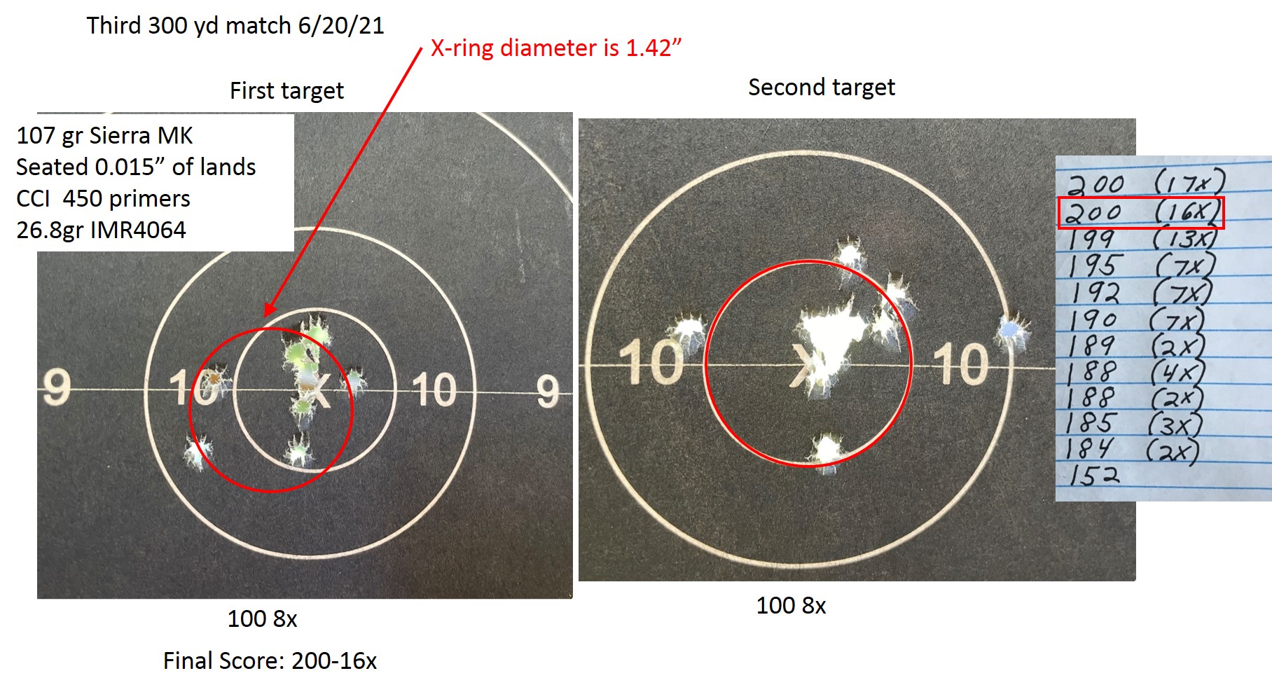

Figure 7 shows the targets from my third match. I reduced the powder charge of IMR 4064 to 26.8 grains. I was a bit lucky to keep a shot at 3 o’clock in the 10-ring on the second bull! I had one wind flag and didn’t notice any wind change for this shot, so I’m not sure what caused this.

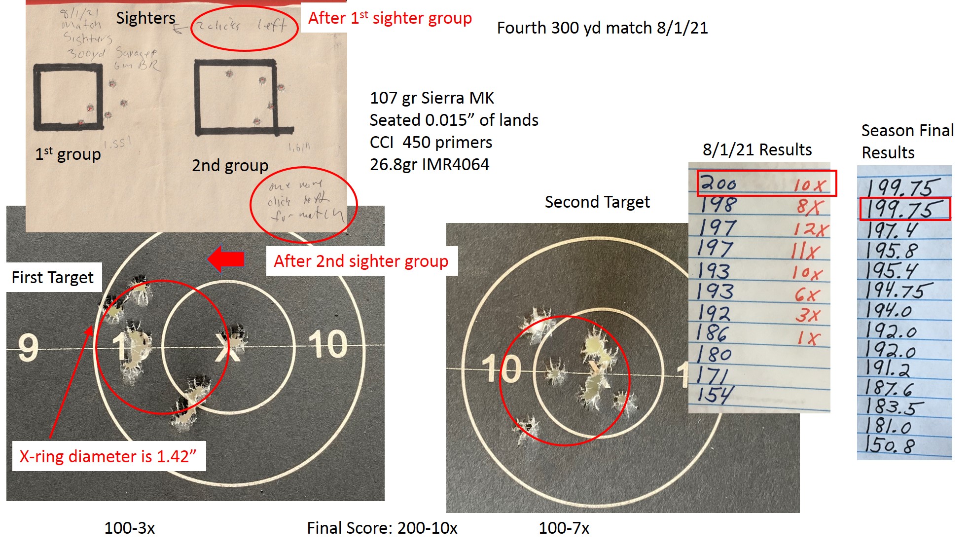

Figure 8 shows the targets from my fourth and final match. I included the sighters in the top left corner to show a surprising result. The group in my second sighter target was a little to the right, so I clicked the scope 1 click (1/8 MOA) to the left. It looks like the group on the first bull moved a lot more than 3/8” to the left after that adjustment! This is why I’m a bit paranoid about making scope adjustments during a match. After the first bull, I clicked to the right and got a better centered group on the second bull. The group sizes look pretty good, each with a 10-shot center-to-center distance of around 1.4”. If they were better centered, I would have gotten a lot more Xs!
I’m very happy with the second place season finish (I tied for first in average score but lost on average X-count). The first place finisher also shot a Savage 12 Target Action with a Sightron 10-50x60 scope, but used a Shilen select match barrel in 6.5mm Creedmoor. I’ve read a lot of complaints about Savage rifles, but the some of the biggest complaints don’t apply for this particular situation. Since I’m using a single shot action, there were no failure to feed or magazine issues. I even removed the ejector to help protect the spent brass, so ejection also wasn’t any issue. Since I’m firing slowly, I wasn’t bothered too much if the sear accidentally tripped and got hung up on the AccuRelease safety lever. This never happened during a match, but happened rarely if I didn’t pull the trigger straight back. If I remember correctly, this happened only a few of times when I was first getting used to the trigger in January 2021 and was wearing gloves due to the cold weather. I really appreciated having a trigger pull of around 6 ounces, which allowed me to fire the rifle under free recoil with almost no body contact with the rifle. This is a great trigger for a factory action, as long as you can shoot slowly! Now if I was shooting in a PRS Match, these are important issues, but for this kind of benchrest match, the Savage worked really well.
