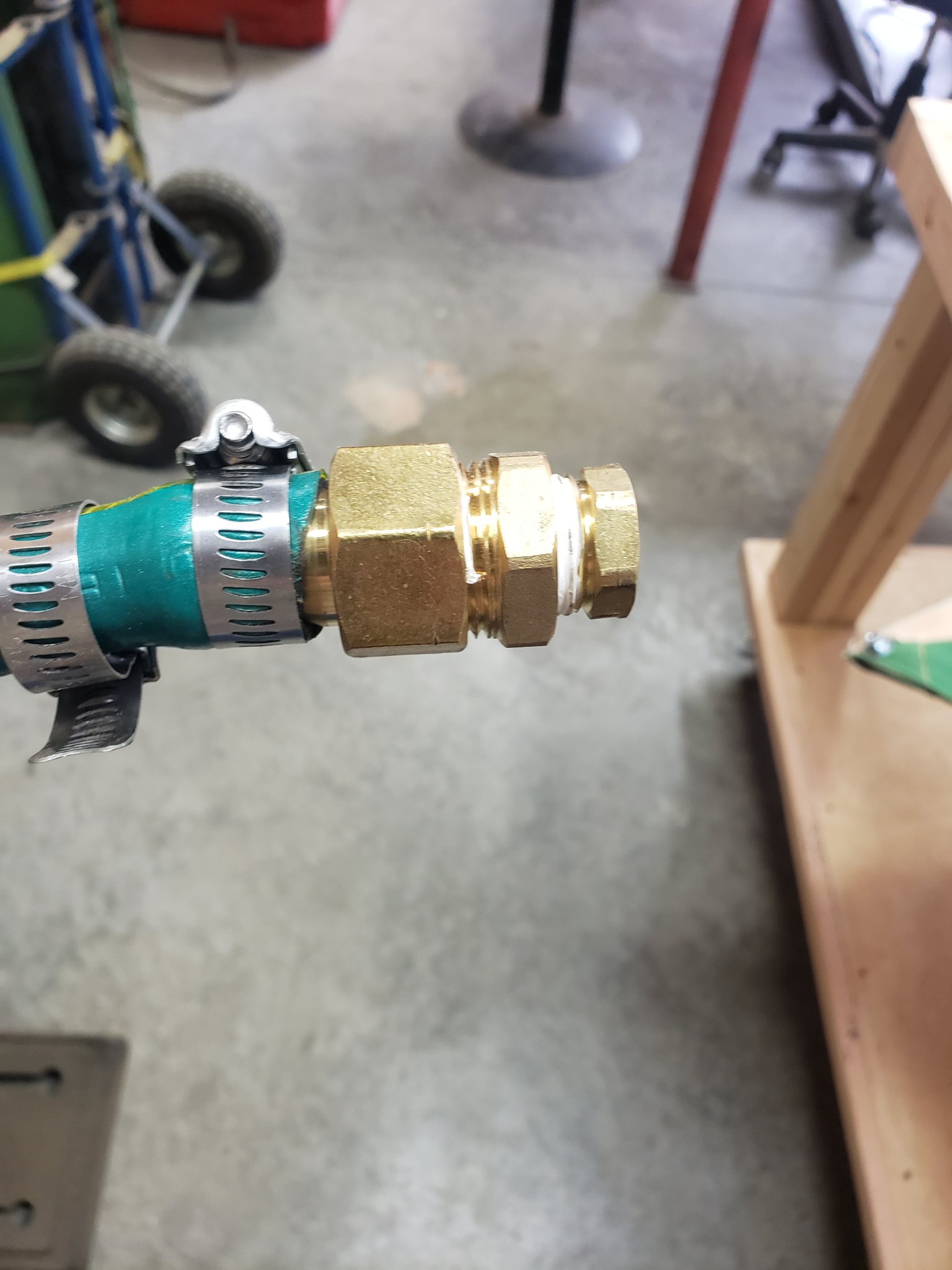

    I stuck an Otis cleaning cable in my 93r17 because the patch was too big and wedged in the chamber. Here me out on this one, I cut the cable flush with the end of the barrel. Took 3/4" ID garden hose and hose clamped one end to the barrel, the other end I went to lowes and got the brass fittings to get 3/4" barb fitting to 1/4" female pipe thread. Now comes the interesting part, unscrew the quick coupler off the pressure washer and thread the pressure washer gun into that mess of brass fittings and throw a towel over the other end of the action to contain the excitement... one quick hit on the pressure washer handle and wah-lah cable was wadded up under the towel... sprayed the barrel down with wd40, blew the excess off with the air compressor, and wiped down with some oil. If you're interested I can run out to the shop tomorrow and see just what fittings I used.

    Okay here she is, 3/4 barb to 3/4 FNPT hooked to 3/4 MNPT to 1/2 FNPT bushing, 1/2 MNPT to 1/4 FNPT bushing. This then hooks up to the pressure washer. Most anytime you have a barrel obstruction like a bore snake or the like its much easier to push it back out the way it came than to wedge it tighter towards the muzzle.
    And you really think that green garden hose is going to handle the head pressure coming off a pressure washer.
    WAH WAH
