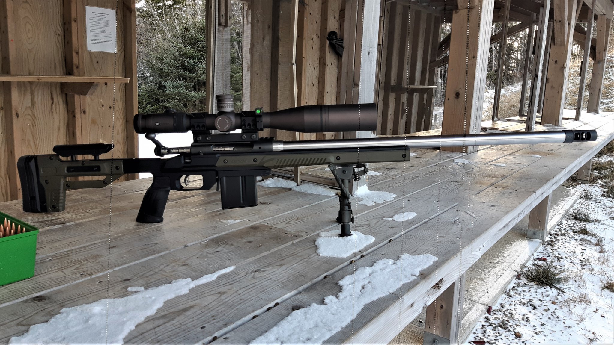

I ran a cdi bottom metal in mine in a boyds and in ran like a champ with 6.5x47 .I have switched to the oryx chassis and love it
Reactions: Evlshnngns
Very nice. Thanks for all the replies guys! For now I guess I am just going to have to wait until another manufacturer produces a bottom metal or try to find one used. I did go ahead and get the plunger style release base (from the newer axis) for the magazine I have now. Much better but still plastic.
