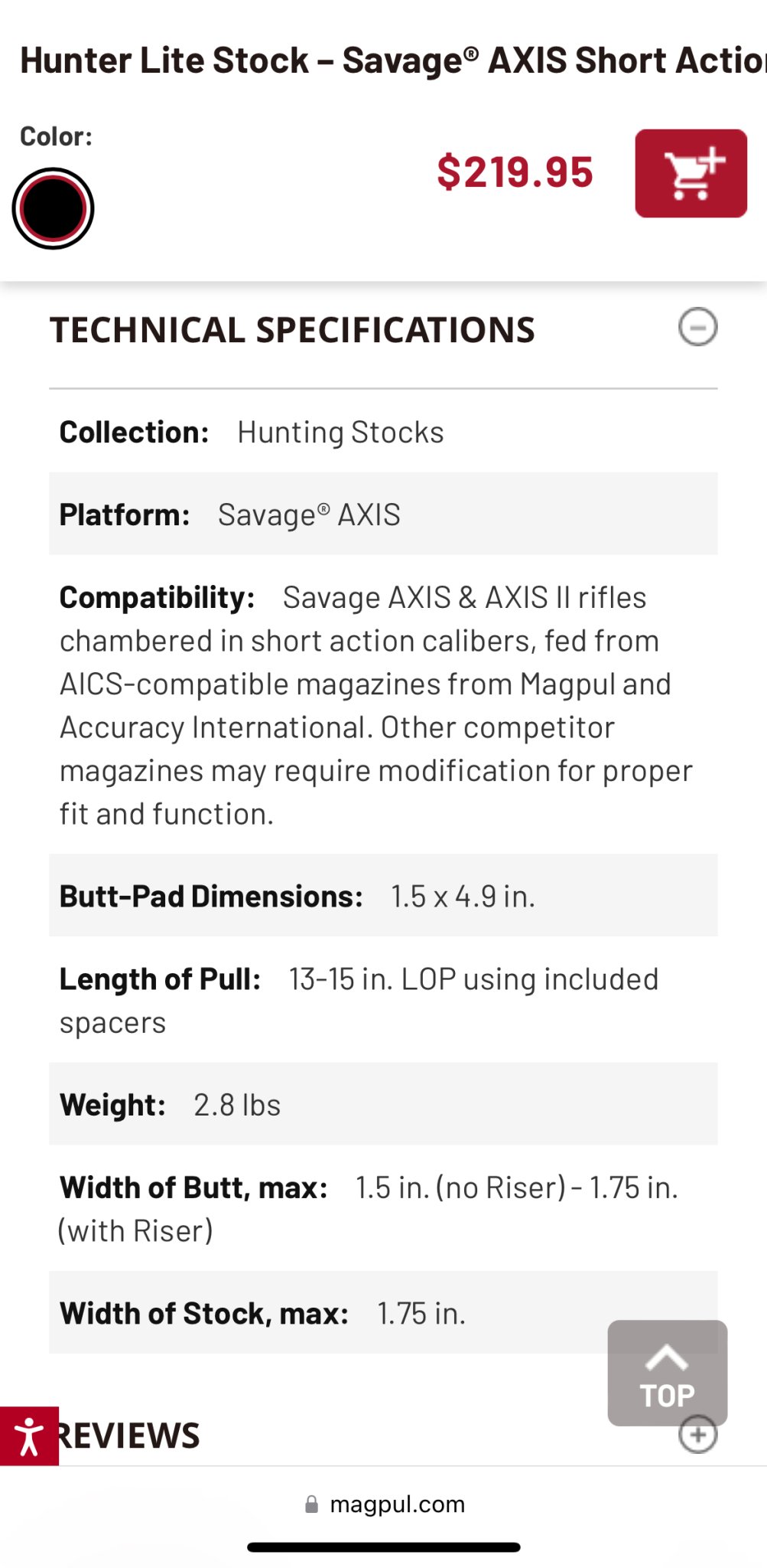

I own a Ruger American Hunter in 308 win and it’s an absolute tax driver, but it’s quite heavy for longer walks in the prairies of Alberta.
I’m looking at grabbing a short action savage axis II XP in 308win/6.5creedmoor/243win and swapping out the stock for the new Magpul hunter lite.
I have gift cards to a local store where the gun would be free and the stock would cost me $320 CAD.
I’m wondering if someone has completed this style build, what’s the weight difference from the flimsy Axis stock from factory to the hunter lite. I can’t seem to find any information on how much a short action axis stock weighs without the barrelled action.
Thanks in advance, and so sorry if my search was inadequate and this info can be found on here!
Luke
Don’t know about the factory stock. Hunter Lite is 2.8 pounds.
