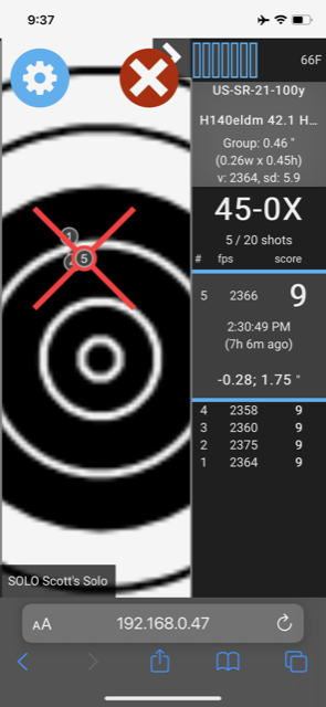

I am dipping my toes into LR F Practical as I try to learn a little from the real F Class guys using an Axis II Precision in 6.5 Manbun. Using Lapua SRP, 450, 42.1 gr H4350, the Hornady 140ELDM and about 1thou. neck tension jumping 20 thou off, running it off a Skyline bipod and a rear squeeze bag it does better than I am. The new Taylor was Here bags are helping me with rear support.
Helluva Fclass shooter named John at Atterbury let me know the rifle is outshooting me until I learn more, . Disclaimer I am a knuckle dragger service rifle sling shooter. I look forward to more time at 1000 yds this year.
Load seems to be working. The Axis II precision is in a full MDT chassis. Trigger is ok, not fabulous, my little rimfire savage MK II has a better trigger. But it lets me shoot at LR and get my toes in the pond. Load testing this was with a can on it. Shot 1 out of the group, 2-5 in the same hole. I am learning rear bag use. Thought it was easy but it takes time to learn. Whole nother discipline for me.
The SMK 140 and RL 17 actually shot quite well in early testing too. This is not a $1200-$1600 action, but a friend who does PRS and F with highend actions, rifles said it was a smoother action than he expected. Do I want to build a high end rig, of course. Job change and such has altered my funding.

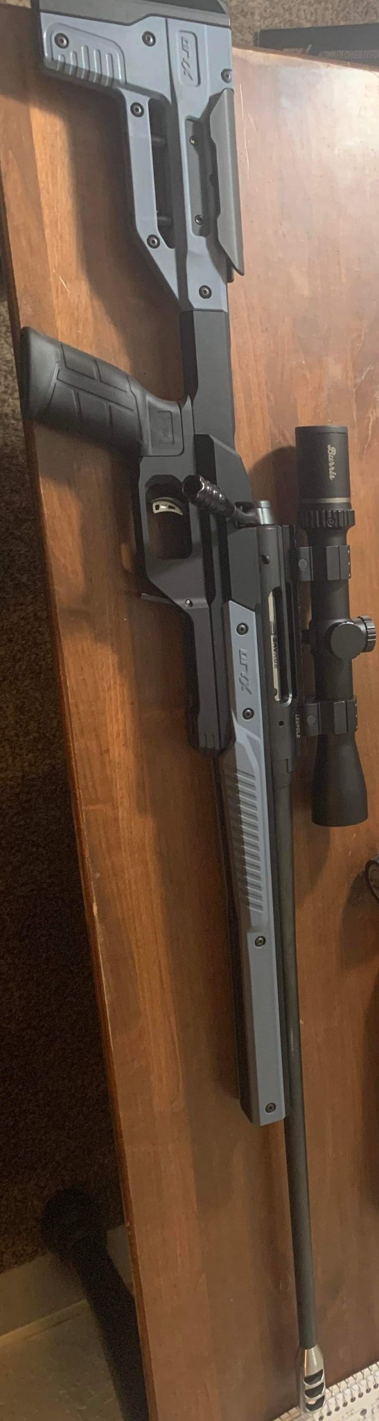

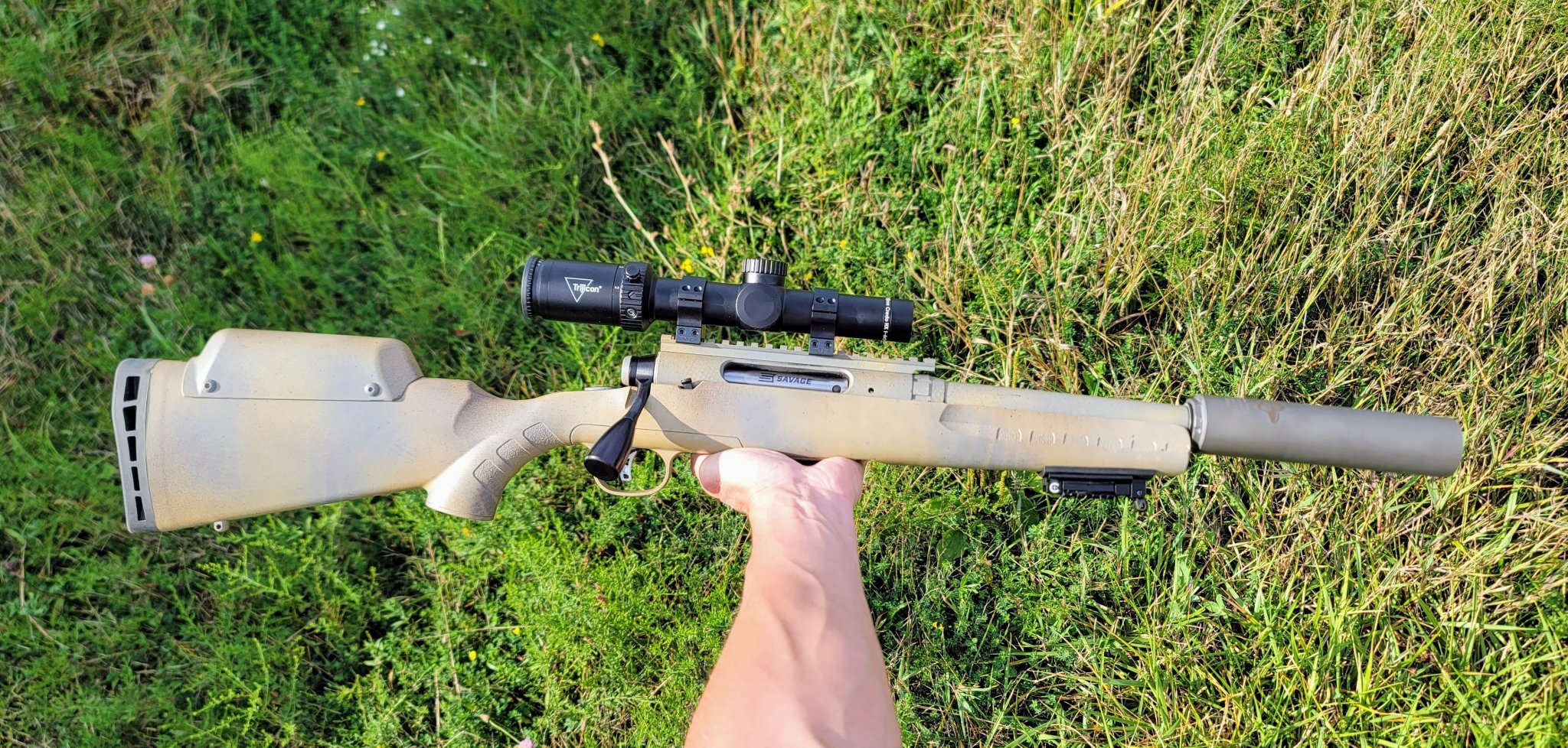

I have a savage axis II in 300blk that I sbr'd. It was crazy cheap and available. It was easily the worst action I've ever felt from the factory. I did a few of the bolt mods available and now it's not so bad. Overall I love the little thing for it's purpose, which is plinking and short range deer
Is the stock a savage ? If so where did you get the raised cheek piece ??

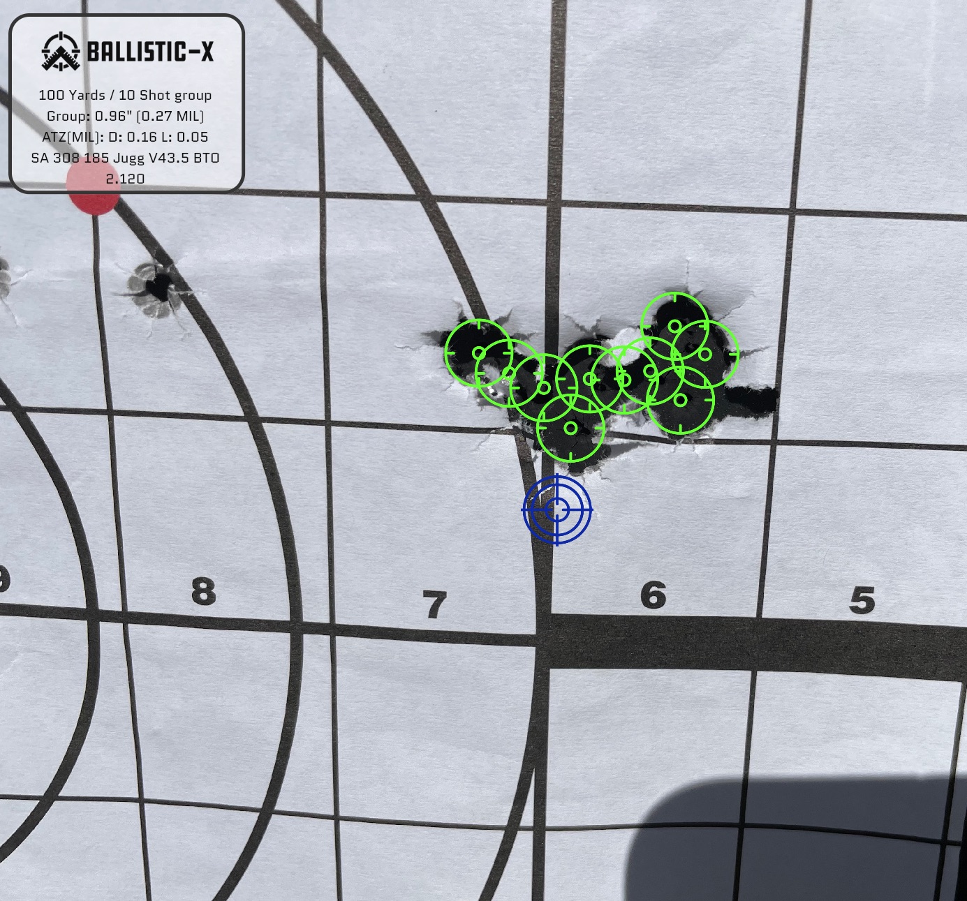

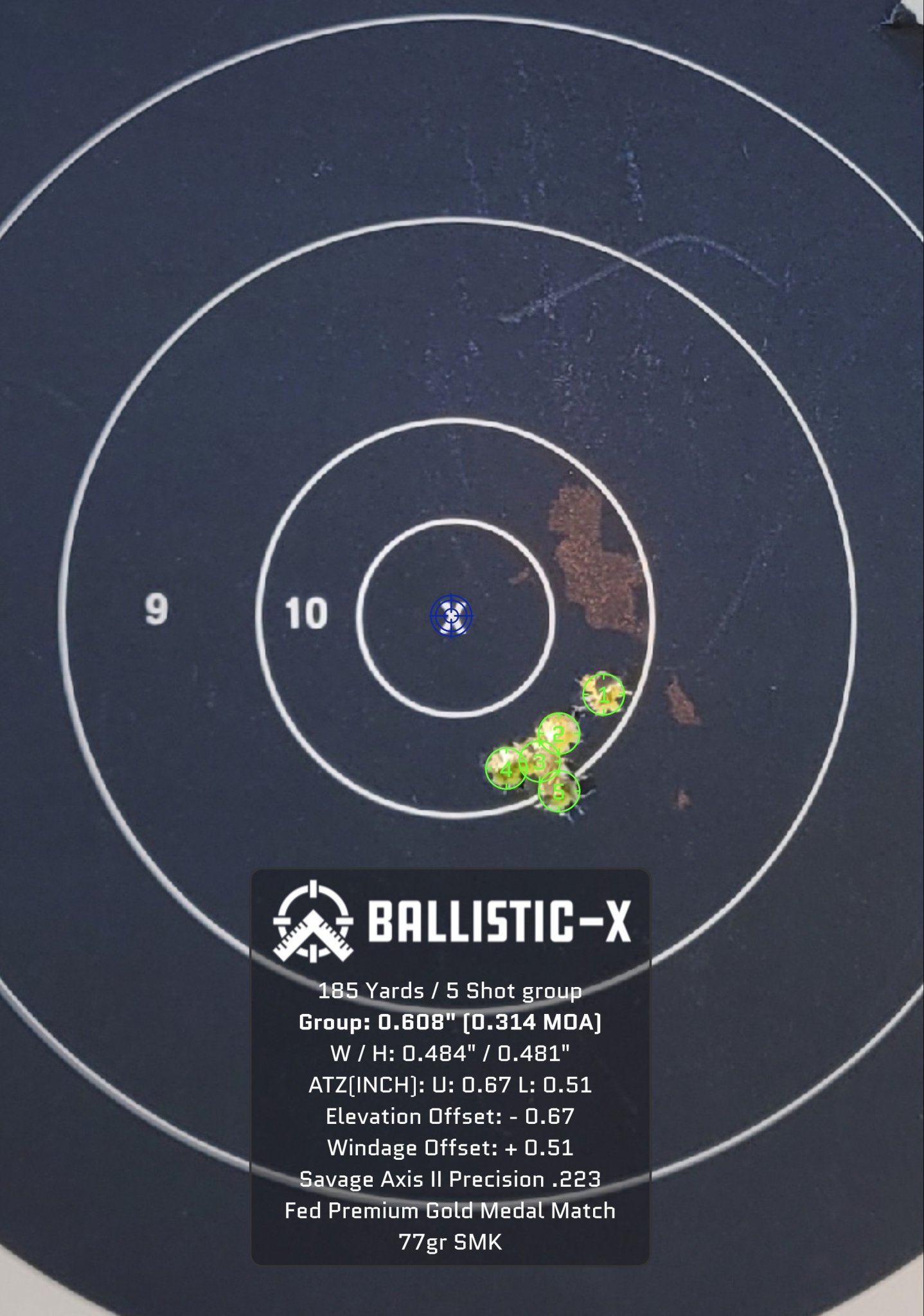

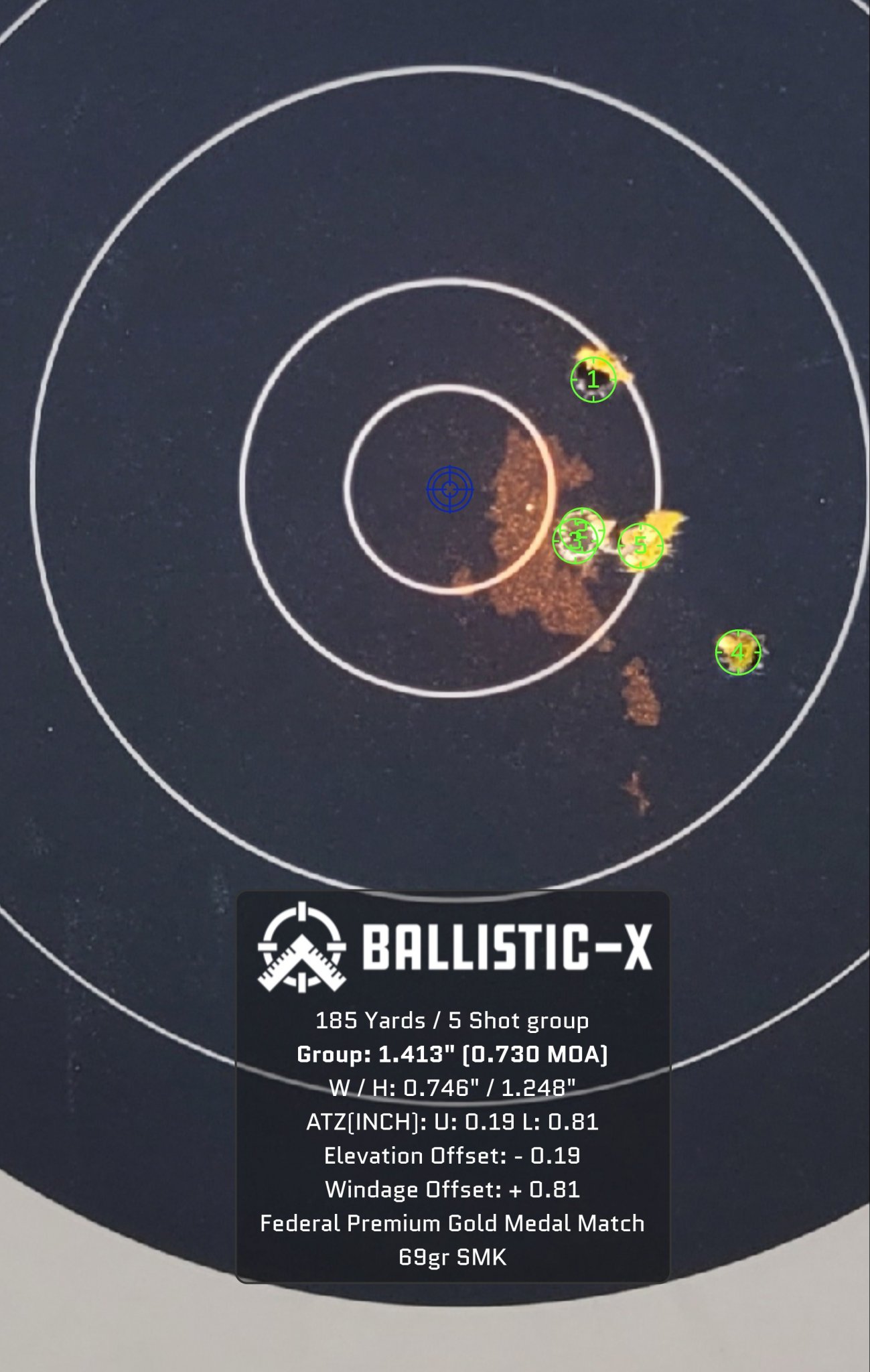

I picked up a new Savage Axis II Precision in .223. Tossed an Athlon Argos 6-24 x 50 FFP MOA on top. Just getting started but today @ 185 yards (2 mph wind 60° day) with 77gr SMKs I put 5 shots into a .60 inch group. 69gr SMKs printed a 1.4 inch group.
Very satisfied. These were factory Federal Premium Gold Match.

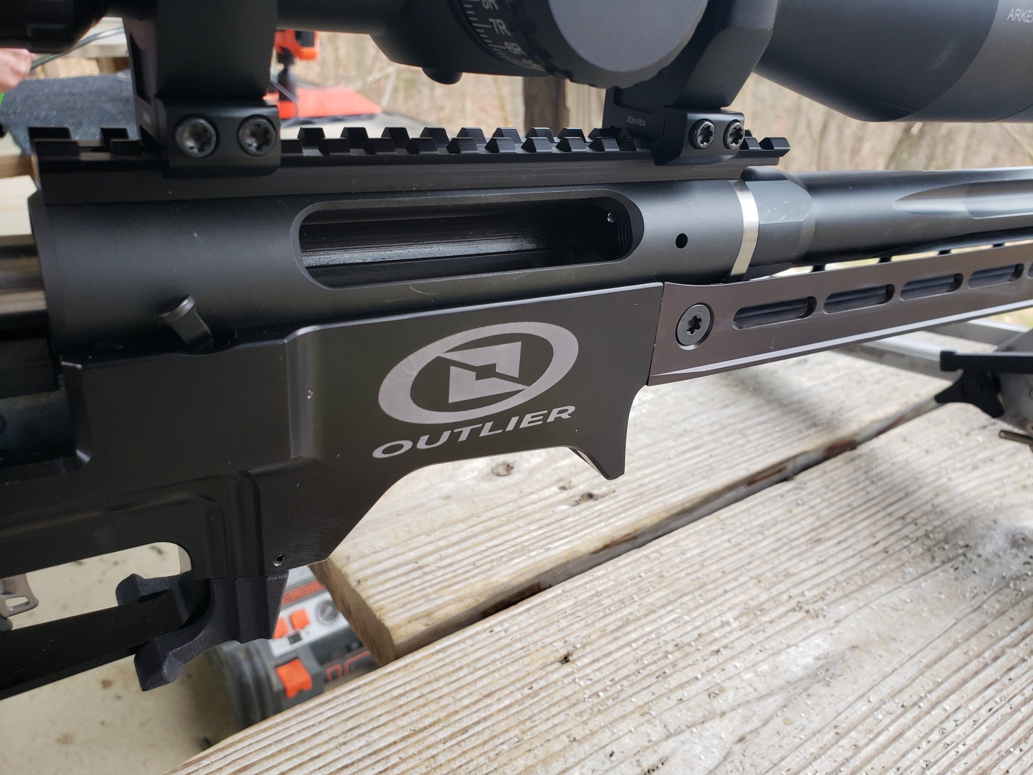

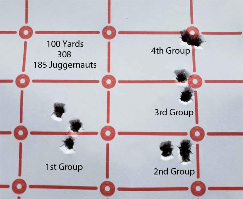

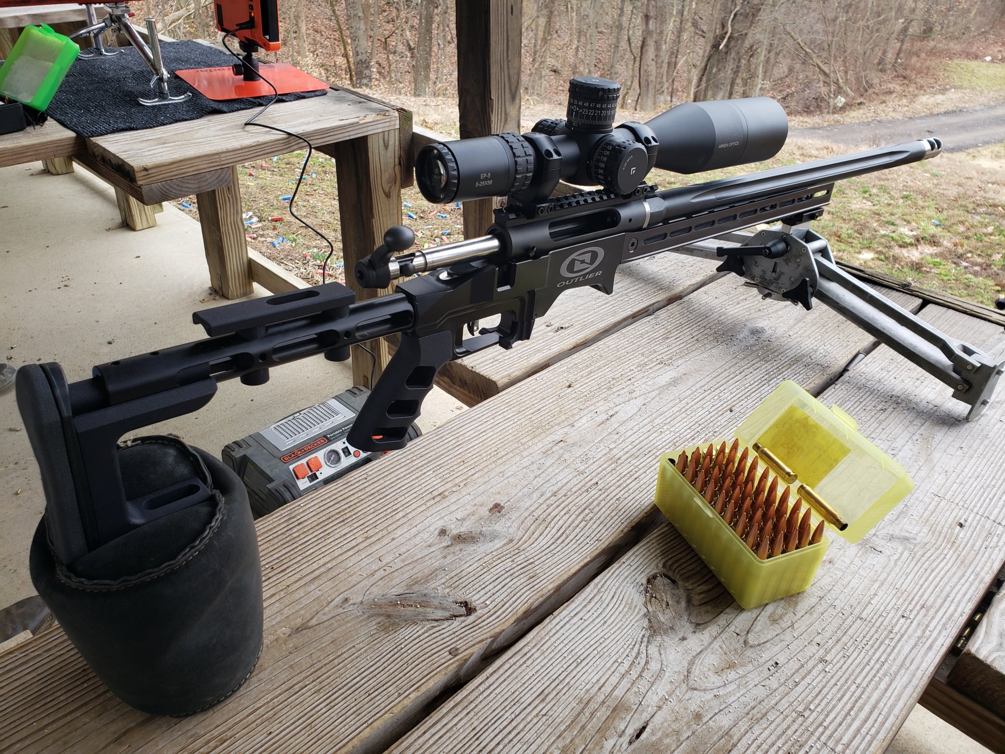

I'm presently testing an Axis II with an Outlier 308 Nitrided barrel and their Chassis. Really nice unit so far. Like most other Savages accuracy is excellent. The action isn't as smooth as a custom but for typical longrange matches most of us meer mortals compete in they can be competitive.
The groups are numbered in the order shot, took 2 shots to boresight and get centered. No break-in, no load development. 185 Juggernauts at 100 yards. 308 would not be first choice but that is what they wanted tested. 6mm or 6.5 is our usual choice.
We have a few Savages but this was my first Axis II, so far no complaints. As was mentioned in a previous post, we did machine the action to accept a match recoil lug. The factory trigger was played with and is adjustable to well under a pound and super crisp if so desired. This system was designed as an entry level setup without breaking the bank.
https://getoutlier.com/products/

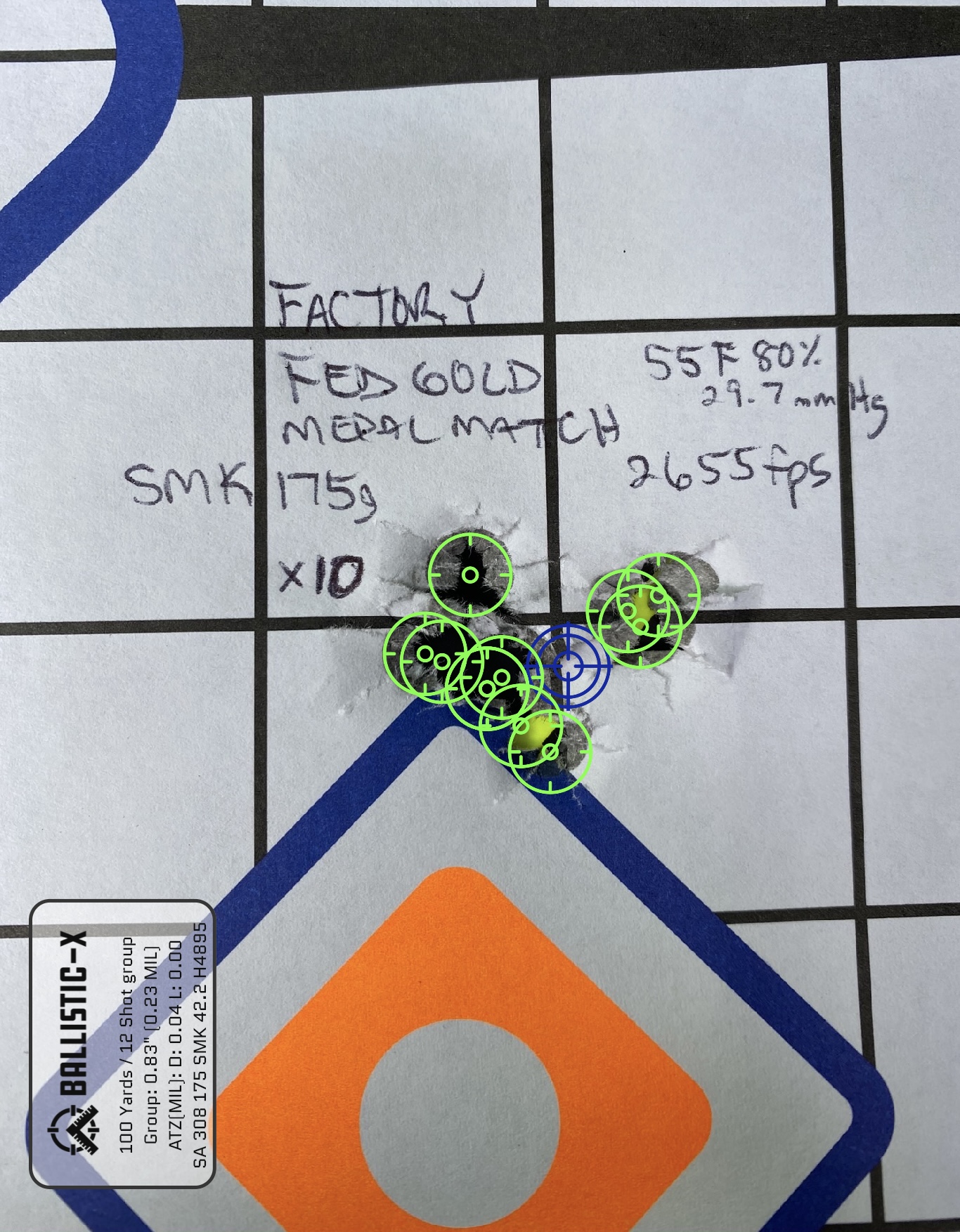

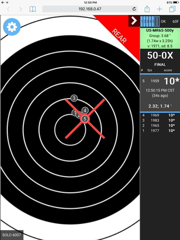

Update on mine. Well got to load test Lapua SRP 2x fired brass now, trying a softer load at five hundred yds a few weeks back after vintage rifle course match. Found a few good nodes and this one screen grabbed as I fired it on the Solo target. Got caught up in hitting steel so Only have this one load test on target. I pushed shot 3 up. For a mostly stock AxisII Precision off a bipod and a Taylor rear bag, I think this load will work. 140 ELDM 20 though off. H4350, Lapua SRP, CCI 450. Had Magneto Speed on the rifle while testing.
