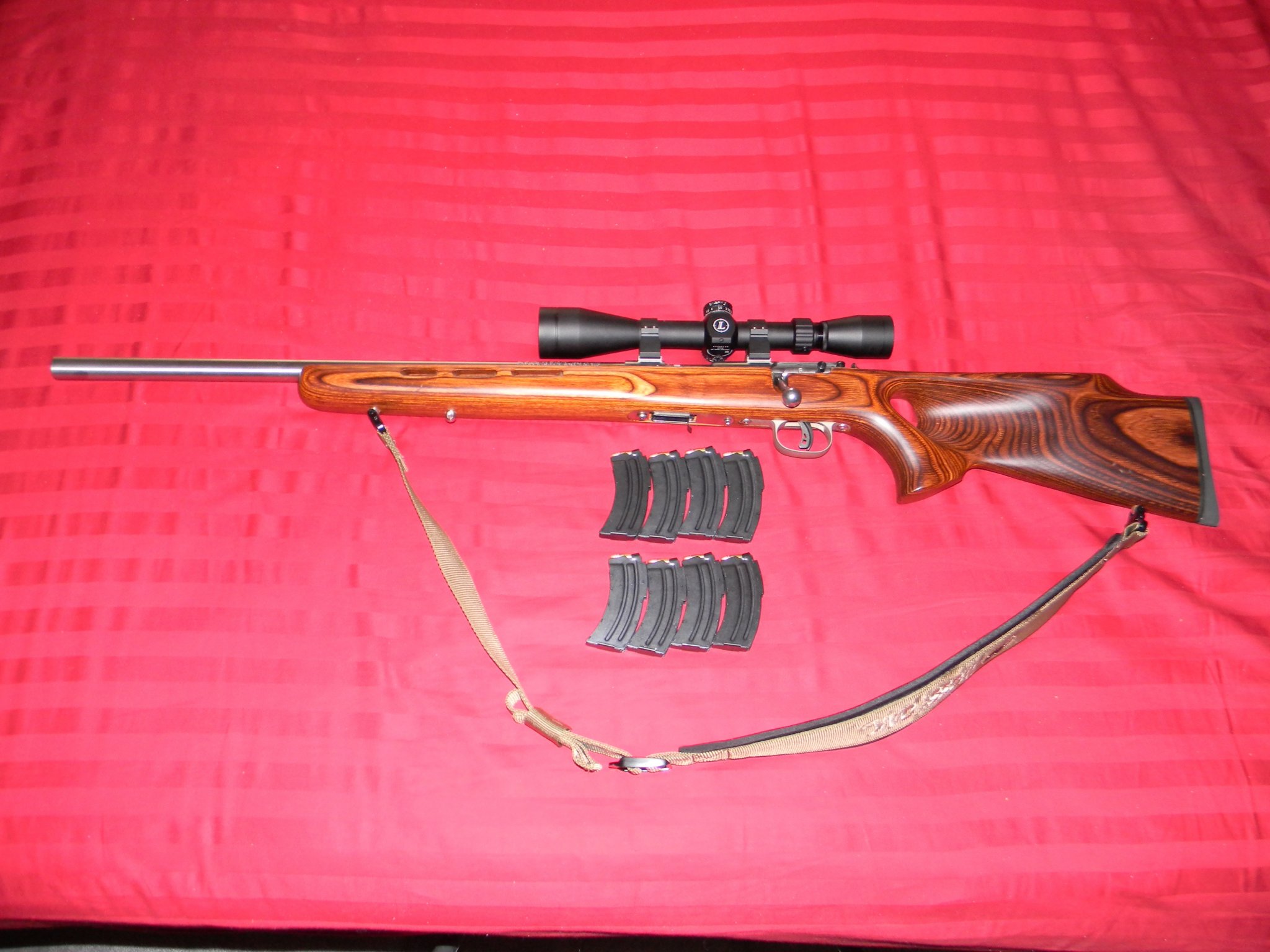

I have a Savage MKII , All I did was to replace the stock, and made a new bottom metal .
People watching my niece, and nephew hit clay pigeons at 225yards with it at the range, priceless!
