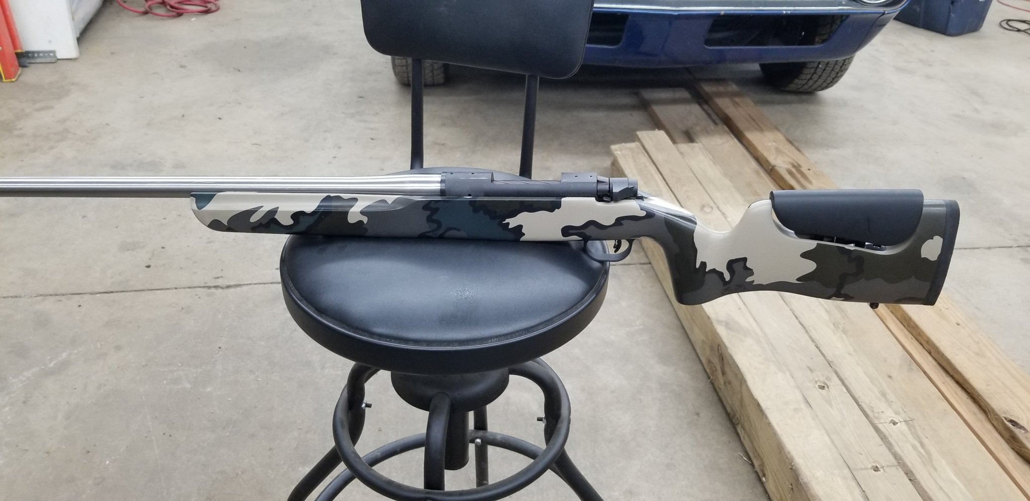

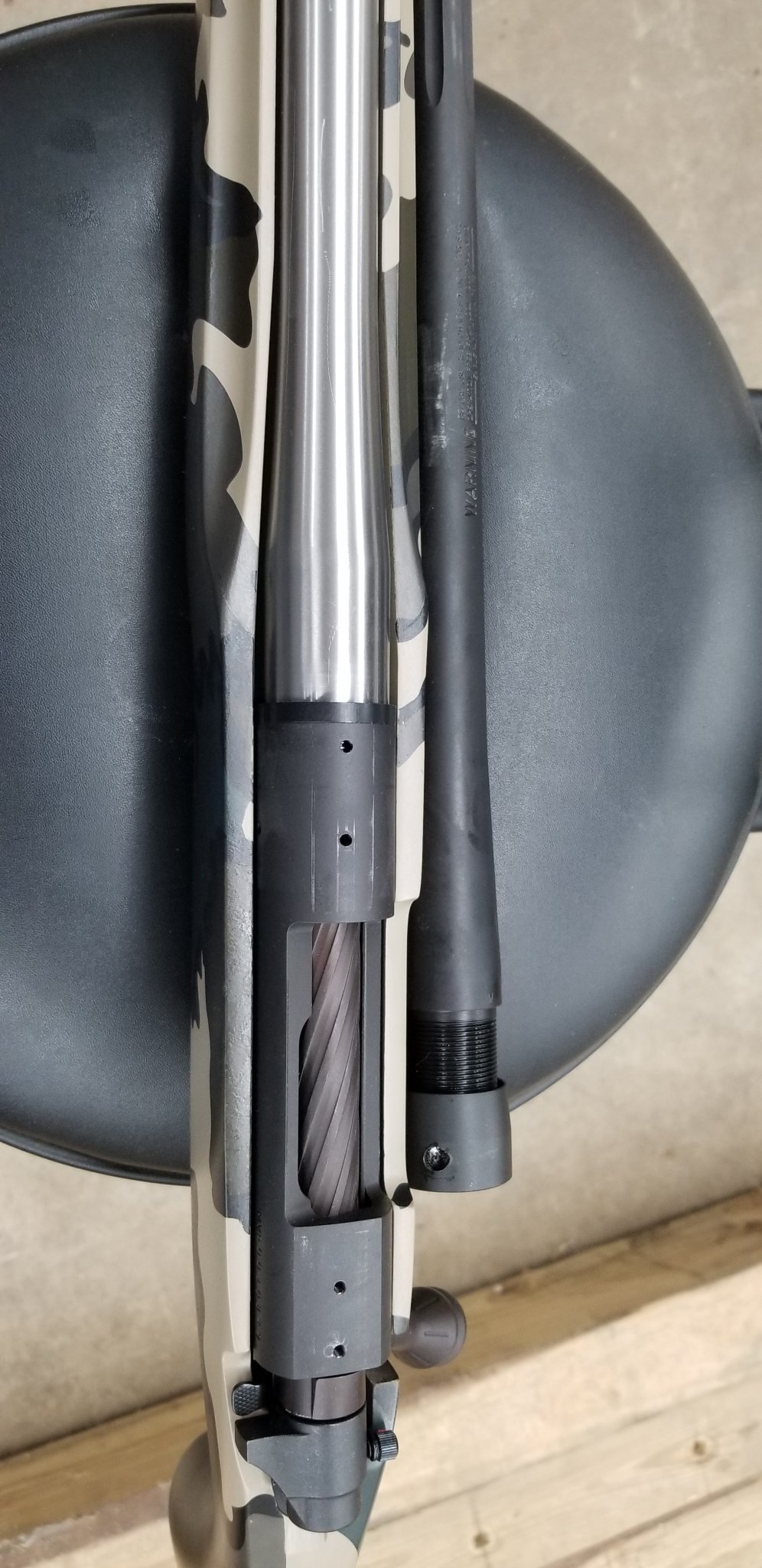

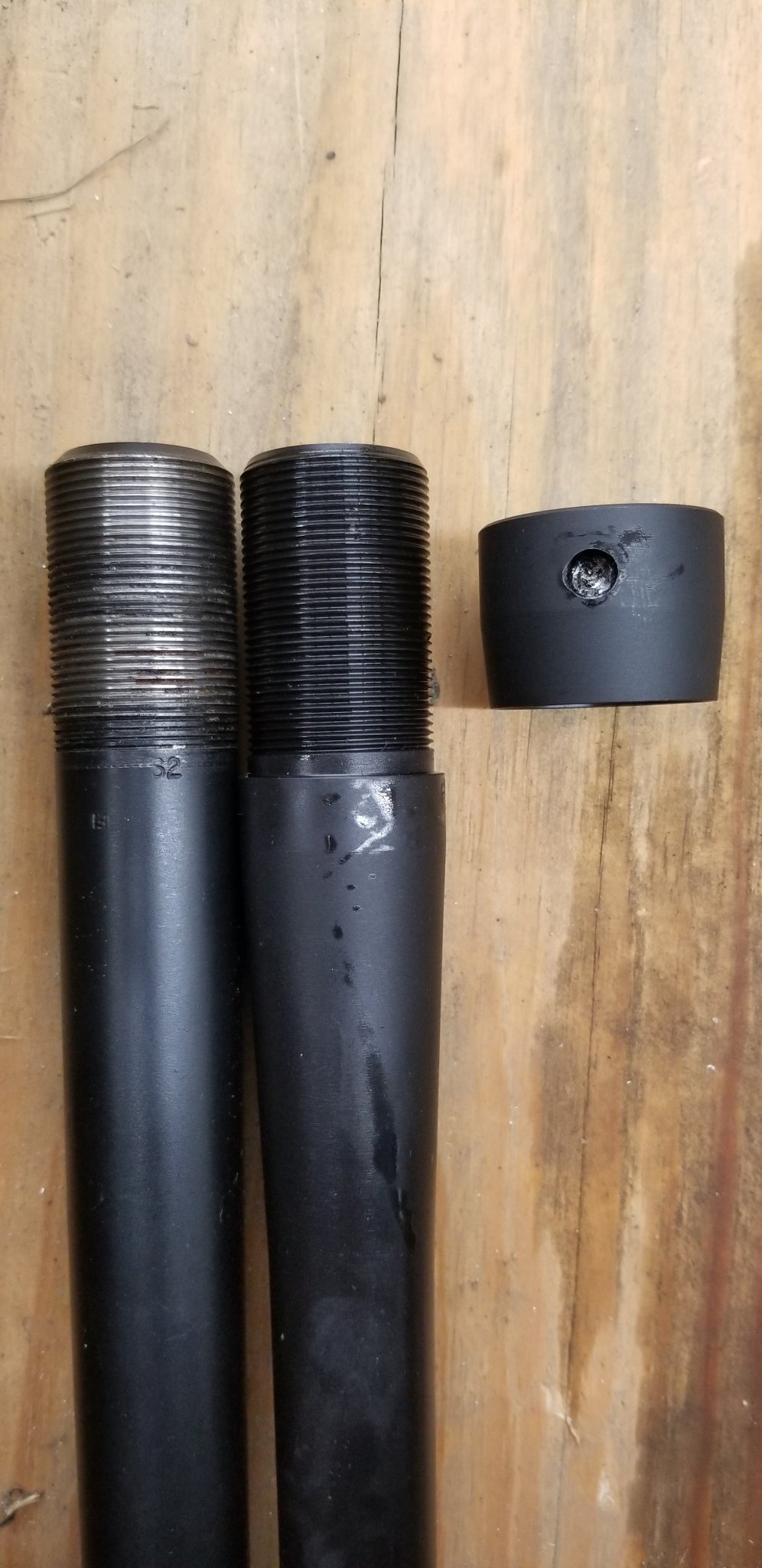

I have a take off barrel here it you need some measurements? We switched this one to a no nut barrel .
Look at the picture I posted above that's a Mossberg barrel next to a Savage barrel see how the diameter tapers up on the Mossberg barrel and the savage is straight ? The front of the Mossberg nut is hollow to fit over that taper I should have snapped a picture to better explain .
