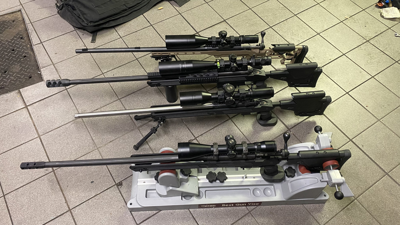

These are some of my Savage rifles.
The 6.5 Creedmoor is the FDE one.
It is a $540 Canadian rifle in an MDT LSS-XL chassis totaling less than $1300 Canadian without optic.
