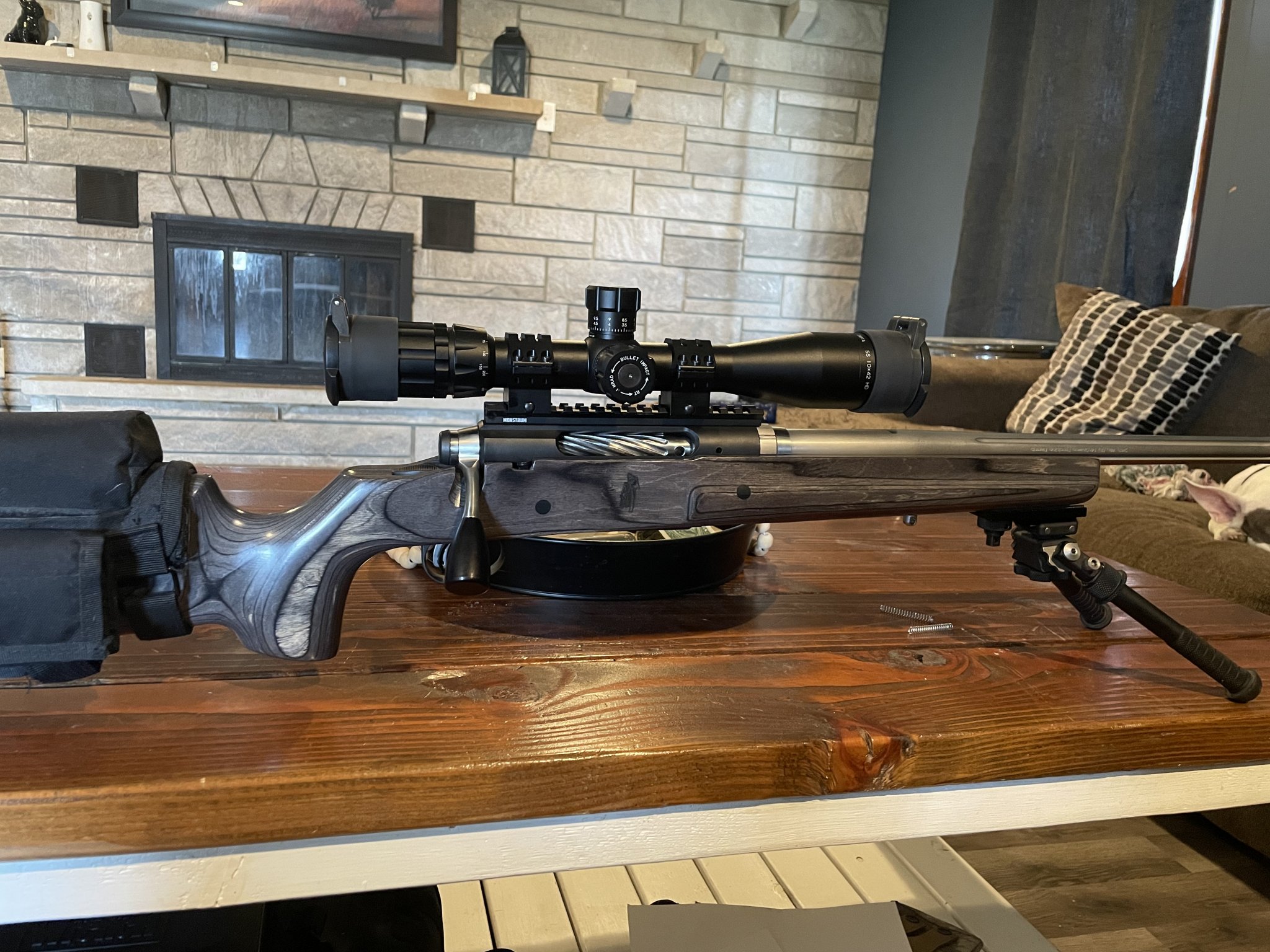

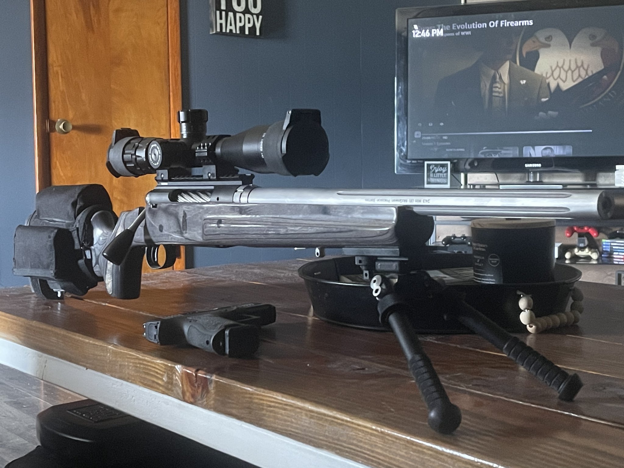

Hi everyone. I had a question regarding my new .243 build. Used the search feature and couldnt find anything that helped. I just installed a new barrel on my savage axis .243. Whenever closing the bolt on the go gauge the bolt closes perfectly smooth, and doesnt close on the no go gauge. I thought perfect until i went to chamber a federal 100gr blue box round and the bolt still closes but is kind of stiff. I have never encountered this after using a set of gauges so i was wondering if my headspacing could be too tight and is the rifle still safe to fire? Any help would be greatly appreciated

Like ledzep said, determine where the interference is. Not uncommon for ammo to be at or slightly longer than a Go gauge. Also not uncommon to have cartridges with a large neck/shoulder radius, which can interfere.

Tried several from the same box but somewhere i have some hornady rounds i will try. Its not like crazy tight to close but it is noticeably stiffer going down with the bolt than with the original savage barrel but only with the live rounds ive tried. Go gauge cycles perfectly normal. Mainly i want to make sure im good to fire it because this has never happened to any other rifle ive had and was hoping for input. I will try the sharpie trick tonight and see if i can tell where its contacting
I did the sharpie trick and there a couple hairline streaks going lengthwise which i assume is because its a new barrel and it may have some kind of roughness, then there is another very light mark all the way around the very base of the shoulder. No marks on the projectile.
Tight headspace is a functional issue. If they chamber and you're OK with a little resistance, you shouldn't have any issues other than the resistance.
You should also have a window between GO and NOGO... So you could screw it down on a NOGO, mark a sharpie line on the nut and barrel, then do the same with the GO gauge and make a new sharpie line on the barrel to see what the window is. Bump it 2-3 thou over GO and you'll lose the squish. 7 degrees per thou roughly.
As long as a NOGO doesn't close when you're done with it.

Have an update. Went ahead and said screw it and shot the rifle after quadruple checking the headapace with gauges. Barrel break in couldnt have gone better. Consistently the rifle shot a 1 inch group using crap .243 federal 100gr powershock. After a few rounds the cases got much easier to cycle and no signs on the fired cases of issues. Very happy with the build overall. Now time to develop a good load for it.
