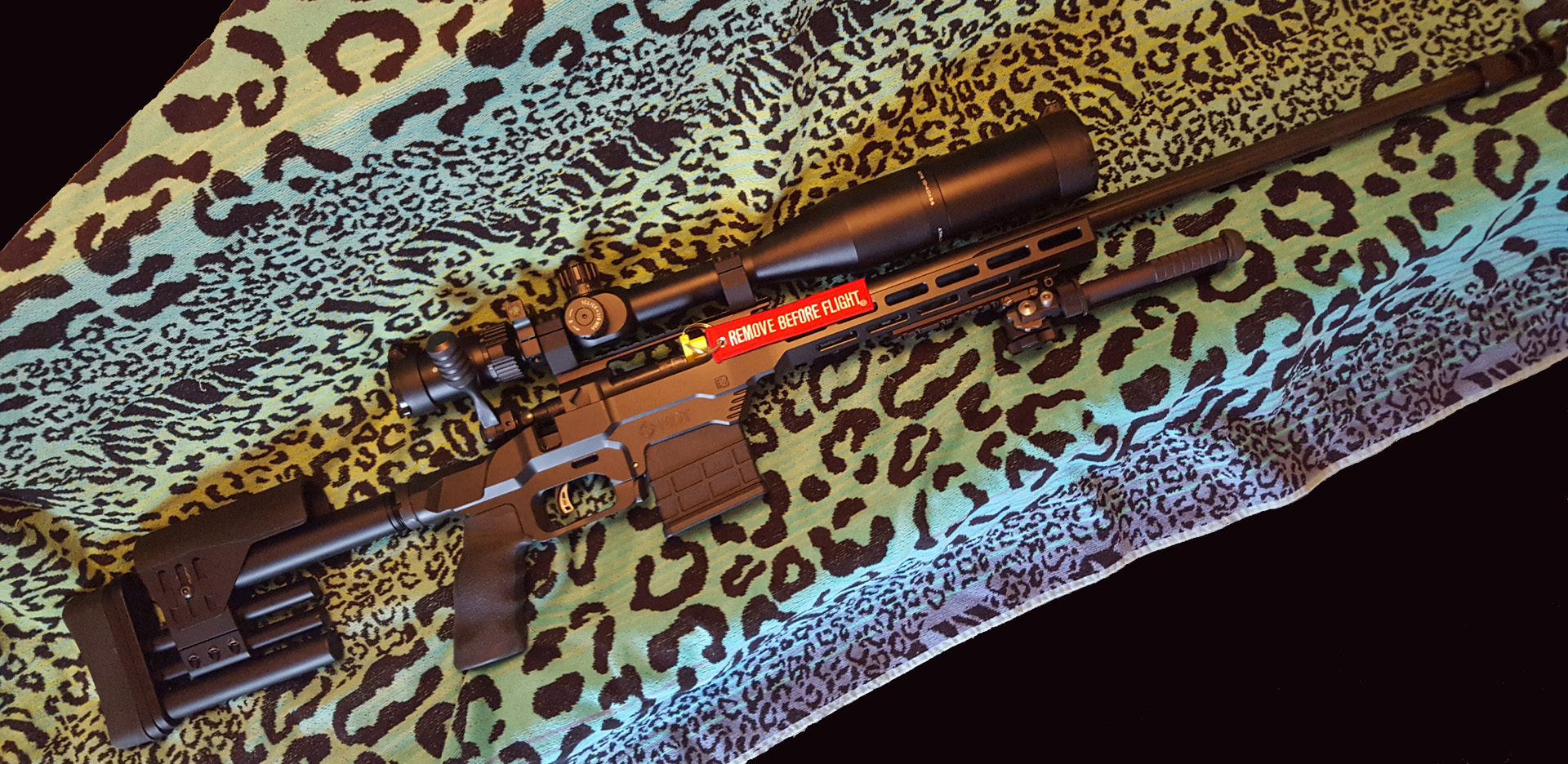

The action on my Savage 10 FCP-SR improved dramatically when I put it in a chassis and started using AICS magazines. Don't know it that would help in a Long Action or not but suspect it will. It'll never be as nice and tight as a higher end action but the gun is a .75 MOA $2000 gem including glass, bipod, rings, vertical grip, butt stock, muzzle brake, etc. I'm not worried about putting the money into it as I'll never sell it so don't have to worry about resale value.
Savages are what they are...mine is my first precision rifle and my nephew/shooting partner and my brother both shoot my FrankenGun Savage better than they shoot their high dollar, super duper rifles. They bitch about the level of smooth and tight but when it comes to the shooting part they are pretty amazed. Bang for the buck it's worth a try to put yer Savage in an MDT chassis and see if you can use the better magazines to tighten things up.

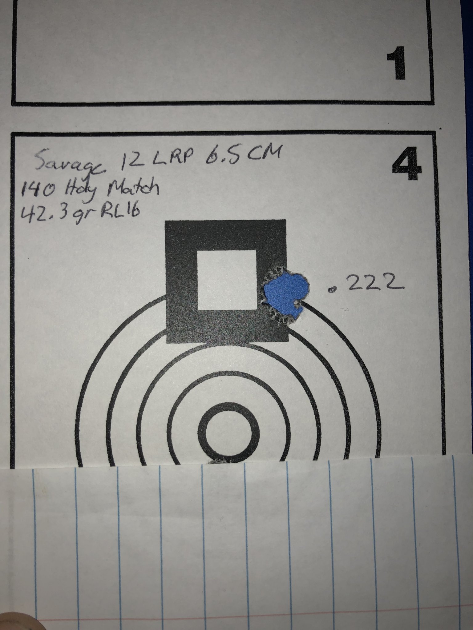

A couple of years ago, I figured out that the best thing to do was to put the money I would have spent on upgrading my 12 LRP Savage towards buying my Tikka...
Never been happier and I don't have to make excuses.
My 2011 production 12 LRP is a shooter, but it ain't the same as a Tikka. The world has changed since 2011.
I contemplated new bottom metal and / or a chassis for the Lurp, but the cost of the upgrades were getting closer to the cost of starting over.

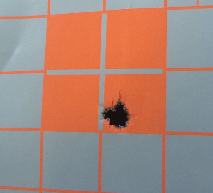

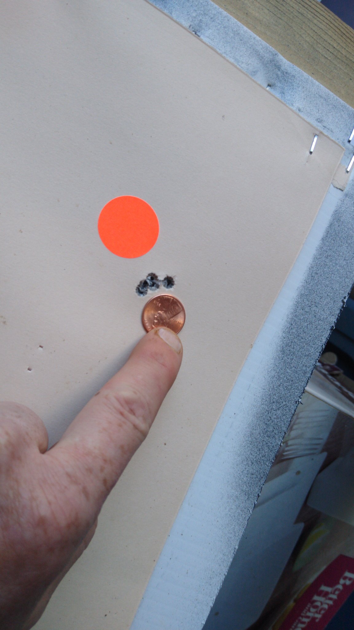

800 yards!! Savage 110 tactical desert 6.5 creedmoor 130 vld 42.8 stable 6.5 Hornady brass br-2 primers and about 45 minutes each to carefully make everything perfect as possible SD 6 ES is in the teens this was the first of consistent sub inch and a half group's 800 yard group's it shot after load development was done.thers 5 shot's in there hard to see in picture.my kid shoots those groups I'm not that good yet maybe never will be lol people stop talking to me when I tell them about this they assume I'm just making it up

point of impact at 800 is less than a inch off once we got it diled in.not all my savage rifle's shoot this good and this one shoot's anywhere from 3/4 to 1.5 moa with factory ammo but with careful load development it shoots better than any sako Or tika that I've ever shot.my 22 250 Savage Axis with a JB weld filled stock and Timmy trigger shoots 3" at 600 yards after load development but it shoots 1.25 moa and bigger with most factory ammo I'm a fan of savage but they require very precise load development you can't just load 10,000 off the lands and expect them to shoot it's 80-200 shot's to find it's full potential
Consistent handloads tailored to the gun make a world of difference. That, and perfect shooting conditions.

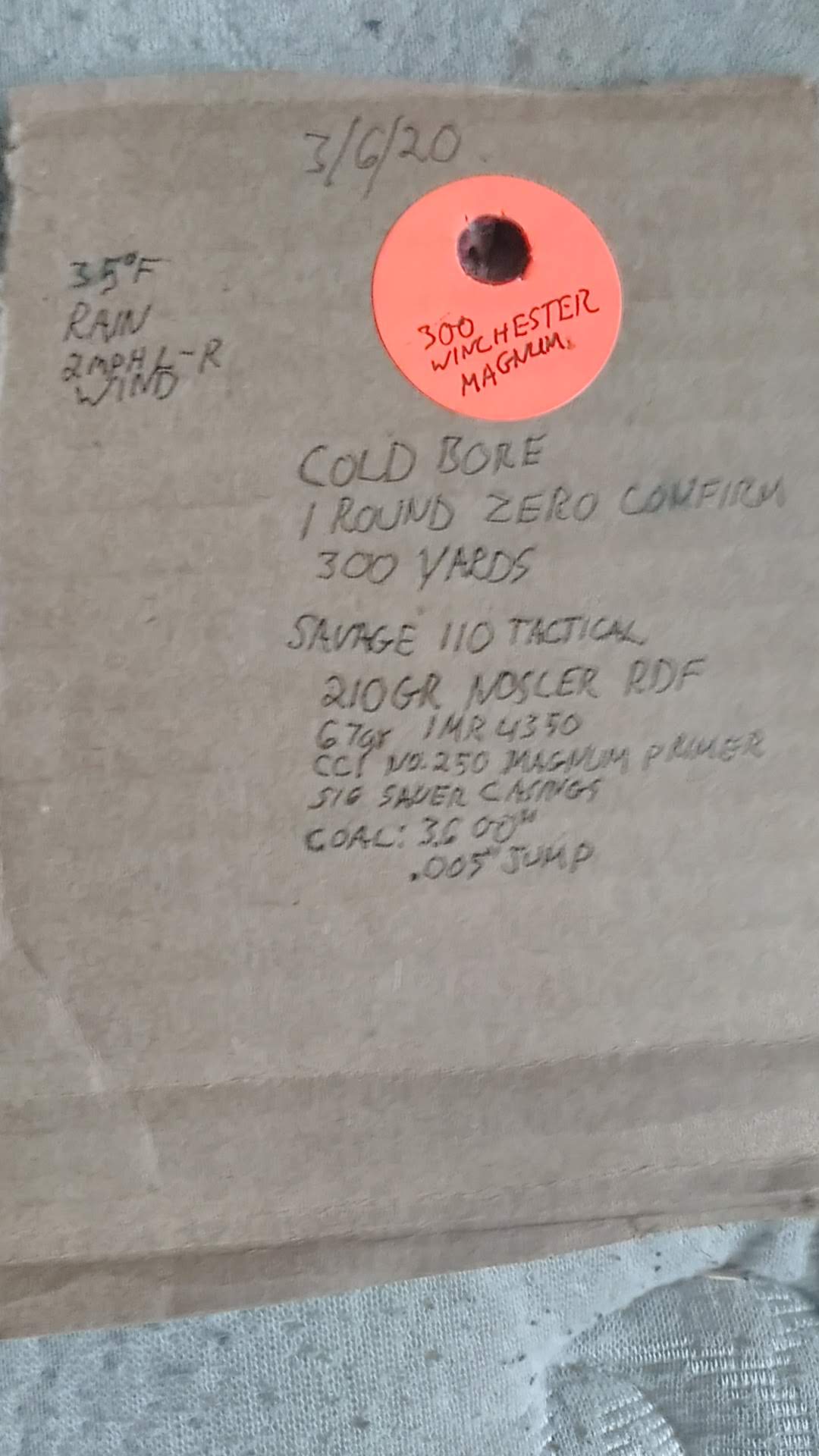

I know I’m late to the party, but this thread was the one that made me finally register.
Don’t let anyone tell you savages aren’t any good, or are limited to “what they are”. When I was younger I let someone more seasoned convince me of this.
My uncle who is an avid elk hunter and has hunted just about every game animal in North America laughed at my (unsubstantiated) opinion of savages, and let me borrow his 10 FCP HS precision. The very first day I shot his rifle, I was hitting an iron 25lb player at 760 yards in the Nevada desert in July. The scope wasn’t mounted for my build, I was adjusting to my uncles.
Had it not been 105 degrees out by 11am, and had some quality ammo, I’m sure I would have range 800+ yards.
Yes, the bolt has a lot of tension on it during the upper half of the rotation to cycle, yes it has a touch of wobble and running fast I have jammed. But I was trying to run the bolt fast way sooner than I should have not having developed my technique with this rifle.

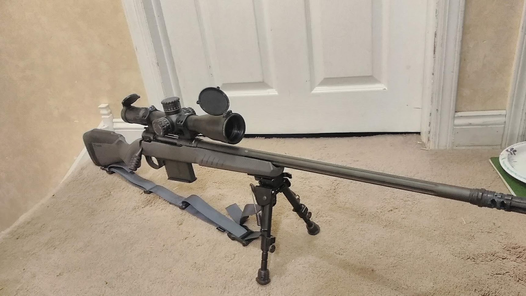

View attachment 7315024View attachment 7315025dont get me wrong, my 110 is pretty much as good as its going to get. I guess im just so used to my Savage 10 FCP-SR bolt (well broken in +2,000 rds) being nice and smooth that my 110 just feels rough and sloppy.
