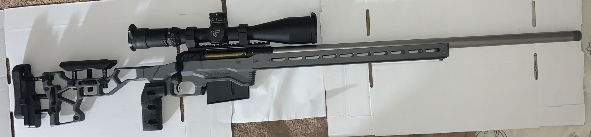

Weight:
Barreled action with trigger and thread protector - 9lbs (8.989)
Chassis - 5.5lbs (5.527)
Magazine - 0.5lbs (0.511) - Empty
Rifle 15lbs. Savage states 14.95lbs.

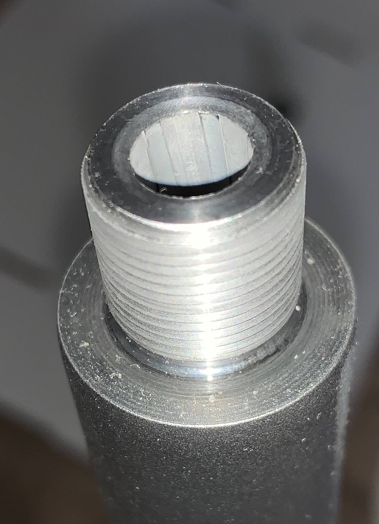

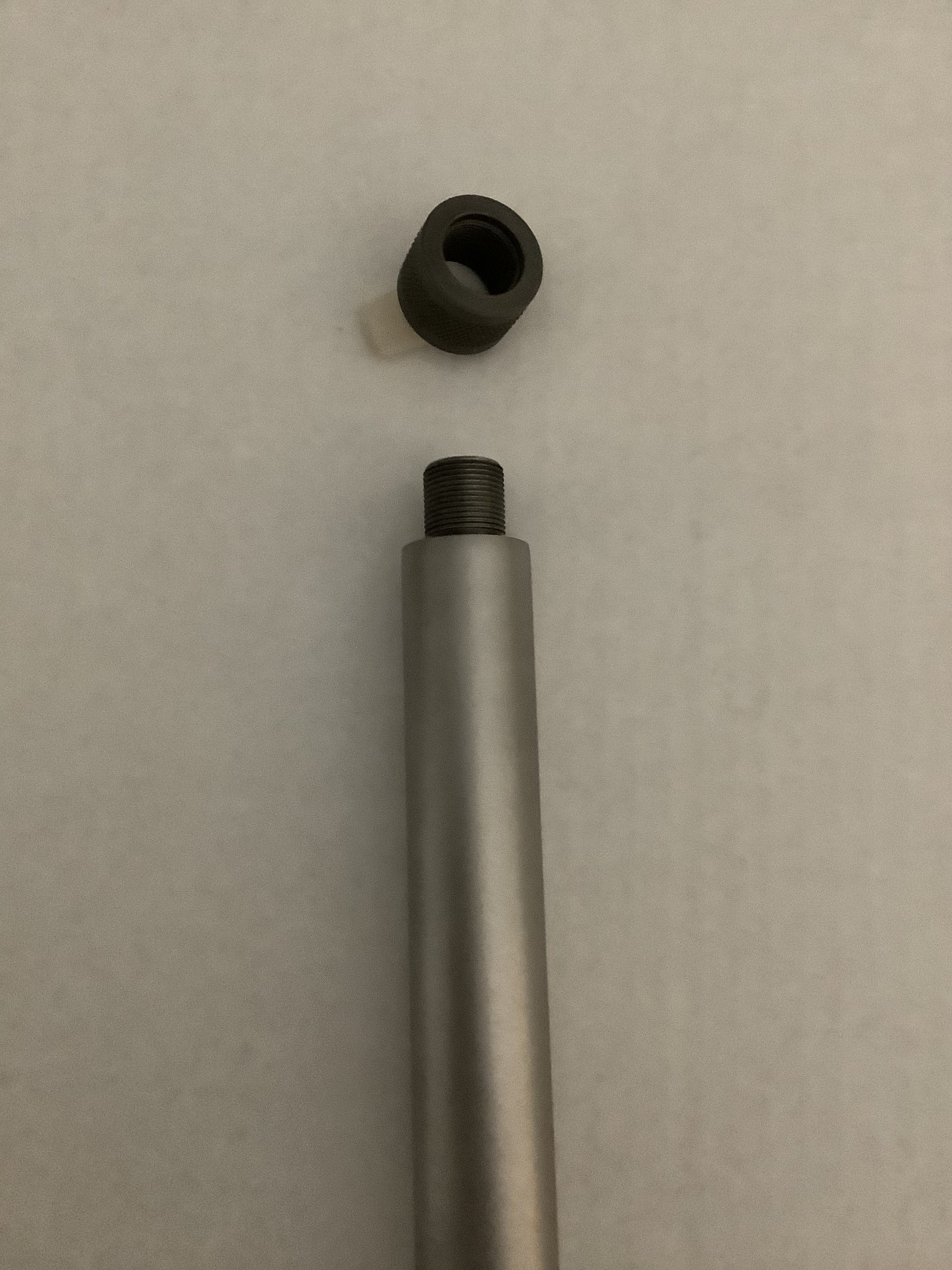

Muzzle and thread protector:
The first thing I noticed was the lack of a muzzle device. After re-reading the description, it was clear that they were only included on short action rifles. It did come with a thread protector that I find more useful. Savage muzzle brakes are not bad, I would just never use one unless it came on the rifle. The threads are not Class 3 and the thread protector stopped short of fully seating. Some crud was left on the threads making it gritty to remove/replace but a quick clean up made a nice fit but it still did not seat flush with the barrel. These are things that I really would not expect of a rifle in this price range. If you want everything perfect, go with a $4k to $5k package. I do not know the crown angle nor do I have the tools to measure it.
The muzzle brake on my Stealth was on so tight that I ended up turning the barrel out of the receiver removing it. That was my fault although I do not believe they needed to torq it to wherever they did. I was even worried that it may have distorted the muzzle/crown.

The chassis is an ACC by MDT with the Savage Logo. I found the chassis well made. The fit and finish are nice. Weighing in at 5.5lbs without barreled action and magazine you could call it heavy depending on your application. As a target rifle shooting 338LM, I believe it is where it should be as it does have the ability to add weight. The incorporated ARCA Rail is a nice addition keeping it with the times. While writing this I found this chassis on MDT’s website for $1100 + $200 for the paint job. You may be better off going there for info.

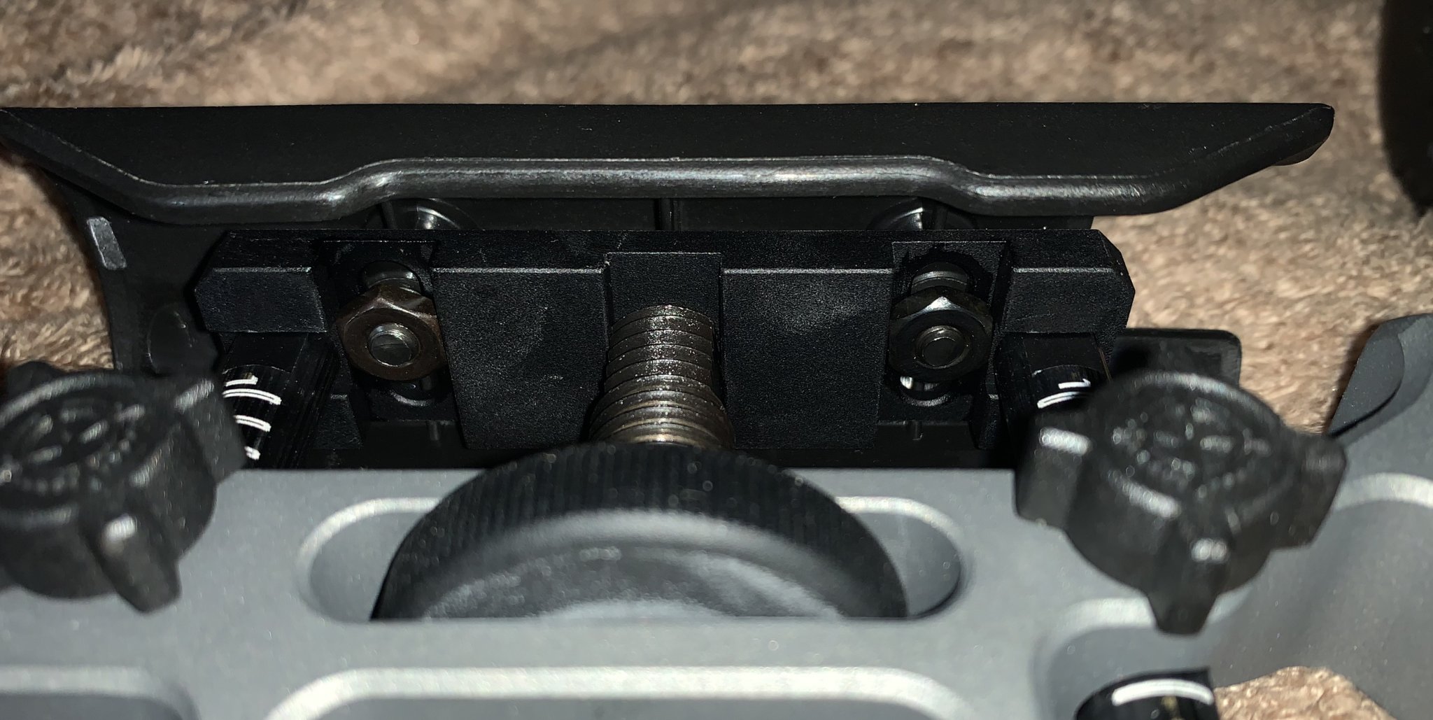

The finish and stamping were pretty good on the the receiver. The finish, unfortunately, did not match the rear baffle, bolt handle and assembly screw. My pin gauges are packed for a move so I can’t give the exact clearance for the bolt body/raceway relationship but the unnecessary slop you usually hear about on a Savage is definitely gone. I would say it is just about perfect. The raceway is very smooth with the black flash nitride finish but the titanium nitride finish on the bolt body seems gritty so it lacks the nice smooth operation of a high end rifle. I may measure it with pin gauges and have one made down the road to see if that can be improved. As with most most Savage bolt guns, the bolt lift leaves much to be desired. I really hoped that they were going to address that on this line.
When operating the bolt, there is a twang/ringing through the chassis that I don’t like but that is only when I am working on it. Any support like a bag, bipod or even a hand when set up to fire completely dampens it.
The recoil lug was done well. It is properly pinned. The MPA BA Competition has a wedge to secure the lug against the chassis. That would have been a really nice addition here. My Stealth had a slot in the receiver for a pin but no pin in the lug and was set a little under 10 degrees off center. Very poor workmanship. The lug on this rifle was nicely pinned with SS and well centered.

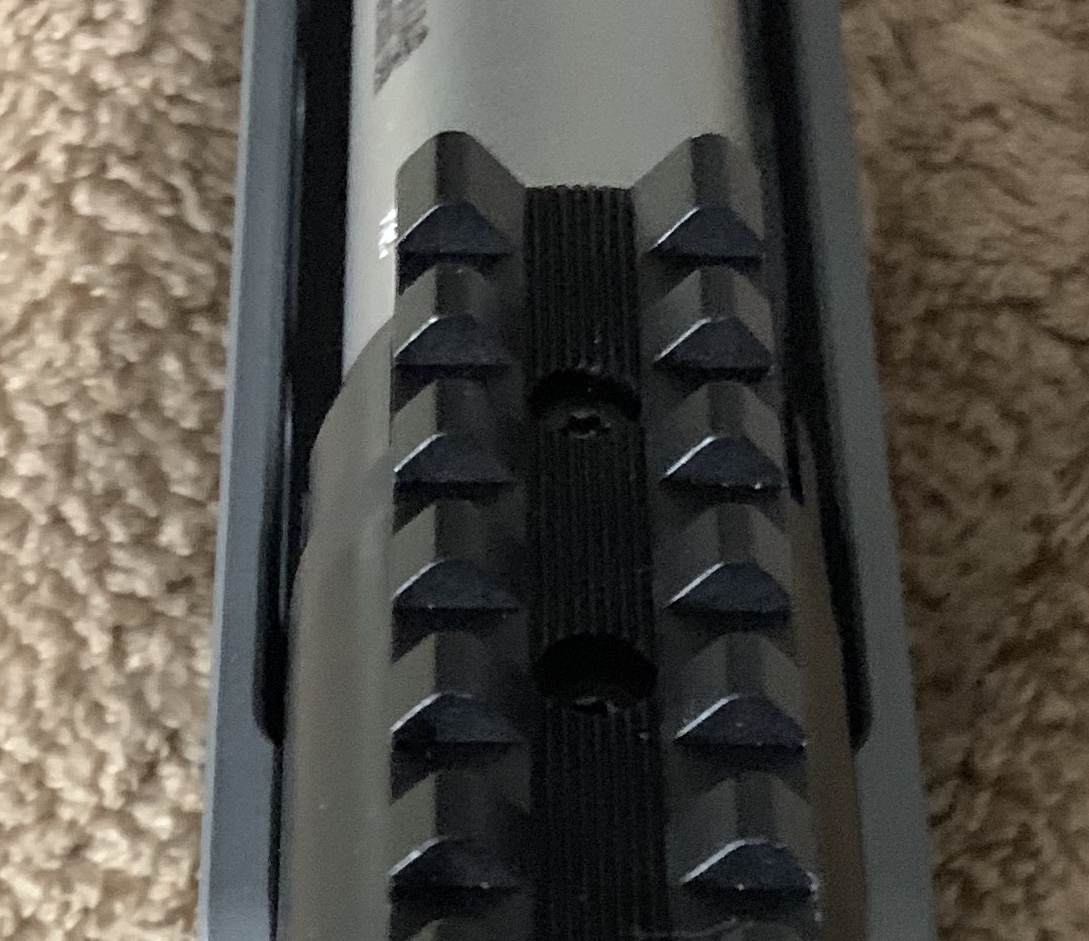

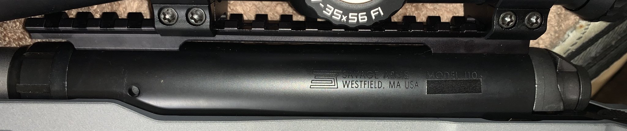

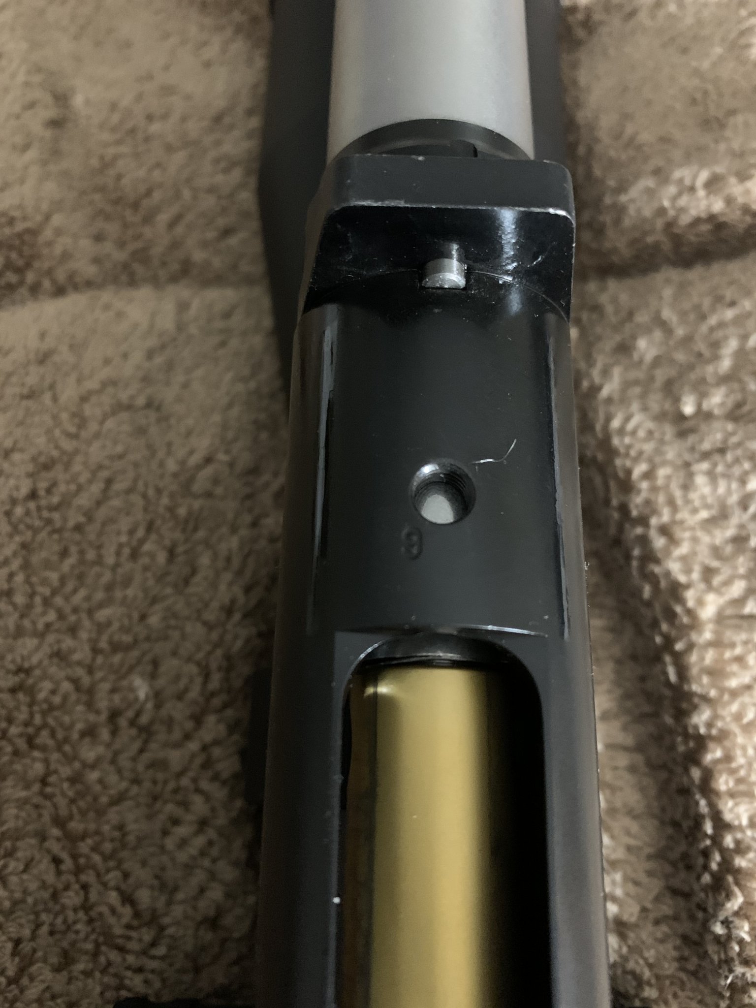

I have not kept up on the names of different Picatinny rail designs but this one is hollow down the center of the top which helps the scope slide slightly further rearward.
The rail has a number printed underneath the front overhang but I am unable to read it without removing the rail which I do not want to do. On the Stealth, I had continuous problems with the rail coming loose. After several calls to Savage, they sent me a new rail and screws but in the end, I picked up a Badger rail and custom fit some screws to fix the problem myself.
The front action screw is too short, it only threads in about 1-1/2 turns. I had this same problem with my Stealth. I will probably end up getting a longer screw and shortening it myself.

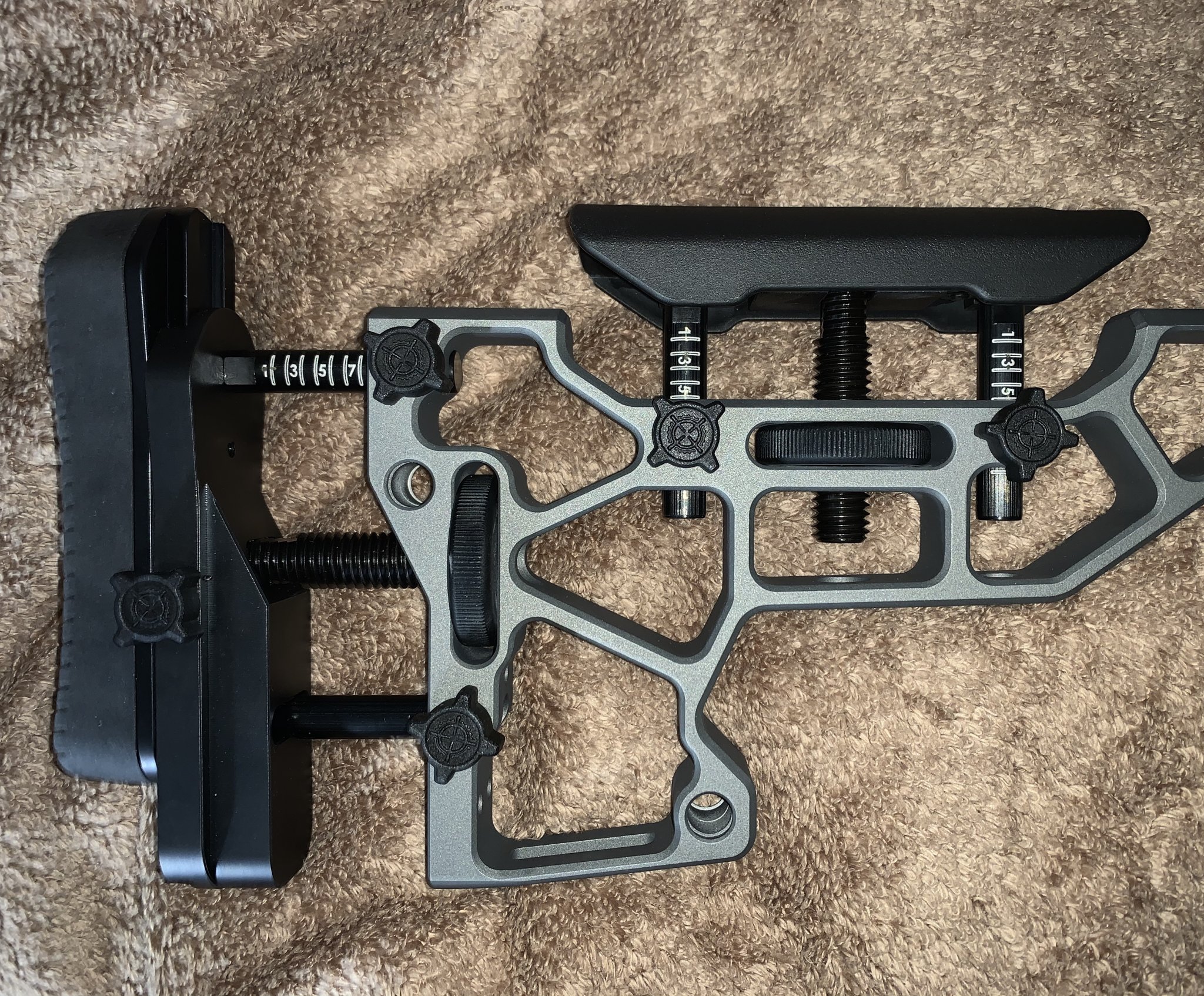

Stock:
The stock (part of the chassis) does everything I need it to.
I did like the ability to adjust the cheek piece from side to side. None of my other rigs allow that. Part of the cheek piece will have to be dremeled to remove the bolt without lowering it.

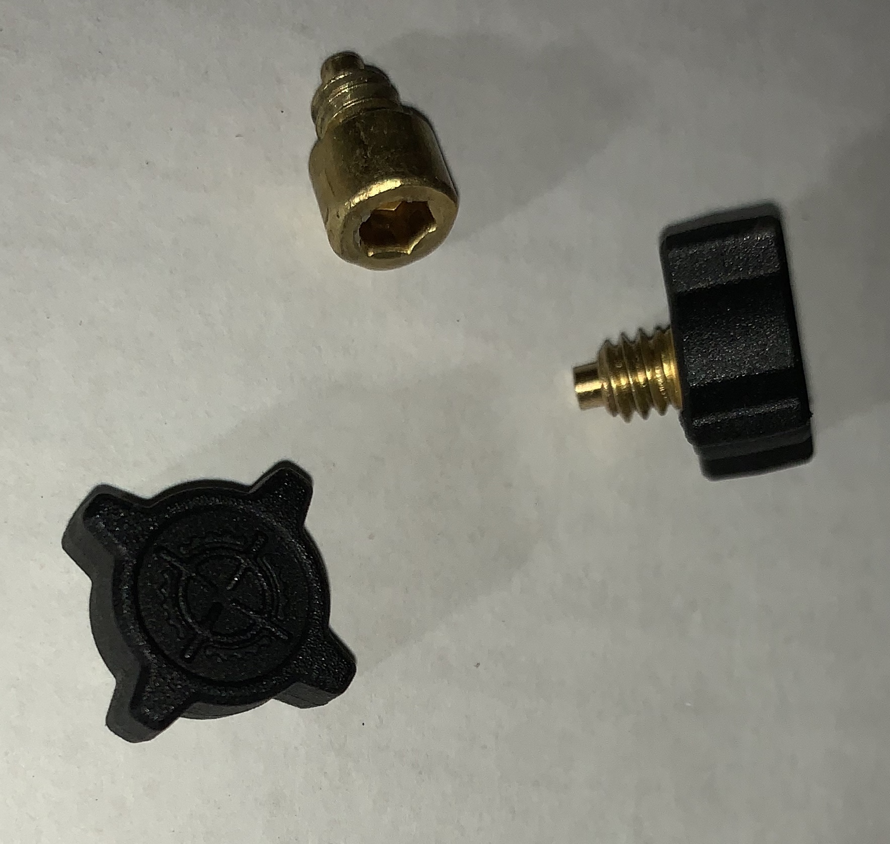

The thumb screws gave me some problems. On MDT’s website they appear to be machined aluminum ... these are not. The butt pad adjustment screw (up and down) keeps getting knocked loose. You can carefully pry the plastics knobs off leaving the brass colored screws but you loose the ability to adjust it without an wrench. 5 thumb screws and 10 holes come on the rifle. 5 on each side as a mirror image. I might get some extras to fill those in as well as help secure the components.
The butt pad adjust (LOP) and cheek weld adjustment (up and down) have hash marks so you can keep notes on what works for you in different scenarios. You can purchase a kit with 4 spacers (1/4”ea) to extend pull length up to 1”. You can also purchase a folding stock adapter and a night vision cage.

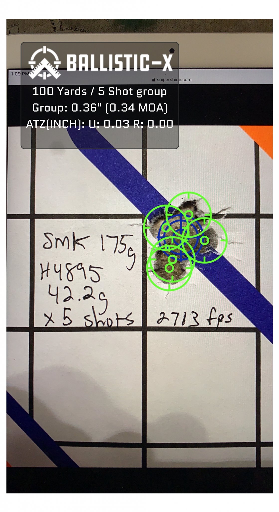

I just found out the number of pictures I can attach is limited to 10 although it stopped me at 9.
I will update when I have data but I expect 1/2 to 1 MOA. I will most likely get a custom barrel on order while I burn this one out. That will help me determine just how good the rifle is.
Did I get lucky? No clue. Will you? Same answer. All in all, I am very happy with it. After the disaster of my Stealth purchase, getting a nice Savage 338LM was considerably more expensive than it will cost most of you.

ONE thing I would recommend is to take you rail off and clean the screw holes, and then lock tight those screws in, mine did not have lock tight and the rail went loose after 50 rds. Based off your post I almost thought you were youtuber Boltactionreloading ha

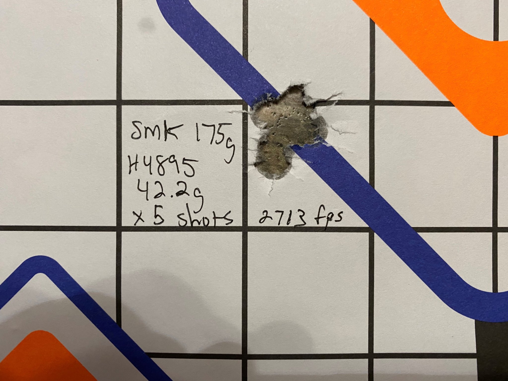

So Ive been waiting on load dev until the barrel finishes speeding up. But with the 300gr Atip, its getting 2900 with h1000 without any pressure signs at all, On an initial pressure test before break-in I got 2960 without any signs of preasure.
the barrel has sped up by 100 fps since then, so I am going to do some load dev this weekend, I would imagine 3000 fps will be my ceiling.
That's really fast for 300 grains! How much H1000? Wonder what retumbo or RL33 would yield... Still in the mkt for a 338 or big 300.
So 92 gr is getting me 2900fps, again with zero pressure. But that is virgin brass we will see how this week turns out.
H1000 should be faster than retumbo, rl33 would be faster but would not recommend it because of how temperature-sensitive it is.

P.S. Thank you for posting your picture of the front pic rail screw. I noticed mine was standing proud compared to the other 3 and I was concerned but I see from your picture that it is the same. Quite a relief!

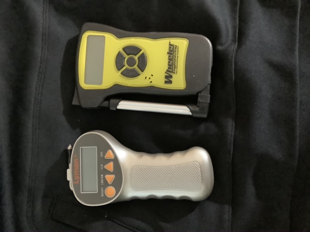

  3. Stand-up - I will be checking velocities soon with a V3. I’ll post when I do.

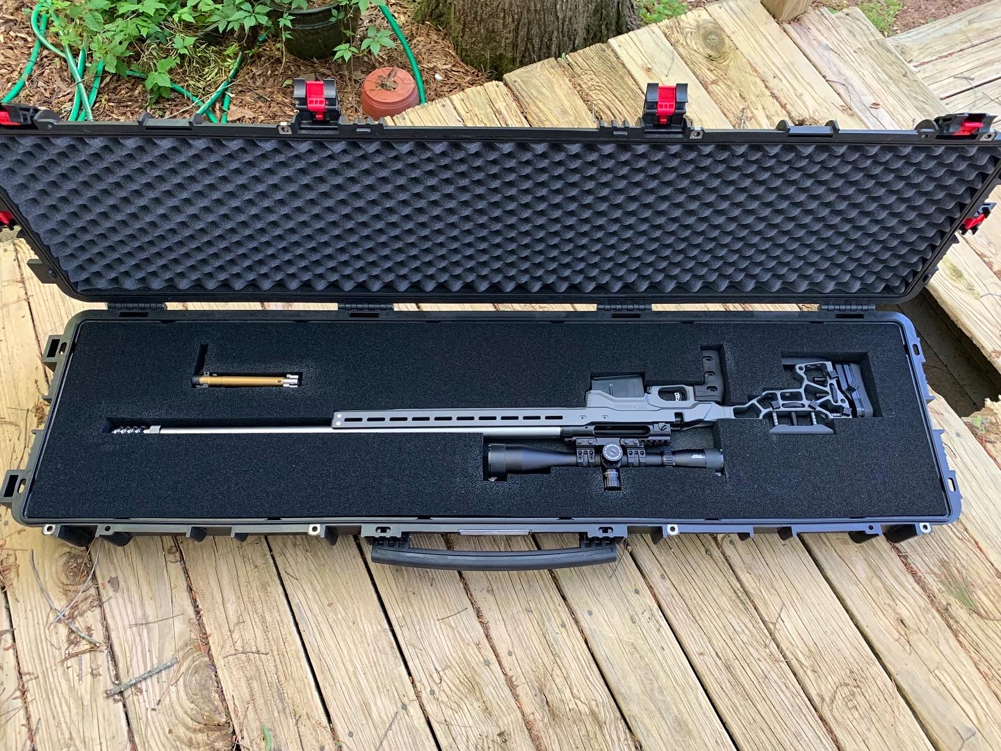

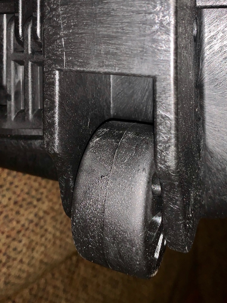

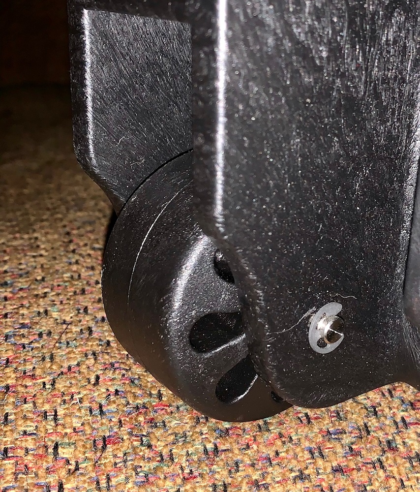

Morning! I really do like the Explorer case! It is hell for stout but a bit of a challenge to haul in my Toyota Yaris. 🤣

That is a really nice job you did with the foam!
How would compare it to the Pelican in terms of durability? Any chance you could post a picture of the wheels? Thanks much.
P.S. I found this stuff and am thinking about trying it ... https://www.fastcap.com/product/kaizen-foam. Off topic but nice for our hobby.
Thank you! It was pick n' pluck so I did the plucking and plastidiped the crap out everything and then used Devcon Wood Weld to glue the top and botton layers together. As for comparison to the Pelican cases... I couldn't find a Pelican that was long enough! The Explorer is specifically made for .50 BMG rifles and has 60.625" on the inside. Durability wise I think it can easily hold it's own against the Pelicans. I'll get some pics of the wheels when I get home but here's the specs...

FWIW since you mentioned .308
Savage Ashbury Precision Ordinance .308 24" barrel
SMK 175 gr bullet with 42.2 gr H4895
2713 fps avg
5 shots 100 yds, repeated several times

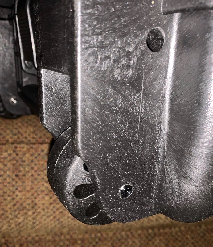

So... Wheel pics! Some assumption going on but they look like they are injection molded halves that are RF welded together, have bearings installed (way to smooth for plain plastic. A good flick with my finger and they spun for 10 seconds or so), and are retained with a steel axel that has a shoulder on one side and a E-clip on the other...
Hope this helps!
Reactions: MeasuredResponse
So... Wheel pics! Some assumption going on but they look like they are injection molded halves that are RF welded together, have bearings installed (way to smooth for plain plastic. A good flick with my finger and they spun for 10 seconds or so), and are retained with an axel that has a shoulder on one side and a E-clip on the other...
Hope this helps!
Thanks!! That’s what I was looking for. I wish I knew how to send a private message.
Reactions: nikonNUT
