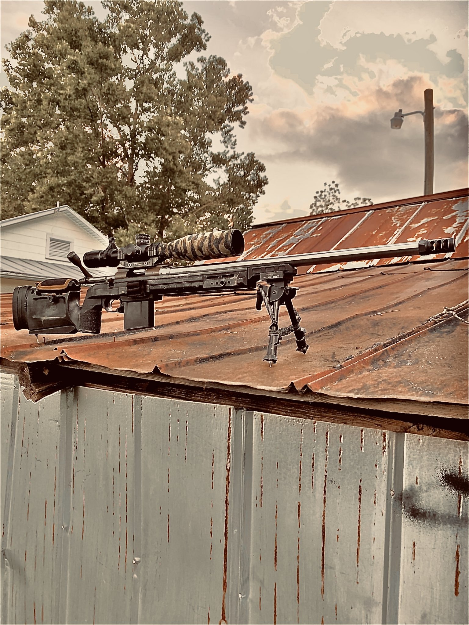

Of those two choices I would go 700 no doubt.. Here’s my budget .223 Remage project I just finished..
