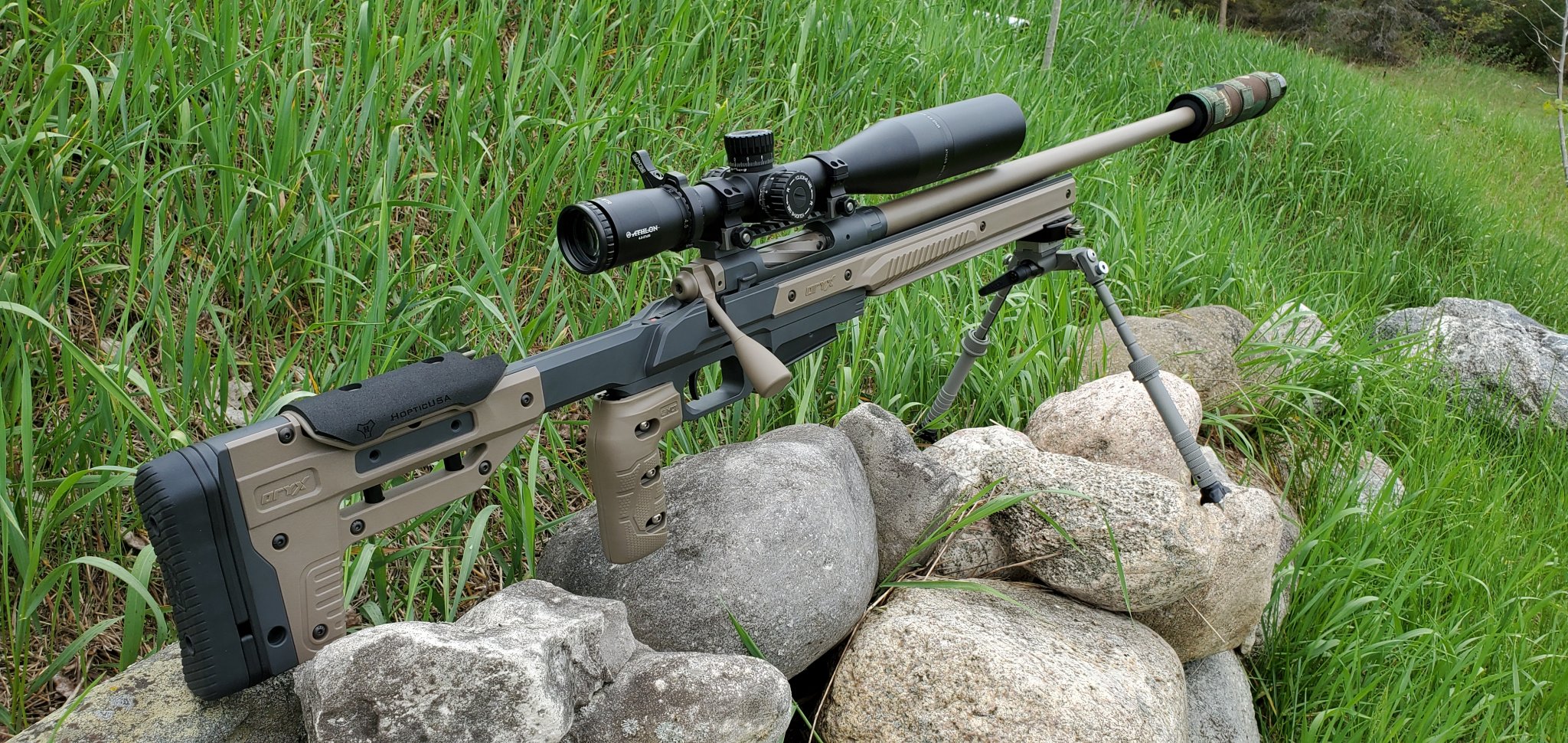

The Oryx chassis fits the savage and comes in right at $400. I have never tried a Savage in one yet, but they have been fantastic with Remmys and Howas.
Nice looking chassis!
Sadly, the pistol grip is so scary to the gutless city dwelling people who have given up their ability to think for themselves to CNN, that where I intend to house this rifle, that chassis is, I believe, illegal, and I don’t mess with illegal no matter how ridiculous it is. The KRG-B is fine, but they don’t make it for Savage owners behind the lines. I’m not sure if one could be modified, I’ll have to look into that.

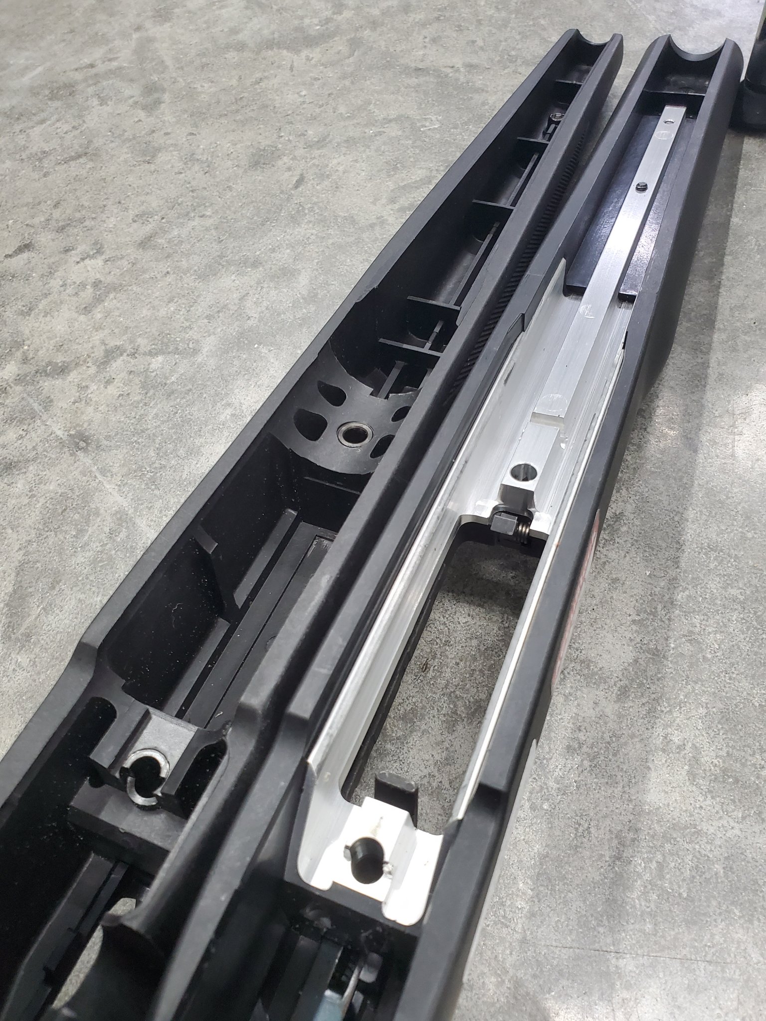

You could always also snag a factory savage Accustock .....much better than old flimsy plastic only stocks and has a factory detachable mag setup.
Here's old plastic only vs new Accustock with aluminum bedding

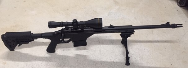

I started with a Savage 12FV from Cabela's. At first I put it in a Boyd's AT-ONE with a pillar and glass bedding job. I kept the blind magazine, so I didn't have any problems with stiffness or breakage. Topped with an Optika6 5-30x56 that rifle shot 1/2 MOA with Hornady factory 140gr BTHP ammo.
I kept upgrading it, adding an ejector kit from Kinney shooting supply and a bolt lift kit from PT&G. I also polished and smoothed everything I could see that moved. The accutrigger on the 12FV came with the lighter varmint spring so I was able to drop the trigger weight quite low, and it turned out to be a very good trigger. I shaved a little off the ejector to help with feeding and now it's a really slick action.
Earlier this year, wanting to be able to use AICS mags and not wanting to mess with shipping it to a gunsmith for inletting, I decided to swap it into an MDT Oryx. It already shot great, but it's even more solid in the Oryx. I upgraded the optic to an Athlon Cronus BTR a few months ago. That rifle in that chassis with that optic is currently my best shooting rifle. I don't even bother to reload for it yet because it will do 1/3 MOA with 140gr ELD Match factory ammo. (I will eventually work up a load for it, but I'm having too much fun just shooting it for now).
I love the Oryx, but it was very good bedded into the Boyd's stock also. If the pistol grip is a problem MDT now offers the XRS for the SA Savage. My Savage was a good rifle to start with, but with a little work it's become a great rifle IMO.
