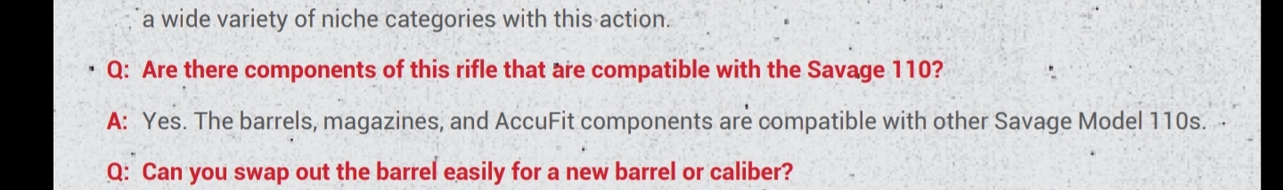

would a 110 bottom metal fit the savage impulse? Savage sales rep didn't know anything about the rifle and I got tired of waiting on hold for the custom shop. If the magazines and accufit components are compatible, is there any reason the bottom metal wont fit? I know the impulse predator uses AICS bottom metal, but I cannot stand the camo. I'd rather buy the impulse big game (which is cerakoted as well) and use AICS mags.
I spoke with the custom shop. It’s evidently not compatible. Not sure why. I’m considering buying an aftermarket aics mag well for a 110 and seeing what it’s going to take to make it work. I’ll let you know what I figure out.
