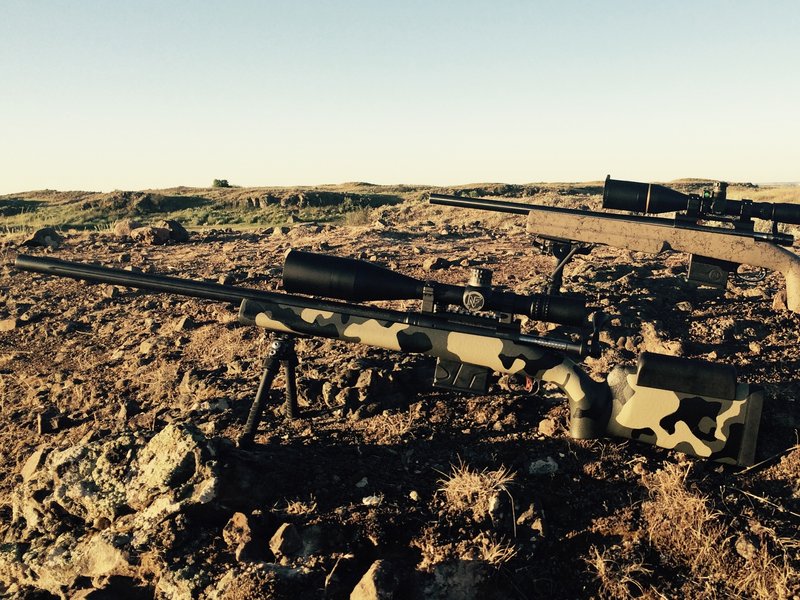

I went with a Ken Ferrell 20 MOA base...PM me for any specifics.

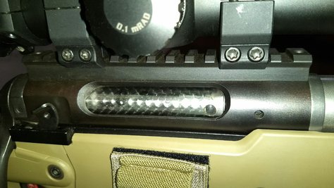

Have both Model 10 FCP HS Precision .308 and Model 12 LRP 260 Rem HS Precision. - both have both have same SA and installed Nightforce steel base Mfg. #A168 style 20 moa 6-48 (Brownells 749-012-02WB) although you can find multiple places on net. Used NF heavy duty scope rings and even change scope from rifle to rifle with slight check of zero each time.
Thank you Jarhead, but when you say they both have the same SA action, are you sure? I was under the impression the FCP series SA's were "open top" whereas the LRP SA was a closed top, meaning you could if you wanted use a recoil lugged scope base on the FCPHS but not on the LRP. I'm guessing you used a non-recoil lugged scope base on both. I'm heading over to Brownells now to see if I can get an order placed. Thanks again Jarhead. If no luck there I'm probably going to go for Bench Source or Farrel but I was originally avoiding those because of how freaking tall they are compared to the others I've run.

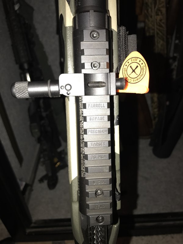

I'm using farrell 30moa base with seekins rings
[IMG2=JSON]{"data-align":"none","data-size":"full","src":"http:\/\/i984.photobucket.com\/albums\/ae324\/Bach17\/Mobile%20Uploads\/IMG_20170804_220955836_zpszwwbbwm5.jpg"}[/IMG2][/URL]
