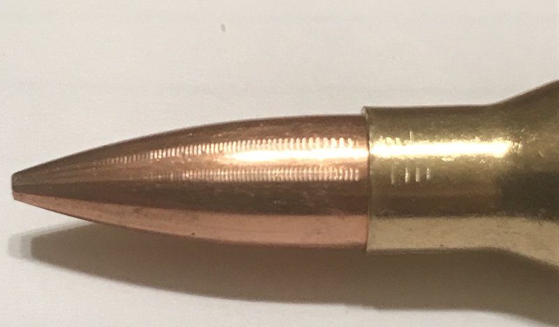

I'll try that out before ordering a second one. I was looking at the magazine more today and it definitely sits an 1/8" too low in the mag, not a lot of rattle though, fits pretty tight, just slightly low. I found that if I was fairly quick on the bolt that I could get all 10 rounds chambered but I discovered a problem.
The brass on the bullets was skimming the feed ramp or barrel, due to the angle/lowered height, and causing speed bumps striations in the brass. Probably wouldn't cause too much of an issue inside of 100 yards but long range I would think that would have a slight impact on aero dynamics and stability of flight. Also cleaned up some fine brass shavings where it was skimming before and into the barrel.

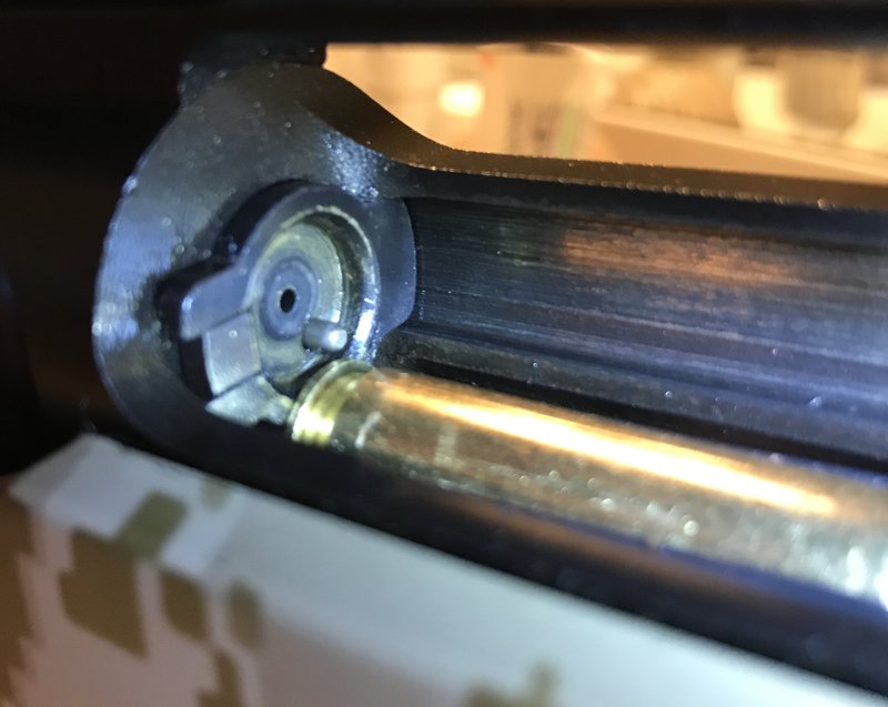

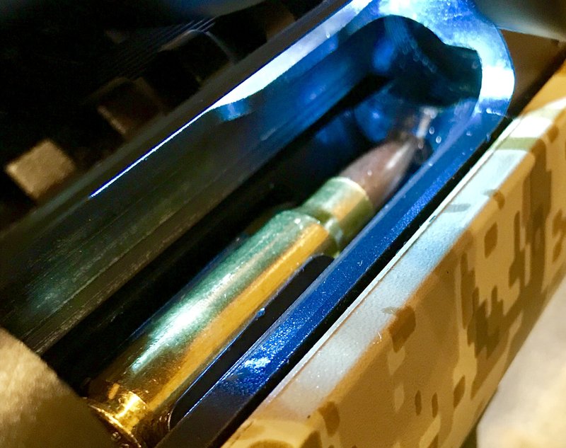

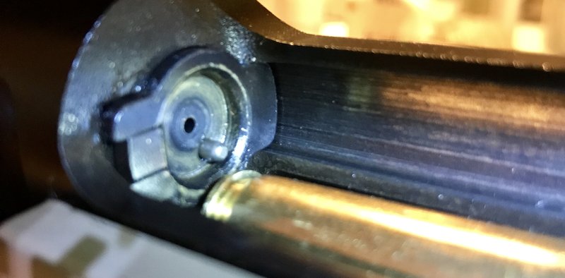

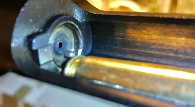

Well, dropped $85 for an AI 10 round magazine from midway and it definitely didn't fix the problem. The magazine actually fits tighter than the factory one and doesn't feel as lose. I took some pictures of the new magazine inserted: http://imgur.com/wwAEU1F
image_67347.jpg Im not sure if the picture will help or not. I'm not much of a gun Smith at all so not sure what the best route is now. Just keep hammering them home at 100-200 yards and hope the ramp will eventually wear itself in with all of the rounds I put through it? Take a dremel and try to sand the ramp down to make the bullet transition path easier? Take it to a gunsmith? Oddly enough the first five of ten rounds are very hard to feed but then the last 5 rounds go smoothly into the barrel. This is probably due to the spring pressure in the magazine?

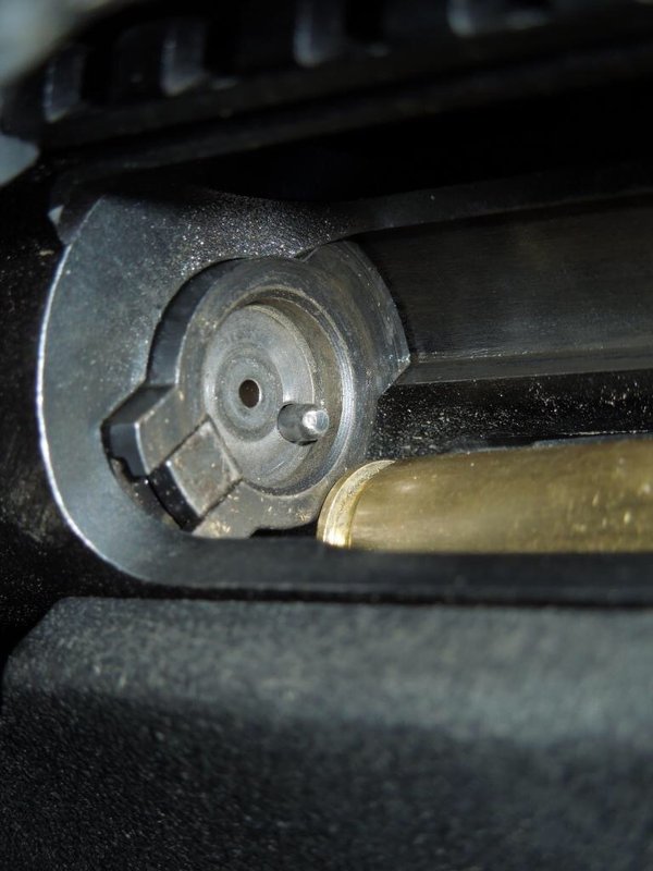

Can you post a pic on how the cartridges mate up with bolt face in the magazine?
This is mine with PTG bottom metal and an AI 5 round mag.
I'll look at my chassis tonight as it feeds like butter as well.
I think it's a height issue not a feed ramp issue.
