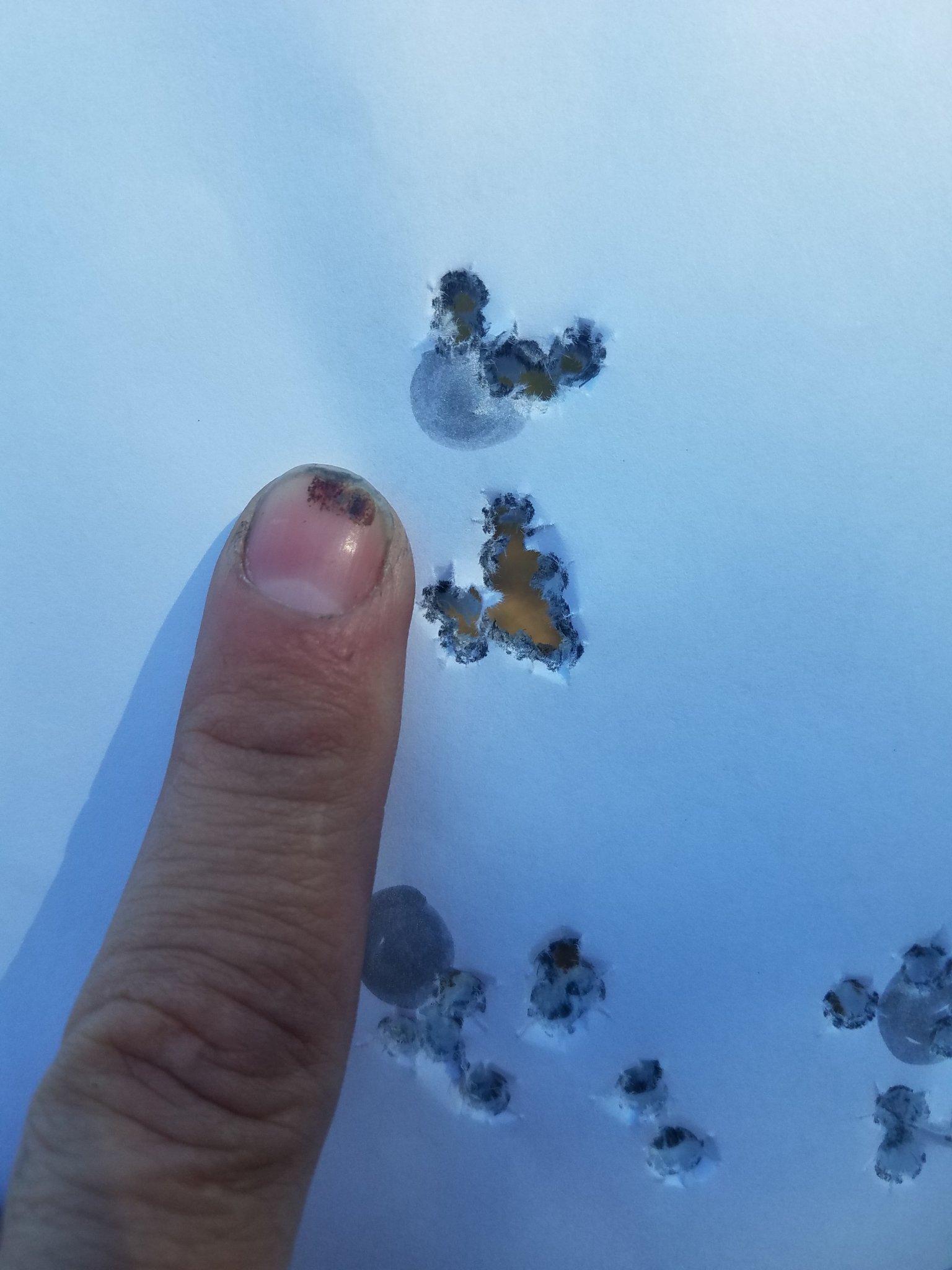

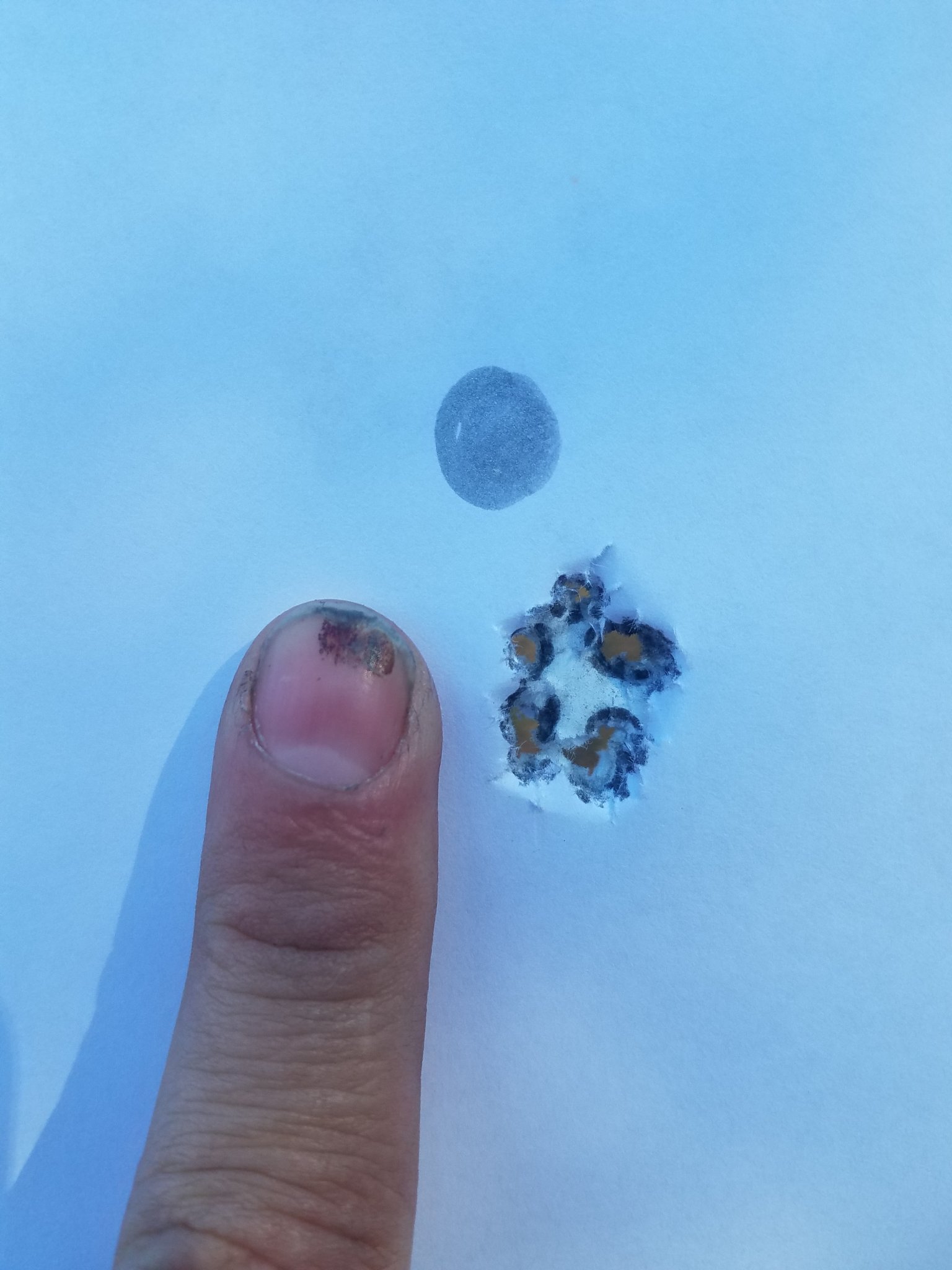

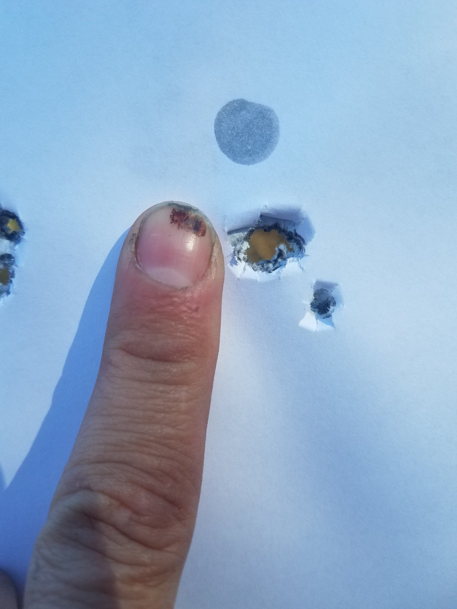

This thread is a little dated, but I just picked up one of these recently and tested alot of ammo I had on hand. Rws r50, federal ultra match, sk pistol match, lapua polar biathlon, eley match, eley edge, eley pistol match, federal auto match, and cci standard. The federal, lapua, and eley shot the best. Surprisingly the cci standard and auto match did well also. I then tested the 6 best with a can, and had amazing results. Sk pistol match on top, federal ultra match in the middle, and lapua polar biathlon on bottom. The flier (1st shot) on the lapua was from a different lube in the barrel. All 10 shot groups @ 50yds

Reactions: crackerbrown
