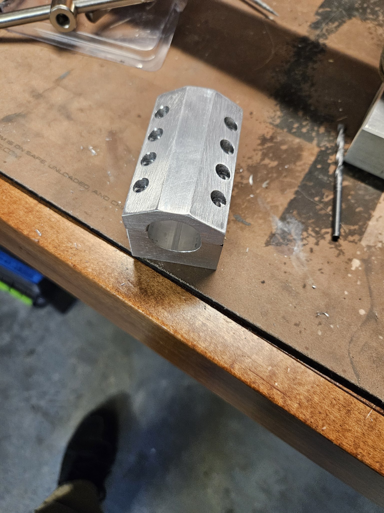

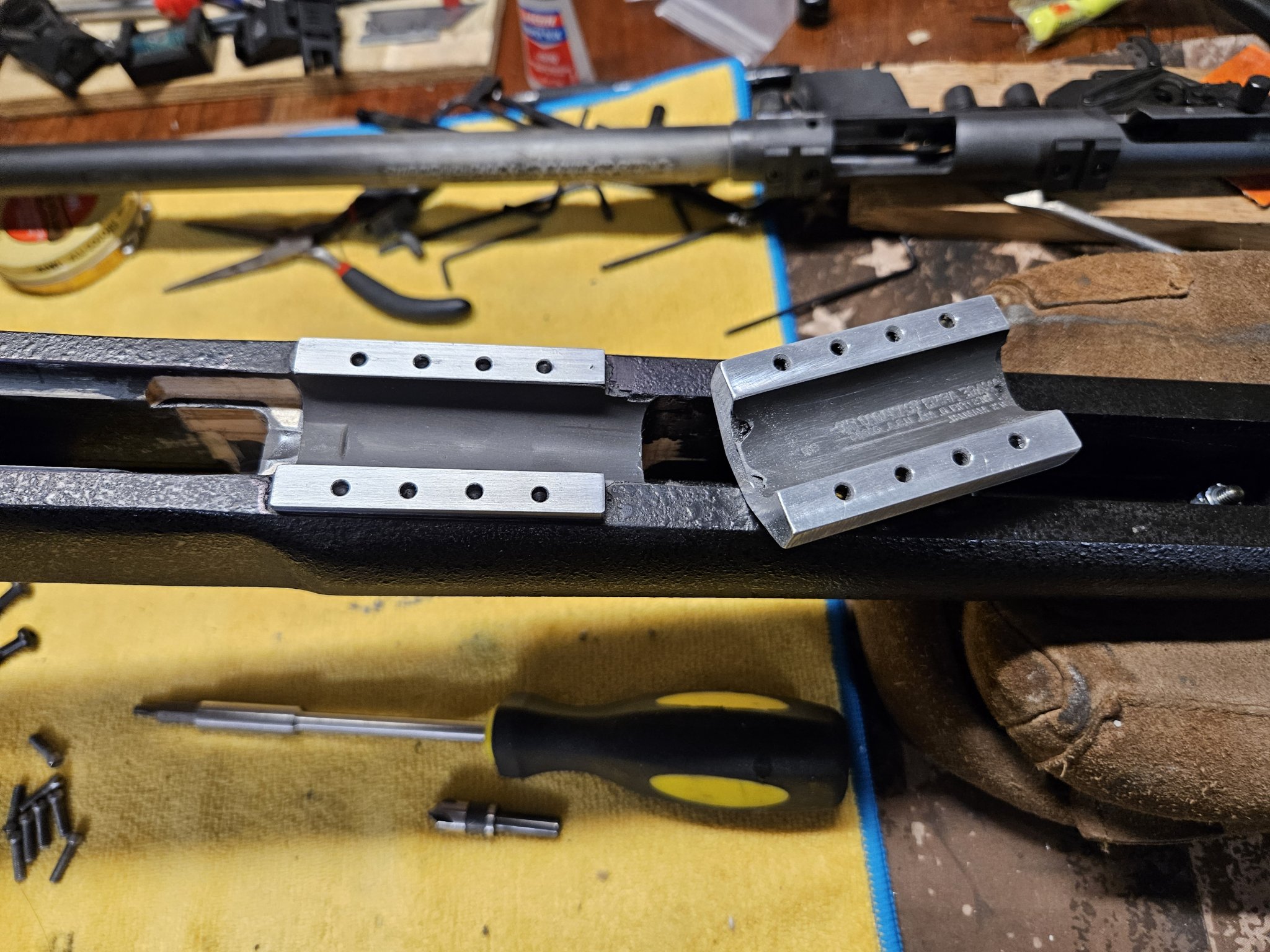

Have been shooting this rifle for about a year and am quite happy. Rather than pillar bedding I want to use a barrel block and let the barrel and the action float. I do not want to cut up the Boyds All-in-one in case this pipe dream doesn't work. Anybody have a Mark II stock? I would prefer wood but might be able to make a tupper ware work. I even considered making a stock with laminated plywood.

I’d be very interested in a photo essay on how you install a barrel block. Looks like you could pin one into the plastic stock and epoxy into the Boyds wood stock. Design of the block is of most interest.

Check out the link https://www.6mmbr.com/gunweek075.html I have found some 3/4 inch birch cabinet plywood and think I will try building a stock like this guy did. I have found a machinist who thinks he can machine the block. There is no tapper to the Mark II barrel so it is just a matter of boring a hole and then cutting the block in half to clamp on the barrel,. The trick is getting the hole in the center and then cutting it exactly in half and keeping everything concentric.
Take a look at your plastic stock and see if it could be cut out for the block without weakening it too much. I am afraid after cutting the stock it will be too weak and flex badly.... but I haven't looked at a plastic stock.

Thanks for the link. The plastic stock will definitely not work for that set up. Too thin.
That chunk of aluminum is fairly big. I’d be inclined to use a two piece set up rather than try lathe boring and then splitting. A decent mill would make short work of the job, especially if using a digitally controlled mill. Wouldn’t be cheap tho. Aluminum has gotten stupid expensive and machine time isn’t getting any cheaper. Interesting idea tho.
I figured a 2"x2"x3" block of aluminum or steel. Aluminum would be lighter, but I don't care. I've found some 3/4 hardwood plywood and figure I can build a stock for <$25. If I can find a machinist wo will build a block for <$50, I am going to go for it.
Sounds like a good plan. Long pole in the tent will be machine time and material cost. Here in the Kaw River Valley machine time runs about $90 an hour. I’d guess your block will run closer to $100 by the time it’s finished. Not excessive to run an experiment and satisfy curiosity.
That's why I think boring a .831(barrel diam.) hole and then cutting in half will be the least amount of machining. Cutting exactly in half will be the trick, might have to true up with a mill. I've got a couple of machinists thinking about it. I can drill the bolt holes and tap the bottom bolt holes. Since there is no recoil the size of the block can be smaller

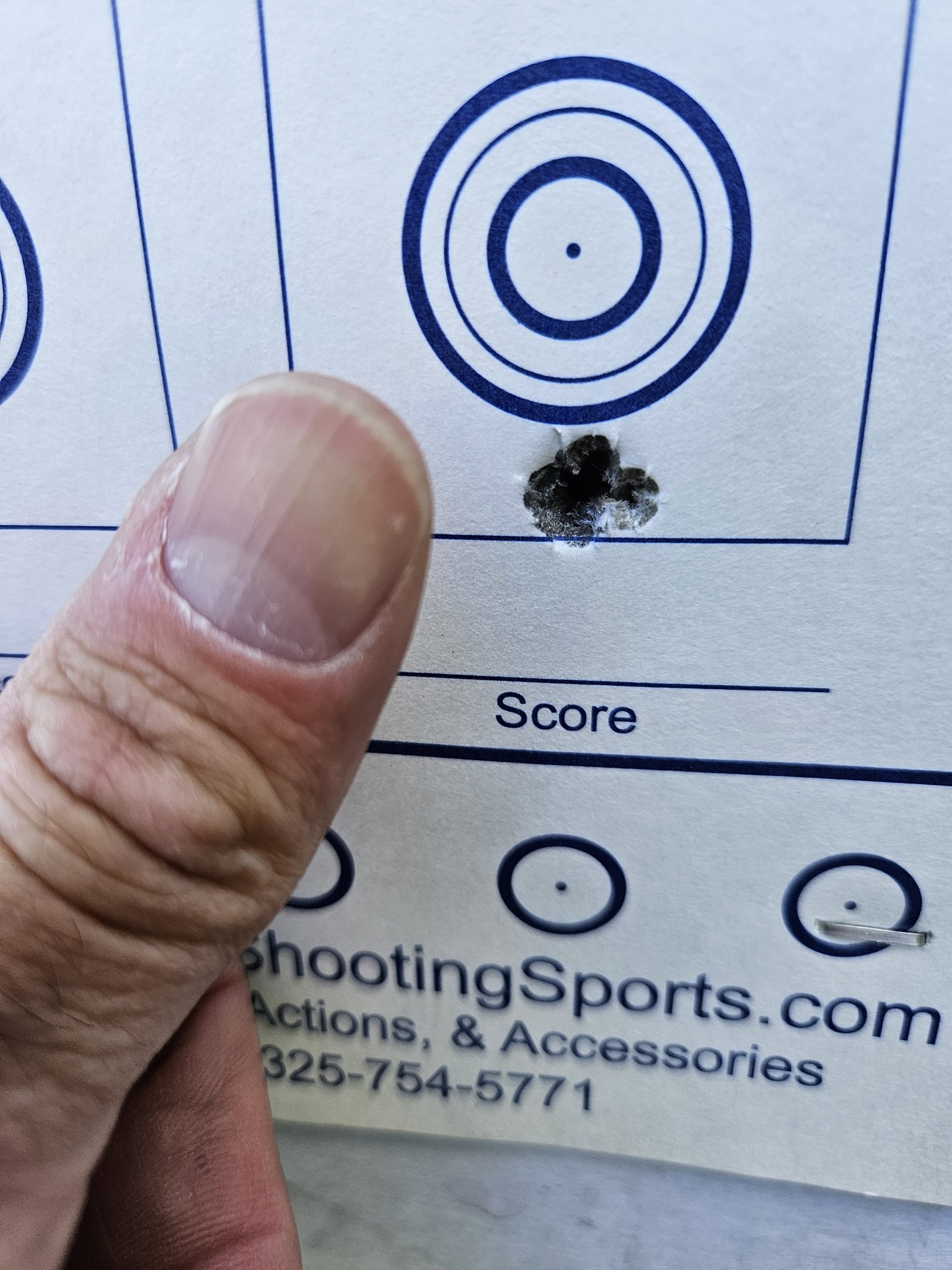

tell me about it...
6 shots at 50 yards. only one of those was a "flier" also sk rifle match.
I have my complaints with savage lately but grouping is not among them!

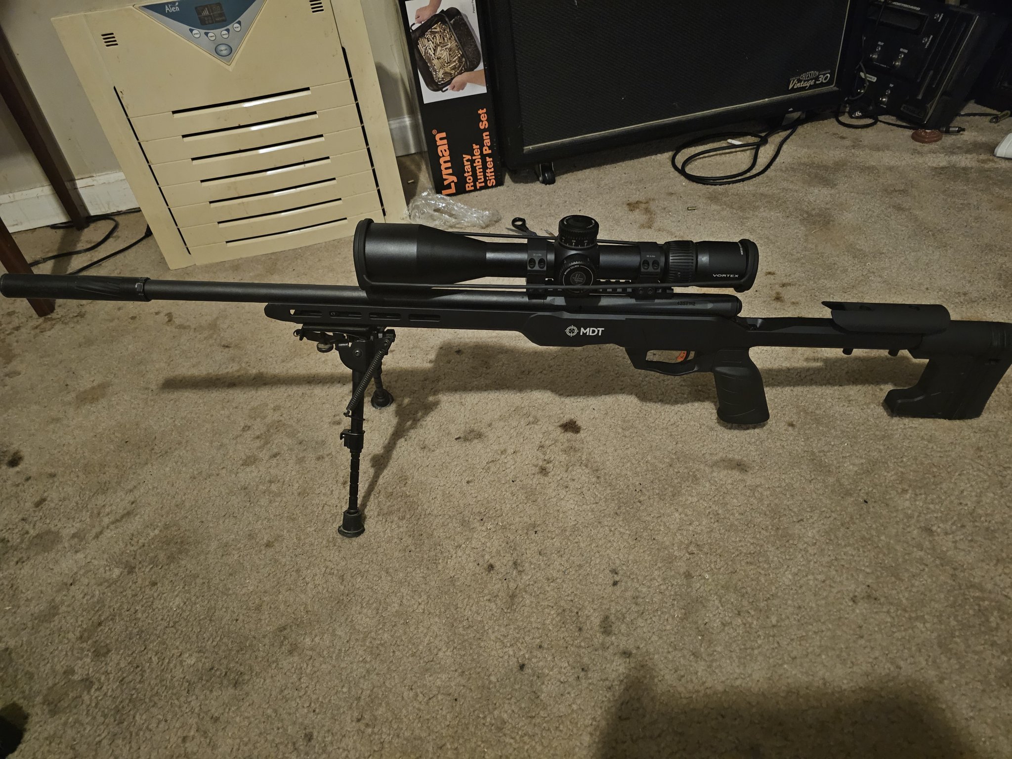

I had a b22 precision that I ordered from midway I think it was, or maybe psa idk. whoever had a cheaper price.

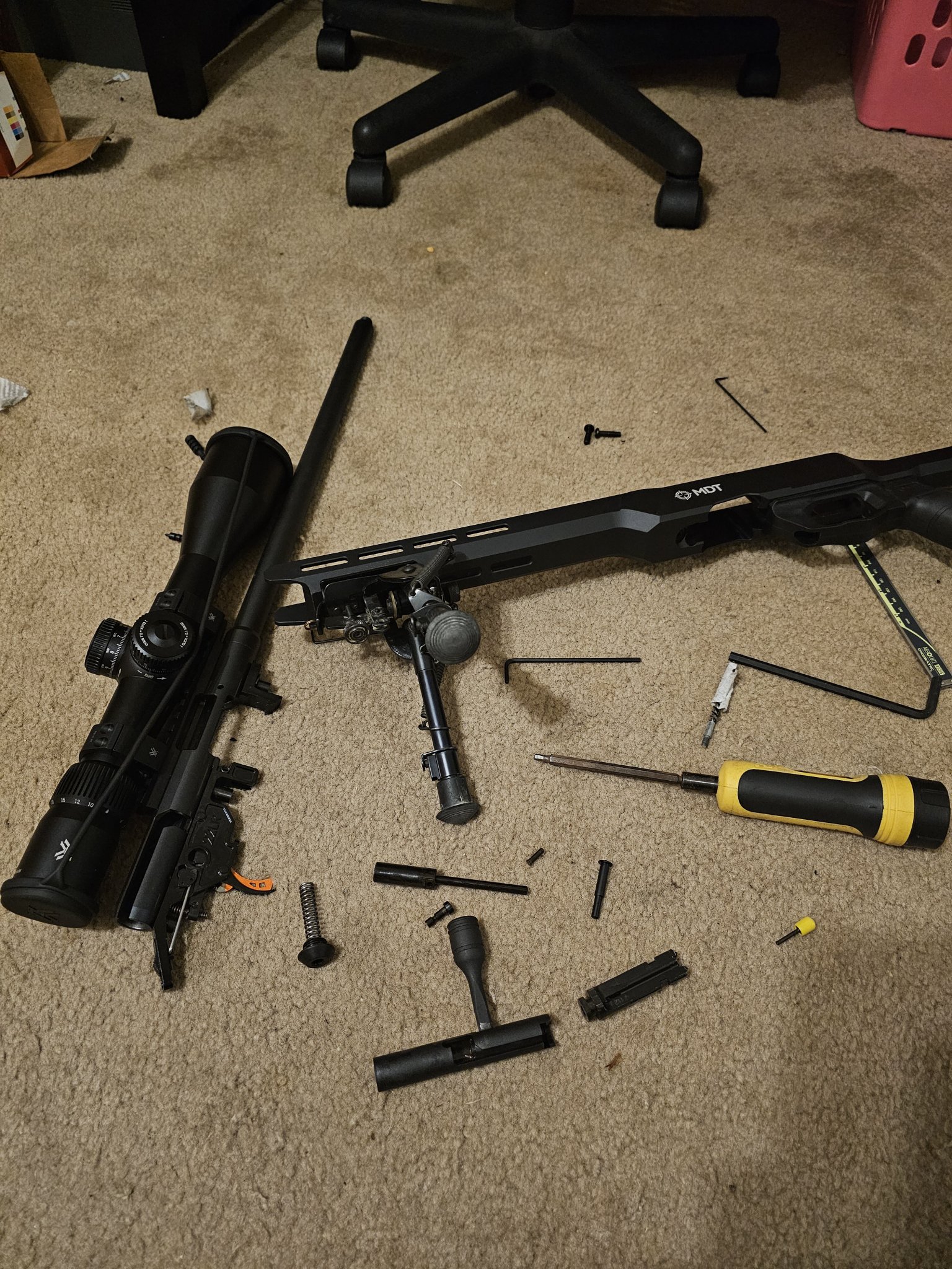

holy shit I had to file a lot to get these mags to work.
now they work really well.
