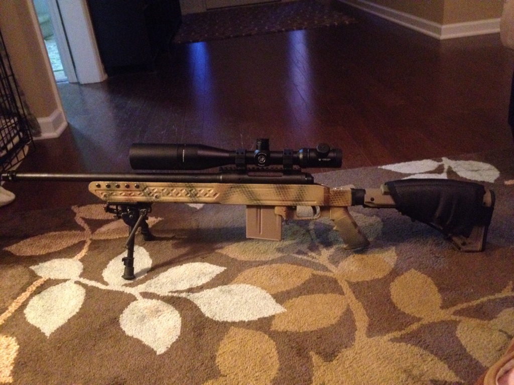

I've got a bottom bolt release and was pretty bummed to find a lack of options too. That being said, I went with a McRees chassis and couldn't be happier with it. XLR's chassis have the ability to work with the bottom bolt release actions too. I know that doesn't help if you're dead set on a traditional stock where the options become pretty limited...
I will have to look I to the mcrees I called xlr and didn't get a call back, someone might know the answer is it compatible with other ar style grips and but stocks? Right now I'm kind of set on the mdt tac 21 right now but trying to stay open minded, I appreciate all the help!
Works with any AR stock and buffer tube. He recommends against styles that don't use the carbine but they can be made to work. That's a magpul UBR under my stock pack. I guarantee you hear back from McRees and it will most likely be Scott himself.
