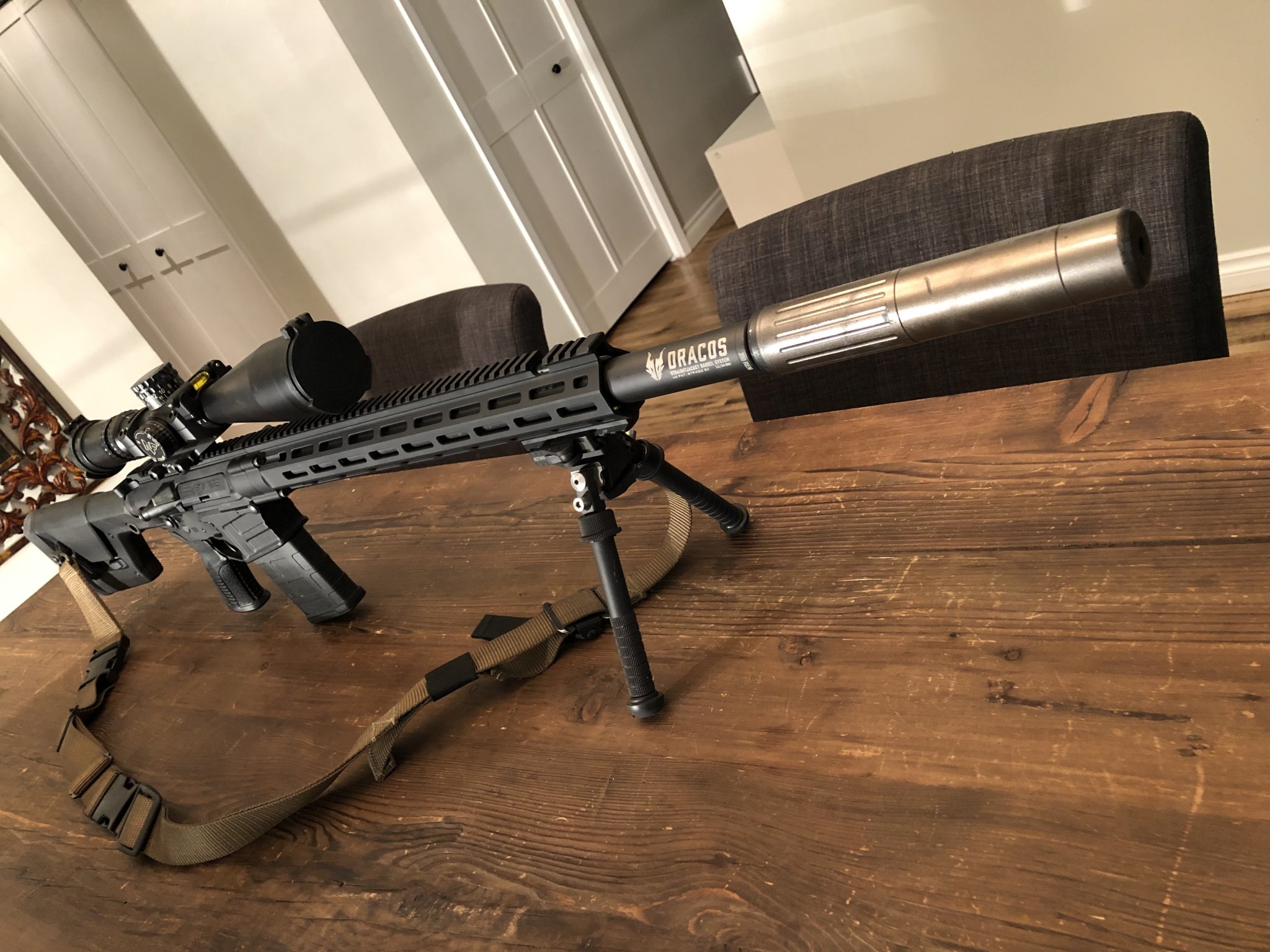

Greetings,
A question for the experts here on SH...
BTW, new member, any SOP infractions not intentional...

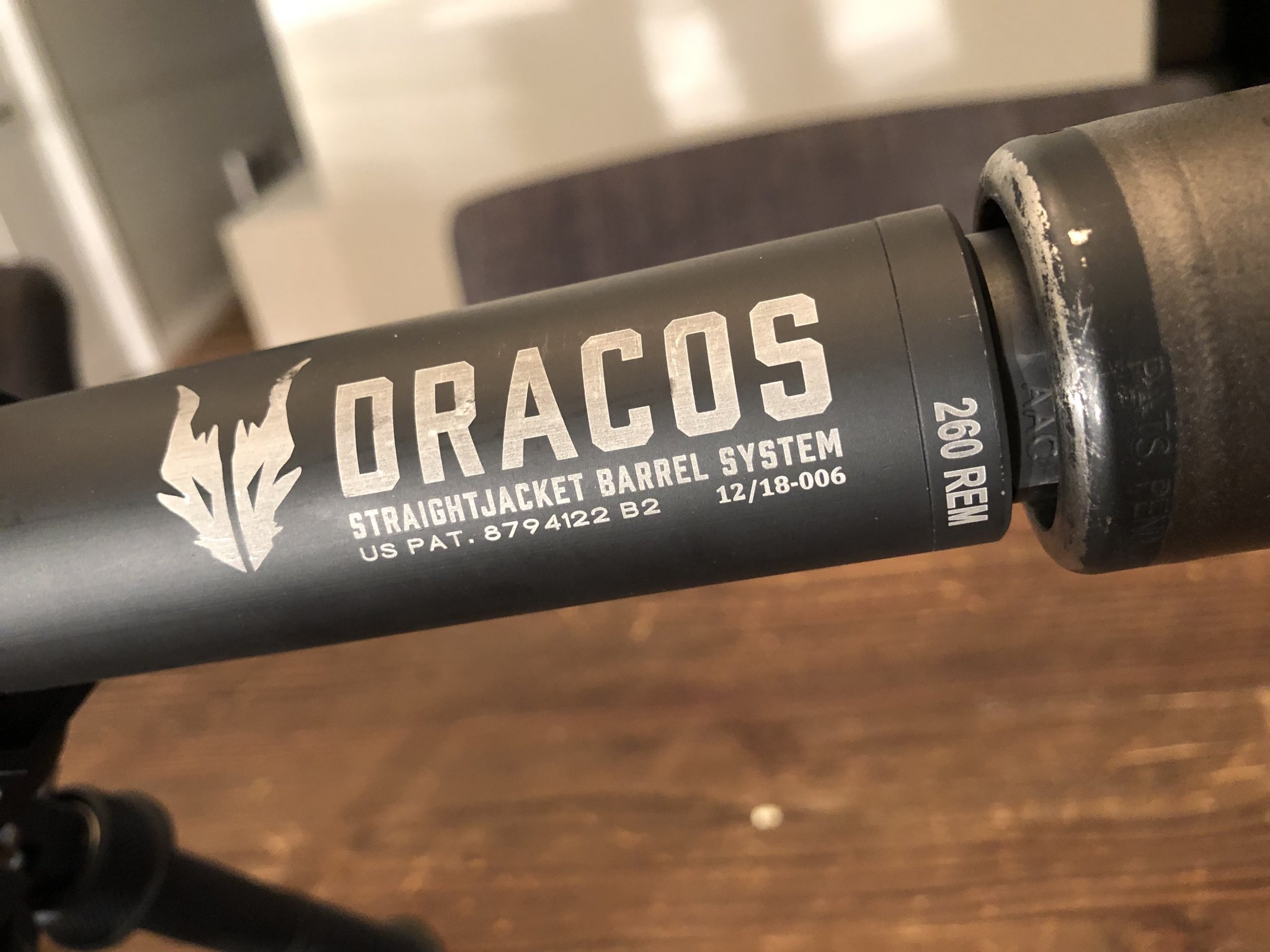

I have rebarreled my Savage MSR-10LR with a 22” Dracos barrel in .260R.
UNSUPPRESSED:
Using handloads of 41.0g of H4350, 139 Lapua Scenars, and resized .308 once fired mil spec brass, the rifle is undergassed and does not cycle properly. It will not pick up a second round from the magazine, nor lock the bolt to the rear after a single shot.
SUPPRESSED with AAC SDN-6
Rifle cycles perfectly, but is prone to vertical stringing. I have used this suppressor on my bolt gun, (SIG SSG-3000 with 22” Benchmade .260R rebarrel) with similar accuracy issues.
Removal of the suppressor eliminated flyers for my SIG.
Desired endstate:
Shoot the MSR-10 unsuppressed with normal cycling in order to move to accuracy testing. Eventually move to a suppressor more suited to PRS shooting.
Limiting factors:
The Dracos barrel dwell time adjustment made no impact on cycling in any depth of inset screw setting.
There is no adjusting the Savage MSR-10 BCG gas key due to its design, which is devoid of an adjustment screw.
Work around questions:
Does anyone here have any gouge on an adjustable gas block solution for the Dracos barrel? As of mid Feb, the company recommends using the BCG gas key for adjustments.
Does anyone here know if there is a BCG that has an adjustable gas key that will fit and function in the MSR-10 platform?
Also a larger charging handle would be nice too.
Grateful for any input!

Hey Red Dog, (and @AMGtuned: thanks for the tag! :))
How many rounds through your new barrel/rifle? Sounds like at least a good number prior to making the switch to 260R.
A few things come to mind regarding cycling issues.
  1. I avoided the 260 Rem due possible feeding issues; the 6.5CM case was designed with mag length cycling/feeding in mind and gas operation seems to be overall more consistent with 6.5CM than 260 due to the oal and case shape.
  2. Your 100% correct that overgassed rifles can mimic being undergassed. This was the issue in my rifle and switching to a heavier rear mass buffer should help. I went to a 5oz and it's still a bit overgassed with a suppressor.
  3. The JP silent capture tuner kit should work BUT you will need to do one of the following: swap your rear buffer tube to a standard rifle length OR make a custom spacer for the carbine length tube that goes between the BCG and buffer face (the Savage BCG is shorter than standard AR10 BCG and could potentially allow the JPSCS op rod to hit the firing pin when it bottoms out.
  4. The Dracos Dwell time adjust screw is about as useful as a glass hammer. It simply doesn't do what they expected it to do. I had conversations with Dracos/Falkor Defense about it and they stated they were working on an adjustable version of the block that limits flow but had no ETA.
For the purposes of tuning quickly, I'd suggest reducing load further (look for node between 39-40gr) and swap out to a Tubb Flatwire spring or something similar. There is a good chance that your loads will work better with a slightly softer, slower load. I also found that 140gr bullets had mediocre results in the Dracos whereas the 120-130 seemed to work much more consistently, along with reducing dwell time (faster muzzle exit means lower dwell time generally speaking).
The stock Savage spring is SUPER SUPER strong compared to most but that creates a two edged sword: you need a heck of load to get it to cycle BUT it will likely be overgassed to get it back far enough to pickup next round which can cause bolt to unlock early and lead to accuracy issues.
Feel free to send me a PM and I'd be happy to send my phone number to chat as needed about what I've tried and what worked for me. Sometimes easier to cover this stuff by phone than back and forth via messages.
