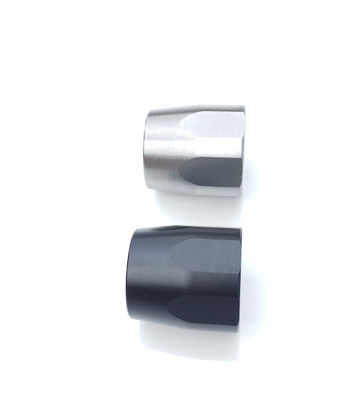

Savage Nut On an Impact Precision Action
I think the OP has Savage 20 tpi threaded barrels so a remage nut isnt going to solve the problem. A Zermatt/Bighorn would be a better action for OP's needs.
I think they said on post #2 that Imapact has a 16 TPI thread like a Remington. If it's a 1-1/16" x 16 TPI (Remington 700 pattern) PVA's Remage will work. Zermatt's 12 point or Invisinut should work too. Although the tool for the Invisinut makes is expensive.
OP
OP has a small shank savage barrel. That should be a 20 TPI thread. But yes I agree the impact has a 1-1/16” X 16 TPI thread. Zermatt / Bighorn use the same Small shank savage 20 TPI thread.
