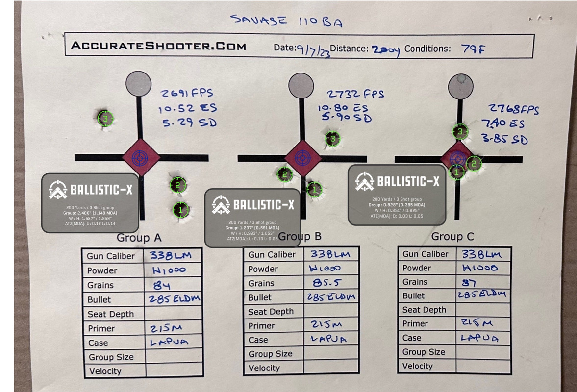

This is my Savage 110BA load development in 338 Lapua.
The first group is 250gr Factory Lapua ammo.
The rest is my hand loads with Lapua brass and Hornady 285gr ELD-M projectiles.
This is 3 shots on a gong at 425y with the final load of 92.3gr of H1000.
WARNING: This load is above published load data. Do not use without working up carefully.
