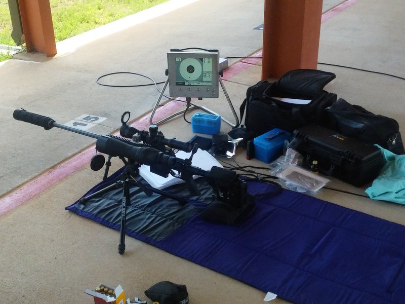

Promised pictures from Talladega. Savage Stealth 300WM. Berger 185 OTM with RL-22 74gr. Wind 10 mph Right to left. Not sure what x out on shot 1 & 2 mean, will have to ask next time I go. Really good trip. On this rifle, no working up to 600, just started with previous dope. Felt really good. The 300 WM is my favorite of the rifles I currently have or any in the past.

Did some more analysis. Above target was 5.311 at 600 yds. MOA was 0.845. 10 mph right to left wind.
Tested 300 WM with Magnetospeed, load RL-22 74g, Berger 185 OTM Juggernaut. Was expecting abut 2900 fps. Got repeated (8 shots) all > 3100 fps. Avg 3120 SD 11.2. All with Suppressor.
Need to work that SD down, looks like my scales are allowing 3 or so powder per .1 gr.
Suggestions?
