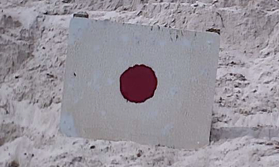

    @Mike Casselton on 3rd or 4th shot can't quite remember, but from the target cam voila this hit was perfect elevation and considering full value wind 12-15 dead out of the east I let out a WHOOOOO when he chipped the paint at 9 o'clock! 6.5 24" barrel 140g ELD....so much fun to see. Atta boy mikey
    Liar, liar! 😁
    It was a Berger 140 Hybrid.
    41.5 H-4350
    Fed 210m
    Lapua LRP brass
    2700fps
    Rifle is a factory Rem 700 24" threaded.
    MacMillan A4
    Harris 9-13" bipod
    Form-1 8"x1.5" can
    Bushy ERS 4.5-30 H59 set on 25x
    Winds were tricky, but manageable.
    We had been doing really well on the 1K targets so, why not...

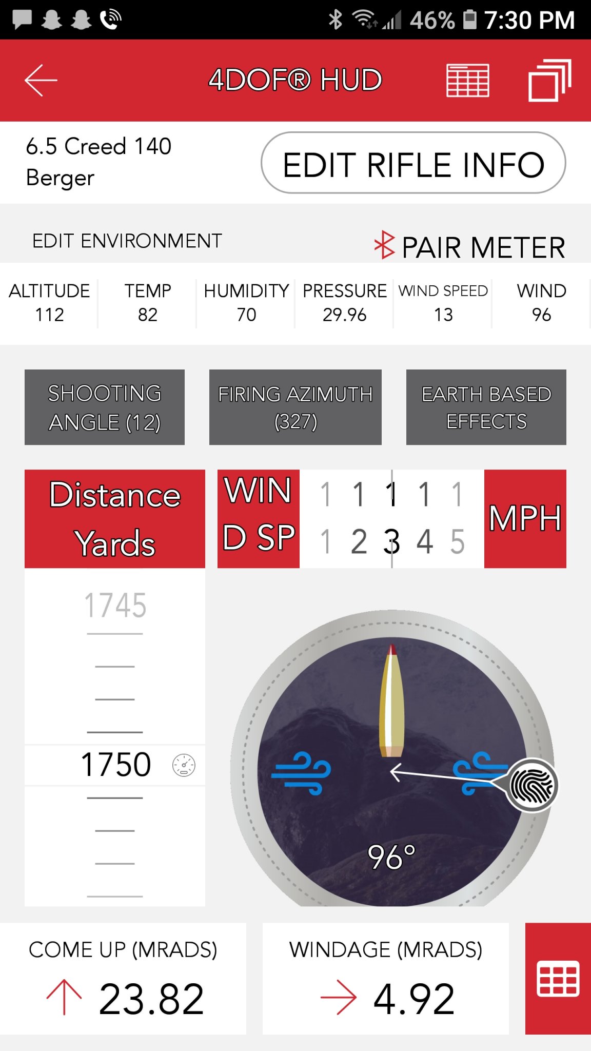

    Here's what Hornady DOF said:
    It was off a little. I needed another 1 mil up and another 1/2 mil right, but otherwise, it was decent. I haven't done any truing of the app.
    Hit on 3rd shot.
    My new goal will be a cold bore center hit at the mile.

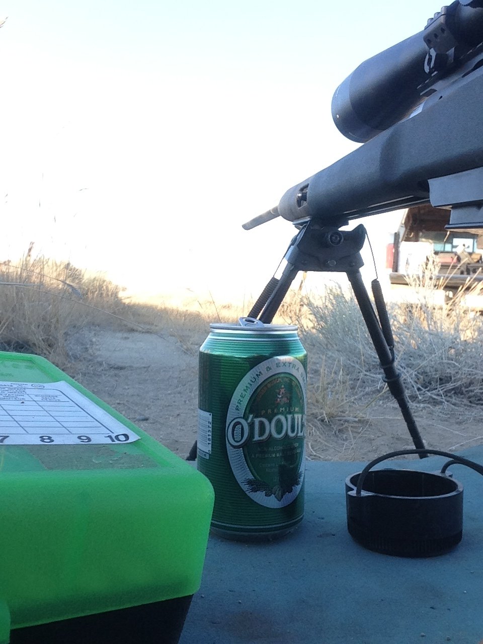

    My first 1000 yard combination
    That's why I mentioned the Harris.
    Some time during our "winter" I'm gonna try the 1k with my old Savage 7-08, 140 Ballistic tip running a sedate 2675. IMR 3031 and unworked brass.
    It'll have some cheap assed scope on top in cheap assed rings.
    Oh, and I'll use a Caldwell bipod.
    Heads will explode. 😁
