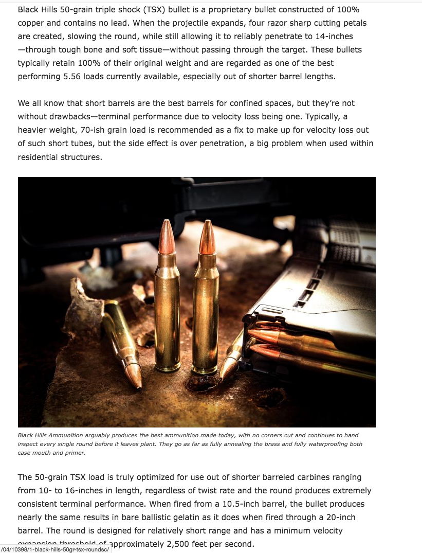

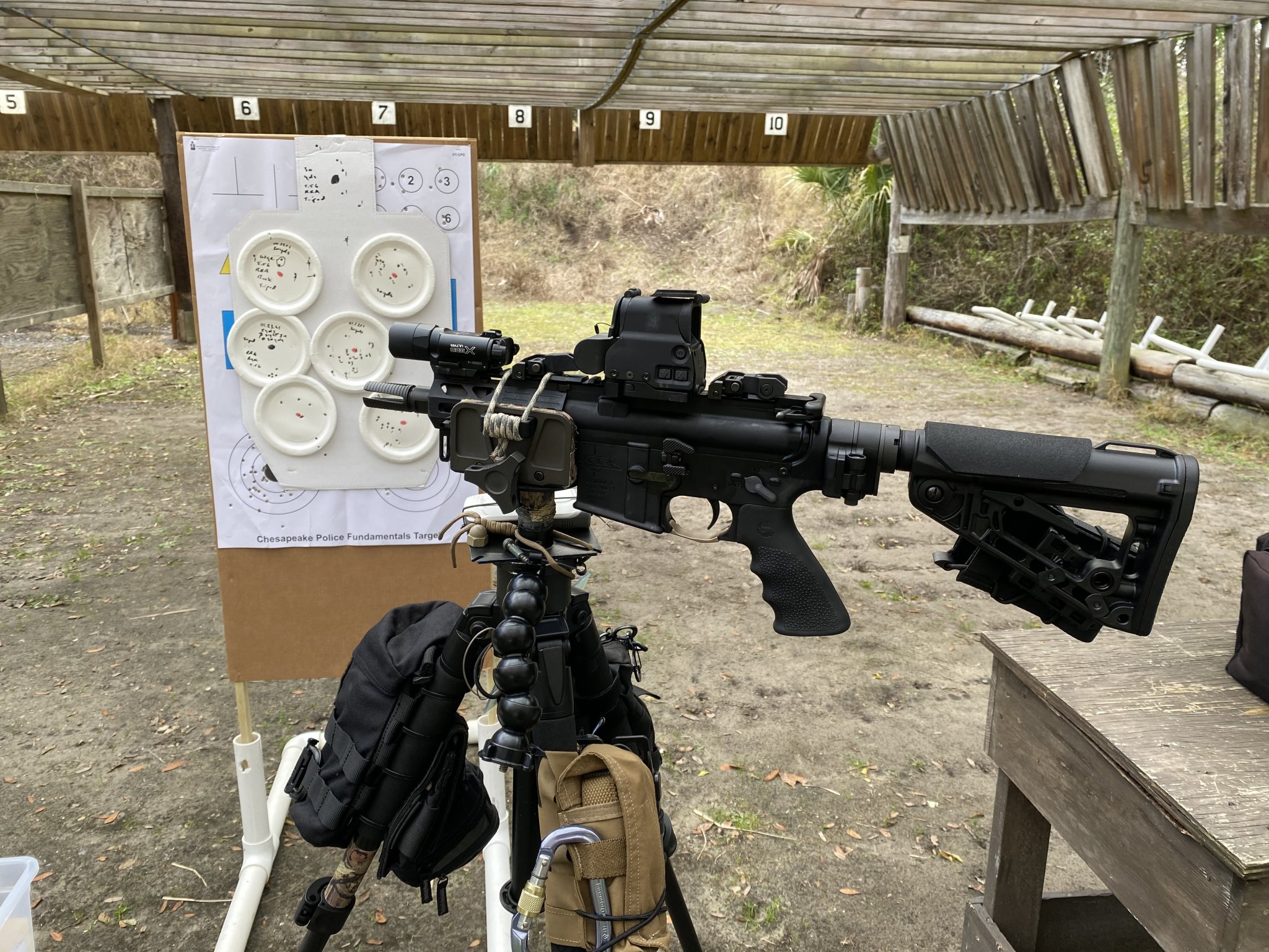

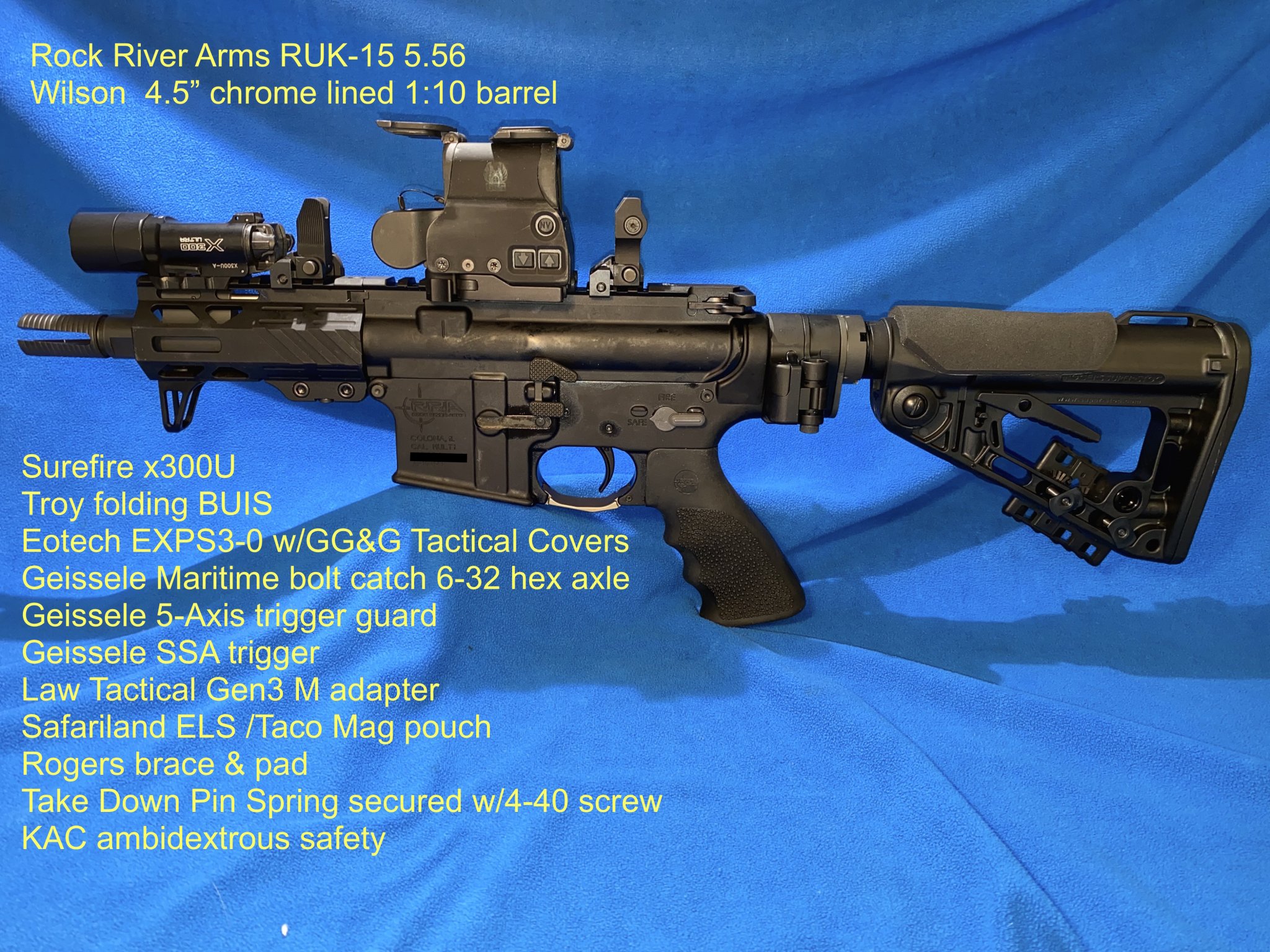

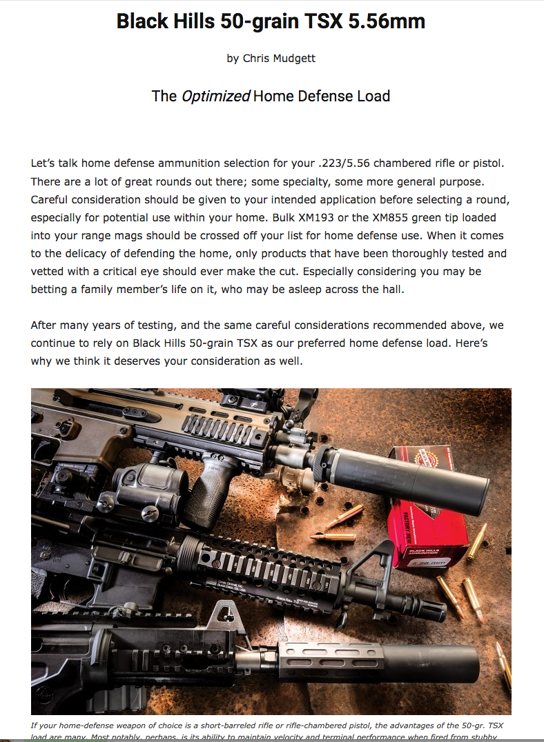

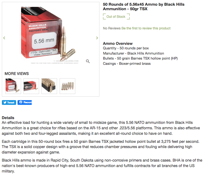

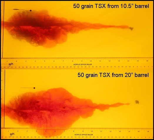

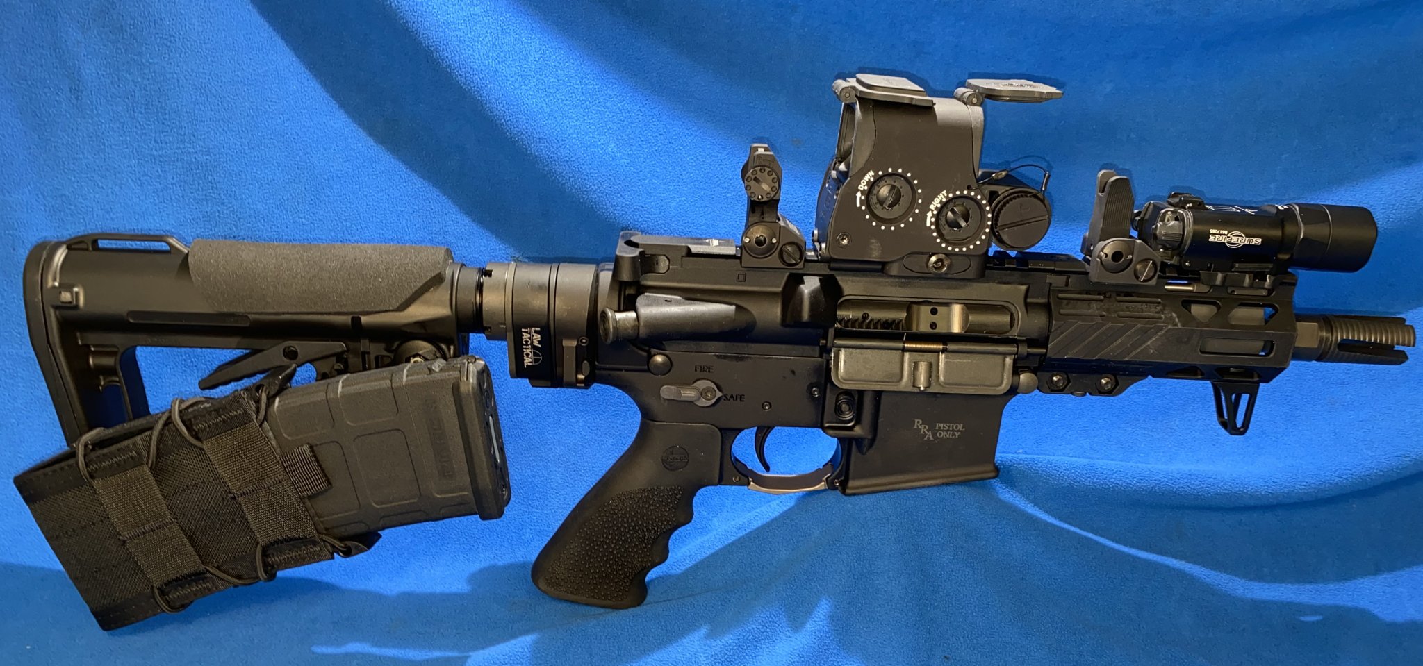

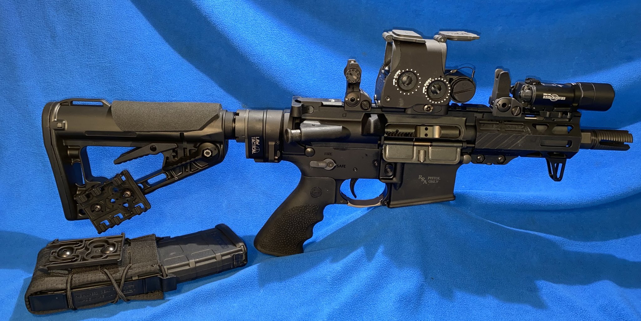

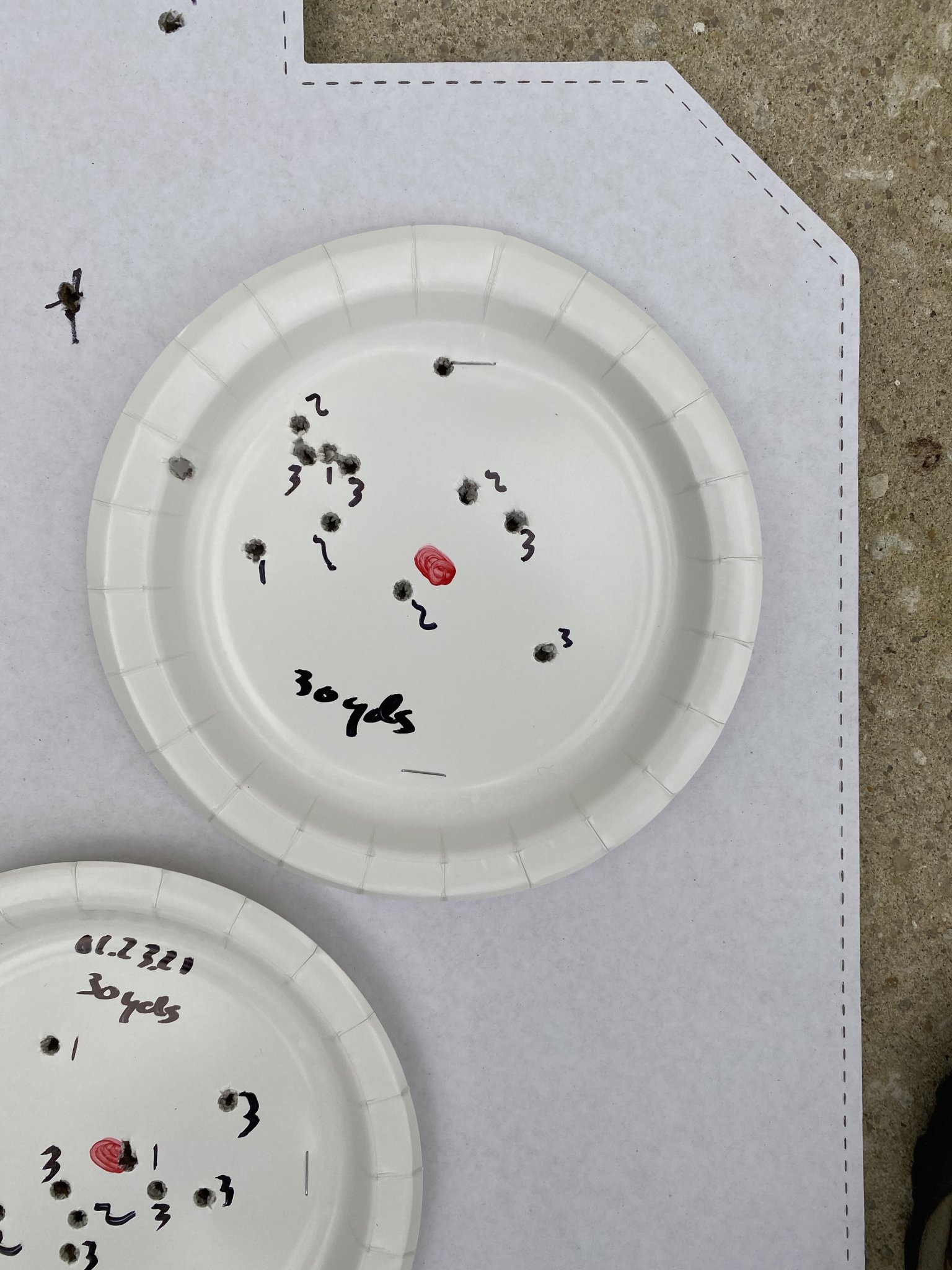

I have a number of 5.56 SBR's and pistols , this one is my shortest and for defensive intent I use the BH TSX. Black Hills 50 gr. TSX was developed for just this situation. Decades ago the FBI studies demonstrated the 55 gr 5.56 rounds had less household barrier penetration than HP 9 mm rounds.

I have a number of 5.56 SBR's and pistols , this one is my shortest and I use the BH TSX. Black Hills 50 gr. TSX was developed for just this situation.
Thank you. I put my email on a few lists of this since they seem to be out of stock everywhere. Funny cause that was my gut is why not use a lighter varmint round. I know the 36gr stuff I have is supposed to be pretty messed up on the short range receiving side - out of my 16.5 inch barrel anyways .
70 grain TSX shows about 3500 boxes in stock

I have 50 gr optimized tsx as well. Expansion threshold is about 2300 iirc. The picture/page above ^ said 2500 but I'm almost positive it's 2300. I'd rather use something that fragments or has a lower threshold on a very short barrel. On a 10.5" you're still 2850ish fps so you're definitely still good. That round sheds velocity fast though so if you're thinking about scenarios of longer shots it's not idea imo.

Any of these is going to absolutely ruin someone's day. Some are better suited for higher velocities though. Just have to look at your velocity and the rounds expansion/fragmentation threshold.

Have you chronographed that thing? If it's not above 2400 I'd be very worried about over penetration and no expansion. I would definitely try to find a round with a much lower expansion threshold.
Also even with doubled up ears you're probably damaging your hearing with that through bone conduction. Just something to be aware and careful of.

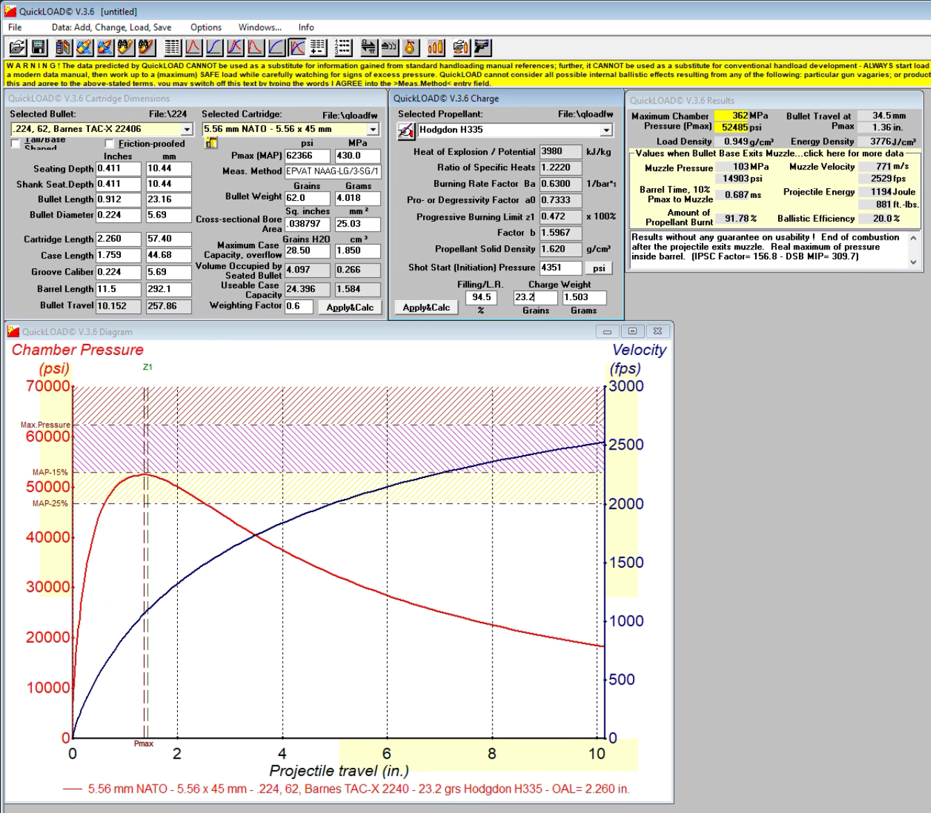

Handloading can certainly net some gains, if you’re willing to go that route:

H110 can be made to work, but generally won’t be as efficient or temperature/lot insensitive as using something closer to to powders used in 300blk, etc.
essentially the reason I listed H335, is I punched in desired bullet and seating depth (via coal), barrel length, constrained to minimum 70% fill and Pmax -13%, then sorted for max velocity on the powder table. H335 is as fast as you’re going to get unless you start playing in the pmax -5% zone after fully characterizing a specific powder lot. (I’ve only done this with my batch of CFE223 where several dozen rounds in controlled conditions gave me a reading that it tends to run slightly hot by about 2%)
