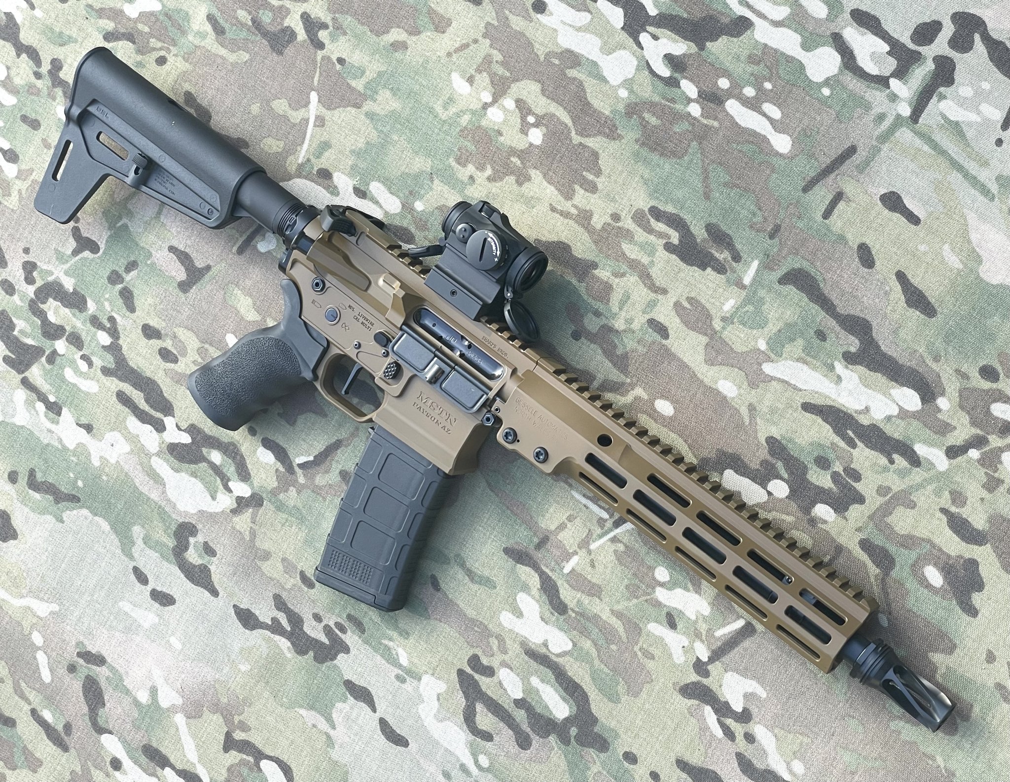

My SHTF carry is an 11.5” SIG MCX with S&B Dual CC 1-10.

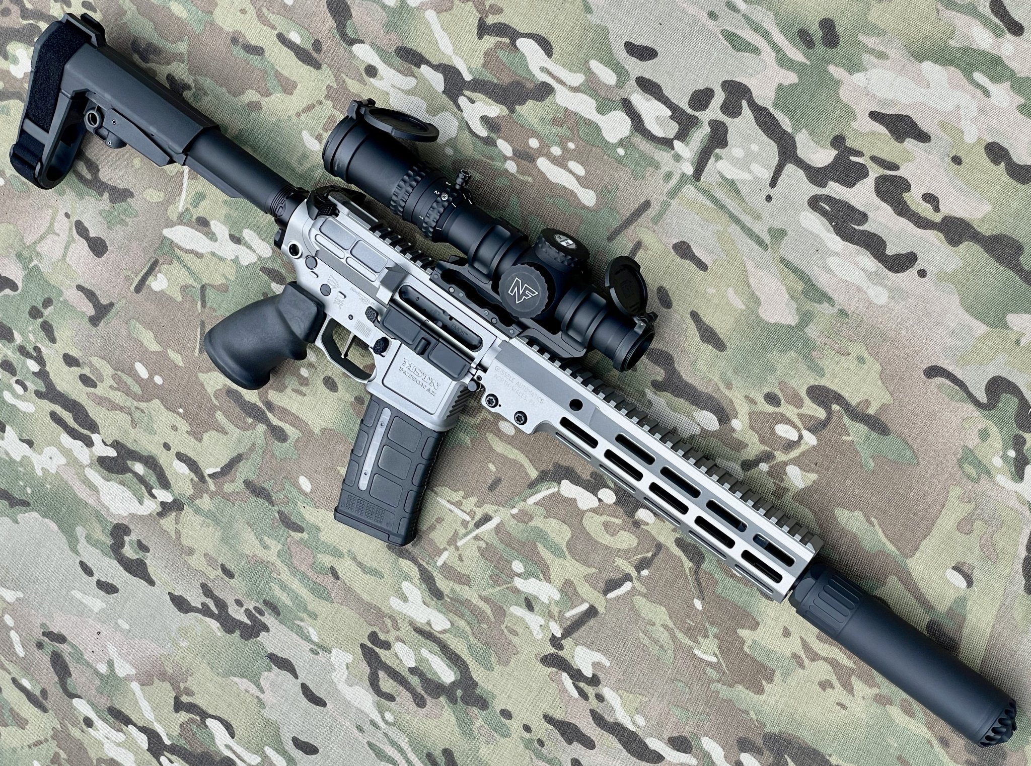

If I could only have one rifle, it would be my 11.5 SBR MCX Virtus. Surefire Mini suppressor on it, a little gassy and loud but perfect maneuverability. Have bounced between different optics but a 1-6 LPVO makes consistent hits out to 600m with mk262 (once get a decent wind call).

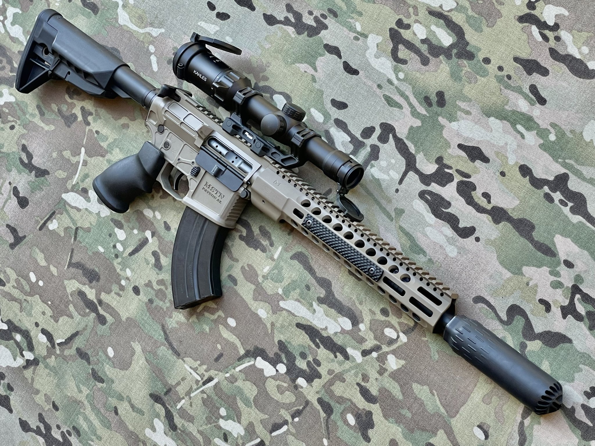

If I could only have one, it would be my 12” Grendel suppressed.
It does what none of the 5.56 blasters can at any range, and performs more like a .308 at distance, only with easy sight picture tracking/self-spotting. I’ve been shooting it every range trip and course since 2017. Very fun little gun that does things you would have to see to believe at distance. Hits the steel loud.

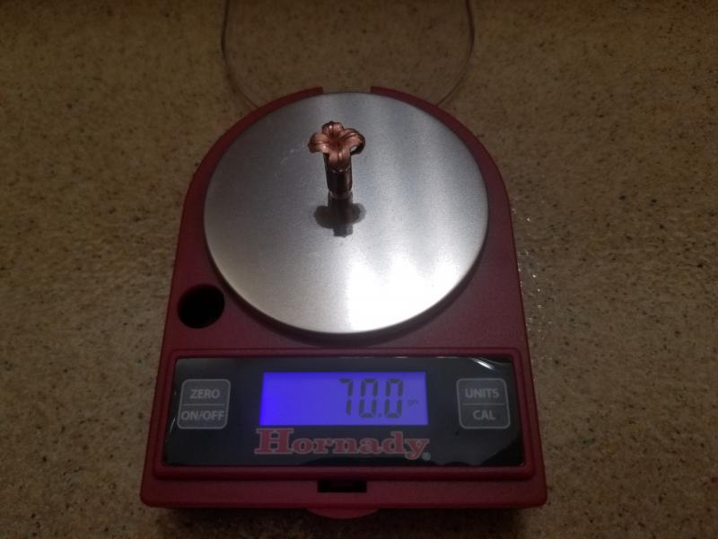

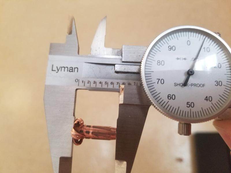

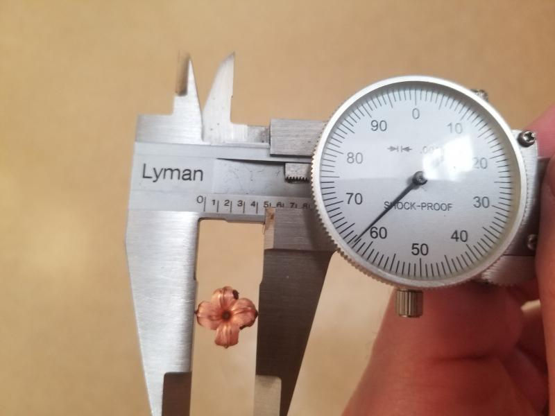

An example is this 70gr TSX I recovered from shooting a white-tail lengthwise at about 100 yards using my 11.5. Predicted impact velocity was 2350fps:
