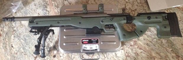

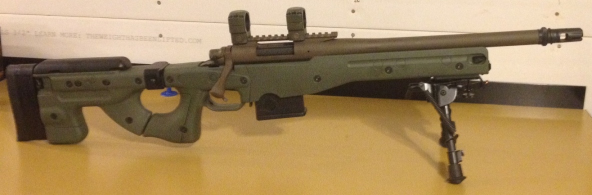

    If you can't have an SBR in your state maybe the next best thing might be to cut one down below 16" and get it back up to legal length by pinning and welding a muzzle device. Here is a 700 AAC that I did that too, put on a Stiller bolt knob, Timney, NF rail, Patriot Brown cerakote, and dropped into an AICS. Accurate Ordnance did the work. The brake is the 300 Brakeout. This is one example of the gun shooting better with the can than without. It'll shoot 147s 5 shot 100yd groups at about 2 MOA. Put the 762-SDN-6 on and it gets cut in half. The 2nd pic is to compare it folded to a 9" AAC 300 Blackout upper.

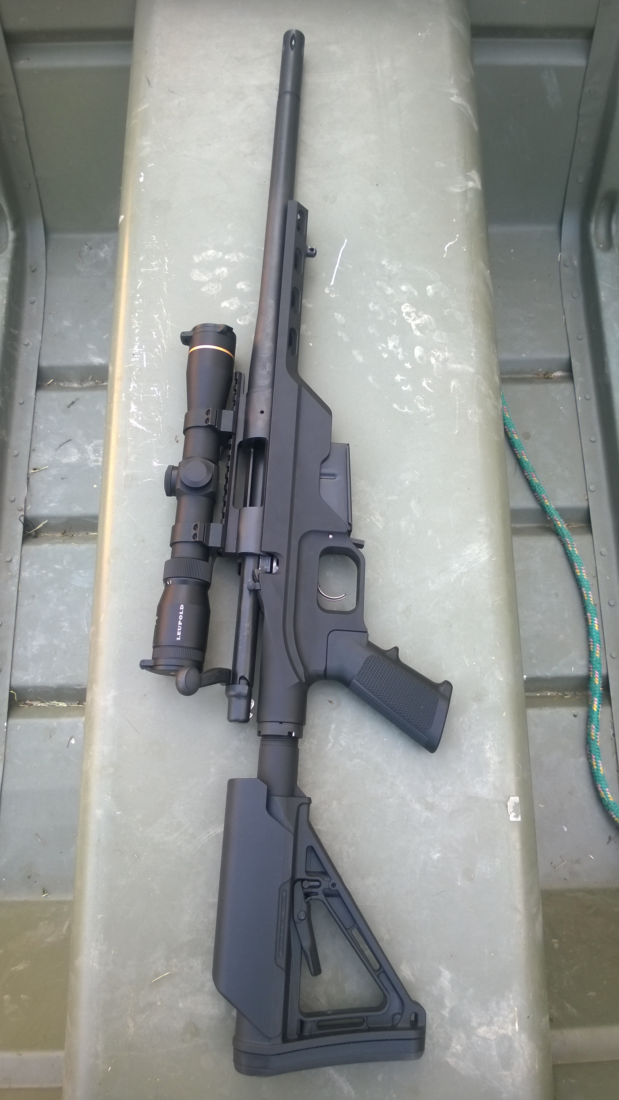

    14.5 and premint brake lss mdt chassie.
    14.5 aac 308 with permanent brake and a lss mdt chassie.
    it shoots good and its handy.
    That is very cool. I was looking at that chassis fir a while but it just seemed too short for the long barrel I was doing. That though looks perfect. Into the future rifle build file it goes.
