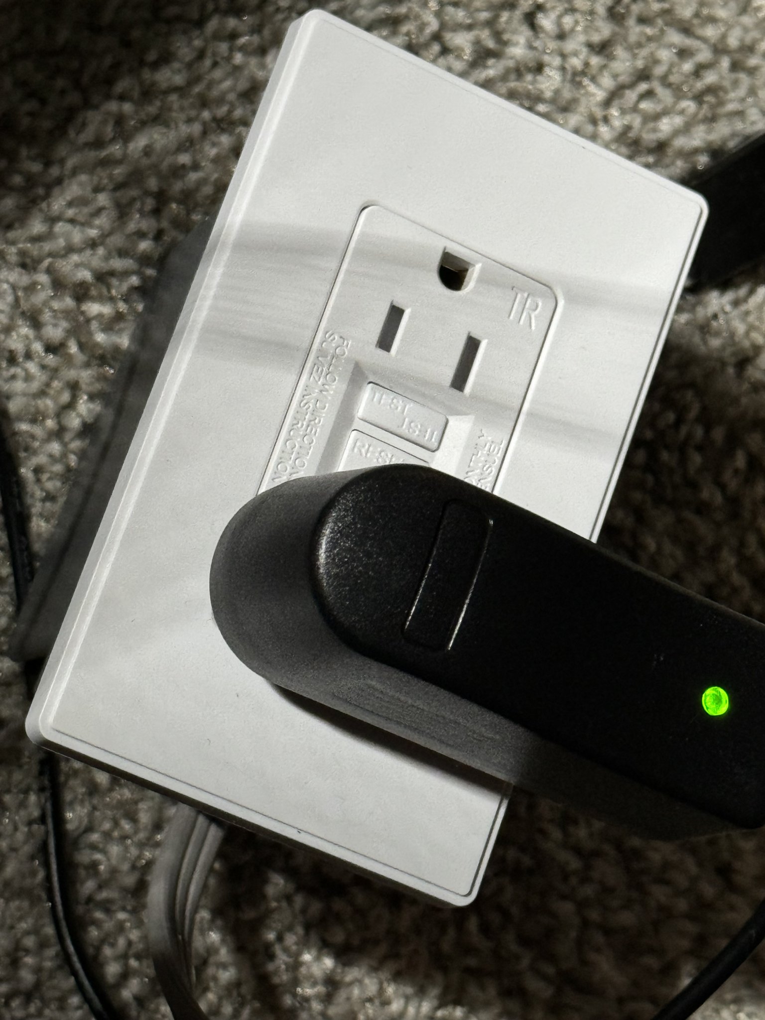

I had an electronic scale that would drift annoyingly forcing me to zero or calibrate constantly. I took a three prong extension cord, a GFCI breaker, and an outlet box and made a stabilized power supply solely for the scales. Once it has warmed about 5 minutes it is constant and undrifting. Now it works exactly as it should.
A level of safety is added by using the GFCI. You don’t need to use an extension cord but could just replace a regular outlet with a good GFCI.
