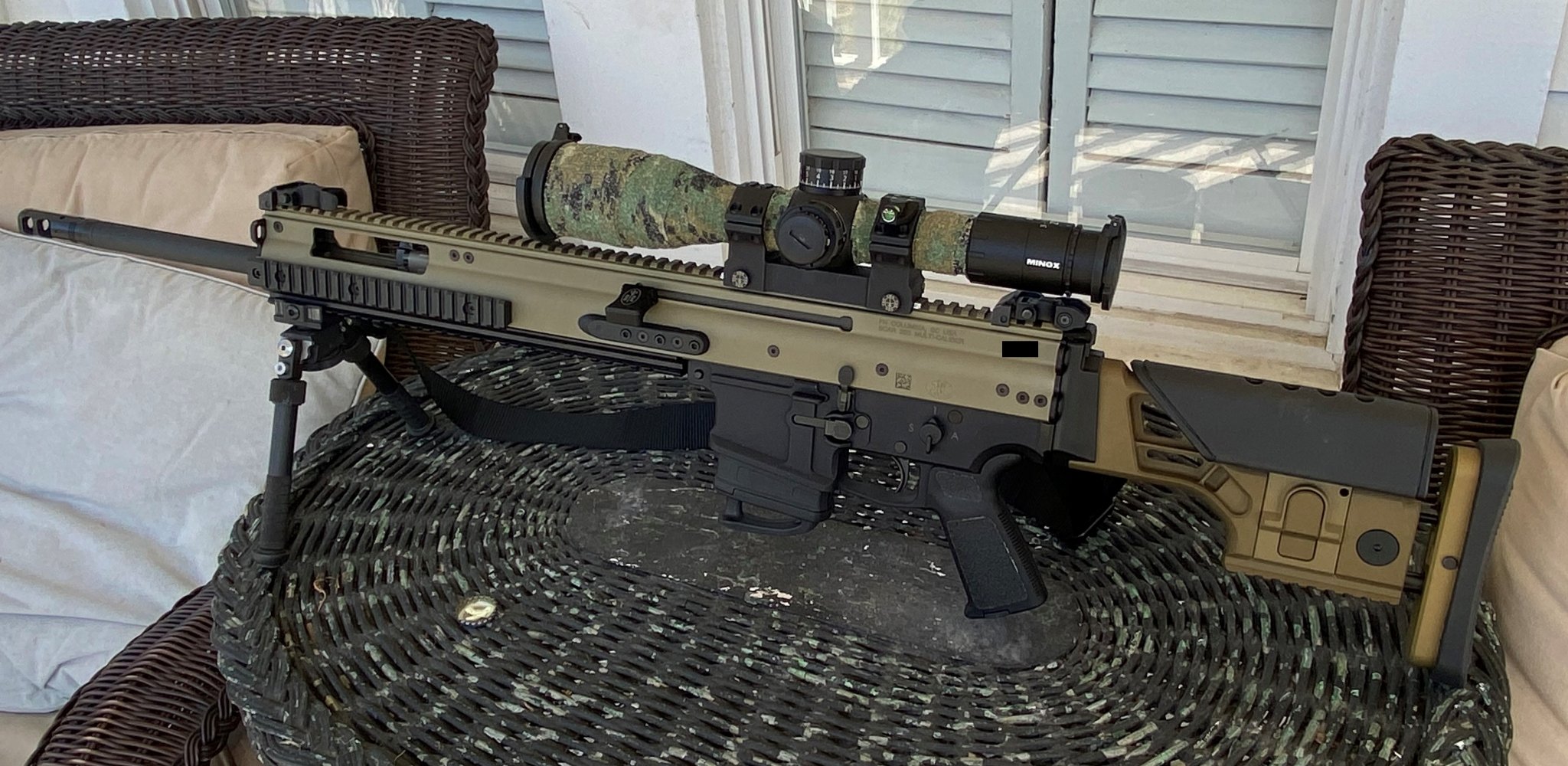

Minox 3-15 on a 20
Reactions: RSR and ScarlettRed
