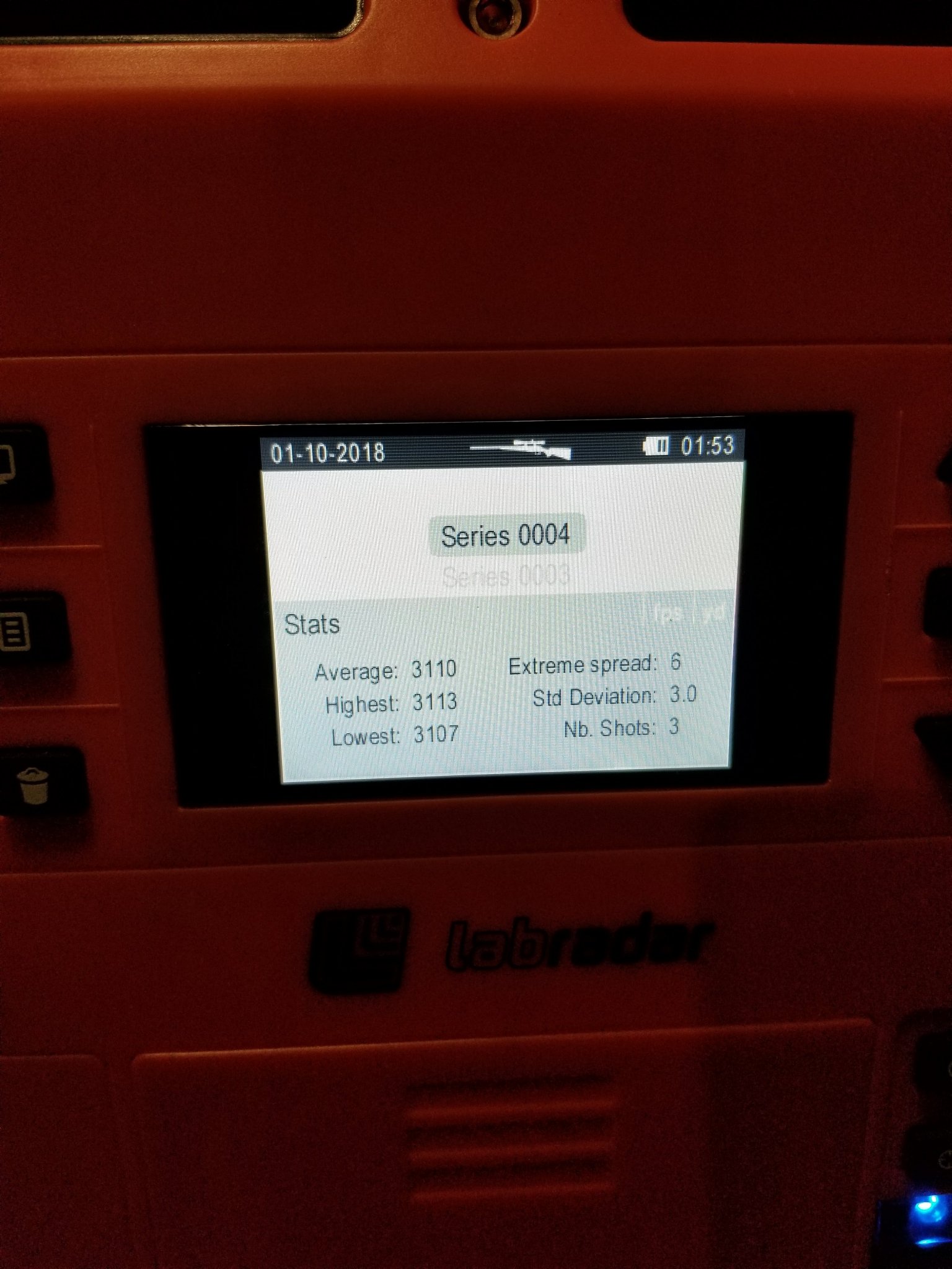

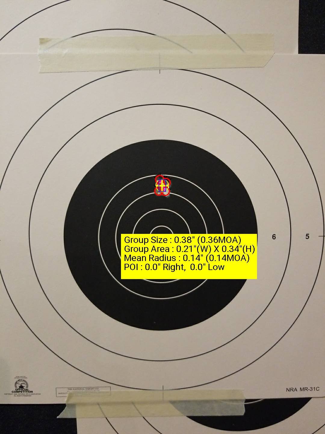

I like the 123 SMK's out of 6.5 Creedmoor. Using RL-16 I got the below grouping with a velocity of 3110 fps, SD of 3 and ES of 6 for the 3 shots my LabRadar caught indoors.
I tested them out to a mile and they worked well considering they were dropping subsonic at around 1600-1700 yards based on the weather and elevation. Not much recoil with them either, compared to my heavy 147gr loads that I also use (147's at 2900 fps).
I personally wouldn't much bother with the 123gr Scenars, but that's just because the SMK's are good enough for me. I don't need to worry about benchrest performance for PRS, just cost (I shoot a lot) and external ballistics (which are functionally identical within 1000 yards for both of them). I like to shoot this 123 SMK load in a local match that only goes out to 600 yards since there's not much drop or wind for me with them moving that fast and targets that close compared to if I shot heavier bullets.

Very impressive results!!

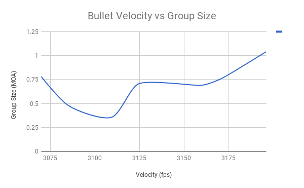

Overall here are the charts I got for my particular rifle (Christensen TFM w/ stock 26" barrel and a TB Ultra 9) with the 123 SMK's on group size vs bullet velocity and charge weight vs bullet velocity. For reference purposes I used Lapua Brass, CCI BR4 primers, and loaded them all to .020" off the lands.
Your mileage may vary, but I like to keep as much data on my load development as possible and I'm more than happy to share what I've got. I didn't see pressure signs, but it was a real challenge to get 45.4 grains of RL-16 to fit in the Lapua case without a drop tube. It was more or less filling powder up all the way to the top of the neck at that point, and anything above 44.2 grains of RL-16 was a compressed load for me.

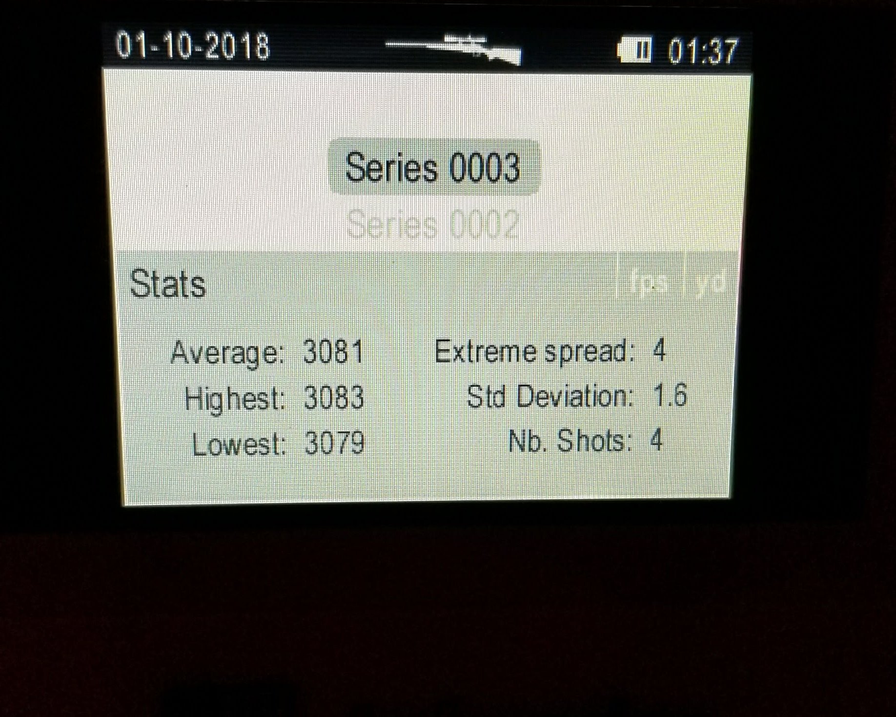

Tested in .4gr increments. Highest SD and ES I saw was 45 grains of powder (10.3 and 25), and the lowest was with the 43.4gr of powder (pictured below, but it only captured 4 of the 5 shots - this testing was done the first time I used the LabRadar and I was still getting the hang of it). Average SD was 5 and the average ES was 10.9. These results were using a Hornady LnL Classic Kit press and other items, just being careful to trickle the powder until the exact kernal where I saw it tick over the charge weight I desired.
